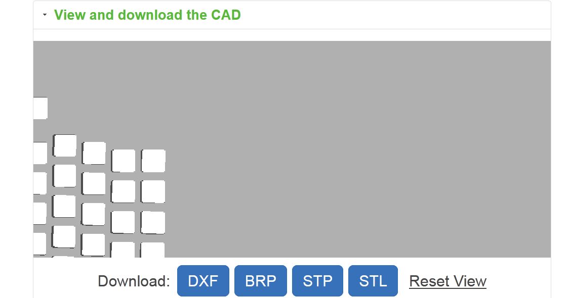

Hi! I have a question regarding swill's plate builder tool. For an ergo layout I rotated the keycaps in keyboard-layout-editor, but swill's plate builder tool did not correctly process this data, the rotation is shifted awkwardly, see screenshot. Is this a bug? What can I do?

Maybe try opening the CAD file in an editor and see if it can be corrected manually.

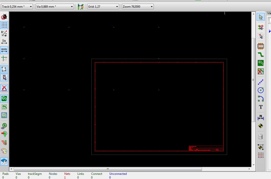

Didn't help. I've downloaded the SVG file from builder.swillkb.com, converted the SVG file to *.KiCAD_PCB format, and opened it in KiCAD. There, I mainly see black void. See screenshot. The original layout in keyboard-layout-editor.com is stable, here is the link to the original layout: http://www.keyboard-layout-editor.com/# ... 769c9f72d1

@Charger Thanks for affirmation. I need to rotate manually in an appropriate CAD application then. I checked out QCAD for this purpose, but am not quite satisfied with it's useability ...
