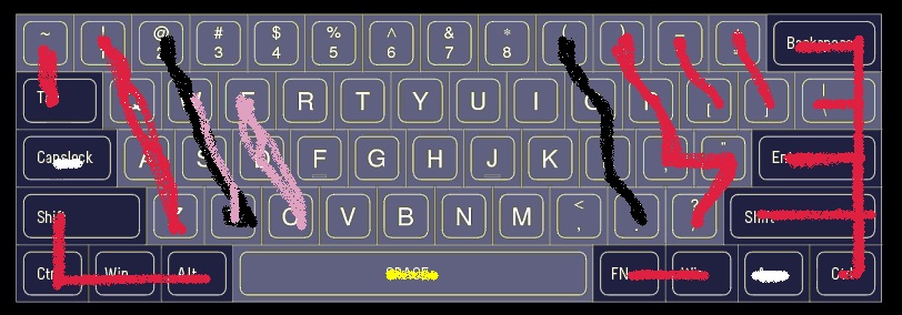

So I've been asked to help Ducky making sense of their next special edition keyboard.
For unknown reasons they want to release a variable-switch board (switch color varies along the board). As far as I understand this is what they have in mind so far
I really can't see the rationale behind this board, but if you really had to make something like this, how would you make it?
Let me start the dance with an alternative I laid out very quickly. I'll post more in the coming days but please let's try to give a sense to this thing and it might become a real board.

The layout seems completely random to me as proposed by Ducky. I don't know if MX has enough stock configurations in spring weights across their "families" (linear, tactile, clicky) to really make this comfortable or feasible. If there were more spring configurations in a simple family, for example if they used Korean custom springs (not a realistic goal, but for argument's sake), then it would be interesting to have a layout approximating a variable-weight Topre board except made of MX clears (or blues, or linears).

That board sort of only makes sense as a switch tester to me. I don't understand why you'd like to change tactility and clickiness between different keys. Spring weight would be more reasonable...

I know it doesn't make sense, but if you really had to make it, how would it be?

You can do a reasonable variable weighting with linear greys/blacks/reds. I've done variable weighting mods before using clear/red/black springs and linear stems and it's alright, nothing amazing. My weighting layout is in the attachment more or less, I can't remember why I had reds/blacks/clears instead of red/clears/blacks but there we go, the later is the way I'd go now if I were to do it again.
I guess on the F row having light-medium-heavy switches as you go along (F1-F4 blues, F5-F8 greens, F9-F12 whites or something) could be kind of nice. Having the columns/rows on the numpad getting heavier/lighter could be kind of cool...as we've got a linear variable weighted alpha section and clicky F keys maybe make the numpad tactile.

How about this:
Blue on the alphanumerics: but like on a typewriter only the alphanumeric keys should click.
Browns on the modifiers: Shift, Alt, Win, Fn, Control. I first thought that linear would be best, but I think that tactility is underrated on these. You would also want some resistance on the upstroke so that you feel when you release it.
Clear on Space: Must have a heavier switch on the space bar, but Tactile Grey might be too hard.
Clear on Return and Esc. Because they are "heavy" operations. Maybe even so far as Tactile Grey on Esc.
Tactile Grey on Caps Lock, Num Lock, Scroll Lock: Heavy switch to prevent accidental presses. Maybe even Green here. (Suboptimal if you like me map Caps Lock to something else, but anyway...)
Arrow and nav keys: Clear or Brown.
Tab, Backspace, Insert, Delete: Clear or Brown.
Function keys, and Prt Src/Scroll Lock/Pause could be have green or blue in different groups.
The idea is to mimic the sound and feel of a typewriter - as a consistent theme, not have different switches for the sake of having different switches. If you remember mechanical typewriters, only alphanumeric keys caused key arms to strike the ribbon and paper.
Preferably, there should also be O-rings on the alphanumeric keys so that you get the Click but without the Clack.
Also, no linear switches. No heavy switches on the alphanumeric keys - keep it ergonomic.

I like Findecanor's proposal, I'll try to lay that out

More seriously, I like Findecanor's suggestions a lot. Clicky alphas, non clicky mods, and heavier switches where size and function are important. If I had to add quirks, I'd include tactile greys on F1 and Insert.

some more non-sense. I mixed some of the suggestions
15 Feb 2015, 10:43
Ideally, the modifiers should be harder to push than the regular keys, so I would do it the other way round.
