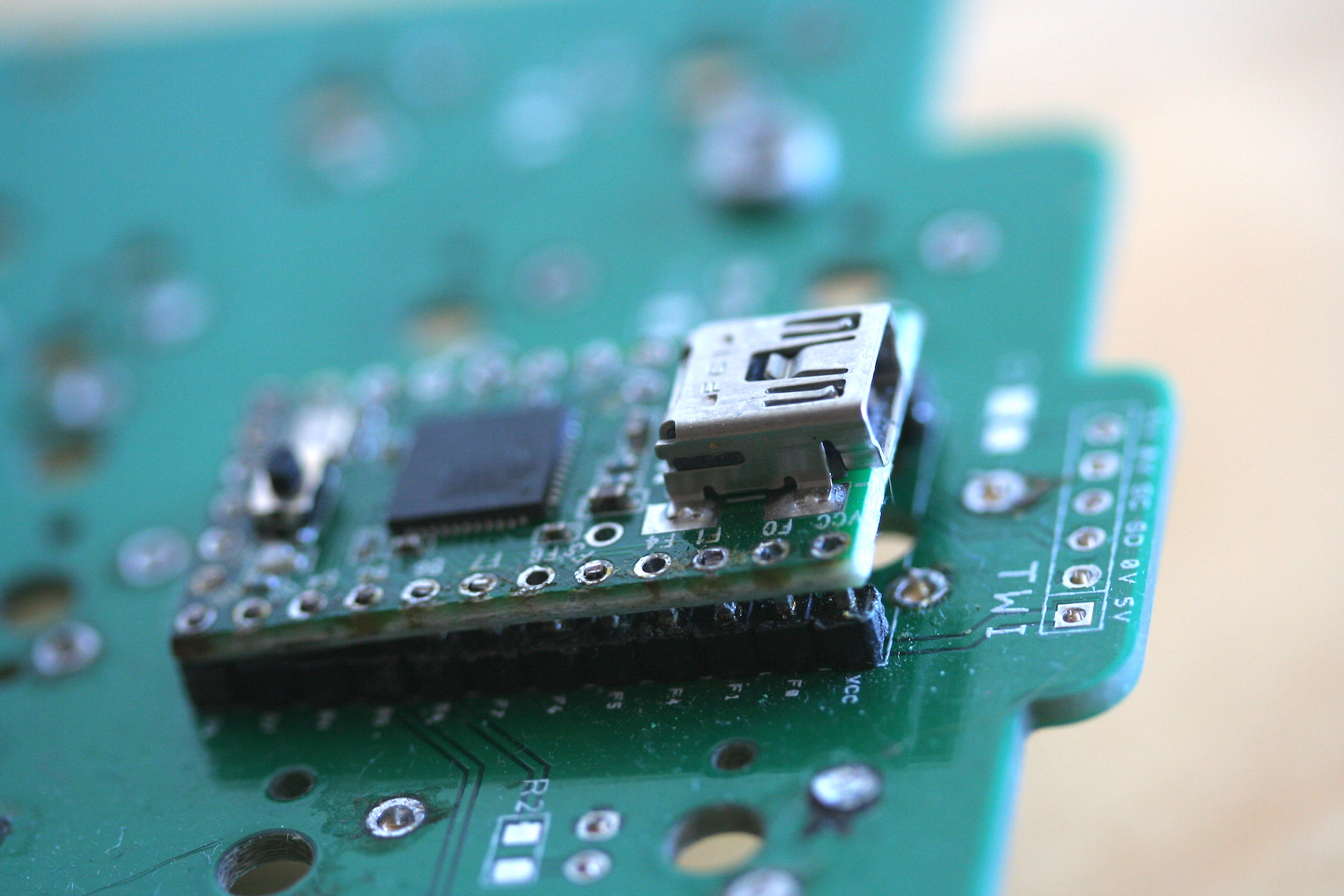

Anyone got advice how to desolder a Teensy (in this case) which is installed with legs in a PCB? I'm looking to harvest one from a prototype PCB I don't use any more, and tried in vain to suck all the solder out of it and pull it off. Just the tiniest bit of solder on each leg seems to be needed to keep it stuck fast!
As you can see, I've already been quite beastly with it! I tried desoldering the pins from the top and the bottom, naturally. Nothing much still comes out, and I'm quite stuck.
I'm guessing I need to be able to melt multiple pins worth of solder simultaneously, with specialised gear?

I've heated the Teensy enough to scorch it a few places, as the photo exposes! I'm not sure what I'd have to do to push the pins through. Heat and force? Trouble is, my soldering iron is too blunt to go through the holes.
@i$: You bet I've been using a suction pump. Like HzFaq says, the slightest bit of cool solder residue and those pins stay stuck hard! I was essentially trying your other technique as well, levering and heating. But there's too many damn pins to let me lever while just heating one at a time. The Teensy's still stuck hard down at the back end, where most the pins are.
I should mention there's an MX black on the underside of this PCB (really the Teensy is slung underneath) which is stuck in as well, hidden by the Teensy, which makes leverage tricky.
