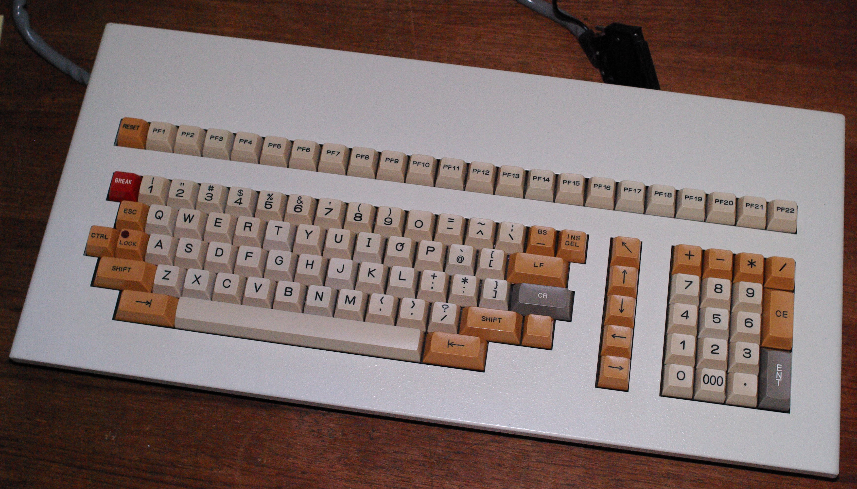

This is the keyboard for this Sanyo MBC-2000 / 3000 computer.

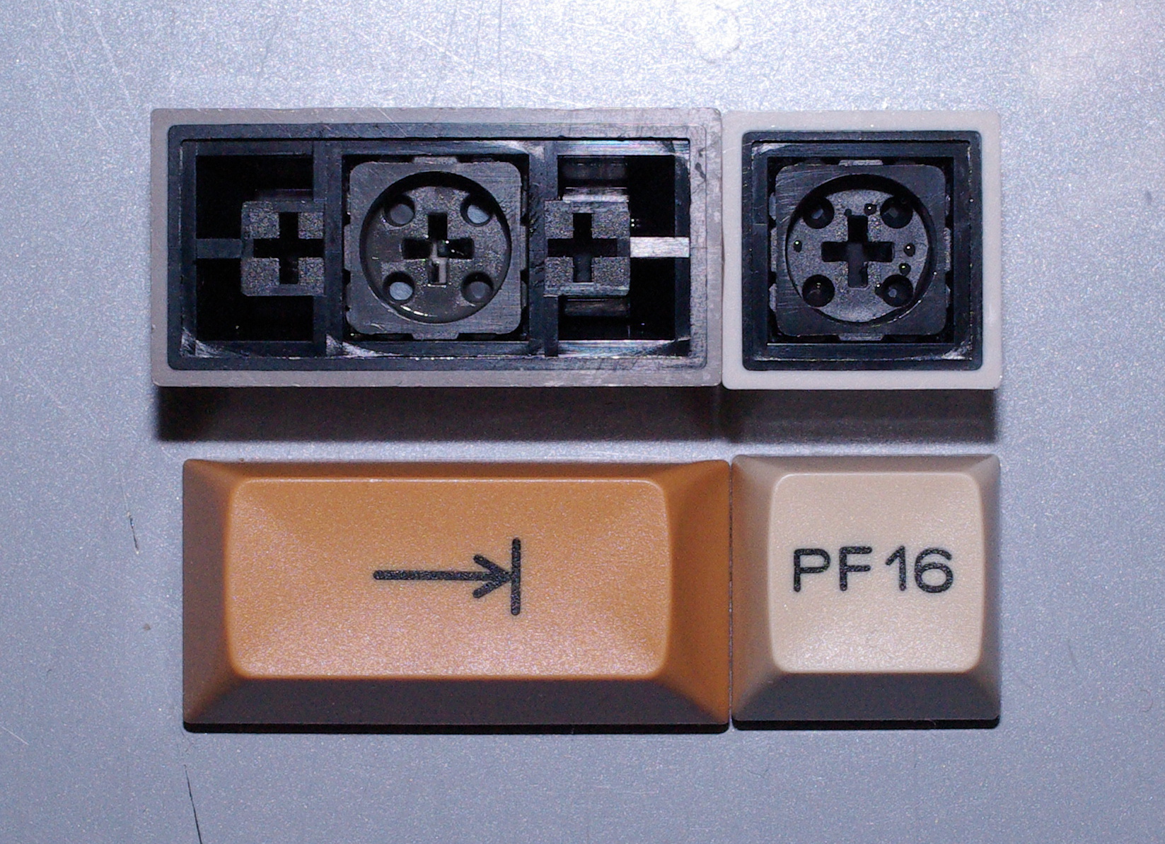

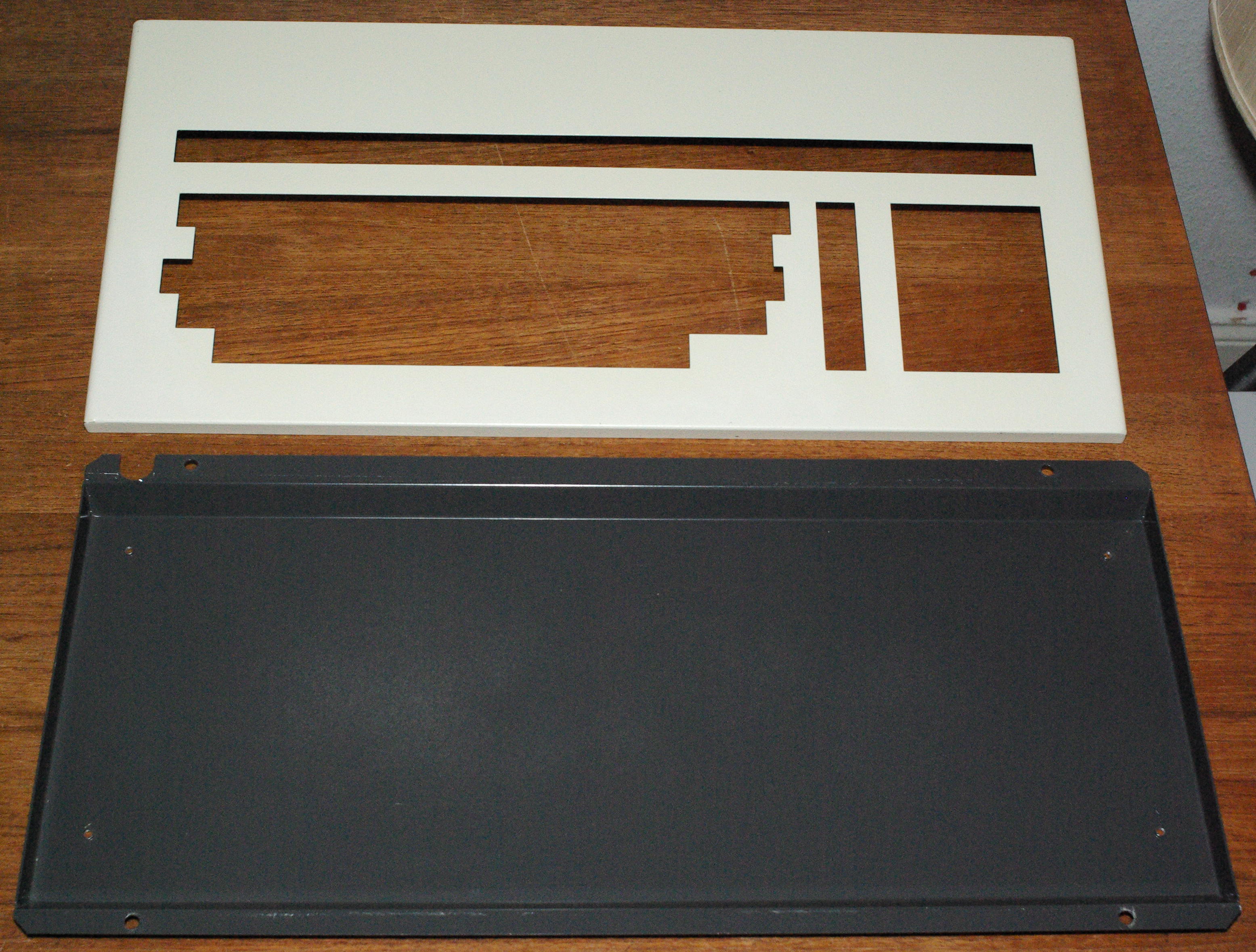

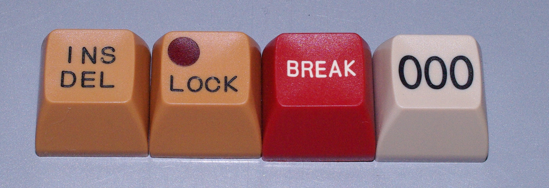

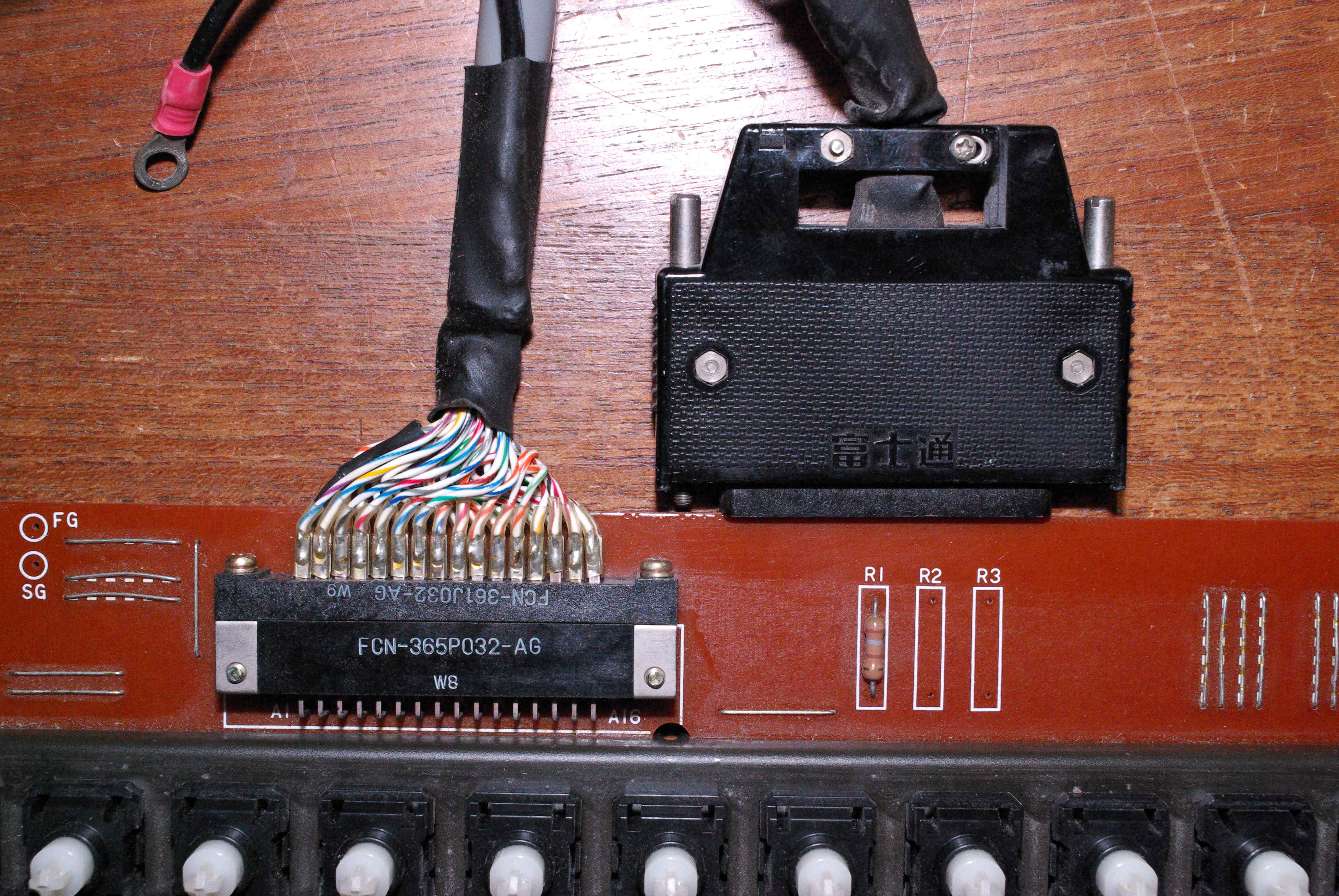

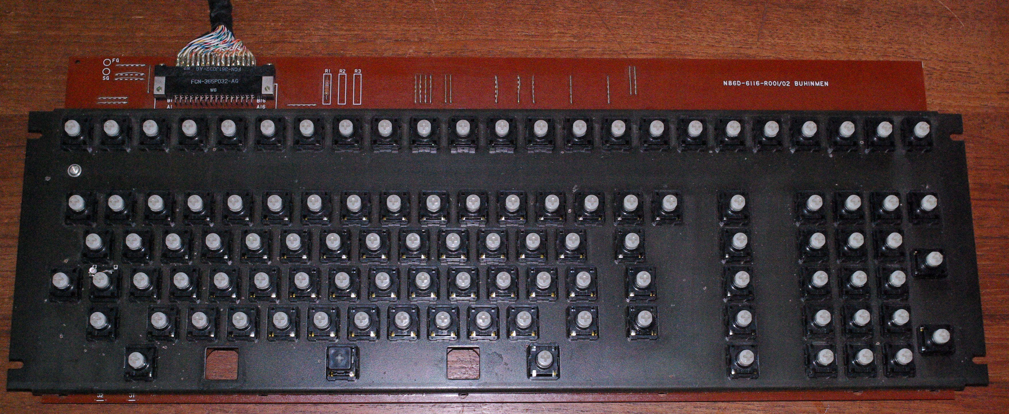

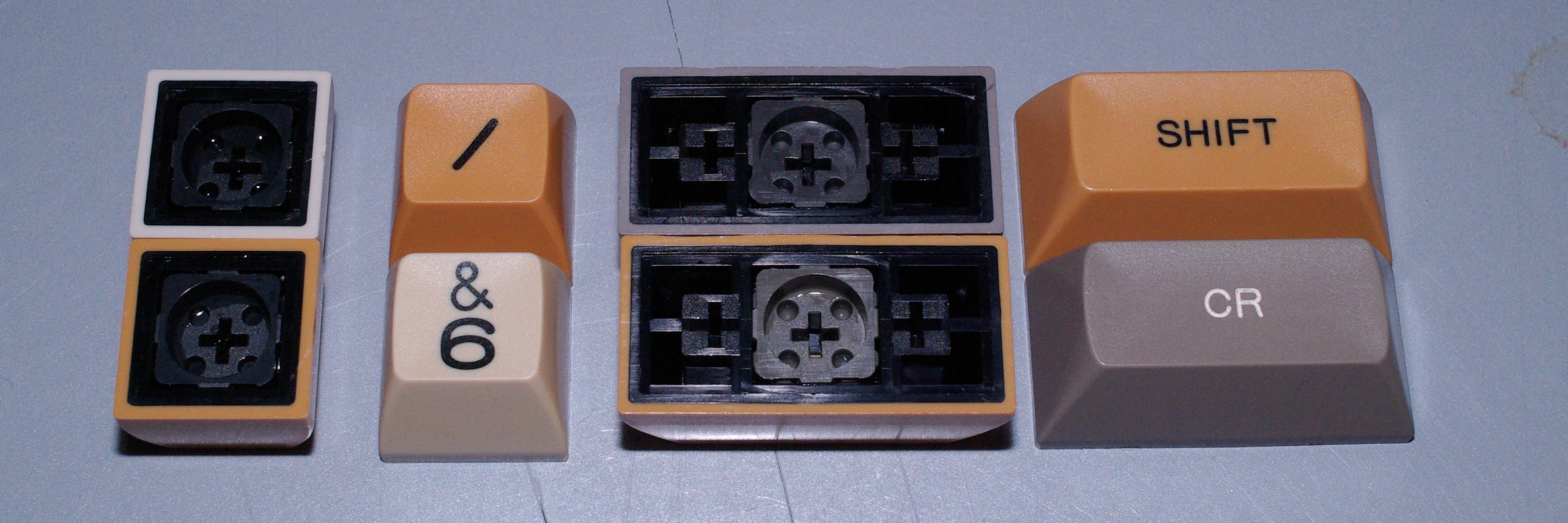

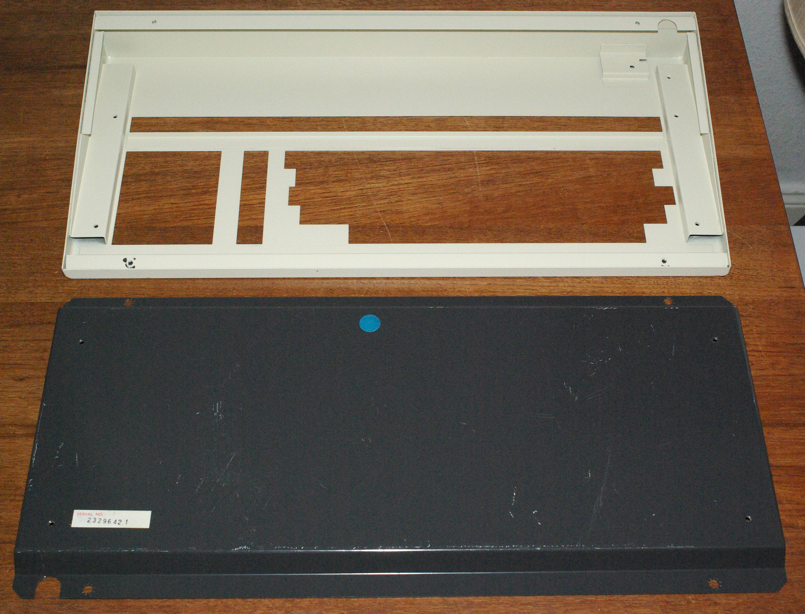

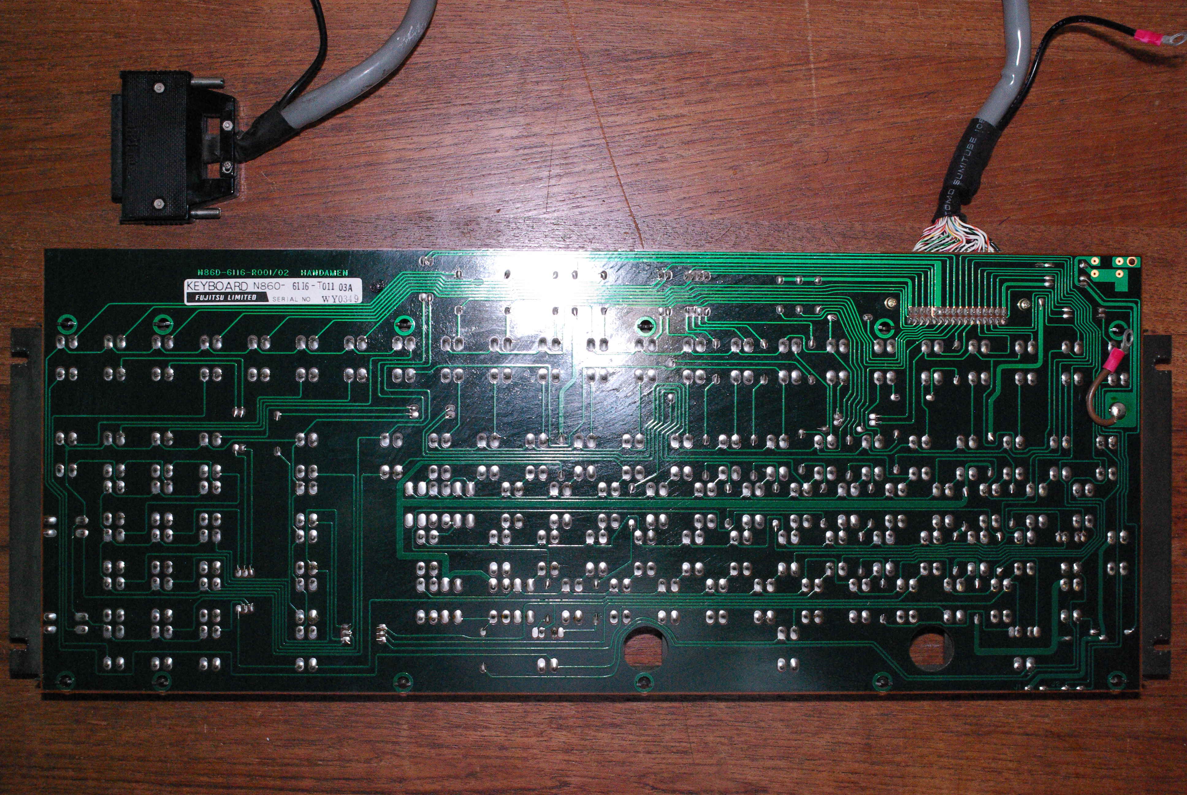

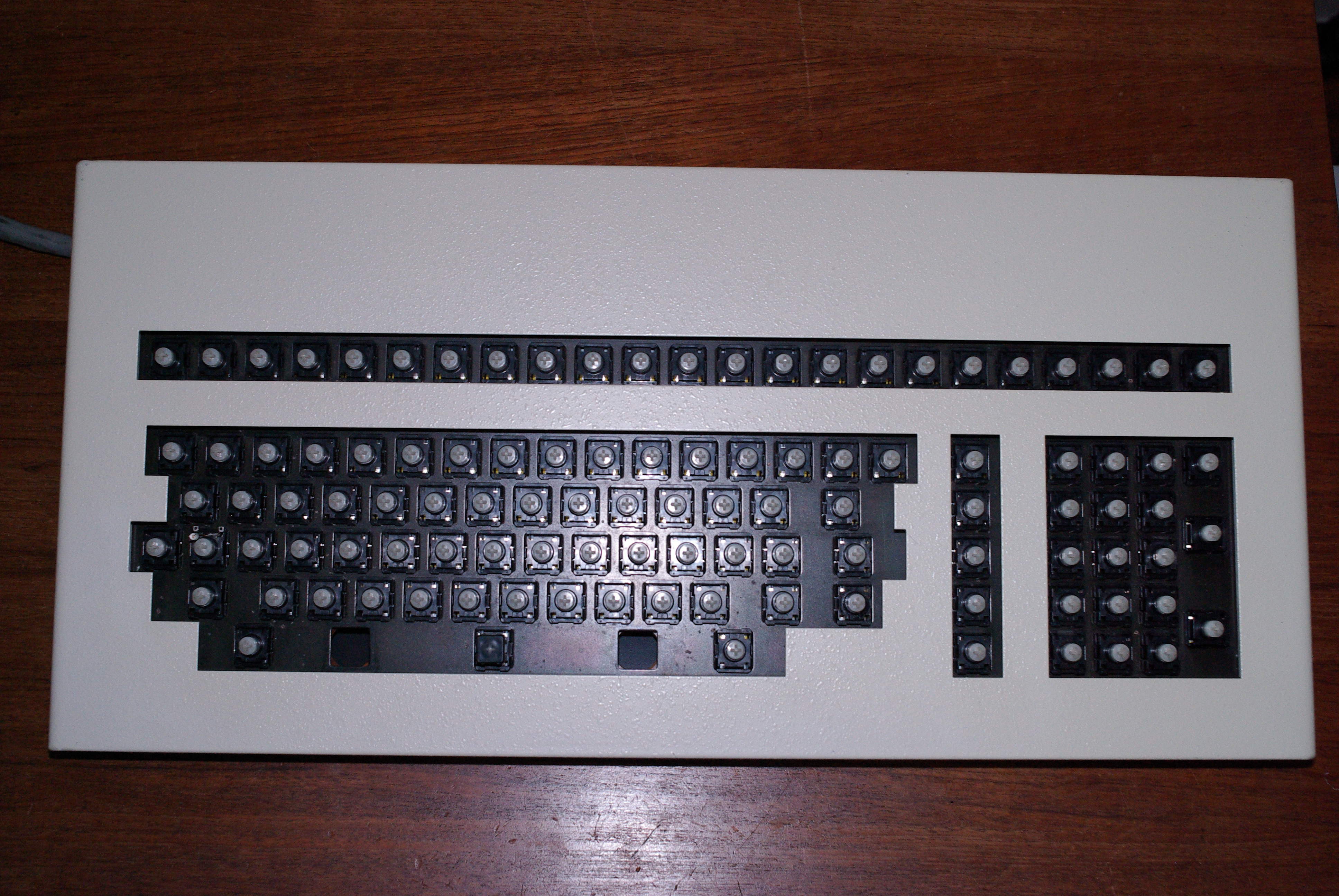

Another one found by guk and bought by me. I knew pretty much what to expect from this, but I am pleasently suprised. I do not know how old this is and cannot find a reference as yet. The case consists of top and bottom parts both made of sturdy metal.The PCB sits on a metal plate inside the metal case. It´s a heavy keyboard! You can see the sticker on the PCB. The other side reads a serial too and the word "Buhinmen". I´d like to know what "Handamen" and "Buhinmen" mean. It´s got nothing to do with noodels that´s for sure. The switch is clicky, feels like it needs lubing for sure. The keycaps are what makes this awesome for me. The colors remind me of my childhood, it´s a little Star Trekish. I´ve never seen caps like this, I mean the inside of the caps, a kind of "insert mold". The connector has asian symbols on it. I cannot see a controller or any chips on the PCB!

Pretty keycaps!

Great pictures as always, Seebart! Found this: * BUHIN is Parts * BUHINMEN is Parts side

pcaro wrote: Pretty keycaps!
thanks, too bad they won`t fit on anything else! :lol:

Very nice! Those caps remind me too from childhood, but maybe more about Japanese cartoons than Star Trek.

You got a nice one here, Seebart. Great caps, a metal case, vintage clicky switches *and* no weird old controller to get in the way of adapting it for USB. I wish I was as lucky with the Honeywell! The matrix is exposed and ready to put straight into a Teensy. I wouldn't count on too much rollover though: I can't see diodes on the PCB, but maybe they're on the other side.

Looks like 32 pins. You'll need a Teensy++ for sure. None of that Pro Micro fluff!

Looking at the PCB's 4 soldering points per switch. it might indicate that diode is on the other side.
01 Feb 2015, 10:37
Yeah, I hope that's the case. But sometimes you'll find bridging wires installed instead. MX switches have a little slot for that. And several switch types have more than 2 pins anyway.

Muirium wrote: Notably, that keyboard has no ICs on the PCB either. But apparently SIX contacts per switch!
Six contacts? They all have four legs. The clusters of six are deceptive: you're seeing the diodes in between switches.
01 Feb 2015, 14:28
Aye. I was too subtle with my distinction between contacts and legs! Two contacts of every cluster of six on that board do indeed belong to a diode. Which suggests that even seeing 4 contacts per switch on a PCB is no guarantee there are diodes installed. Some switches just like to have a lot of legs.

4 contacts is not the key to know is there diodes or not, but above in the picture PCB routing suggests that there are diodes, when looking how the wiring has been done on the bottom layer.

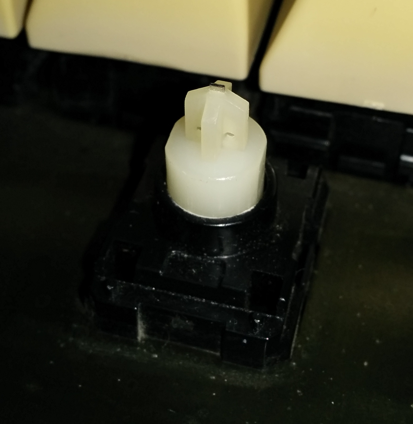

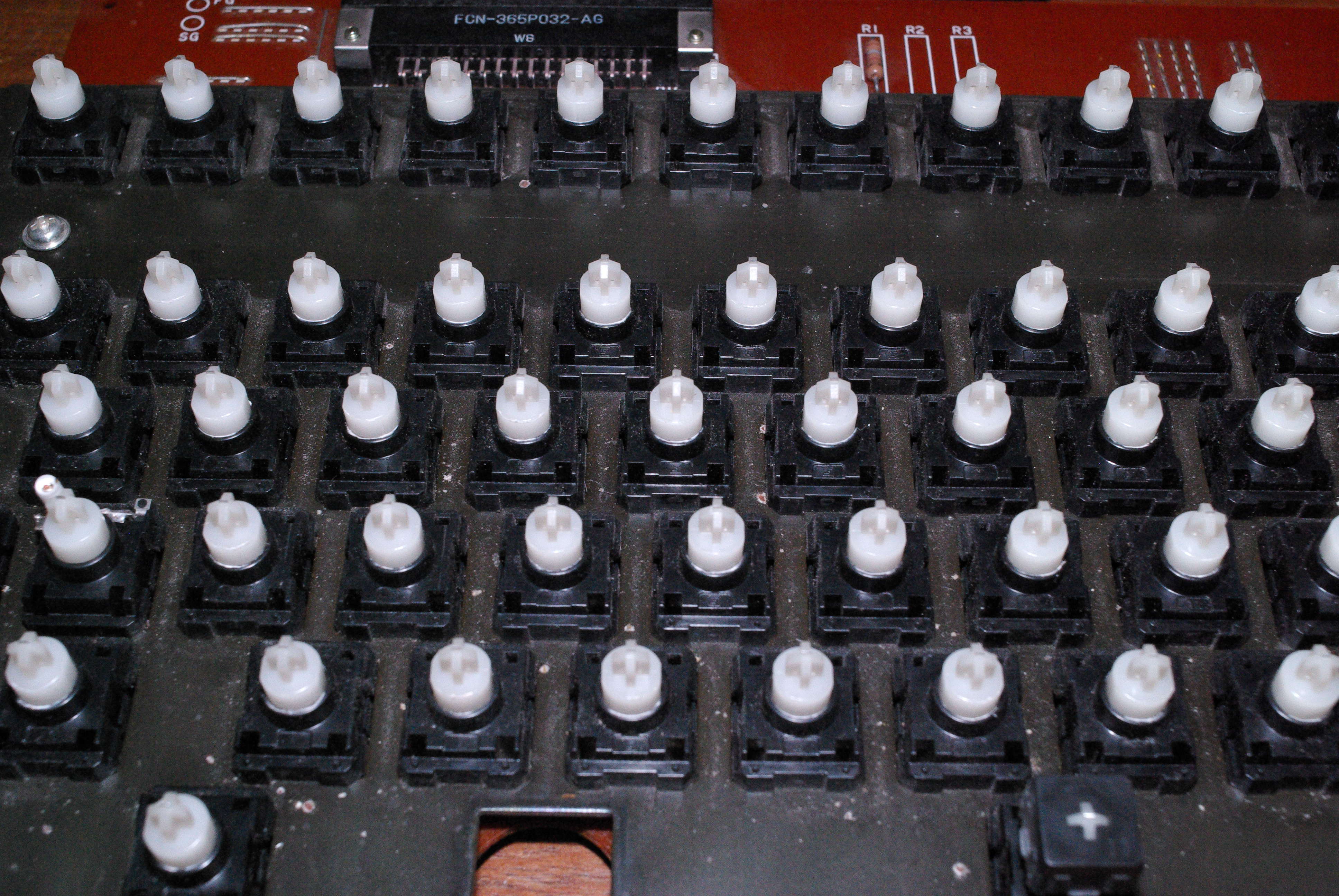

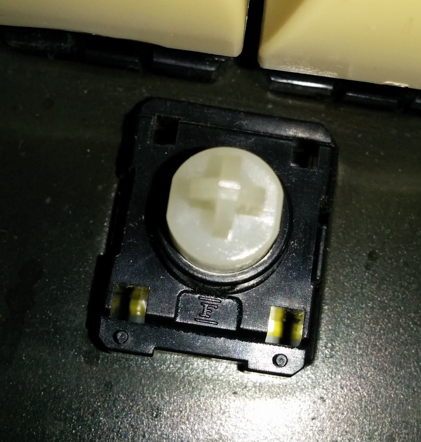

when I was cleaning the keyboard yesterday I kept noticing how sharp the tips of the sliders are, I almost cut myself once or twice. Just now when I took another look real close you can see that the very top of the slider has a really small fine metal tip in the center, you can see it in these pictures. Also notice the "F" marking on the switch housing.
Also the top of the cross on the slider is not flat like the Alps integrated dome in our wiki. Yet on the Fujitsu
Leaf Spring Switch wiki page the illustration of the 1st Gen. switch does have some sort of a tiny tip on the slider!

Ugh, yep. I've cut myself a few times on these switches. Those little razor blades...
Most definitely a 1st Gen Fujitsu Leaf Spring. The connector may be a bit tricky to find fcn-365p032-ag, but I actually think you still might be able to get some. At least your keyboard doesn't have a controller. Mine just has this really shitty 1KRO ASCII out protocol that really isn't worth converting.

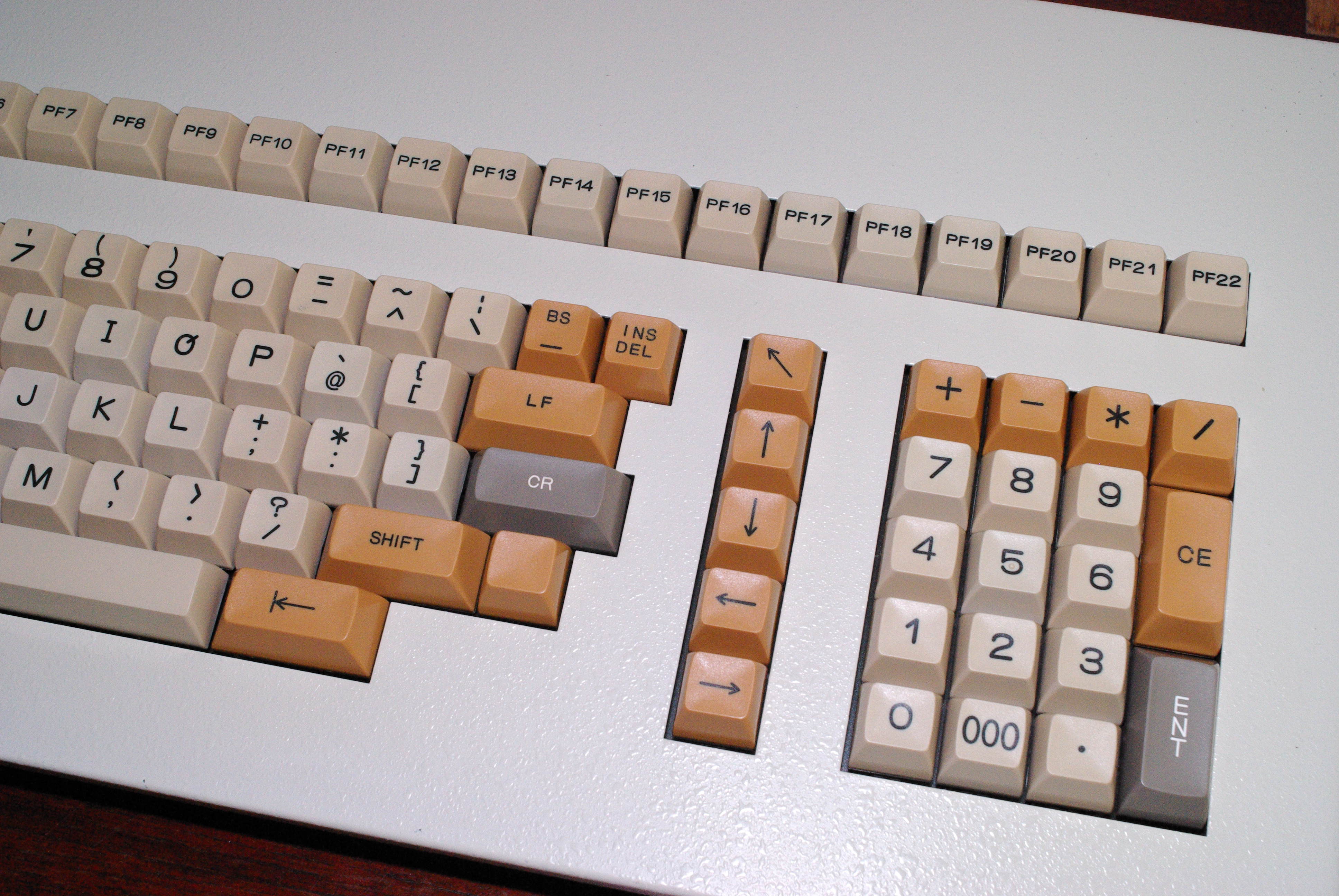

Also, can you check to see if any of the keycaps are doubleshot-engraved?
01 Feb 2015, 19:58
hey thanks for the feedback, now we`re getting somewhere! The following keycaps are engraved:
Tab´s next to spacebar
grey CR
grey ENT
orange CE
orange INS DEL
orange BS _
the top navigational arrow
I find it odd that only a few seemingly random doubleshots are engraved! Any idea why? Yeah I´m lucky with this not having a controller in the way, this is worth getting a Teensy++.
haha I should have read our wiki more carefully, the answer is there:
Used a cross slider with part of the leaf spring mechanism embedded into the slider, and visible at the tip of the tip of the cross.[1]
:oops:

Basically, the doubleshot engraved keys are cheaper to make because you only have to mold one type of keycap, then engrave whatever letters you want into it.

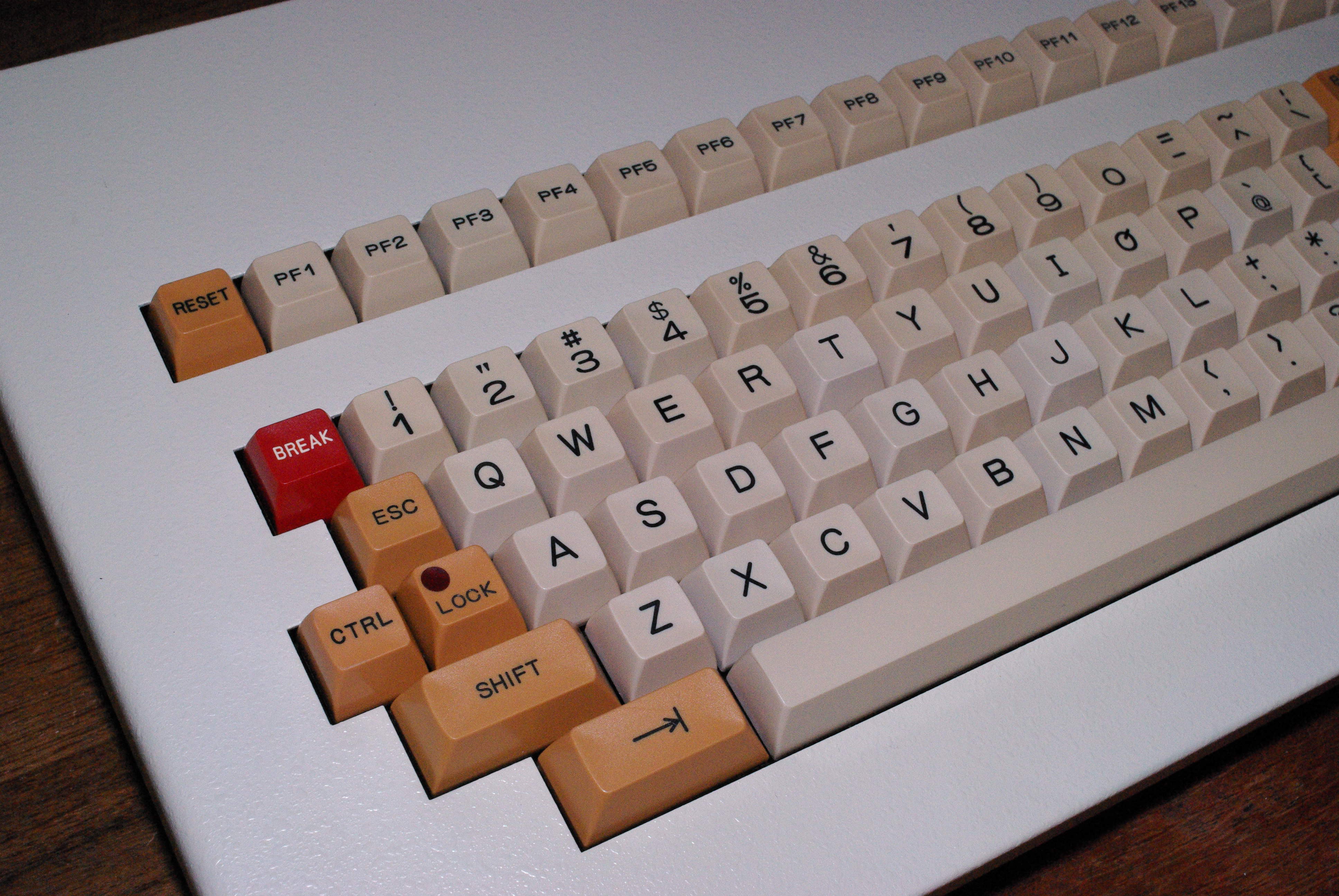

Nice. Looking at the layout, it should be quite useable with some creative mod placement. And vitally, given those harebrained vertically stacked arrow keys, the HHKB Fn key is present:
I wonder what to do with all those function keys!
