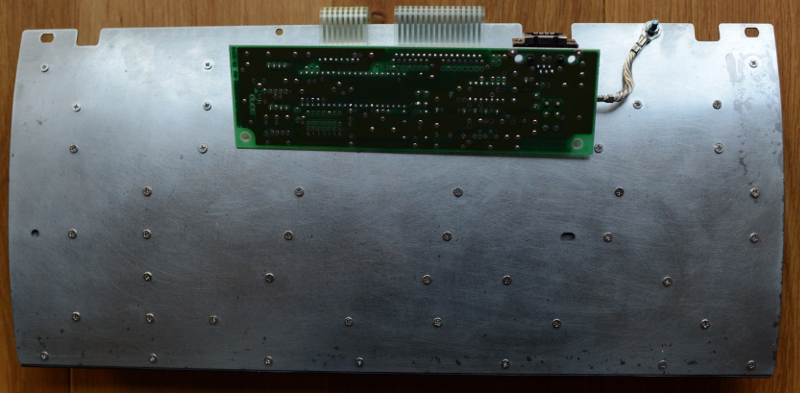

Hello,
This is a very simple question.
I have wet-sanded the back plate of a model m. It was a little bit rusty.
It worked very well. It is soft and bright. I like it a lot.
It seems to me that by doing it I have removed a cover that it had. I wonder if the reason was to avoid future rust.
I could paint it with a nice mat-black anti-rust paint that I have. No problem. But my preference is to keep it as it is.
What is your experience / recommendation ?
Thanks in advance
i$

12 Jan 2015, 08:21
Date - 11.Jan.2015

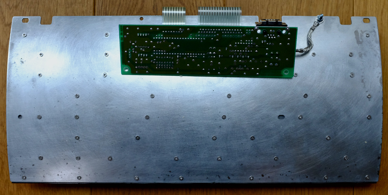

01 Feb 2015, 13:46
Date: 01.Feb.2015
