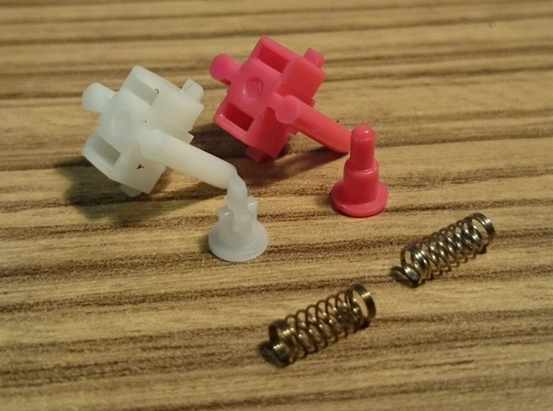

I took apart my ANK 2462 today to find that there were two red slider switches on the board. One on space, and one randomly on letter 'T' or something (I've moved it to 'Esc' now). Have disassembled a white and red to see if there are any differences and it seems that the little peg on the red switch is longer and there might be some difference in the springs but it's hard to tell. They are definitely different colour (white has the gold/bronze coloured spring).

I tend to think of "stem" as meaning a protrusion, and "slider" being the moving part of a switch between the return spring and keycap. In the case of Cherry, I am not sure if "stem" means the whole slider (which is what people take it to mean) or just the protrusion that holds the keycap. For example, I consider the peg inside a Cherry MX keycap as a stem also.
Changing from "stem" to "slider" for Olivetti switches is a strange one. "stem" seems an odd term since the slider is flat-topped with holes in it. I'd say "slider" personally, but I don't understand the reasoning for "stem" originally, since people seem to randomly choose slider/stem/plunger without a clear pattern.

For these old Olivetti dome boards, the stem of the keycap presses down directly on the dome. I wouldn't call part of the keycap a slider. Can you point me to an image that you're describing when you say "flat-topped with holes in it"? It sounds like you're describing the NMB dome with slider switch but I want to be sure.

Lol I realised the confusion I probably made after re-reading my original post. First paragraph is about Olivetti ANK 25-101 and ANK 27-102. Second paragraph is unrelated and about the dome with *slider* variant.
This is an image of the ANK 25-101 with a cap removed:
There's no slider as such. Just the stem of the cap that presses down on the green dome. This is what I think the ANK 27-102 looks like too. Hopefully that clears it up.
