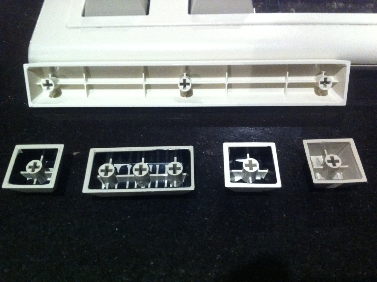

Also anyone willing to buy it for parts is welcome, this is my first mechanical so I have no idea how much it's worth, I tend to just read about them. Also the keycaps look odd on the inside. The best way to describe it is as if someone has put black tape inside then roughly peeled of sections. It may be doubleshotted(?).

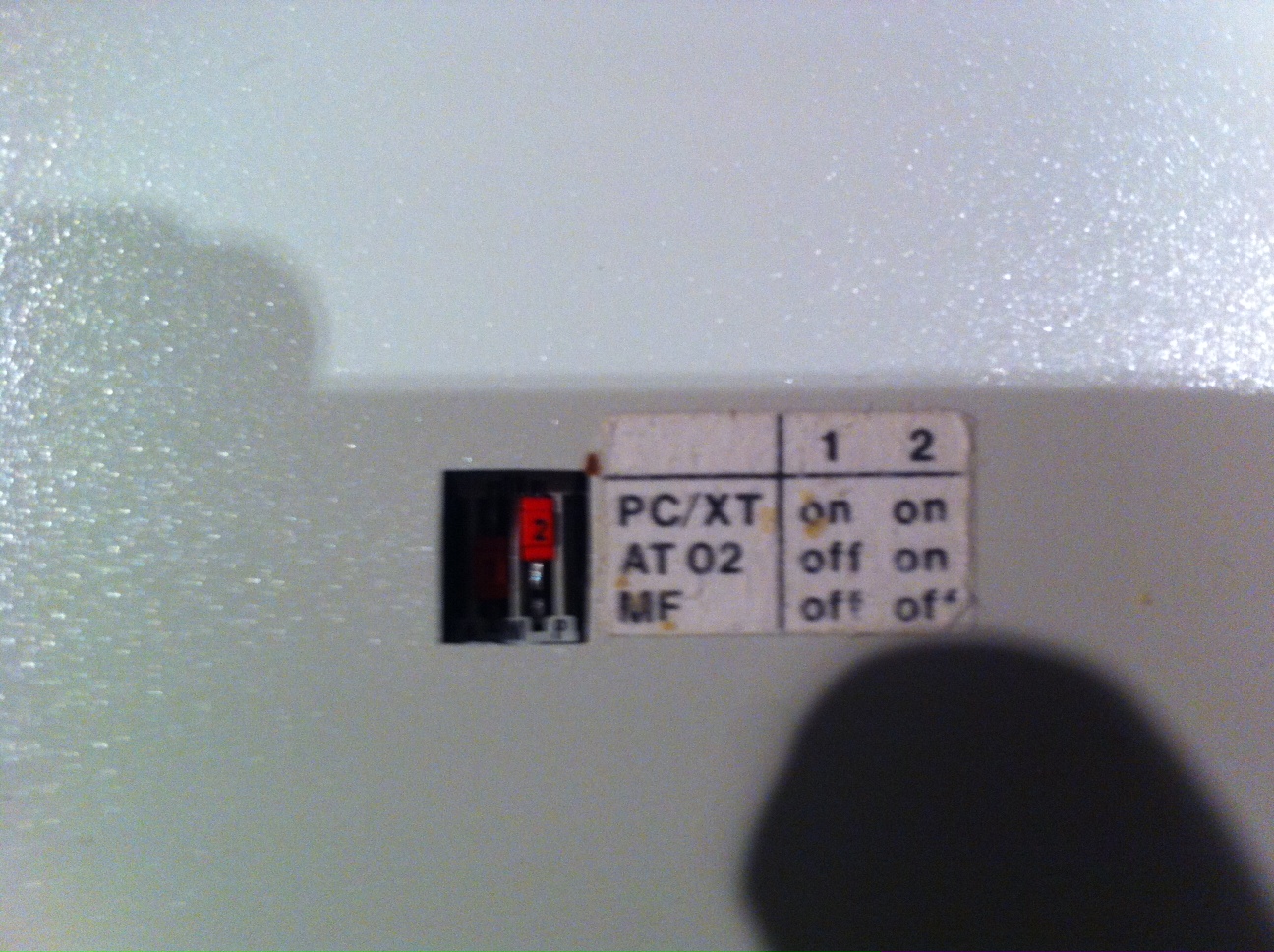

Try checking if there are some switches on the back of the keyboard. If there are, they will allow you to switch between AT and XT. You want AT.
crimzongryphon
31 Jul 2014, 19:46
I want AT? I saw the switches before and asked a friend and he said XT? It's fairing is farily dreadful but nothing is cracked or broken except maybe the keyboard it's self (still testing). I found it at the tip lol. Someone threw it out and I spotted it. Pretty lucky. I've seen a g80 there before but the people who work at the tip were not too happy having their junk recycled... This time I lied and said I owned it and someone else had thrown it out.

Jep, you'd want the switch on the AT position on modern computers.

FYI there is also MF but now that I have restarted the "lock" keys do nothing.

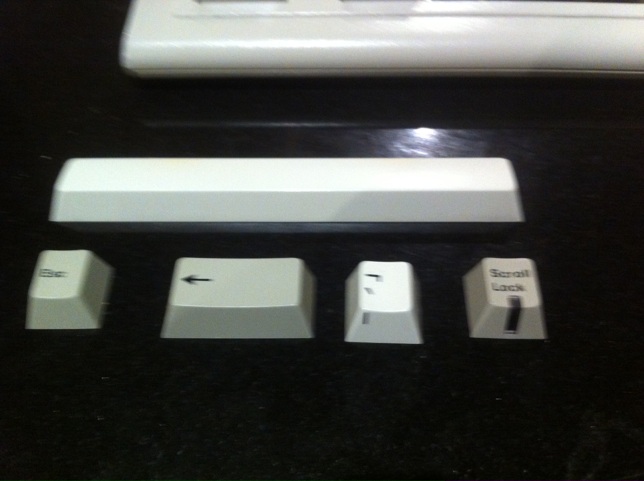

31 Jul 2014, 21:04
crimzongryphon wrote: […] Also anyone willing to buy it for parts is welcome […]
Also the keycaps look odd on the inside. The best way to describe it is as if someone has put black tape inside then roughly peeled of sections. It may be doubleshotted(?).[…]
Obviously doubleshots, otherwise you wouldn't see a second colour inside. Don't let the caps go for too cheap especially if they are ANSI layout, they are not easy to find with windowed CapsLock, NumLock and ScrollLock.

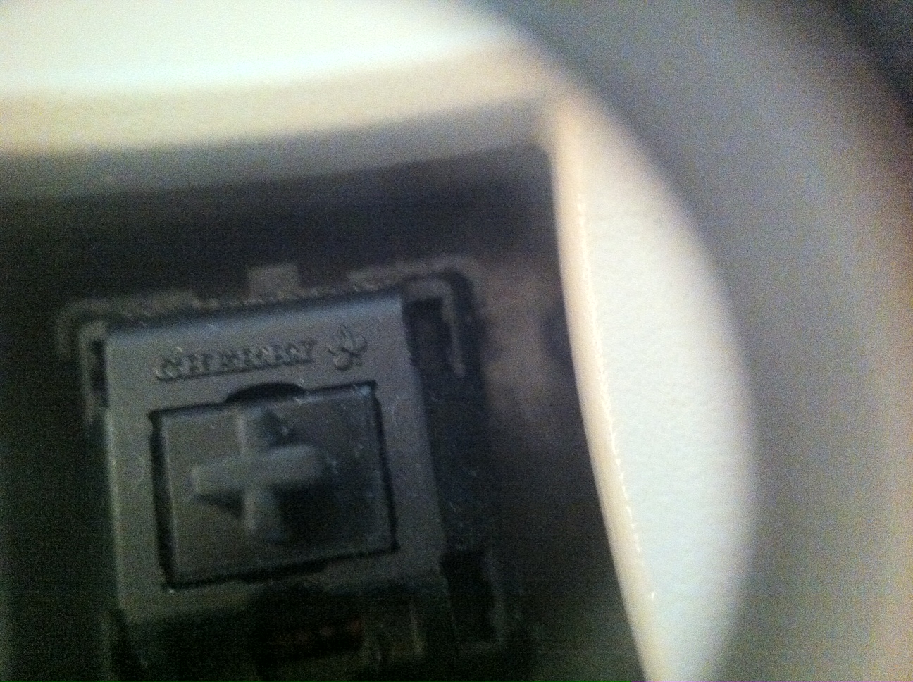

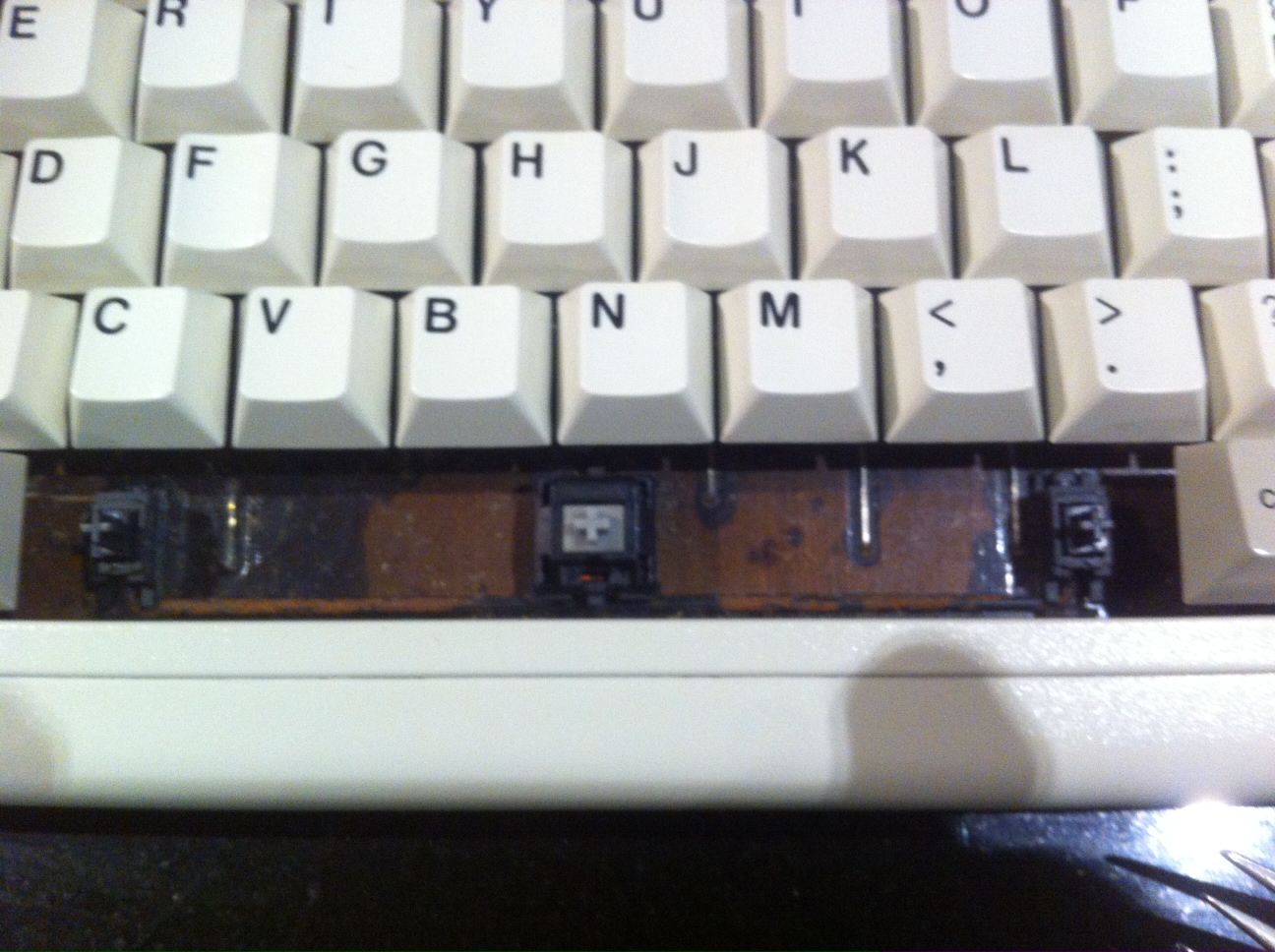

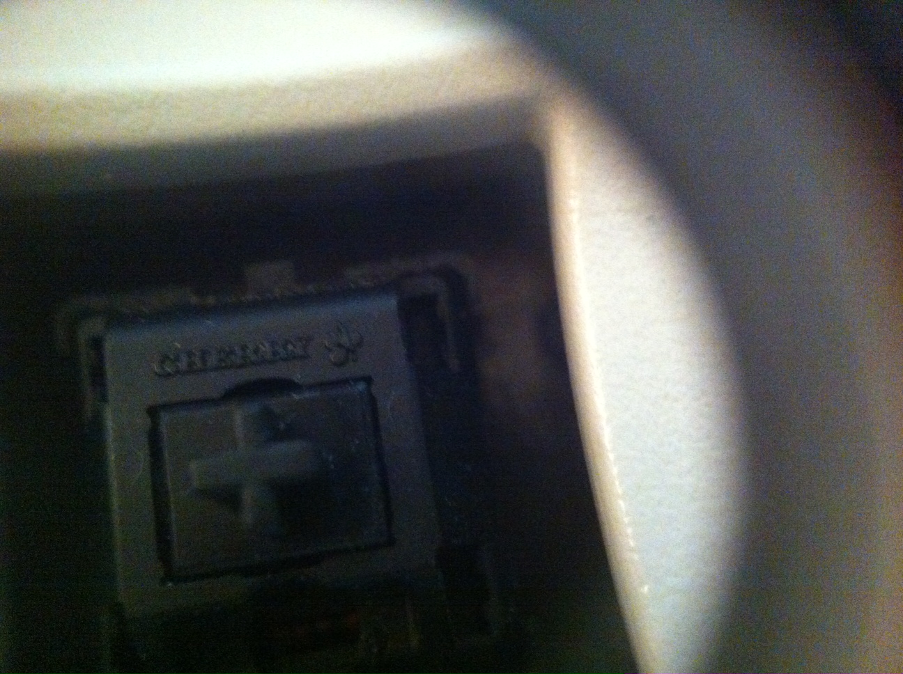

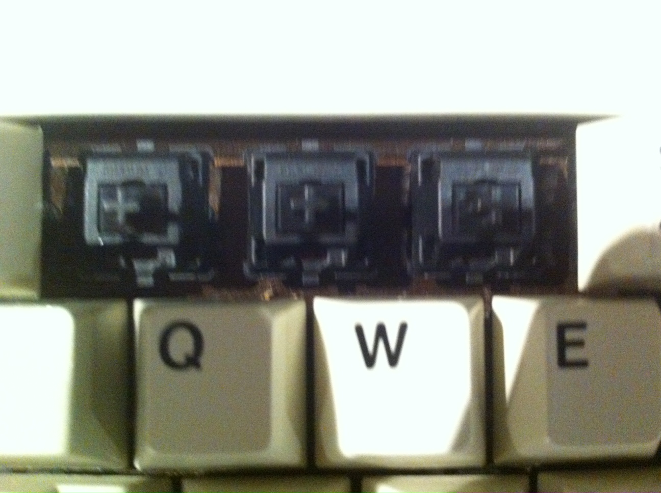

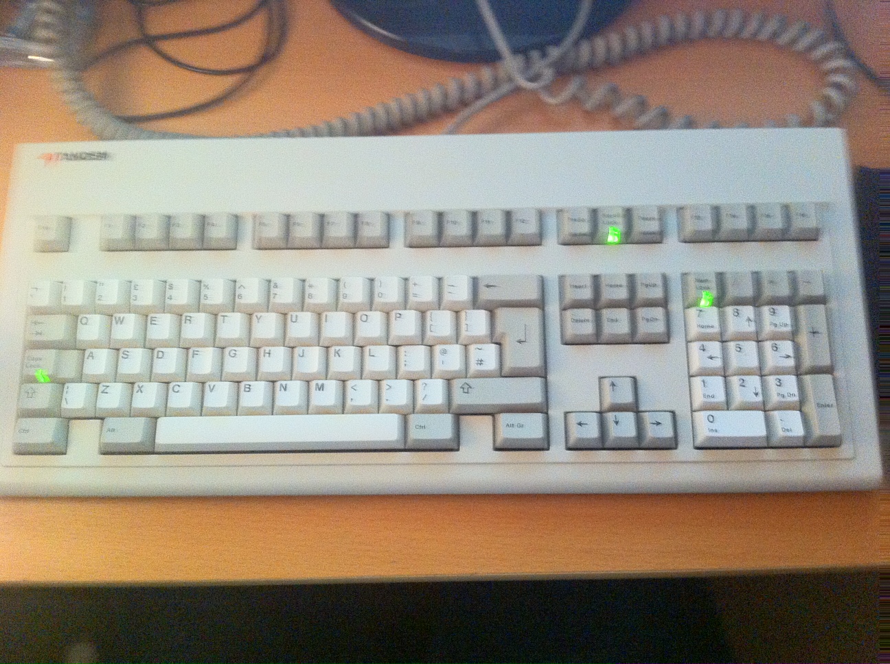

Ok quick update. Keycaps and case cleaned and dried. Space bar has a grey keyswitch (is this normal?). Also I've noticed some keycaps produce different noises depending on their keyboard location. If you like I can record some typing with my iphone so you can assess yourselves.
01 Aug 2014, 00:42
That's normal.

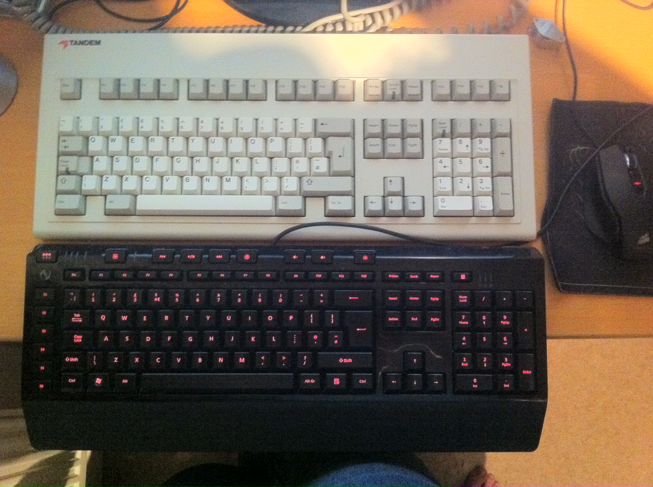

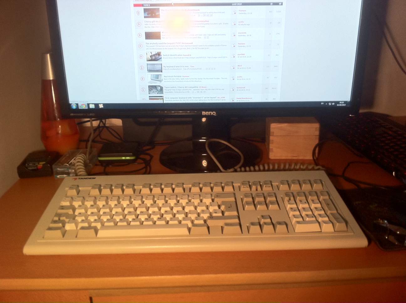

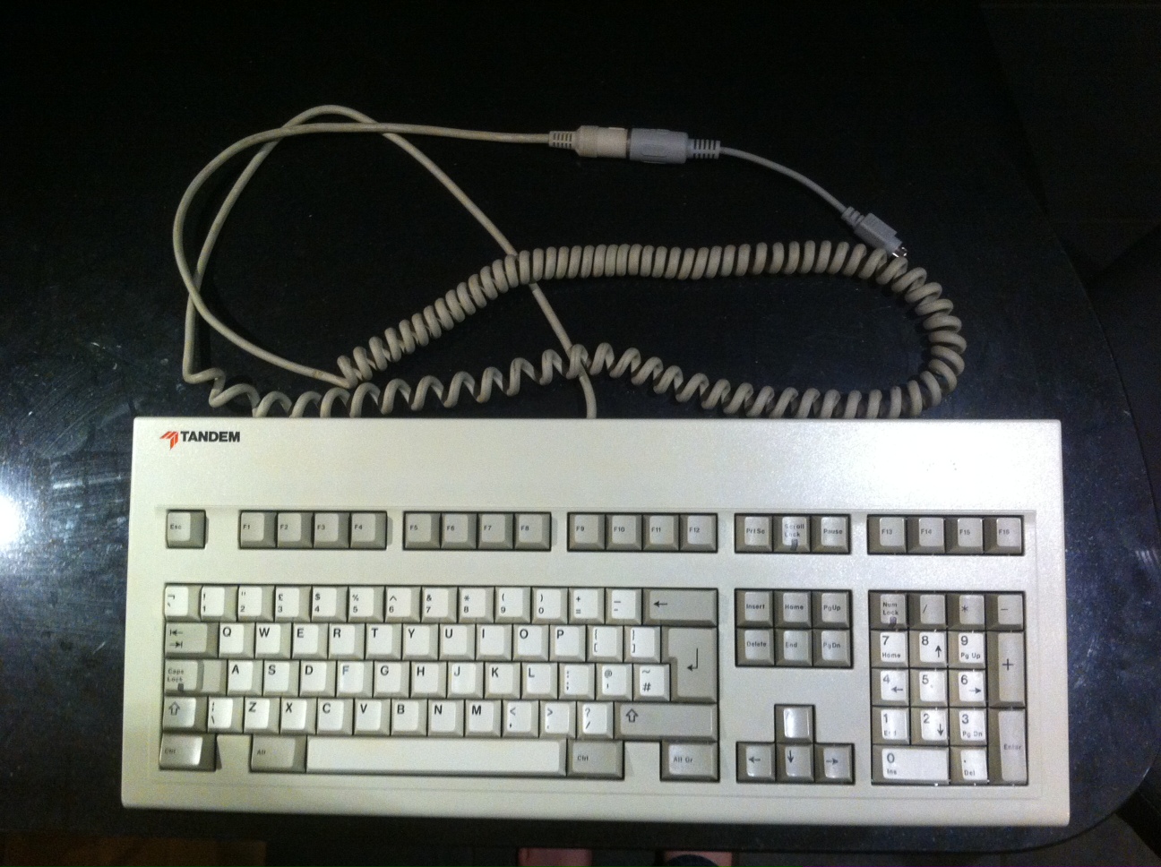

01 Aug 2014, 02:08
photo 2 (2).JPG (448.43 KiB) Viewed 15519 times
Ok here are the long awaited photos. Took me a while and sorry for the extremely low quality but my upload speed is a little slow.
Feel free to ask questions.
This probably wasn't the best way to show them, I'm new to forums in general.
Sidewinder x4 for comparison.

01 Aug 2014, 02:14
Looks good. The keycaps are (slightly shiny) UK ISO doubleshots - very nice. Looks like a pretty nice find.
The poor quality and small file-size is perfectly fine for me - the pictures all loaded instantly. :D Sometimes people post albums of gigantic ultra-sharp, ultra-detailed DSLR snaps and the page tends to jump up and down a lot as a result. Some people post images in
tags to avoid this, but in your case I don't think it's necessary due to the small file size.

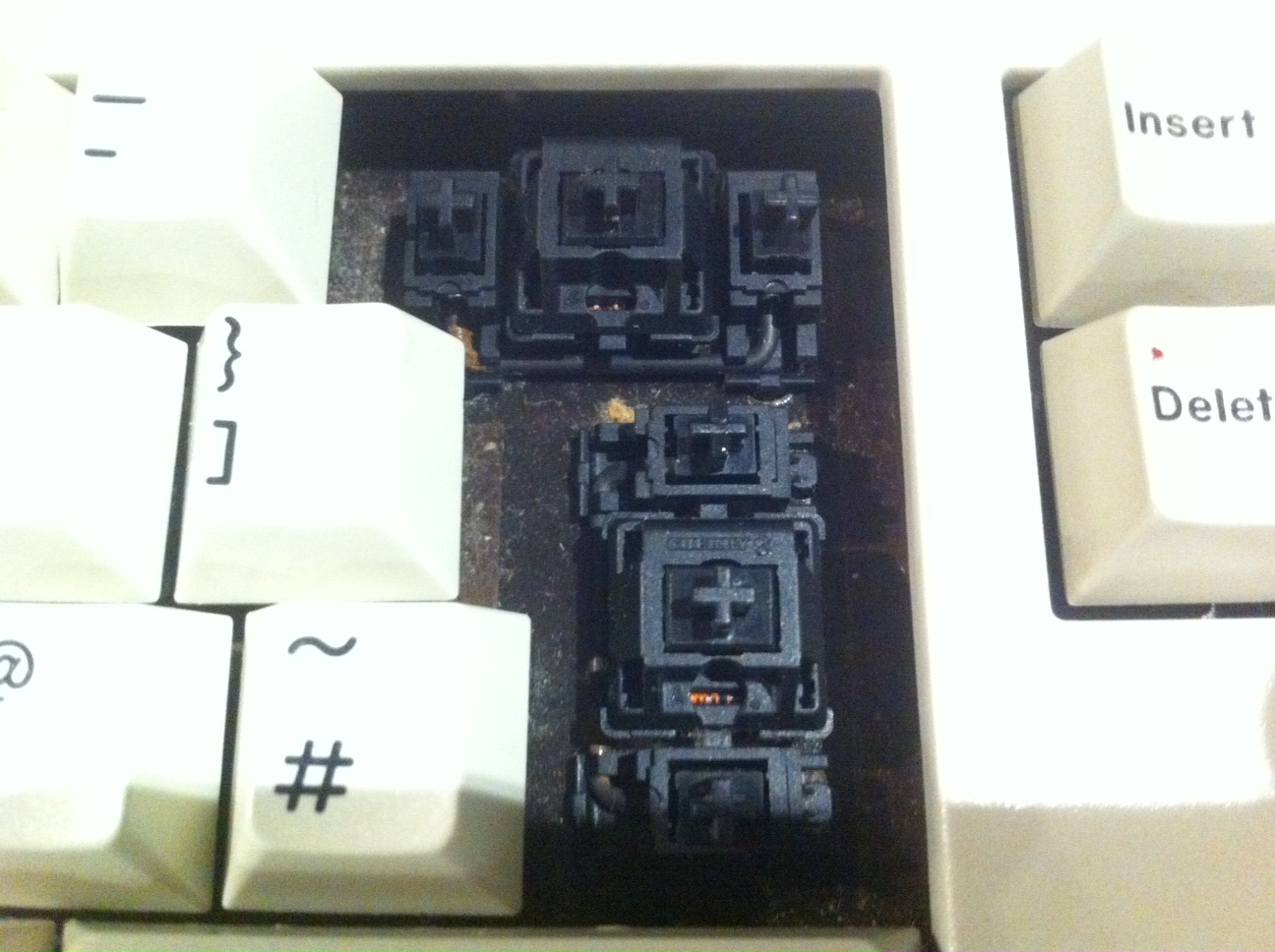

You can haz! For a price :P. I really have no idea what the price is other than what it says on taobao. Also can anyone confirm these are vintage switches? Hopefully they are. I will try upload a video tomorrow of the sound.

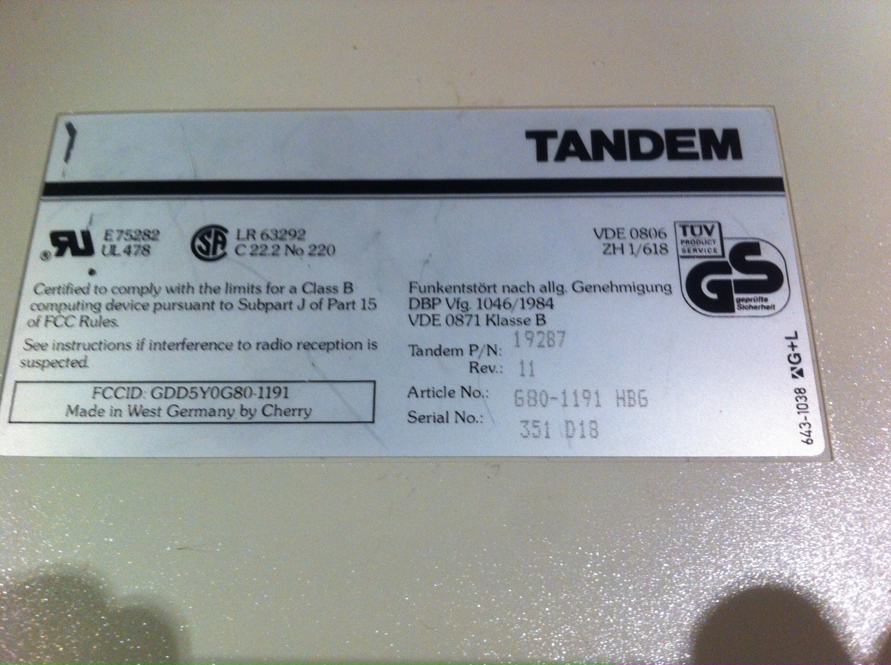

01 Aug 2014, 09:44
HBG? That would make it Cherry MX Brown PS/2.
