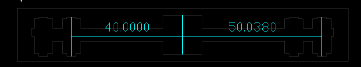

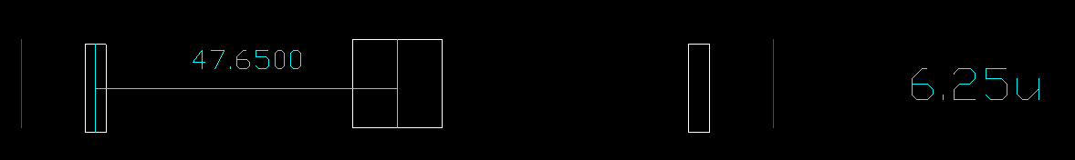

abjr
21 Jul 2014, 18:58
kapish wrote: I've uploaded the CAD file and video into my google drive
A question for you guys. Looking at the starter-kit.dwg, I was a bit confused by the 6.25u space bar stabilizer positions as I see differences for the 6.25u space bar throughout the file.
For example, the top section with the reference points has the offsets as 47.65mm:
while further down I see offsets as either 40mm or 50mm; such as:
Is the 47.65mm offset a mistake in that example?

kapish
23 Jul 2014, 13:51
The spacebar slot were actually designed for costar stabilizer, which doesnt requires much precision similar to cherry stabilizer. Should have stated that, sorry though.
