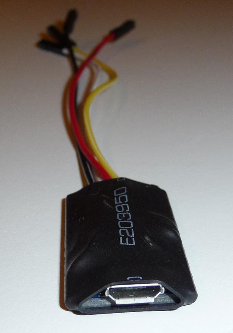

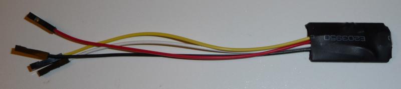

Here is how I build my Soarer's converters:
It is actually a Leonardo Pro Micro, and I cover it with heat shrink tubing so nothing can short out. I use wires that are the same colors as the IBM terminal wires; that way there is no risk of hooking it up wrong. Plus, the individual female socket leads allow me to connect it to either an XT or terminal controller. It has a micro-USB connector at the other end as compared to the mini-USB found on the Teensy.

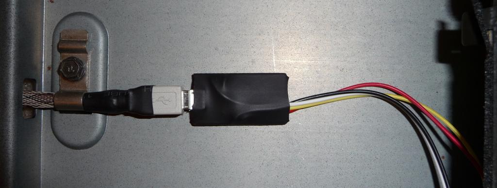

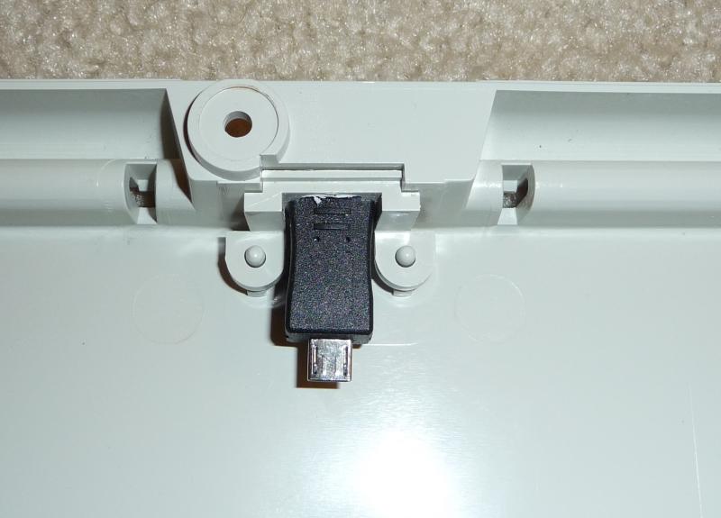

This is how I have it installed in my F-122s:

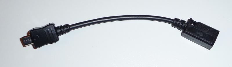

I have a USB extension cable connected to the PC, so I don't really need to have the keyboard's cable be detachable. However, there are a couple of ways that I have made it detachable. First off, there are these little pigtail adapters you can get:
This has a male micro-USB on one end and a female mini-USB on the other. The micro end goes inside and gets clamped down just like before; the mini end hangs out the back.

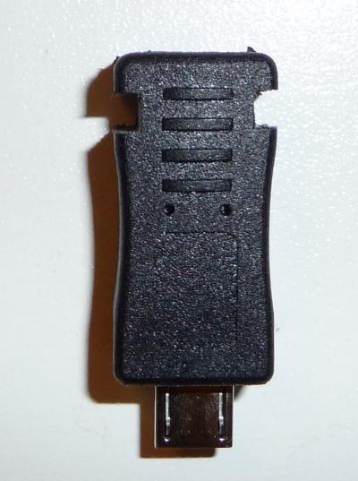

Here is another option. This is a solid mini-to-micro adapter that I've cut some slots in.
It fits under the clamp found in Model Ms that come with non-detachable cables.
It makes for a custom, built-in look.

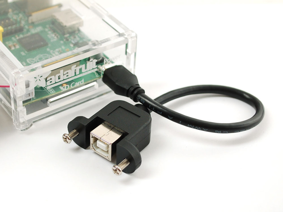

There are also panel-mount solutions like this one:
The Teensy (or other circuit board) can be enclosed in a box as shown or enclosed in shrink wrap. The short cable provides strain relief between the Teensy and the external connector. A USB B connector is shown, but it should be possible to find other types, such as micro USB.

Quantalume's solid adapter looks like a winner, thanks for the pictures! Does the Teensy / clone fit nicely right on the end of it? If so, that's a hell of a lot more convenient than what I've considered so far. A link to the appropriate adapter would be most useful.

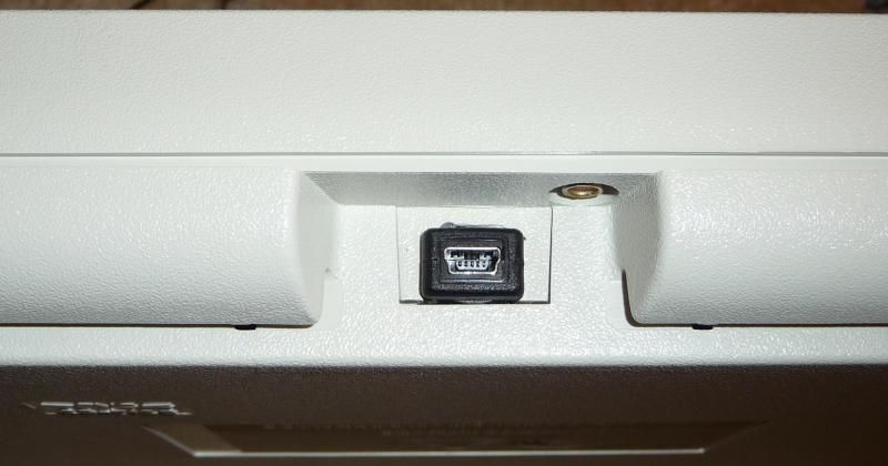

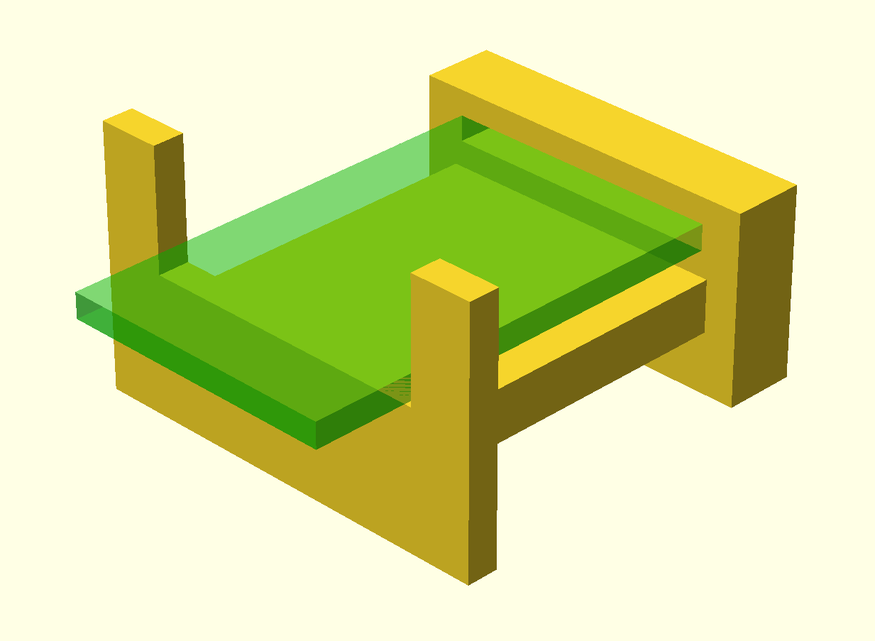

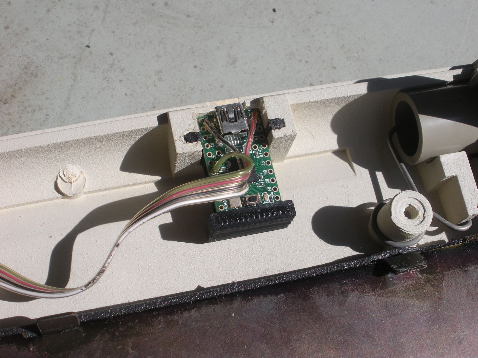

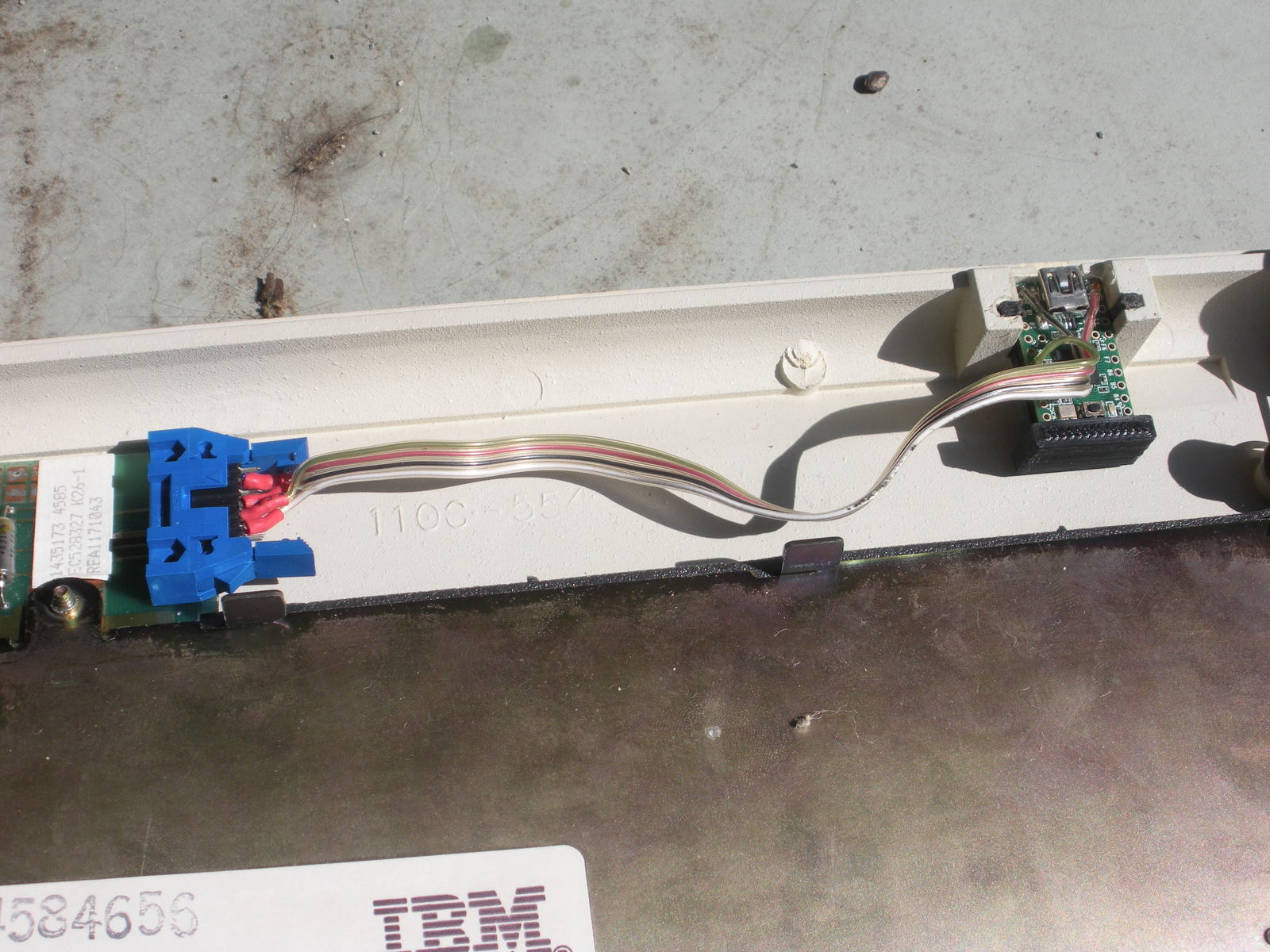

I had my Teensy mounted in my XT model F for a while. I put it between the pieces that held the original strain relief block in place and put enough hot glue around it to keep the board from moving at all. It worked wonderfully for about a year, but one day it cracked and broke. My new mounting solution is a 3D printed bracket that slides into the same place and holds the board by its back row of pads. Everything fits very tightly, which is great until I have to disassemble it some day.
Rendering of the Teensy mount:
Photo of the modifications:
Close-up of the mounted Teensy:

Nice work! However, I get nervous about connecting the detachable cable directly to the mini-USB receptacle on the Teensy. I think I will go for a solution that puts a strain-relief cable in between the Teensy and a panel-mount connector on the keyboard case. That way, if the case-mounted connector breaks or wears out, it could easily be replaced. All this aside, it is great to see people using 3D printing technology.
28 May 2014, 17:50
Smart stuff, Ratfink. RJ's got a point about strain relief, but your approach is so elegant I'm tempted either way. I must fire up a 3D printer someday.

Here's a link to the mini-to-micro adapter: http://www.ebay.com/itm/350927784352. You'll find that nobody makes a mini-to-mini adapter (why would they?), so that is what steered me to the Leonardo Pro Micro, in addition to the more favorable price. And yes, it slides on the end and seems to stay firmly in place.
Ratfink, did you have to make any modifications to the XT case? Preserving the original cable and avoiding modification of the case have been overriding considerations in all of my USB conversions.
Ratfink
28 May 2014, 18:54
I had to file the original cable hole slightly larger, but other than that there were no modifications made to the case. I haven't actually tried this, but it looks like if I were to put the original cable back in place, the larger hole wouldn't be noticeable at all.

I like the panel-mount connector cables apparently designed for Teensy (and similar circuit boards); more's the pity they do not seem to come with a panel-mount micro USB.
I guess I might go with a home-made panel mount using a micro USB cable fitted into a grommet.
