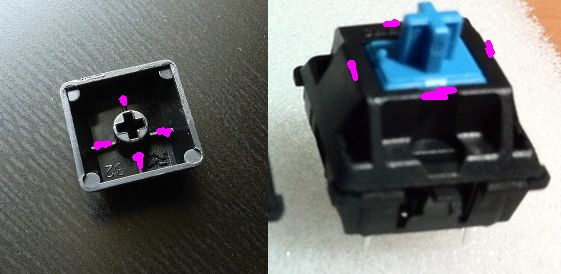

Hi! Am I correct that the "clack" sound is from the contact of the spots I've marked violet?
What if these spots on the switch are cut out, what happens then?

Nope, the keycap will not touch anything on the switch other than the stem it sits on... or it shouldn't. The exception is when O-rings is used, but then it's technically not the keycap that is touching the switch.
It's the stem that's making the noise when it hits the bottom of the switch housing. It actually also makes a sound on the upstroke when it hits the top of the switch housing.
Also, mind different keycaps makes the sound produced in the switch, be it bottom out or click from a blue/green/white, sound different. The case also makes a different, as well as the plate (if any).

Eszett wrote:Hi! Am I correct that the "clack" sound is from the contact of the spots I've marked violet?
I would suggest you give it a try yourself and tell us the answer :lol:

Broadmonkey, I can't believe ... When I remove the keycap and bottom the stem out by pressing with my finger, it makes a different sound (more muted, lower, softer).

The stem hits the bottom of the switch in the marked red areas:
http://www.kbdmania.net/xe/best_article/3354636
Hence the idea from the above link, to make the stem land first on an elastic surface, in the middle.
The bottom-hit sound is amplified by the keycap (acoustic shape) ... which you don't have, when you press the stem directly with your finger.

@Laser that means the keycap is a resonating body, and o-rings are like a cushion dampening the sound waves (vibrations), but not for the actual impact?

The O-ring limits the maximum stem travel, so that *with the O-ring only*, the stem doesn't hit the bottom of the switch, because the O-ring hits the top of the switch, *first*. The "impact" is moved. I.e., with O-rings, you can't bottom out, you will "top out" first.

I see. But the sharp impact sound is not there when bottoming out the stem without keycap. That is strange.

As Laser said earlier, the shape of the cap amplifies the noise. What you're doing by removing the cap and pressing it is similar to someone plucking the string of an acoustic guitar without a body.

Also, your finger body is elastic, and if you press directly the cherry stem, you have a small contact surface. The stem pushes against your finger over a small surface => high local pressure. This means the stem first goes "into" your finger, dampening the starting speed. Thus a lower speed is reached when you bottom out, the hit is weaker, so - no sound.
If you push the stem with the end of a pencil (bigger contact surface), you'll also get a better bottom out sound. A keycap has even larger contact surface, AND a resonating body.

Quite right. True objectivity requires removing your hands from the experiment entirely.
The contact points on MX — the physical places where bottoming out and topping out occur — are inside the switch shell. You can damp the slider's base a bit as Jmneuv has done here:
http://deskthority.net/photos-videos-f8 ... t6118.html
He sent me a good few of those little discs to try out, which I need to do when I build a new MX custom.
As for "topping out" (the sound your board makes when you release a key and it snaps back to the top, and which is the other half of the definition of clack, far as I'm concerned) MX's internal geometry makes that very hard to damp. Alps and Topre each have switch models with just such dampers, but no one's managed to achieve it on MX, yet.
Anyway, think of caps as amplifiers rather than sources of the noise. The true source is inside the switches.
