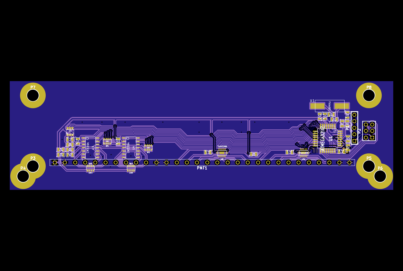

OK have a bit of a pickle here.
Have done the layout; however as you can see from the picture we have a lot of wasted space.
I've added the mounting holes for what I'll refer to as the `standard' Model F controller (what's in my PC-AT and 122-key terminal anyway). This leads to a chunk of wasted space on the bottom and sides. Could live with that, as we've got to mount the sucker somehow.
However, in adding mounting holes as per the smaller Kishsaver controller, we have now have wasted space on the top too.
The end result is a board 149.5mm x 42.5mm. A bit portly, and about twice the price per board from OSHPark compared to the beamsprings.
It's still smaller than the original controllers, but I don't like it.
The alternative I suppose is to have two separate boards, one for a Kishsaver, and one for a standard Model F, which only differ by mounting pattern. Or have snap-off bits, and wear the extra manufacturing cost. Or... forgo mounting holes entirely and attach it just by the ribbon cable and some nice spongy double-sided tape-foam...?

OK so I dropped the mounting points. I added three of my own around the edge of the board; one will need a cable from it to chassis GND, as per the beamspring controllers.
If it won't mount sit nicely mounted by the ribbon (and maybe foam tape) alone, I'll have to fab up a steel bracket or two.

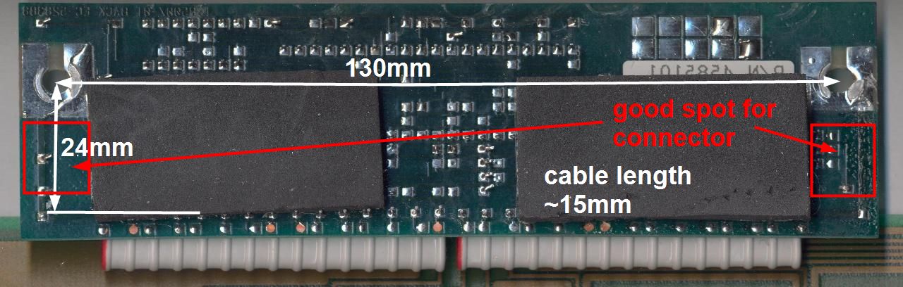

from my KS. i marked what i would think would be good spots for USB connector (either top or bottom would work). the 8 rows side would be closer to the stock cable exit and should work great with a strait or right angle USB cable. the 16 column side would be near the middle of the case so would require a longer cable if you wanted to route it out the stock cable exit.
mount holes are 130mm center to center. the ribbon cable connector is centered between the mount holes 24mm below. the ribbon cable length is tough to measure, but seems to be close to 15mm in length. the entire 13mm square around the mount holes should probably be considered keep-out zones on both sides.

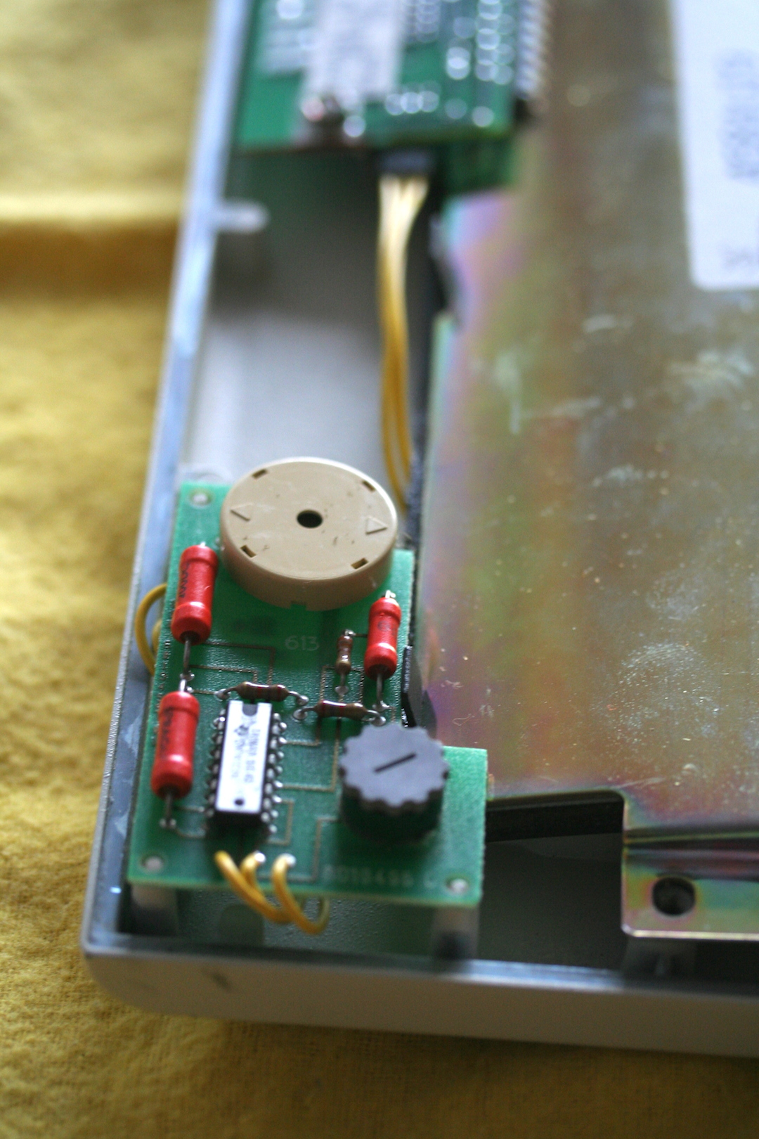

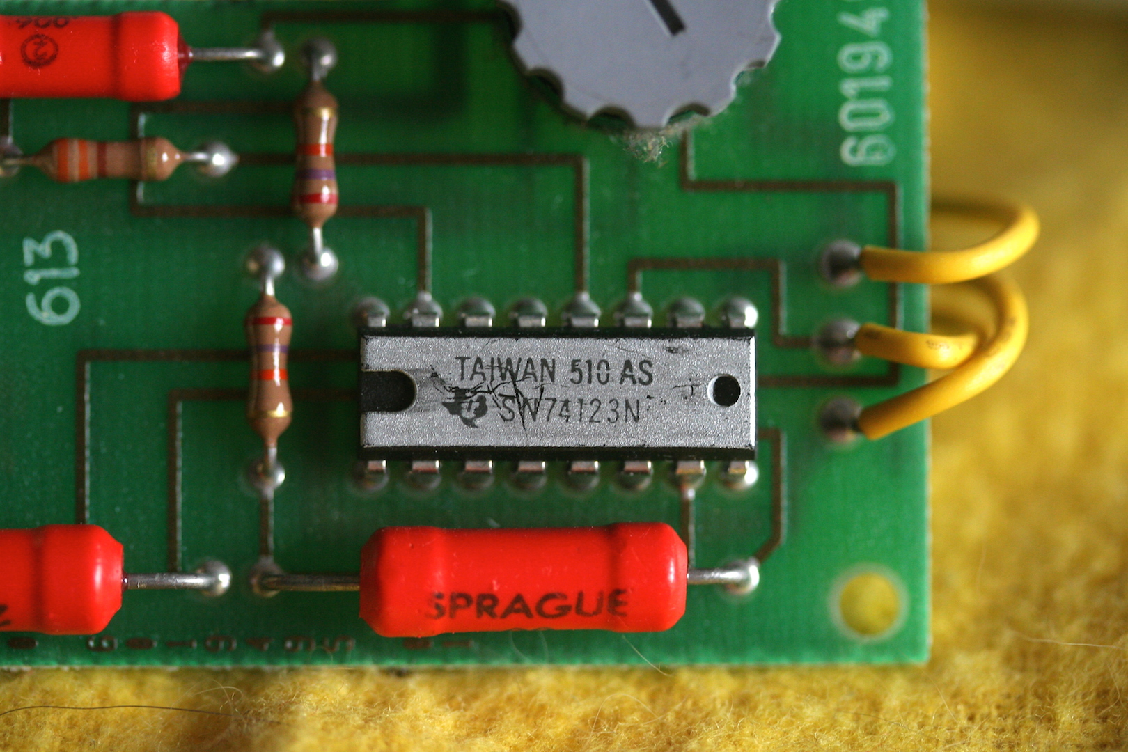

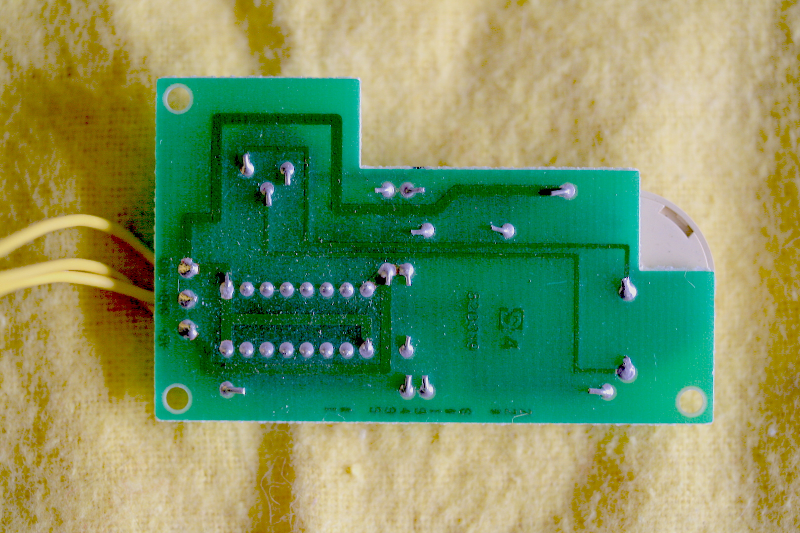

Since I've not seen much made of the Kishsaver's little beeper daughterboard, I took some pictures for the details today. This is part of my cunning plan to get Xwhatsit to support it, like he does the beam spring solenoids!
Kishsaver Beeper Installed.JPG (760.42 KiB) Viewed 10316 times
The dial lines up with a hole on the underside of the Kish's metal case. For volume adjustment, I presume?

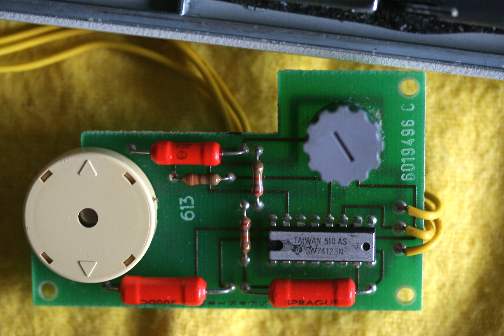

Kishsaver Beeper Top.JPG (776.61 KiB) Viewed 10316 times
Naturally, I named these pictures confusingly. The beeper board's dial goes downward, when the keyboard is assembled. The PCB's "underside" is then pointing up.
Kishsaver Beeper Bottom.JPG (970.04 KiB) Viewed 10316 times
Pretty simply laid out. Here's a gratuitous macro.
Kishsaver Beeper Detail.JPG (809.42 KiB) Viewed 10316 times

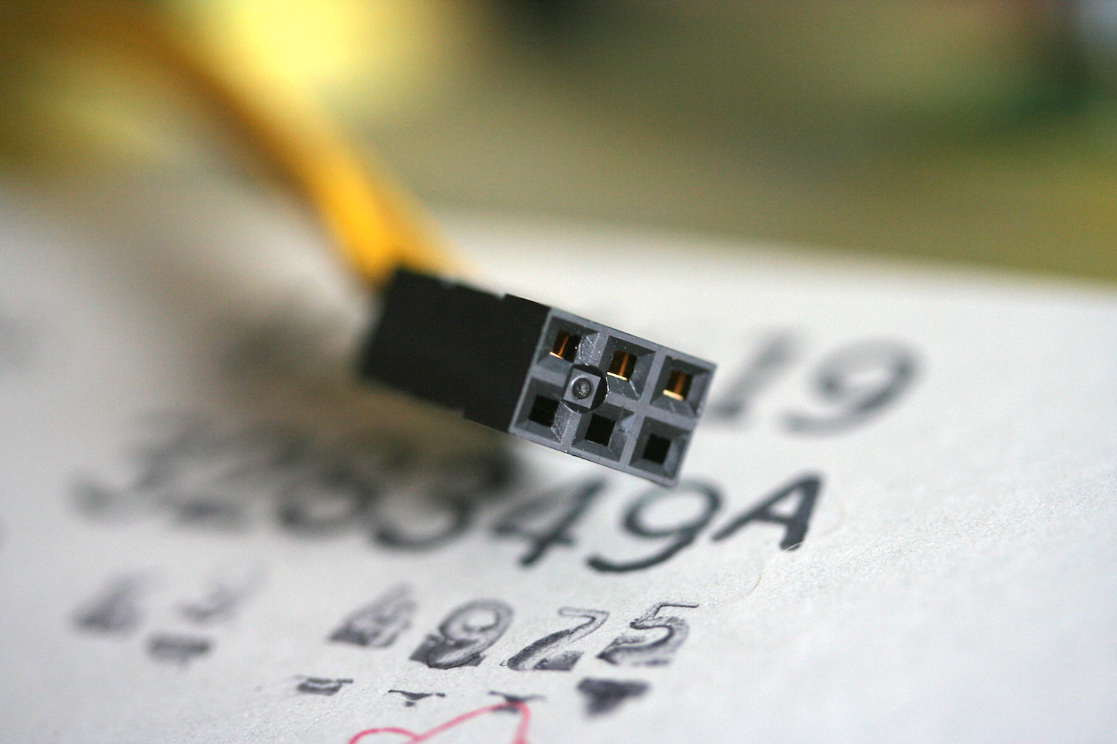

And the important bit, for a replacement controller's perspective.
Kishsaver Beeper Connector.JPG (847.19 KiB) Viewed 10316 times
Three populated pins. All yellow, but all easy to trace to the PCB.

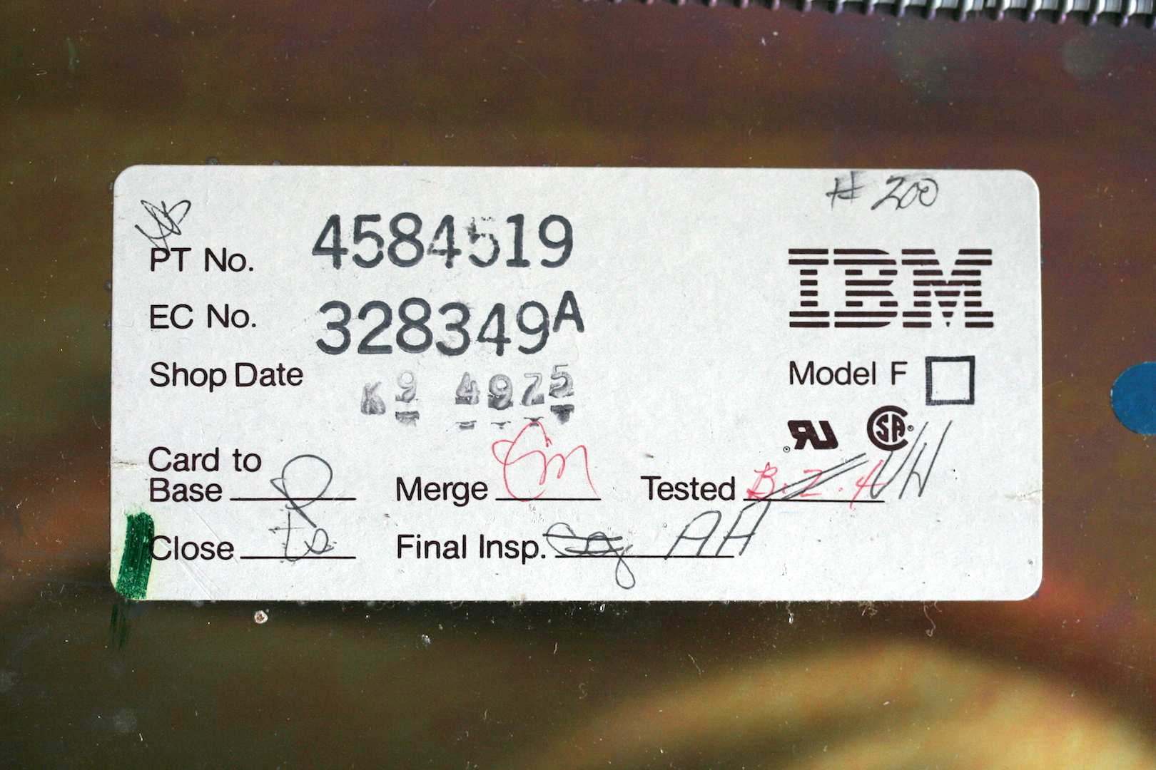

For what it's worth, my Kishsaver is the late (1986) model. Here's the plate label.
Kishsaver Plate Label.JPG (1001.67 KiB) Viewed 10316 times

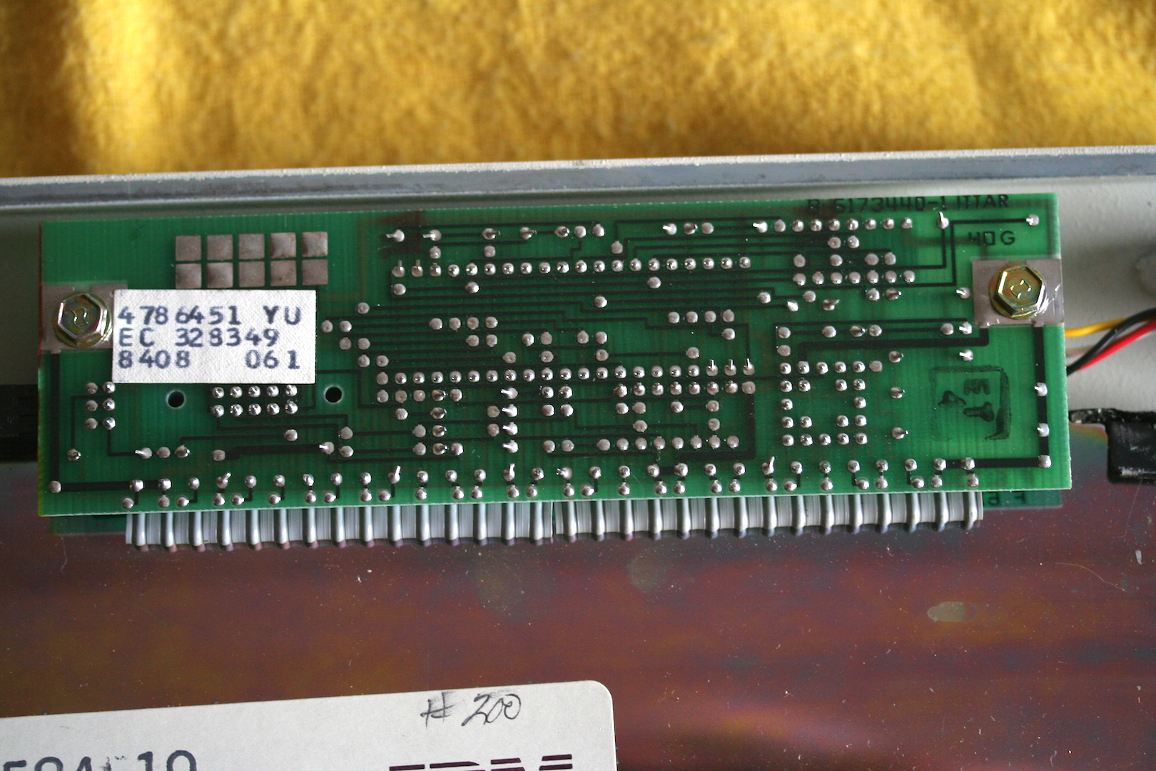

And the stock controller.
Stock Kishsaver Controller.JPG (907.43 KiB) Viewed 10316 times
The daughterboard's three pins are on the far left. There's a fair old bit of slack in its cable, so I wouldn't worry about moving the socket.

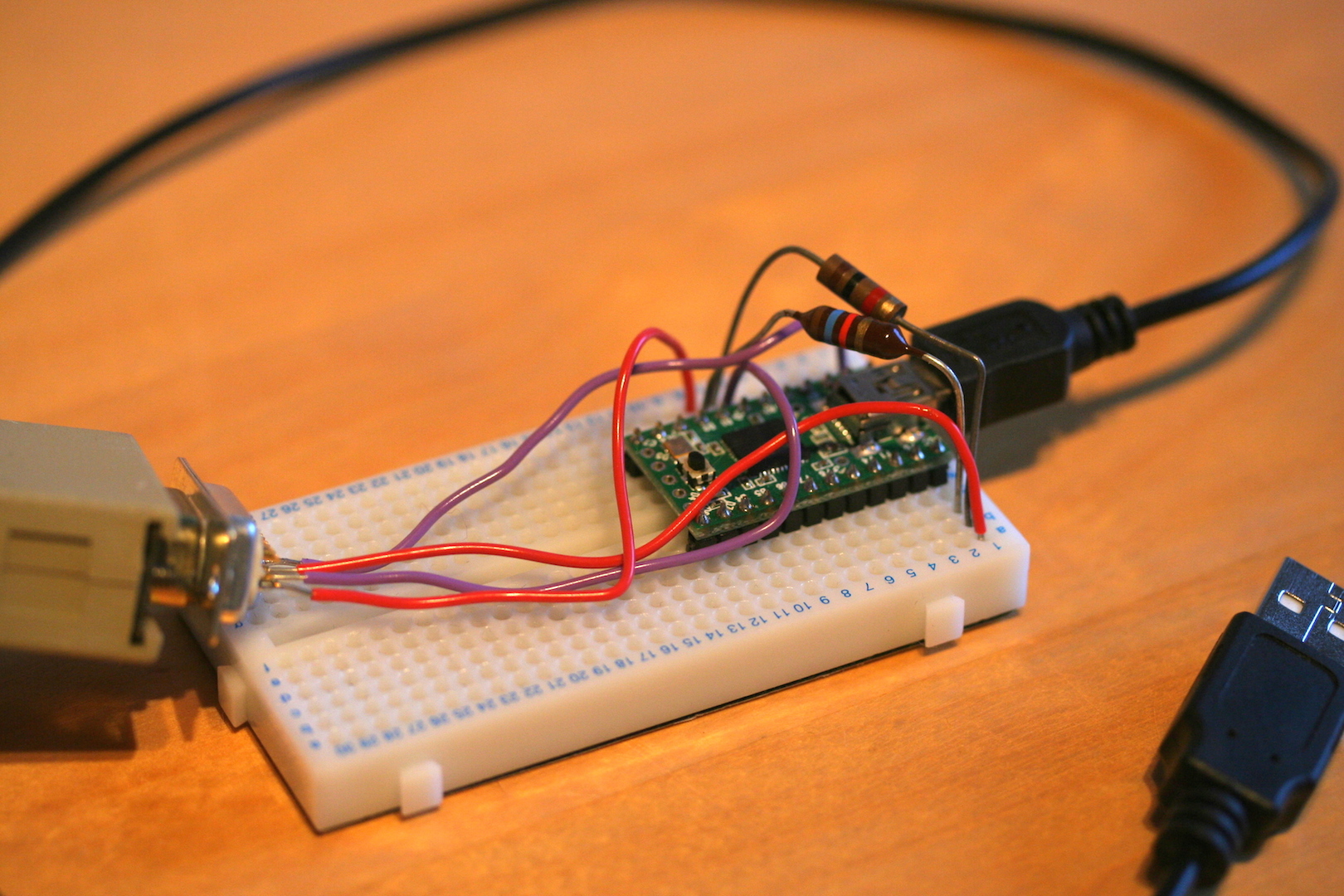

Had it up and running today with Hasu's proof-of-concept converter.
Hasu's Kishsaver Converter.jpg (843.68 KiB) Viewed 10316 times
Which reminded me the apostrophe and S keys needed fixed. So I also did my first chopstick trick. Actually a clipped down matchstick in my case. The springs came out quite nicely, and I popped in a couple of Model M spares. Apostrophe works perfectly. But S proved to be a pain in the jacksie. The pads work, as it registers if you move the spring yourself, but with either Model F or M springs attached it only seems to pick up 1 in 10 keystrokes; despite making appropriate clicks. Ho hum. I may have to open up the plate sandwich yet.

Looks like a piezo beeper I think, so I'm pretty sure it's only ever going to just beep annoyingly. The connector is a slight pain having all three pins on the bottom, as I have Vcc and GND at diagonal opposites. Might have to make a sort of adapter cable, or have the poor bastard wiring it up shift pins around in the connector.
Most likely that is a volume control; if the red things are capacitors (I can't tell) then it might be a sort of low-pass circuit. The 74123 is just a monostable, same as used in the beamsprings for the solenoid, to make it so you don't have to remember to turn off the `beep' signal in a particularly timely manner.
Can you identify which pin goes where? I think I can read `GND +OVR +5V' on the bottom of the board in the picture you posted. Which is which on the plug?
