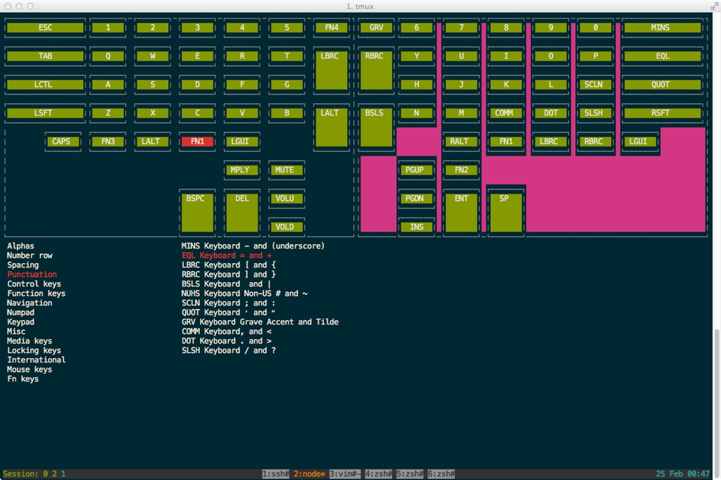

Programming via text editor on the computer is how Soarer's converter / controller already works. For instance, here's my (very much work in progress) config for that homemade 60% of mine I'm forever showing off. No Pn key required.

Yeah, i think we need to use program space to store the mappings which means compiling and programming is required...
AVR programmers and cross compilers are available on all platforms though, so maybe it would be possible to get somewhere along the line of the original idea, but instead of talking to the keyboard directly to do the mapping you'd have a little program that then compile and burn the firmware for you.
I've been tinkering with something like that for the tmk firmware, haven't had so much time for it lately but i plan to finish and share it sometime soon.

CJNE, that tool looks fantastic. I was thinking of writing something similar myself, but probably more on the level of $SOME_MARKUP_LANG --> outputs layout.h. Do I see that it's written in Node? :D

scottc wrote:CJNE, that tool looks fantastic. I was thinking of writing something similar myself, but probably more on the level of $SOME_MARKUP_LANG --> outputs layout.h. Do I see that it's written in Node? :D
Thanks :)
Yeah it's Node alright, trying to keep up with the trends 8-)
And it would be trivial to add on a web frontend instead of the curses one.
A markup parser that can output a C header file sounds like a nice idea!
Almost on topic, it would be nice if we could agree on a common markup for keymaps that could work across different firmwares, then have specific converters to make them into header files...
