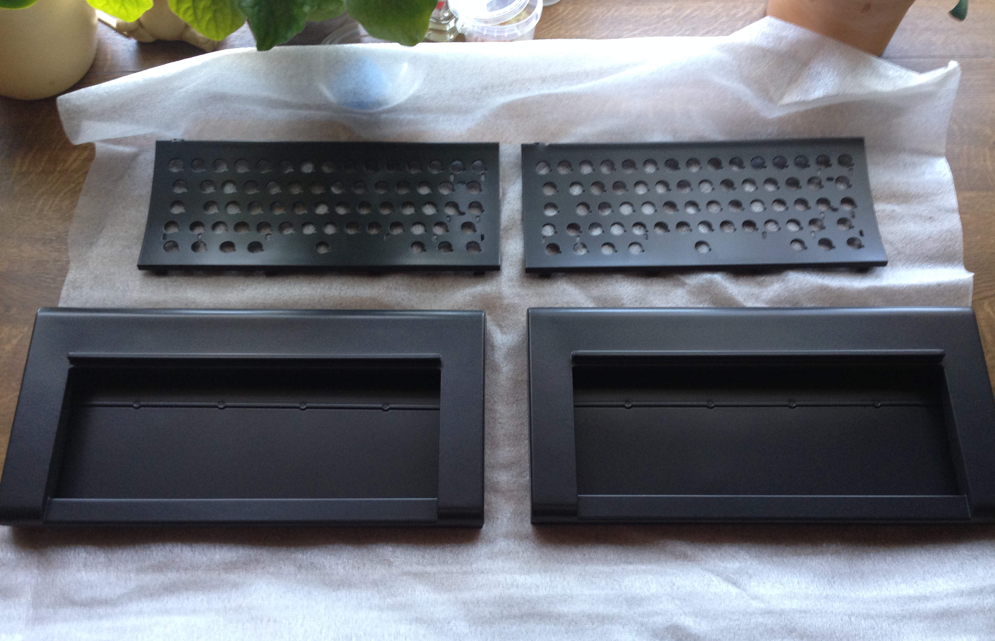

Work in progress...
Powdercoated in RAL 7021 (also known as Panzergrau or Wehrmachtsgrau) It's a very dark grey and looks awesome in real.
Kishsaver RAL 7021
Kishsaver RAL 7021

PAAANZER! haha, they will wreck all your other boards when they are finished ;)
16 Jul 2014, 21:41
Snoopy, I'll sell you my soul for your second kish...
30 Jul 2014, 17:37
I will sell you my soul and i will steal as many as you like and sell you them as well it looks amazing !
Grond
30 Jul 2014, 18:39
Dark grey looks badass!
