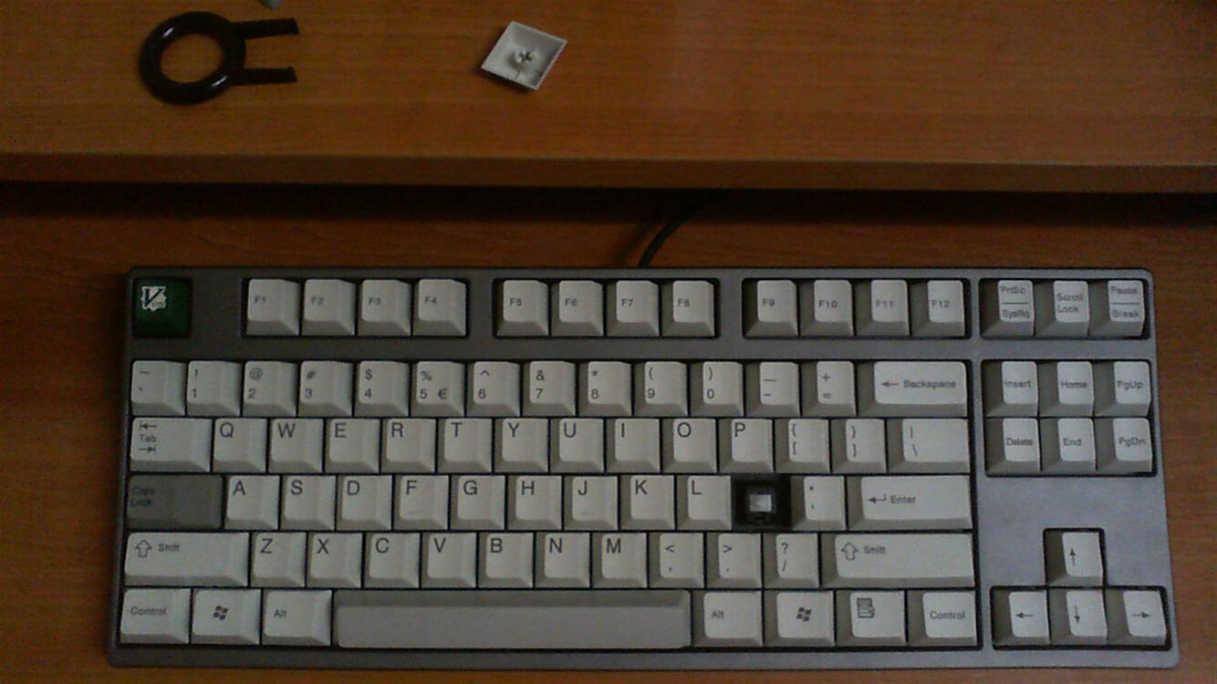

So, first i'll try it on a Ducky 1087C. Step 1, desoldering - done :)

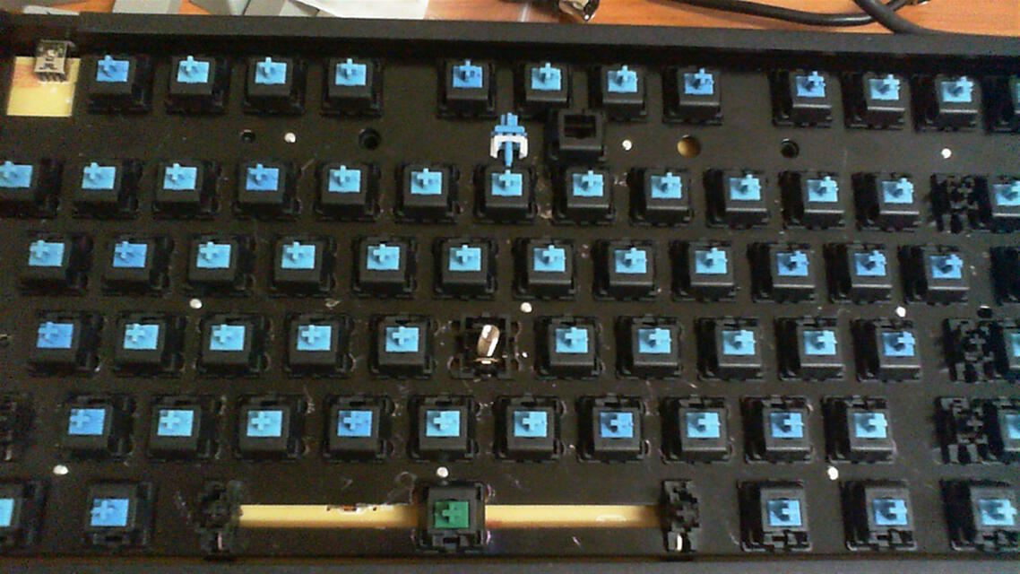

20 Feb 2014, 17:01

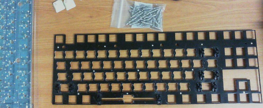

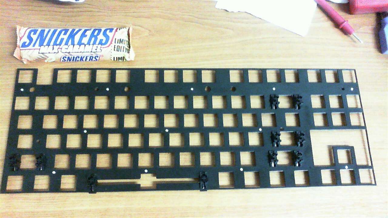

Step 2, "phanducky", done - plate doesn't look aesthetically TOO pleasing, but - it's functional:
I won't bother with the rest of the switch holes (modifiers and so on), since i intend to use non-clicky stems with black springs for those, no matter what the alphanumeric switches are.

Laser
emacs -nw
21 Feb 2014, 01:46
No problem discussing derived topics in the thread, it's flexible and i learn a lot of things from them :)
It took a while to mod the plate - because i used a portable multigrinder with accumulators - i had 3 sessions, each in a different day, of 1-1.5 hours each (batteries span), so in total - around 4 effective working hours. I used a diamond coated conical head ("bit" i see it's called). I understand that a better solution would have been to use a "reaming bit drill", but i had no access to such thing. And expect some muscle fever in you back (vibrations + not-your-everyday-moves to keep the holes uniform).

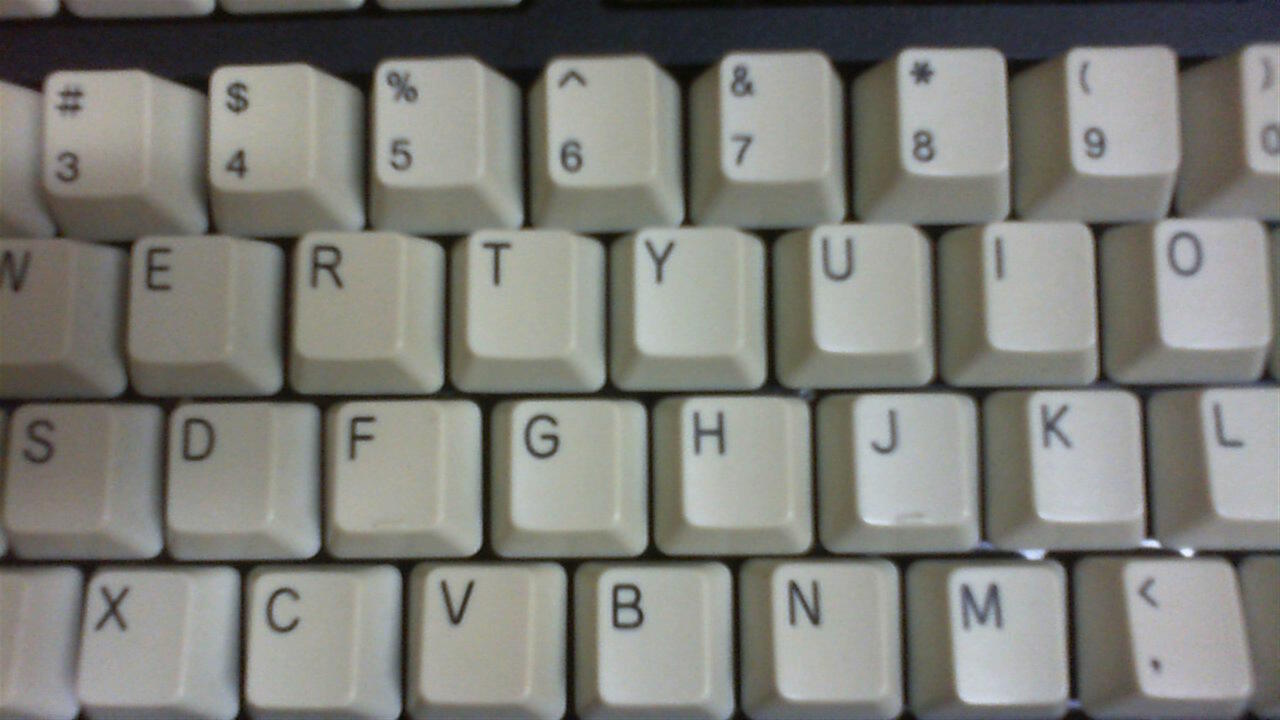

Meanwhile, i finished modding my other keyboard - i desoldered everything and mounted clear switches with springs from the original black cherries. I also took the (thin) PBT keycaps from a Cherry keyboard - can't believe how different they feel on a plate-mounted keyboard! I am very proud of the result: panda clears feel excellent, and the keycaps too :)
(and yes, i know the spacebar is upside down)
Laser
emacs -nw
24 Feb 2014, 19:15

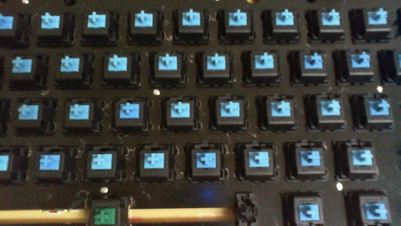

Ok, the post before the last one, coming back to the ducky, this is how it looks after soldering and testing that each key works. I won't remove all the top switches to test the holes, though :P
I decided to go for this keyboard with blue stems & 65g springs.

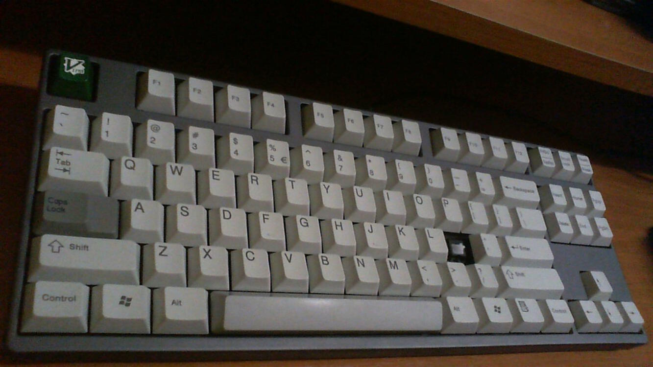

emacs -nw
26 Feb 2014, 23:54

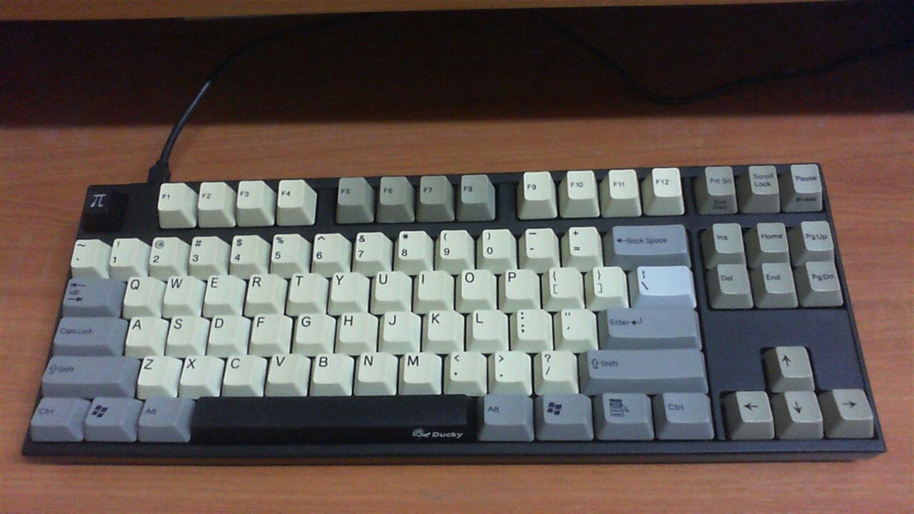

(For completion) Last step, completed keyboard with some mix of semi-matching new & old keycaps:
As you can see, the cutouts are sufficiently small not to be seen between the keycaps:
