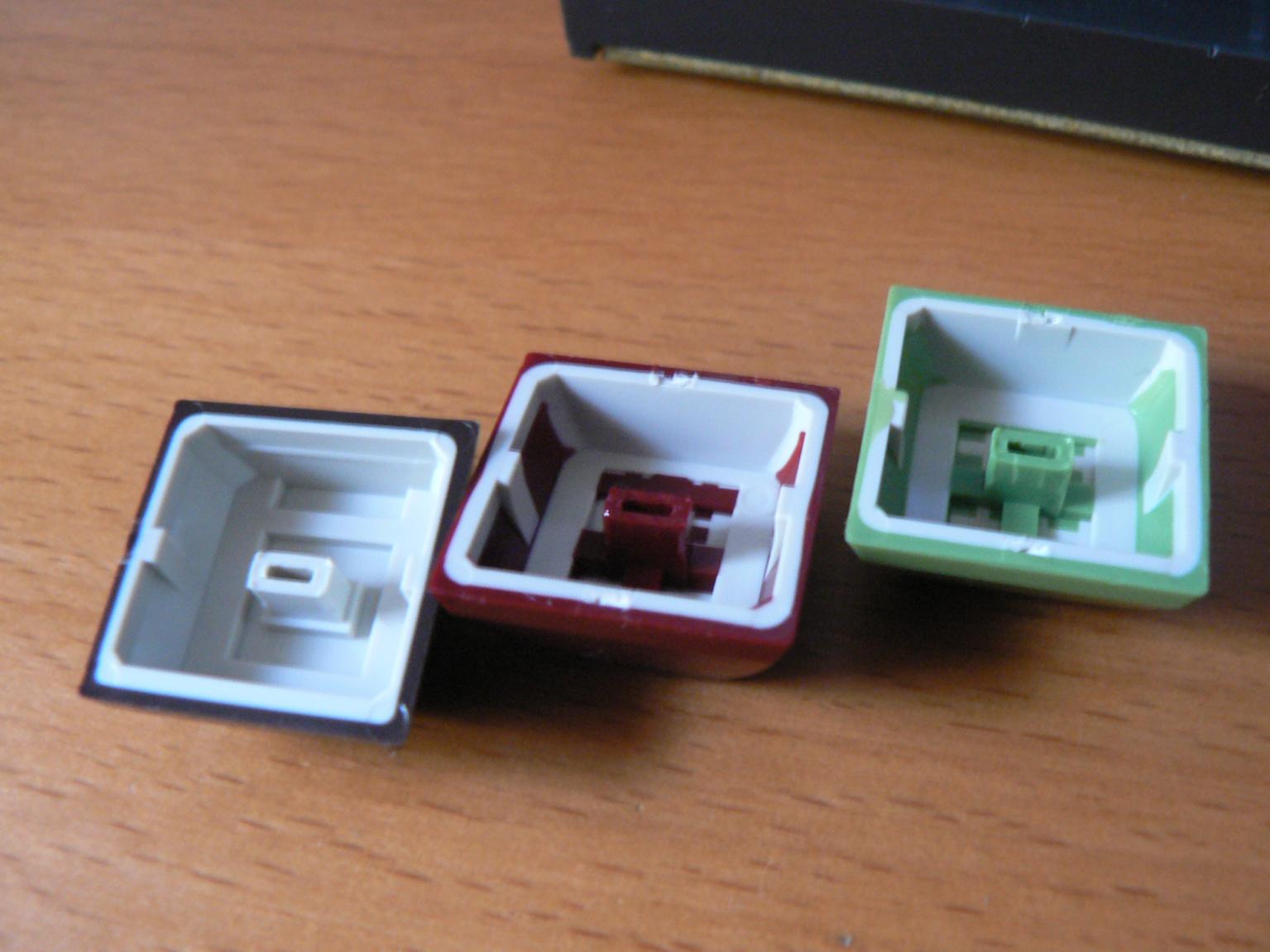

Adding my pics, so you have them in here as well:

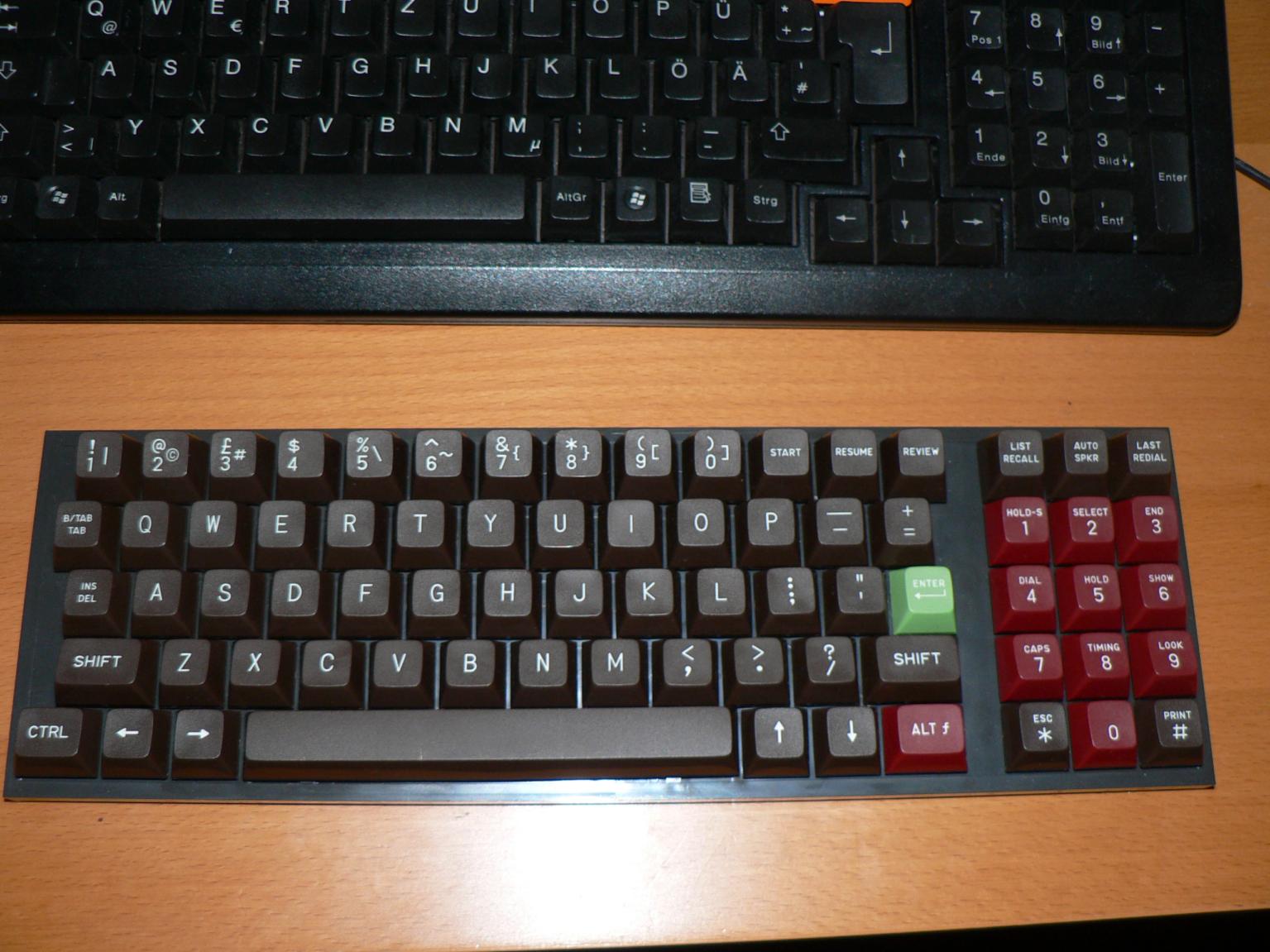

The machine is called a "One per Desk" or Computerphone
They were made in 1981-1984, more info on the machine can be found here:
http://www.classic-computers.org.nz/col ... rphone.htm
http://en.wikipedia.org/wiki/One_Per_Desk
24 Jan 2014, 23:30
Danke.
The weird thing is that the DSA Retro Set group buy was allegedly inspired by the Commodore 64, but I've never seen a C64 with those three colours.
However, the DSA Retro Set bears a striking resemblance to that Alps keyboard.
(That One Per Desk photo is funny — it's a colour screen showing a menu that's mostly the exact shade of green of a green screen, with a single line of red that looks Photoshopped as a result!)
24 Jan 2014, 23:36
Daniel Beardsmore wrote:The weird thing is that the DSA Retro Set group buy was allegedly inspired by the Commodore 64, but I've never seen a C64 with those three colours.
Exactly. No C=64 looked like that. But this obscure Kiwi board truly does. I wonder what Matt3o was up to when he picked those colours!

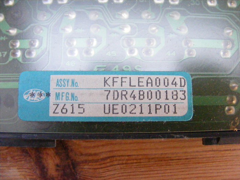

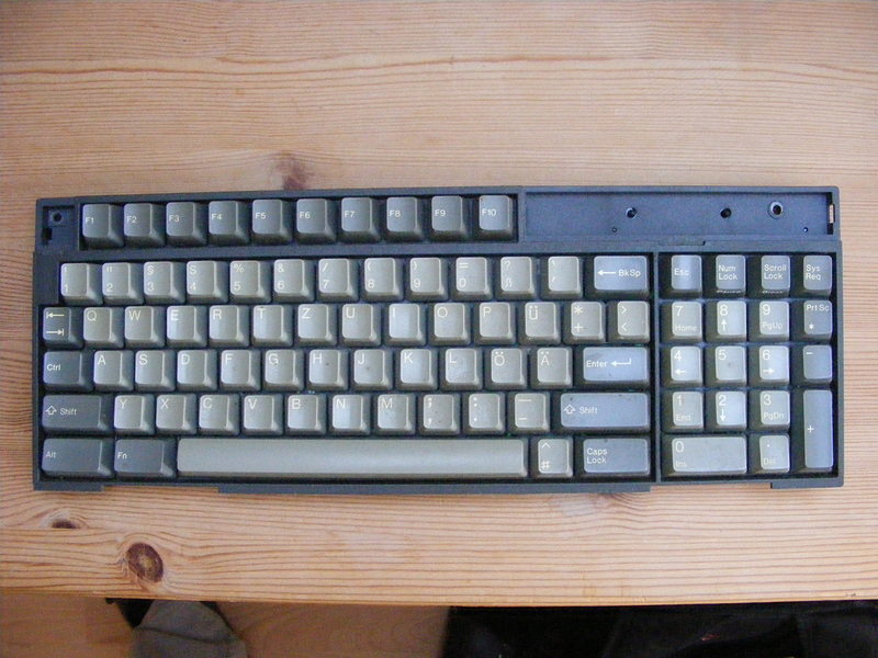

Here's the box for the localization key caps for a Toshiba T5200. Says Toshiba on it which probably doesn't mean anything:
And the pic that contains the assembly numers etc. for the T5200 keyboard:
http://img293.imageshack.us/img293/5767/t5200_08.jpg
29 Jan 2014, 22:27
The keyboard is made by Alps, with Alps switches, and that's the consistent thing: these keycaps only appear to be found on Alps-made keyboards.
