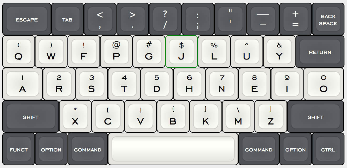

Here is my attempt at a design for a keyboard that is as small as possible, while maintaining the home row intact:
48 keys total, and aside from the legends all existing in SA except for the 2U spacebar.
Would it screw things up too much to have the A and O be 1.25U?
21 Jan 2014, 19:58
I'm not sure where you'd get the caps for them...
Maybe you could pull the 0.5U needed to accommodate those?
jpatters
21 Jan 2014, 20:05
All the caps exist in their row profiles for SA according to the Signature Plastics SA pdf, except for there is no convex 2U spacebar.
Actual constraints used in coming up with the design:
1) Home row intact
2) All alphabetic letters on their own key
3) Standard staggering
4) Rectangular
5) Spacebar on bottom middle (where the thumbs hit)
6) No key less than 1U
7) Existing keycaps
I started with Colemak, but moved the Z from the bottom left to the bottom right to satisfy rules 3, 4, and 6.
21 Jan 2014, 20:05
Very interesting little layout. It'd be easier to pull off as a straight matrix, instead of standard staggering. Being so different to type on anyway, I doubt the usual cautions about monkeying around with stagger actually apply.
I'd go for 4u space bar (the perfect one in SA) and sacrifice the double set of mods.
21 Jan 2014, 20:09
jpatters wrote:All the caps exist in their row profiles for SA according to the Signature Plastics SA pdf, except for there is no convex 2U spacebar.
Oh cool, I would've thought that the A and O in 1.25U wouldn't. Nice one!

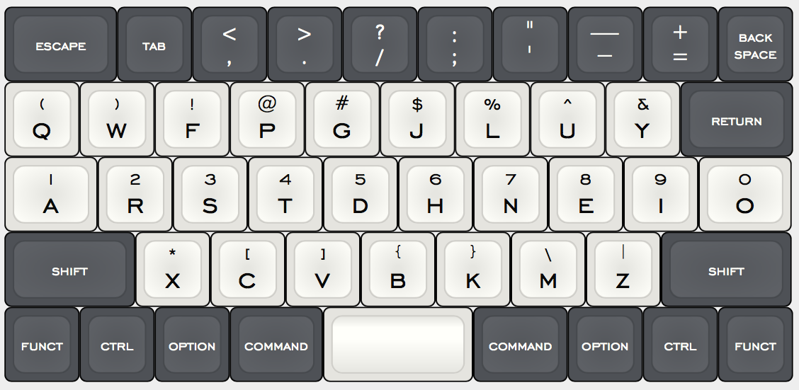

Following Muirium's suggestion:
NANOBOARD 4U SPACE.png (276.49 KiB) Viewed 6884 times
21 Jan 2014, 20:18
A sweet little board like that might even make me learn Colemak! I tried Dvorak once, but the temptation of doing so on a QWERTY keyboard put me off before I really adapted.

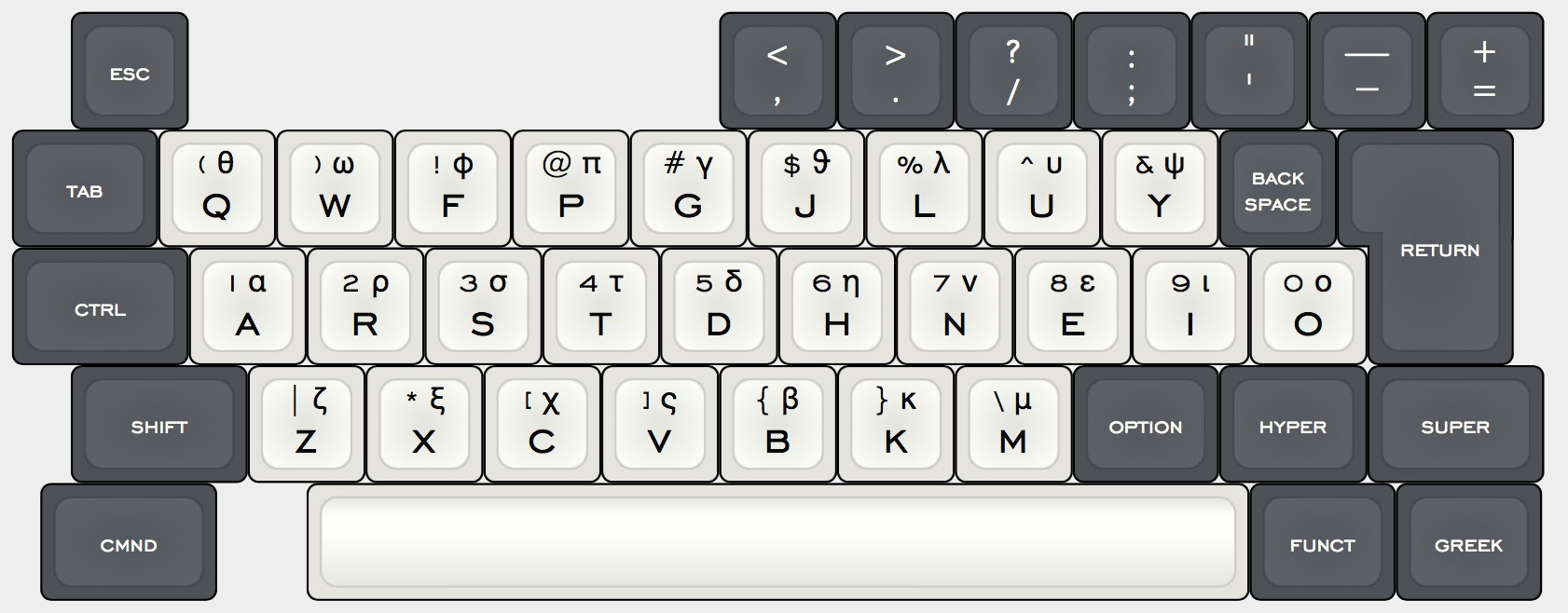

I just can't stop with two stepped keys, here we go again, now with off center hat keys! In row 4! Five new molds! Think enough people would want this to justify $20,000 to $25,000 (I'm guessing) in tooling costs?
NANOBOARD HAT KEYS.png (333.31 KiB) Viewed 6855 times

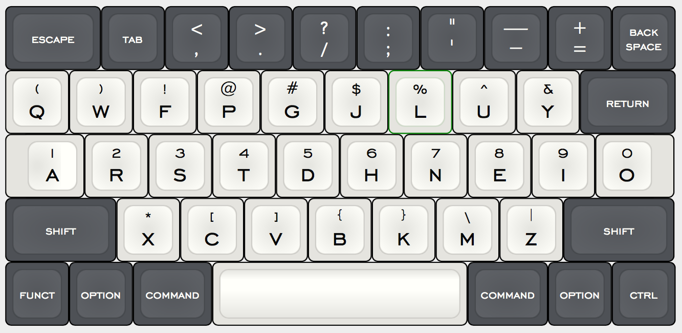

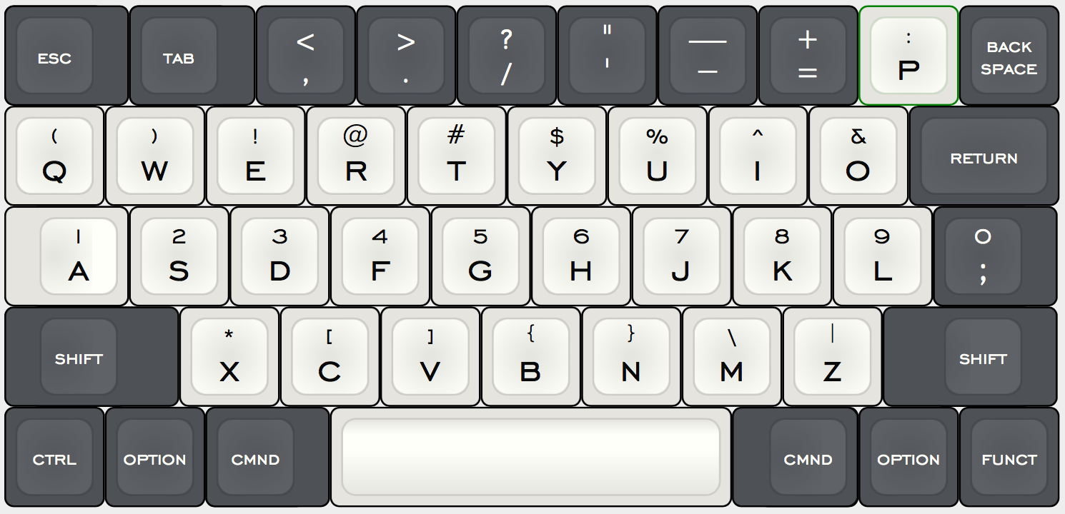

Oh, and here is a QWERTY version, just to show how mangled that would have to be:
NANOBOARD QWERTY.png (314.65 KiB) Viewed 6849 times

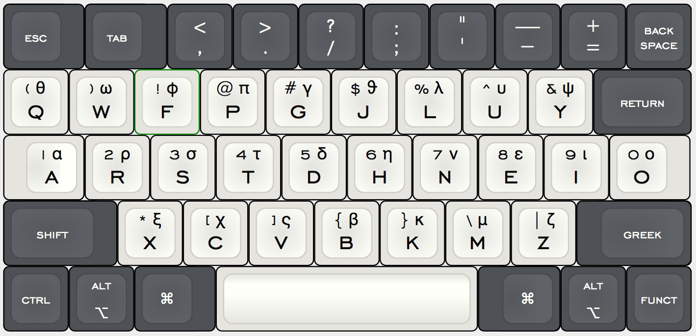

Now with greek legends!
NANOBOARD GREEK.png (309.82 KiB) Viewed 6838 times
21 Jan 2014, 21:54
I like that ⌘ and ⌥ appear, now we're talking Greek! For the complete symbolic look, you'll want ⌃ for Control and ⌫ for Backspace. These have all appeared on Apple's keyboards over the years, in ISO land at least. They were also using ⎋ for Escape in software back in the Tiger era, but have since abandoned it. Probably because it looks so damn similar to the much more recognised power symbol, which oddly enough isn't so recognisable in Unicode.
http://blog.elliottcable.name/posts/use ... code.xhtml
If you ever commission a set of Greek legend caps, tell me. I'd take them shared with Latin alphas or even whole Greek. All the better to learn the alphabet!

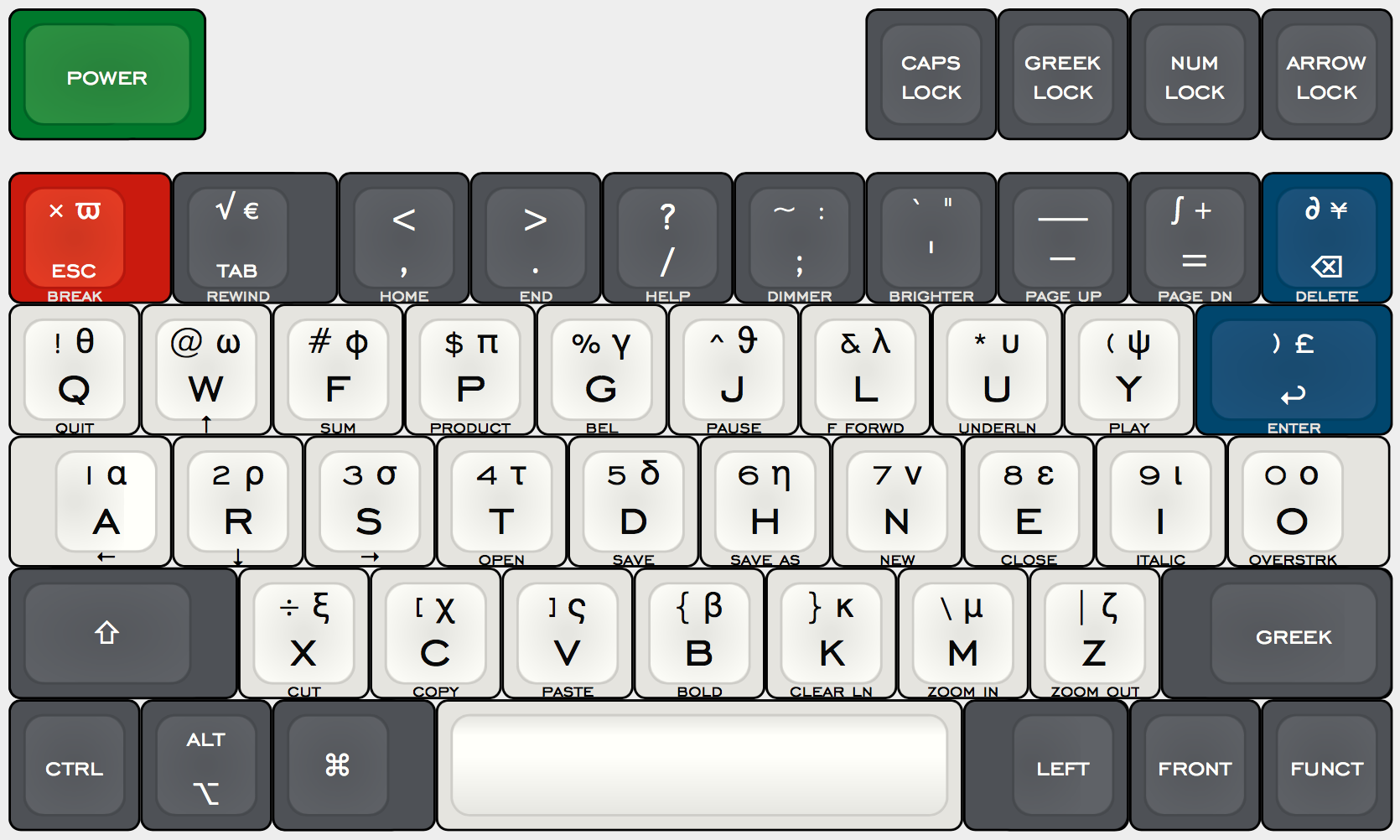

Now with front legends, and an added row which would only be for if there was a version integrated with something like a Raspberry Pi.
NANOBOARD FRONT LEGENDS.png (391.73 KiB) Viewed 6663 times
That symbol on the Greek layer on the ESC key is an alternative lowercase Pi.

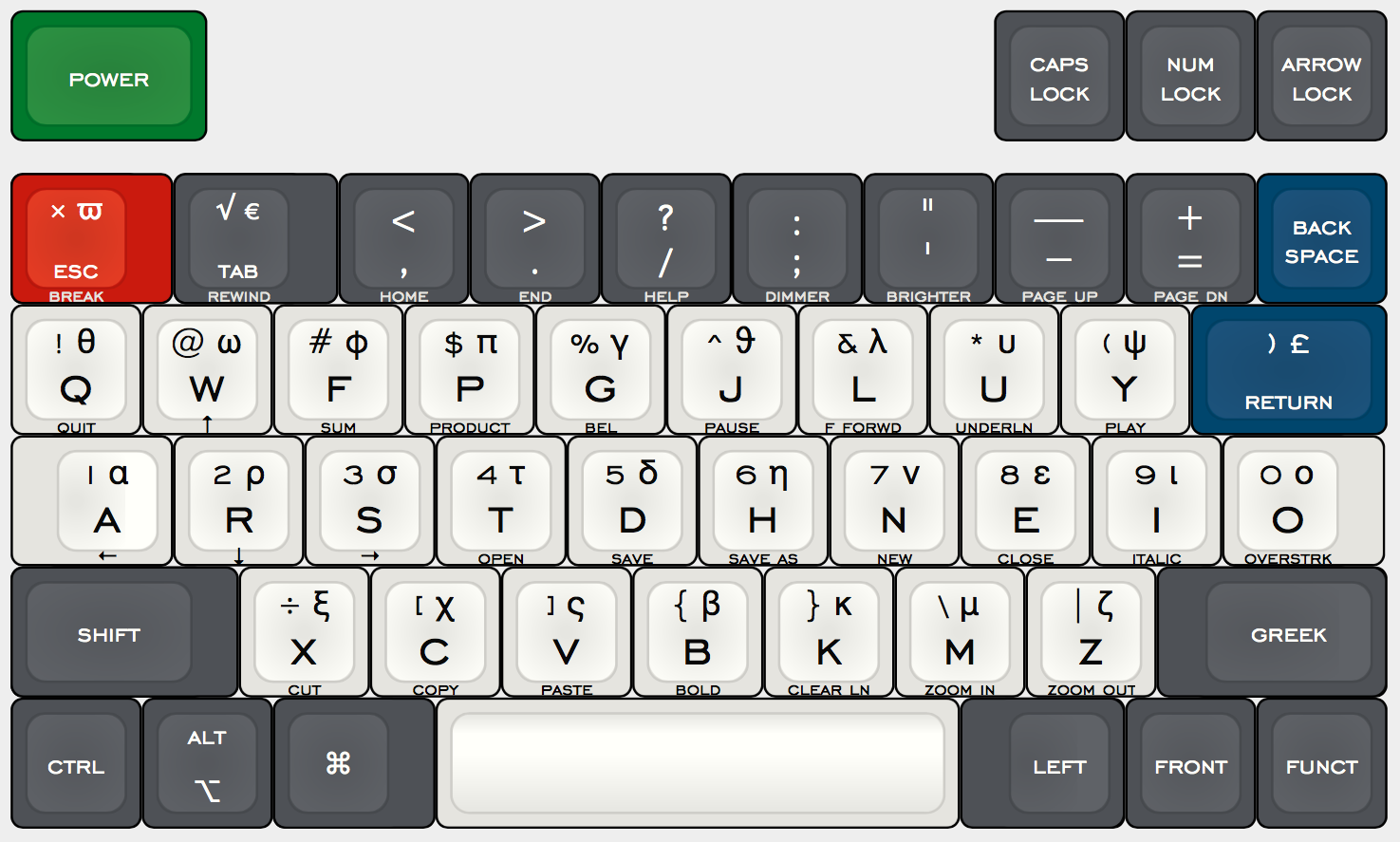

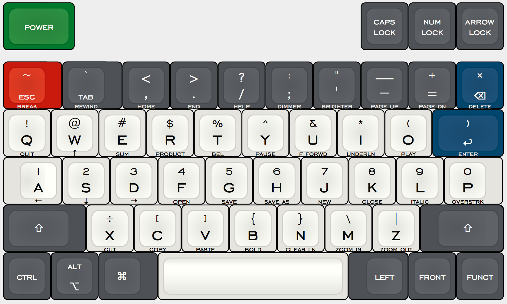

Minor tweaks: added GREEK LOCK, Tilde, Prime, Integral, Derivative, Yen, DELETE, ENTER, and replaced some legends with symbols (BACK SPACE, for example, doesn't fit with the added legends on that key.)
NANOBOARD FOO.png (443.57 KiB) Viewed 6611 times

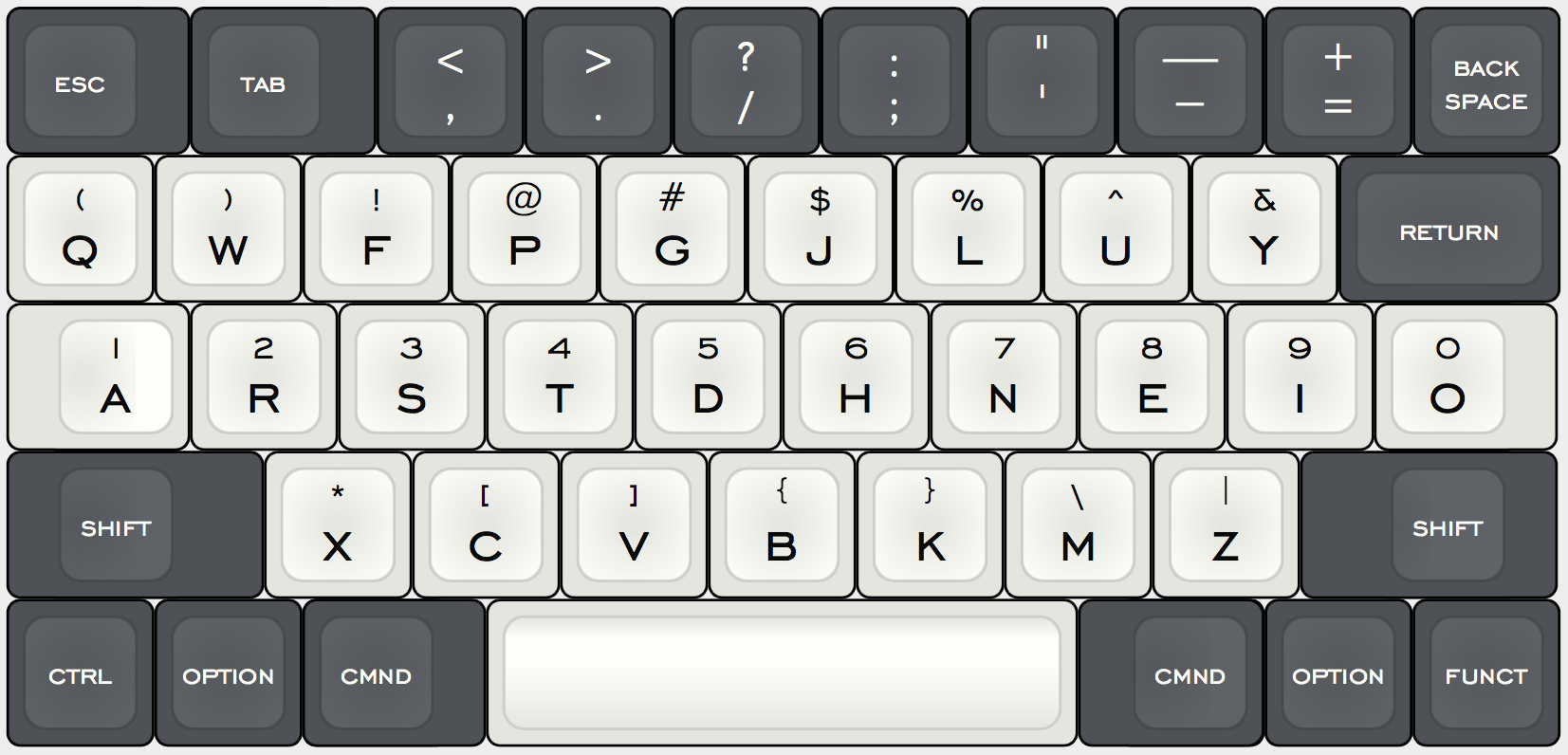

I think the front legends would be pretty expensive in small quantities, with that and the four new key tools that would have to be made, there would probably have to be at least in the high hundreds of buyers to make it worth it. Maybe there would have to be a slightly more accessible version (with all the same key molds and front legends to spread out the cost) to motivate more buyers:
NANOBOARD QWERTYISH.png (444.89 KiB) Viewed 6611 times

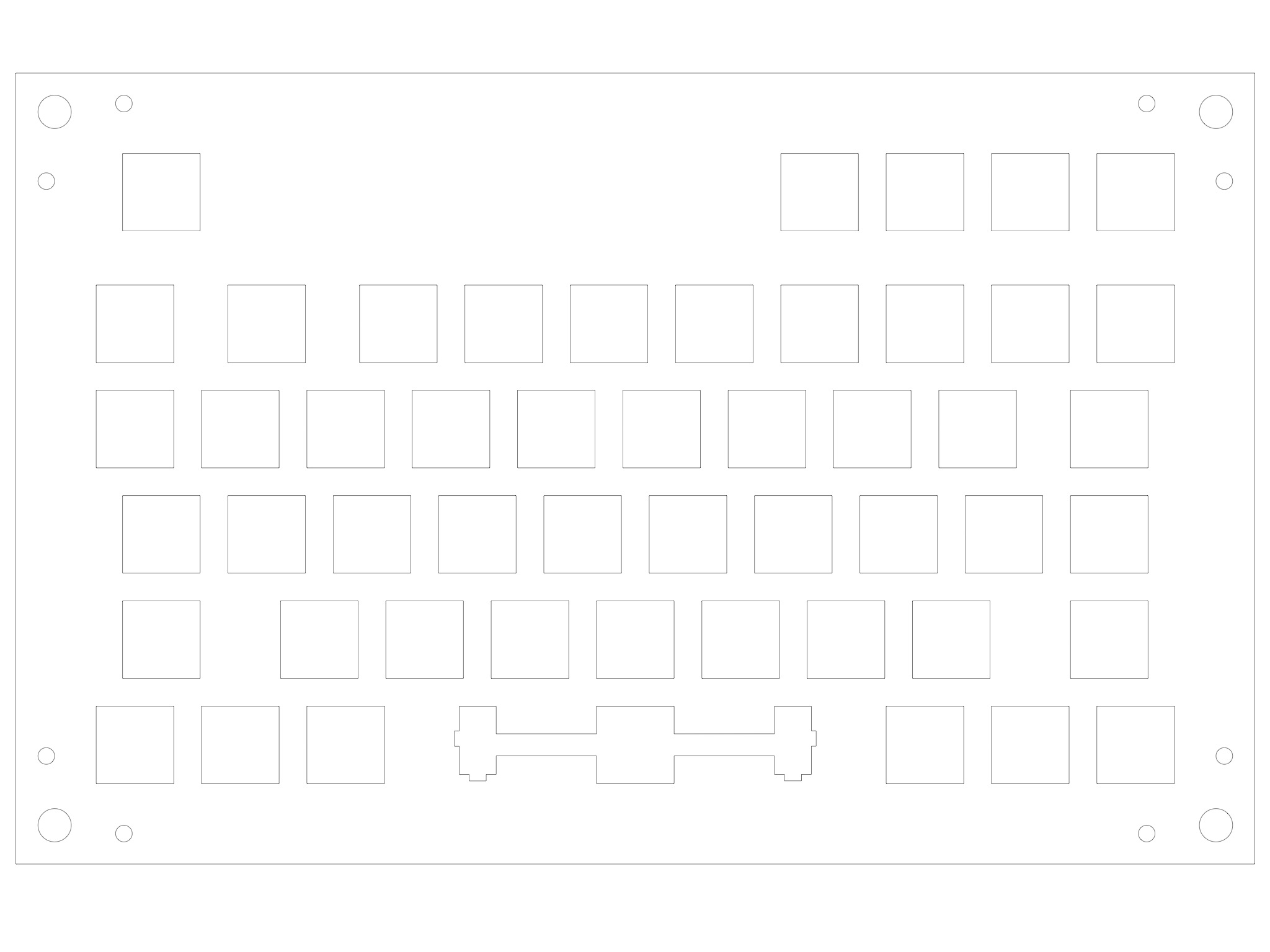

Here is an outline drawing of the (possible) plate:
I have a few questions:
What are the dimensions of the modifications made to the holes on the Phantom plate that make it possible to open the switch housing while it is seated in the plate?
I was trying to parse the specification for the stabilizer from The Cherry website, and I couldn't figure out from that how big the horizontal connecting "arms" that go from the switch hole to each stabilizer hole. There is no length specification for a four unit key, and I don't know how high it should be other than centered and with the top just a little lower than the nub at each end of each stabilizer. Does the height matter? As for the length, how far apart are the stabilizer mounts on a four unit keycap?
I made an assumption with respect to key sizing, and that is that the "unit" is 19 x 19 mm, so 1.25U is 19 x 23.75mm. I placed the bounding boxes for the keys directly abutting each other, then placed a swich hole in the center of each bounding box. Am I likely to have any problems with this approach?
How should I dimension the drawing for the benefit of a laser cutting outfit?
-[°_°]-
31 Jan 2014, 11:32
have a look at the laser cut GB http://deskthority.net/marketplace-f11/ ... aser%20cut
attached you'll find the DWG I sent to the laser cutter. you should find some references there. let me know if you need more info.
