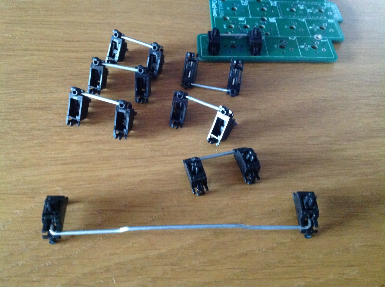

What are people's opinions of the two different families of stabs?
While building PJE's excellent little OneHand, I happen to have a few spare Cherry stabs.
photo 2.JPG (458.76 KiB) Viewed 5542 times
They're PCB mount.

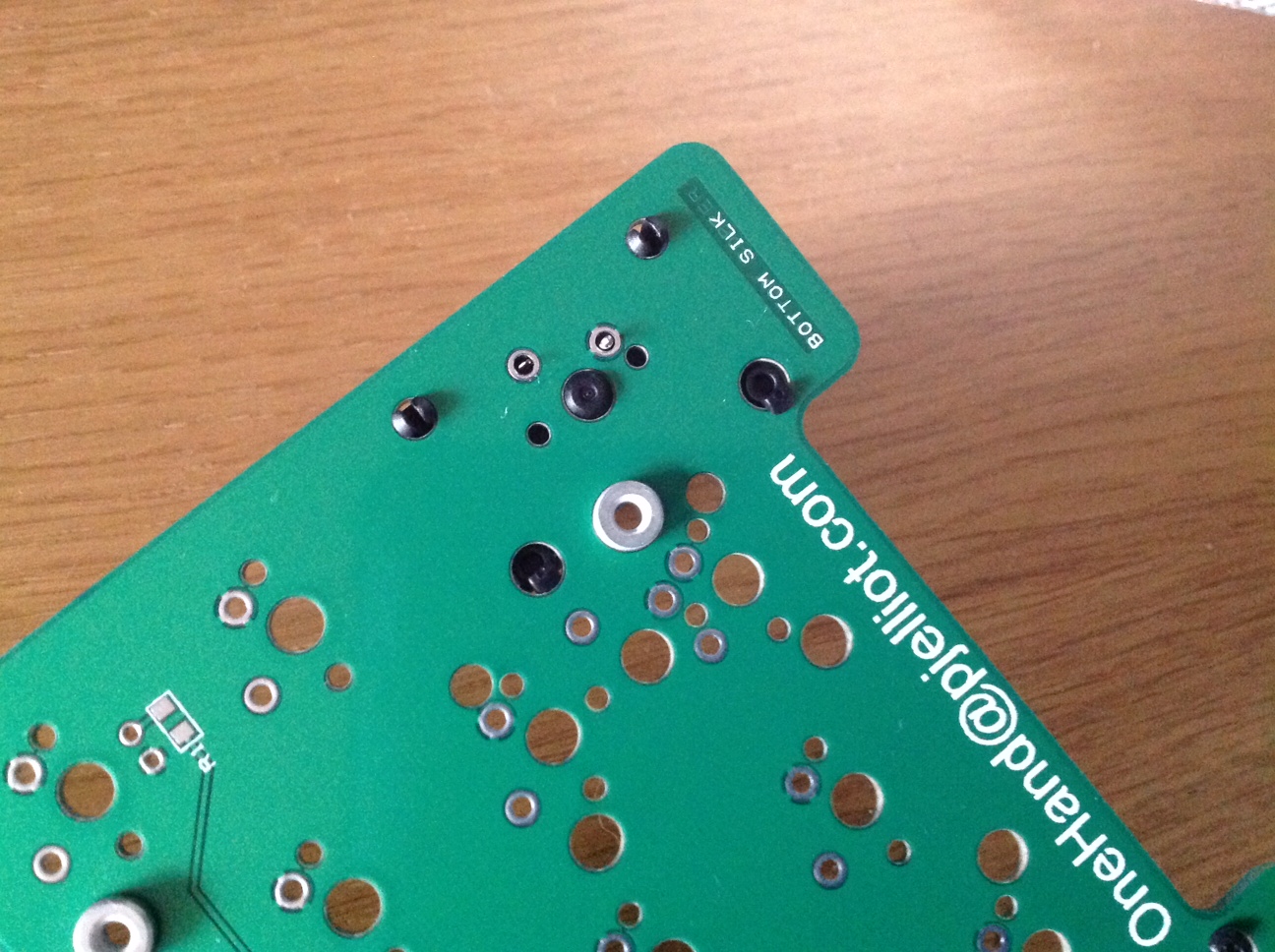

photo 3.JPG (485.8 KiB) Viewed 5542 times

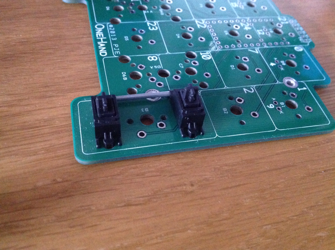

photo 4.JPG (462.48 KiB) Viewed 5542 times
Matt3o tells me plate mount Cherry stabs are pretty rare and that for the kind of hand made metal plate based keyboards he and I like to make, Costar stabs are the way to go.
I'm wondering, though. Cherry stabs accept caps so easily, without the need for inserts. Could I use these PCB mount Cherry stabs on a plate mount keyboard without crazy modding effort? And even if PCB mount Cherries are no good, are plate mount Cherry stabs as easy to build into a laser cut design as I hope?

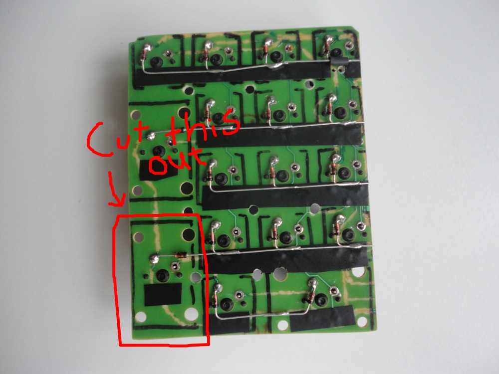

I found an older pic I could use
CUT IT.jpg (173.17 KiB) Viewed 5505 times
As you can see, I have cut out the numpad part of an old PCB from a keyboard I got for it's switches (thanks mintberryminuscrunch!)
Just cut out the piece as shown on the pic, solder the switch on so it sticks. Handwiring over the PCB is easy and doesn't really take up much more space. Just remember to remove the traces on the piece of PCB if they short circuit anything.
To cut and remove the traces I used a Dremel.
