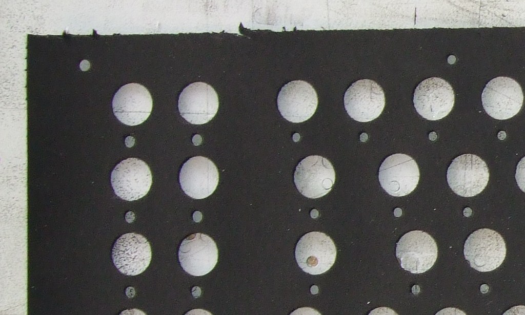

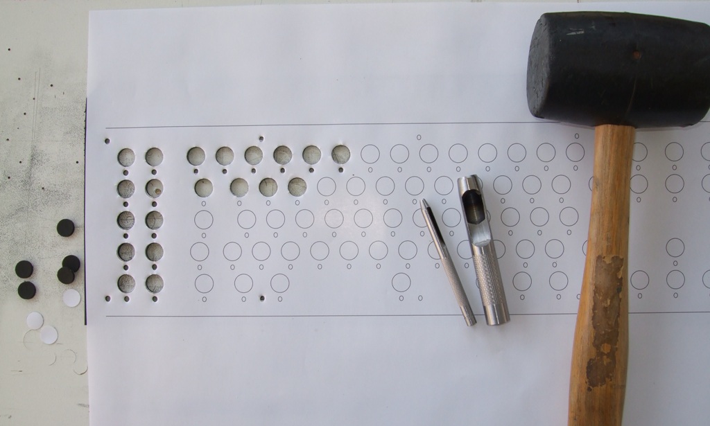

wcass
14 Dec 2013, 04:19
i used this: http://www.mcmaster.com/#8647k102/=pspxs9
to make holes, i use this: http://www.harborfreight.com/9-piece-ho ... -3838.html
i have an AT templates around here somewhere. I have not needed to do a 122 yet, but when i do, i will publish. i cut the material larger than the piece and then use double sided tape just outside of the pattern edge. after all the holes are punched use sharp scissors to cut the outline. A close-up of my work is below. scissors cut the left edge, dull razor knife cut the top edge.
khaine1711
14 Dec 2013, 10:04
The picture shown is for the Model F XT right? Since IIRC the F AT has kinda different looking foam with a small circle directly connected to the barrel
Game Theory
Mr. Despair
14 Dec 2013, 13:11
khaine1711 wrote:The picture shown is for the Model F XT right? Since IIRC the F AT has kinda different looking foam with a small circle directly connected to the barrel
Yes. I used a smaller circular punch for the smaller circle connected to the barrel.
