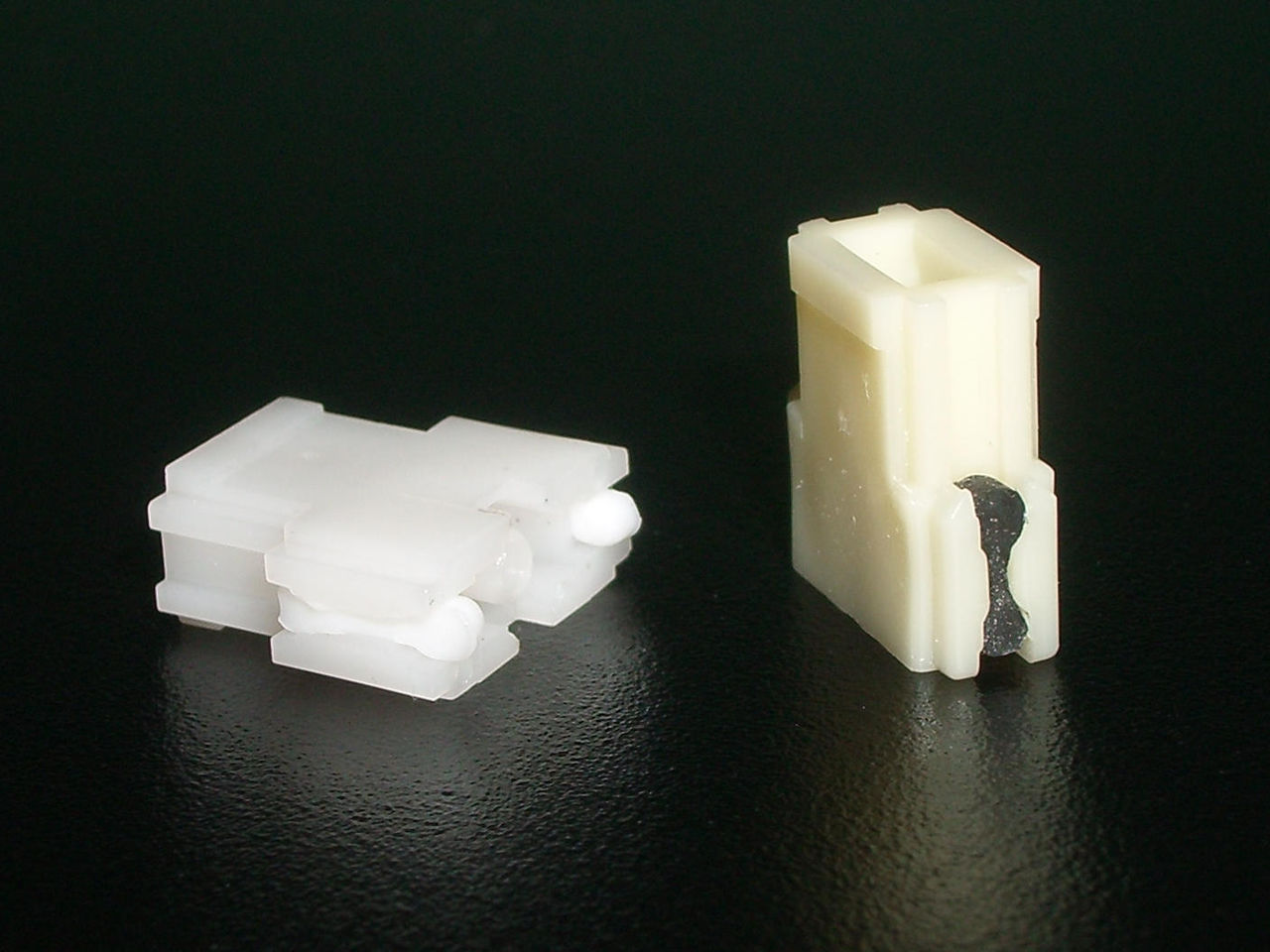

10 Oct 2013, 23:05
Damped Alps switches have little rubber dampers on either side of the slider:
These cushion both bottoming out and the return, damping the slider in both directions.

20 Oct 2013, 03:29
You appear to be correct. The Matias Quiet switch has the same almost flat "bumps" as the Matias Click switch, which will be why the dampers extend down below the slider (where they didn't with the cream Alps). The two switches have identical, interchangeable shells.
I've also successfully fitted a Matias Quiet slider into both an orange Alps and a complicated white Alps switch, and it works just fine. You just have reduced switch travel.

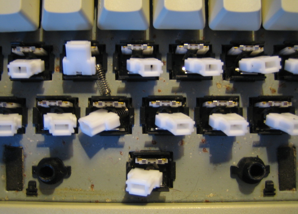

nourathar
24 Nov 2013, 00:56
here some of the action yesterday evening: I replaced all such stems and springs in the 60% center part of my Ultra board with the dampened stems and slightly stiffer springs taken from Matias quiet switches.
Typing is great: smooth, clicky, precise, but without most of the keycap rattle. I'm still getting used to it, but currently I would say this is my favourite switch. Not perfect, but nice.
