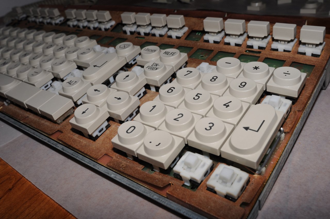

Looks mechanical to me.ZeDolla wrote:Pictures with removed keycaps:
edit: Indeed it is.
Sorry for my misinformaiton before.
There exist keyboards which look the same outside (same key cap design) but are rubberdomes. It is like with G83-3000 keyboards.
Keyfeel is similar to Cherry ML or a bit lighter than blacks.

7bit: interesting, those opaque white switch tops are very RAFI-esque. I'm hoping RAFI can provide the actual part number. (Not sure what Cherry ML switches there are that feel like lighter blacks: my NIB ML switches are distinctly tactile, and very scratchy.)
Any idea what years these keyboards have on them? I'm guessing the switches were discontinued some years ago.

The keyboard is from the late 1980s. People used to say they feel like Cherry ML, or have as low travel as ML.
I remember they felt quite nice, linear like vintage blacks but a bit lighter.
My 105 AiS micro is on the way to me ...
ps: They are not plate mounted.

Tandberg used Siemens-shaped keycaps on Cherry switches, so the keycap is no good indicator.
The switches in 7bit's photos are Siemens STB 21 switches. I've updated Daniel's wiki entry and moved it to "Siemens STB".

Hi Daniel,
here is a link to a bilingual Siemens catalog from the 1990s, http://www.datasheetarchive.com/dl/Data ... 022194.pdf
The section about the STB switches starts on page 80.
I once opened an STB switch -- the mechanics (and, to my mind, the feel) is similar to Cherry MX brown switches.
The tactile feel comes from the interaction between the slider and the vertical contact leaf.
Kind regards,
Ole
