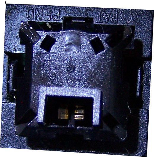

Some bad photos (no good light, phone camera) of the black latching key. I seem to have already broken it, because it no longer sticks. Not sure what happened, I only removed the keycap and looked at it.
One center eye, if you will:
Lever at the back (I had to set brightness to full and contrast to minimum to make it more visible):
(Oh god Galaxy S4 zoom x4!)
The lever, between the two "bars", begins pointing to the left bar, you press the switch, and it clicks to the middle (position in photo). I cannot move the lever with my hand now. Press it again, and it moves to the right, but it remains there now if I press it again. Maybe a tiny piece of plastic of the notches on the housing which guide the lever broke off, maybe not, but seems fragile. I can now manually move the lever to the left again, and it produces a tiny click when I do so. When you move the switch down, the lever catches the notching in the housing, and moves position, this should be some kind of circular thing where it ends up at the start position after two presses.
At the other end of the keyboard there is this Mode Lock key with a black switch, but no lever! Linear like the whites, but requires some more force.

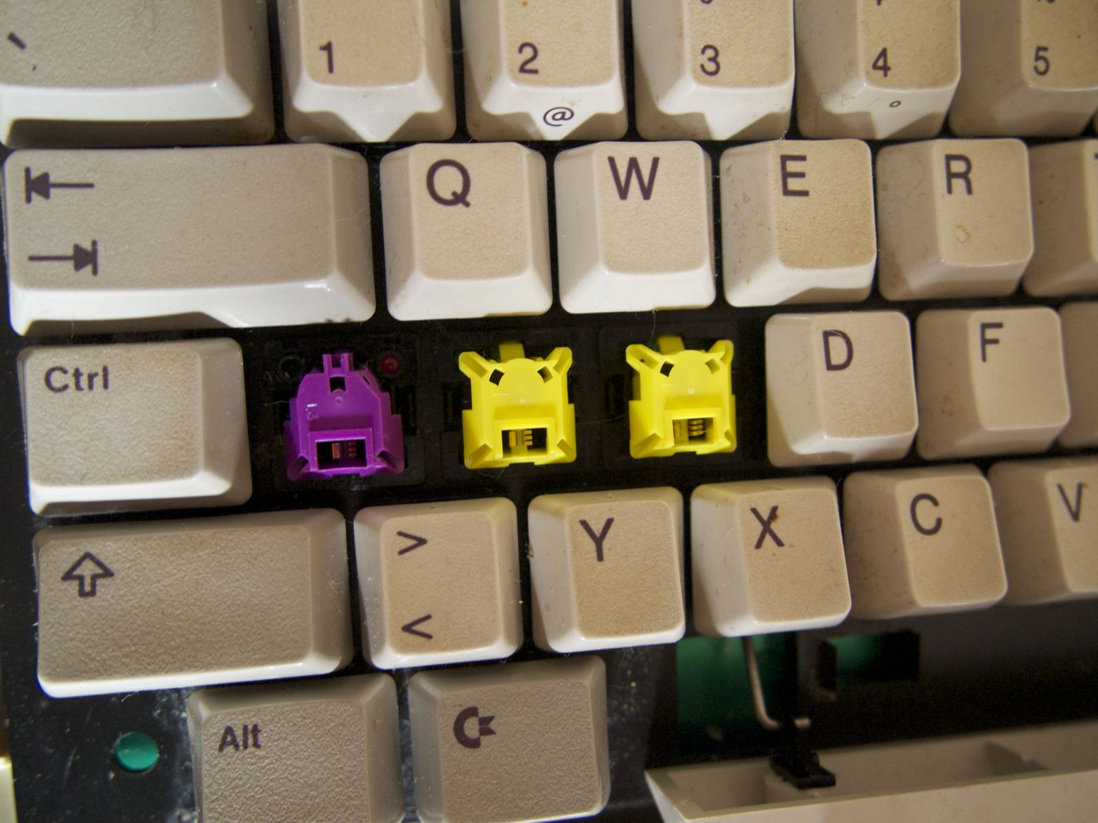

11 Sep 2013, 11:40
Check this out. Yellow linears (slightly lighter than white linears). Purple linear, it feels like yellow ones on a yellow based board, and feels like a white one on a board with mostly whites.
Also grey linear for space bar.
The board with white linears has a green linear space :D
Those space invaders are so far my favourite linear switches, and definitely one of the top favourite switches of all times.
I love the short travel, high activation point, decent weight and superb smoothness which can easily rival Topre or BS.

11 Sep 2013, 22:58
It doesn't match the Commodore keyboards on the wiki. The purple key is caps lock. You can see clearly that there is an LED in it — this finally explains the tapered planform. Space for an LED was the most obvious answer all along, except that the primary example of this (rzwv's tactile RT-101+) has an LED cluster, so they must have changed their mind at some stage and left the switches as they are. I could see the holes where the LEDs should go, but it wasn't clear whether they were intended for LEDs or not.
Interestingly, webwit's latching switch has no LED capacity.
I feel hesitant to report yellow as a slightly lighter grey/beige, without having an adequate sample.
(I did believe that there were one or two more colours to come, but I no longer remembered what they were. I would not be surprised if there are still more, e.g. some similarly lurid shades of tactile and clicky switch!)

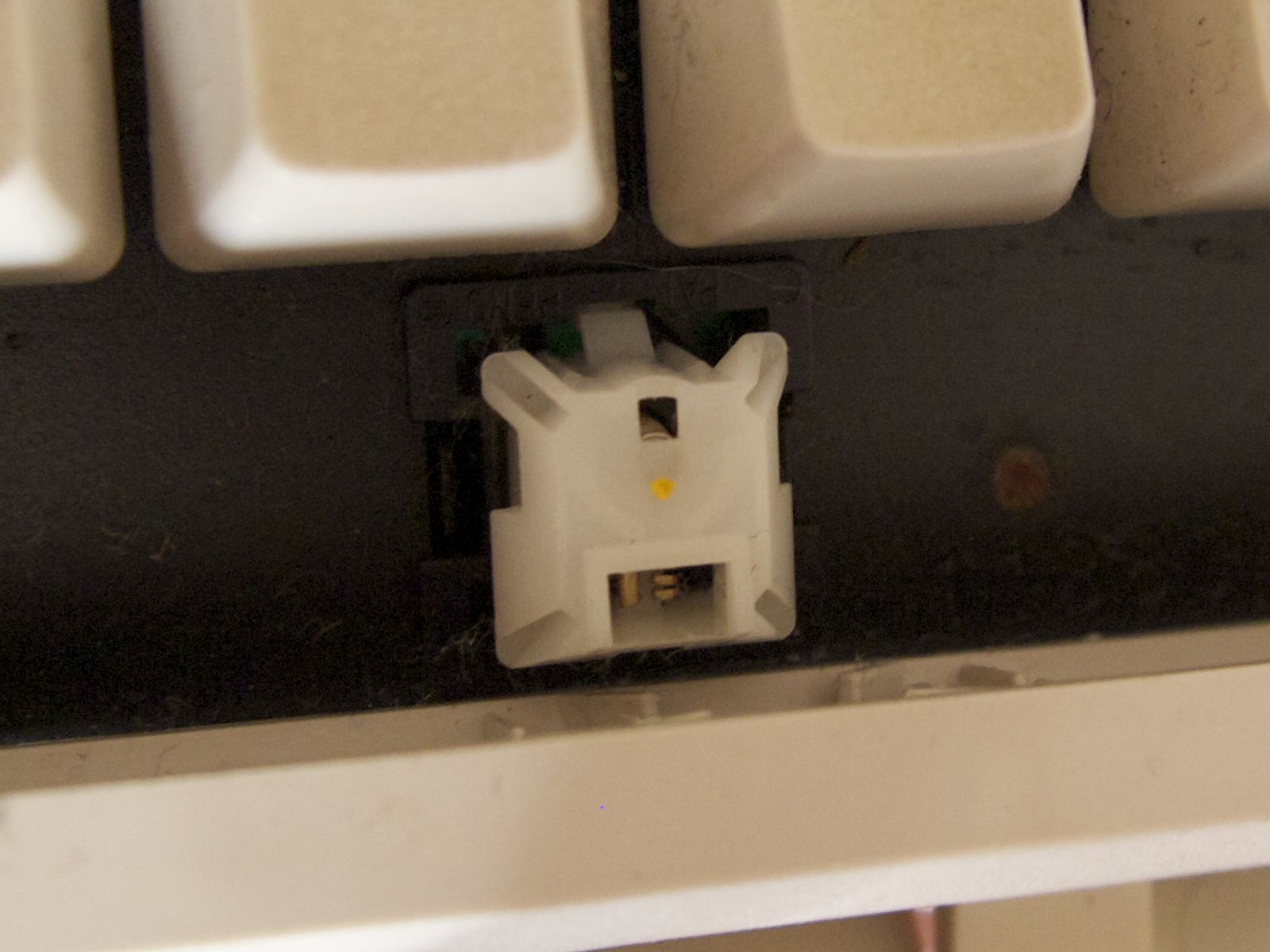

11 Sep 2013, 22:59
PS that space bar switch looks white to me. White with a coloured dot is quite normal. Grey switches are quite distinctly grey.

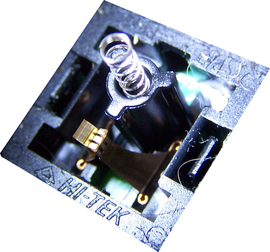

19 Oct 2014, 02:10
Just for completeness, the Gundam version:
This appears to be the original design, as (d'oh!) that is the design shown in the patent!
Not only that, but at least one keyboard it comes from doesn't say NMB on the PCB, suggesting that the keyboards went into production before NMB got involved:
