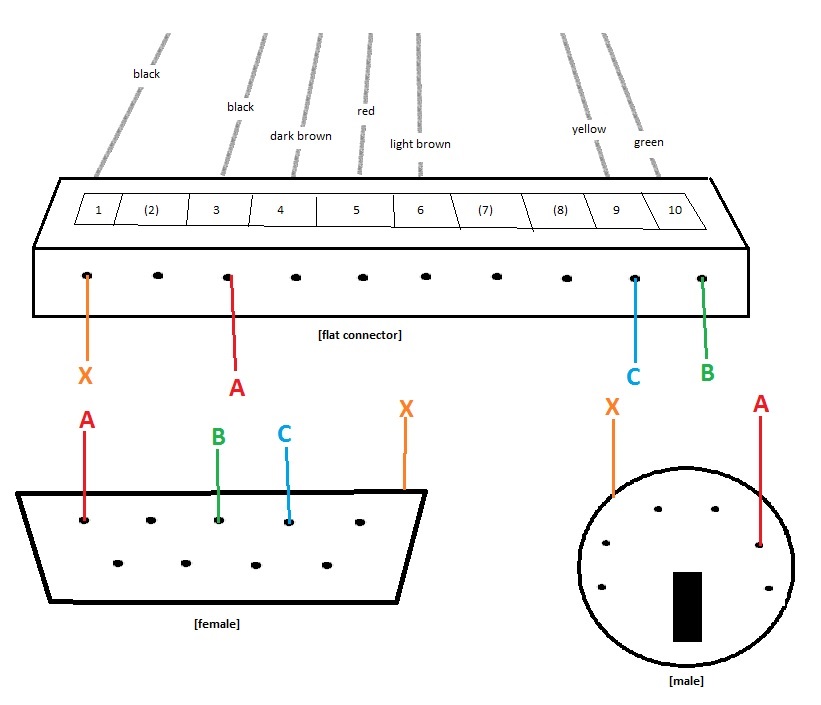

Hello,
according to this thread
http://deskthority.net/keyboards-f2/nee ... t2433.html
it seems that it is possible to program the tipro boards via RS232 (and a USB-R232 adapter) using this cable.
Image.
Who does have this cable and could measure the pinout, i.e. could determine which pin of the RS232 connector is connected to which pin on the keyboard side?
Because an USB-R232 adapter is quite cheap. So you would get an good alternative to buying an Tipro USB controller.
Best regards

I've seen talk of these cable a few times but I've never found anyone sharing the pinout of them. Anyone know what it is? :?:
I need to get my tipro connected via a com port so that it can be used as a gpio device by some radio software.
31 Oct 2016, 13:10
Tipro Y cable continuity check, measured with a very simple multimeter with somewhat too thick tips,
hope I haven't missed anything:
