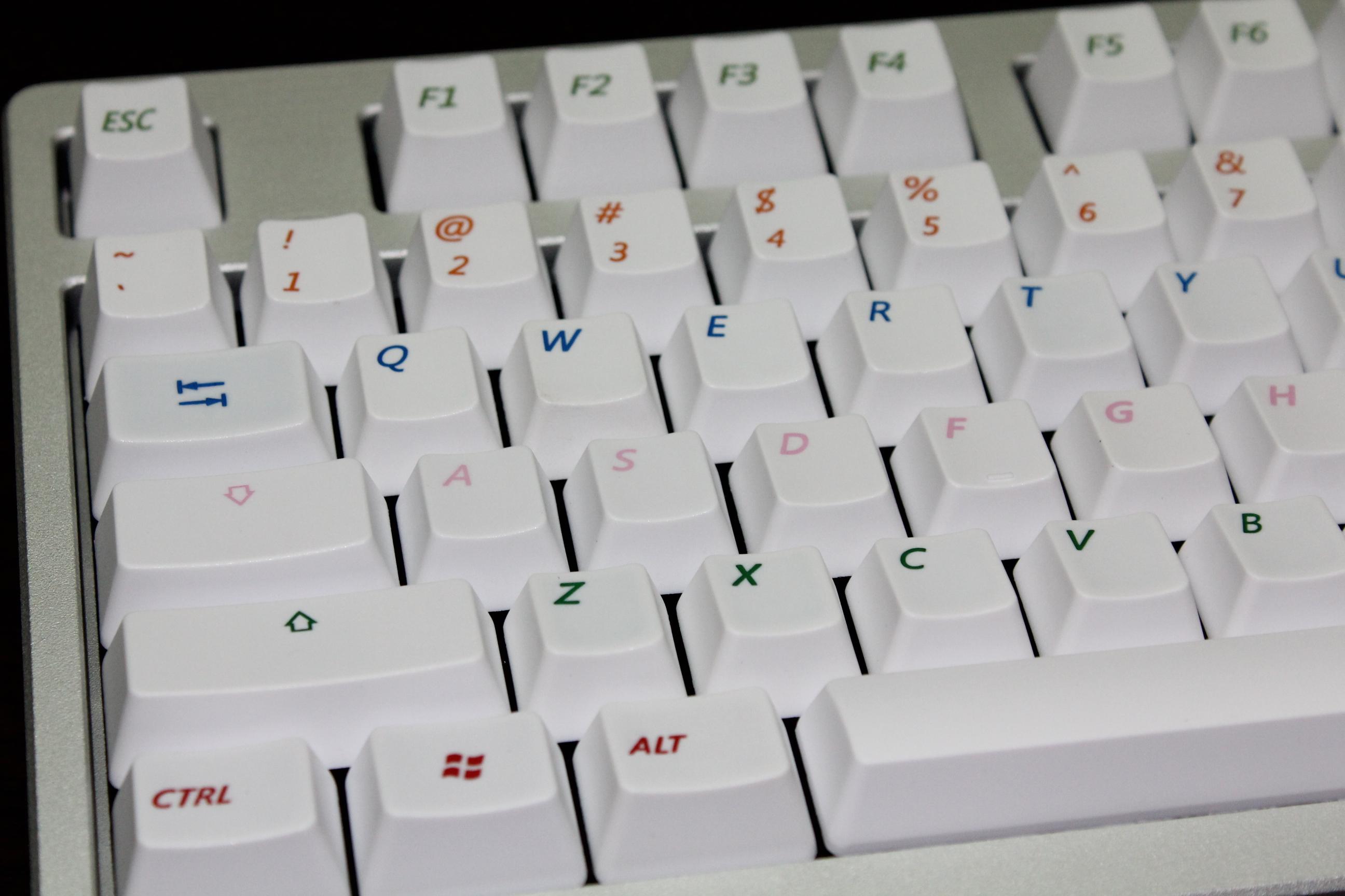

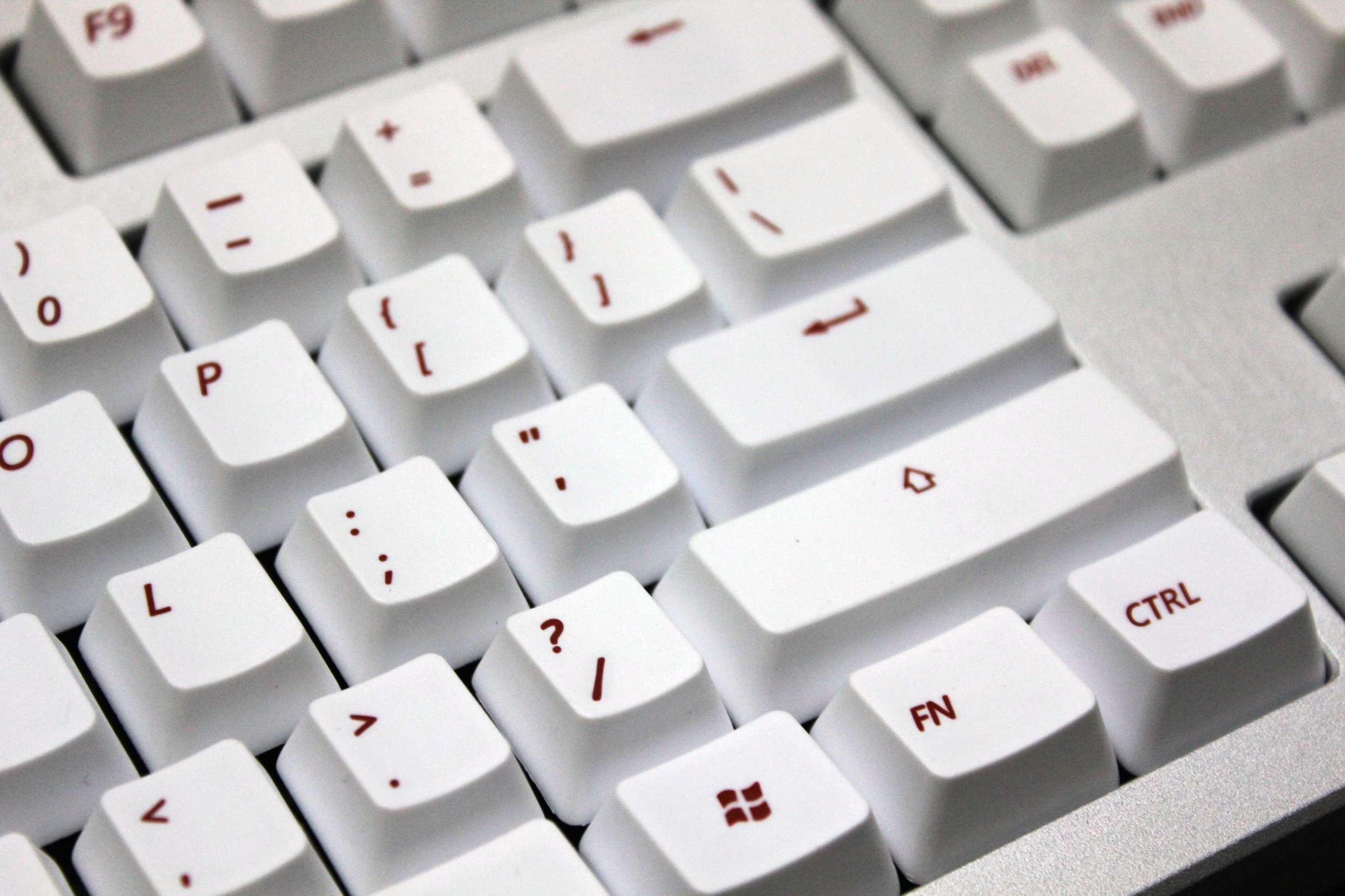

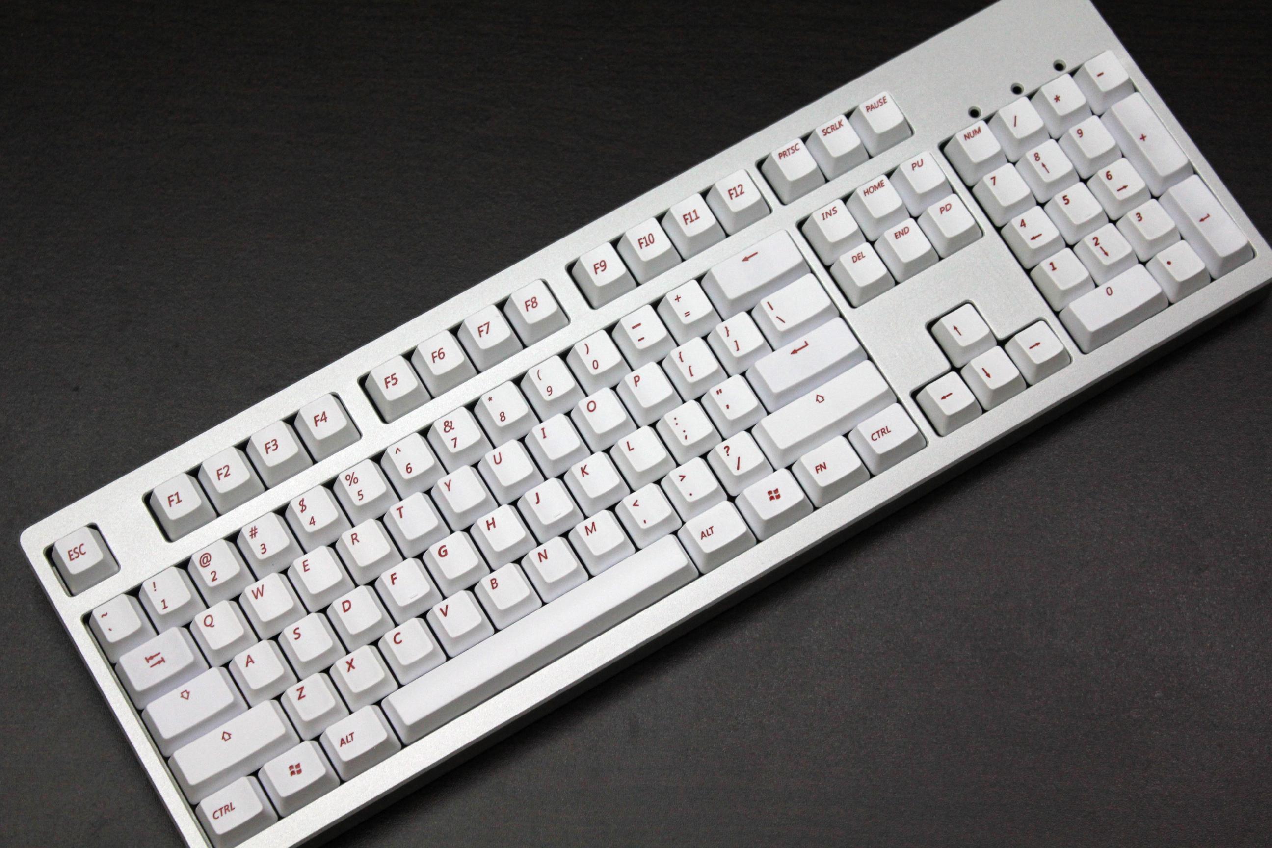

Pt. 1
Red color
Red color
- IMG_0493.JPG (442.35 KiB) Viewed 7201 times
- IMG_0435.JPG (304 KiB) Viewed 7201 times
- IMG_0434.JPG (277.88 KiB) Viewed 7201 times
- IMG_0433.JPG (304.13 KiB) Viewed 7201 times
- IMG_0430.JPG (358.11 KiB) Viewed 7201 times
- IMG_0429.JPG (342.65 KiB) Viewed 7201 times
- IMG_0428.JPG (338.22 KiB) Viewed 7201 times
- IMG_04271.JPG (486.73 KiB) Viewed 7201 times

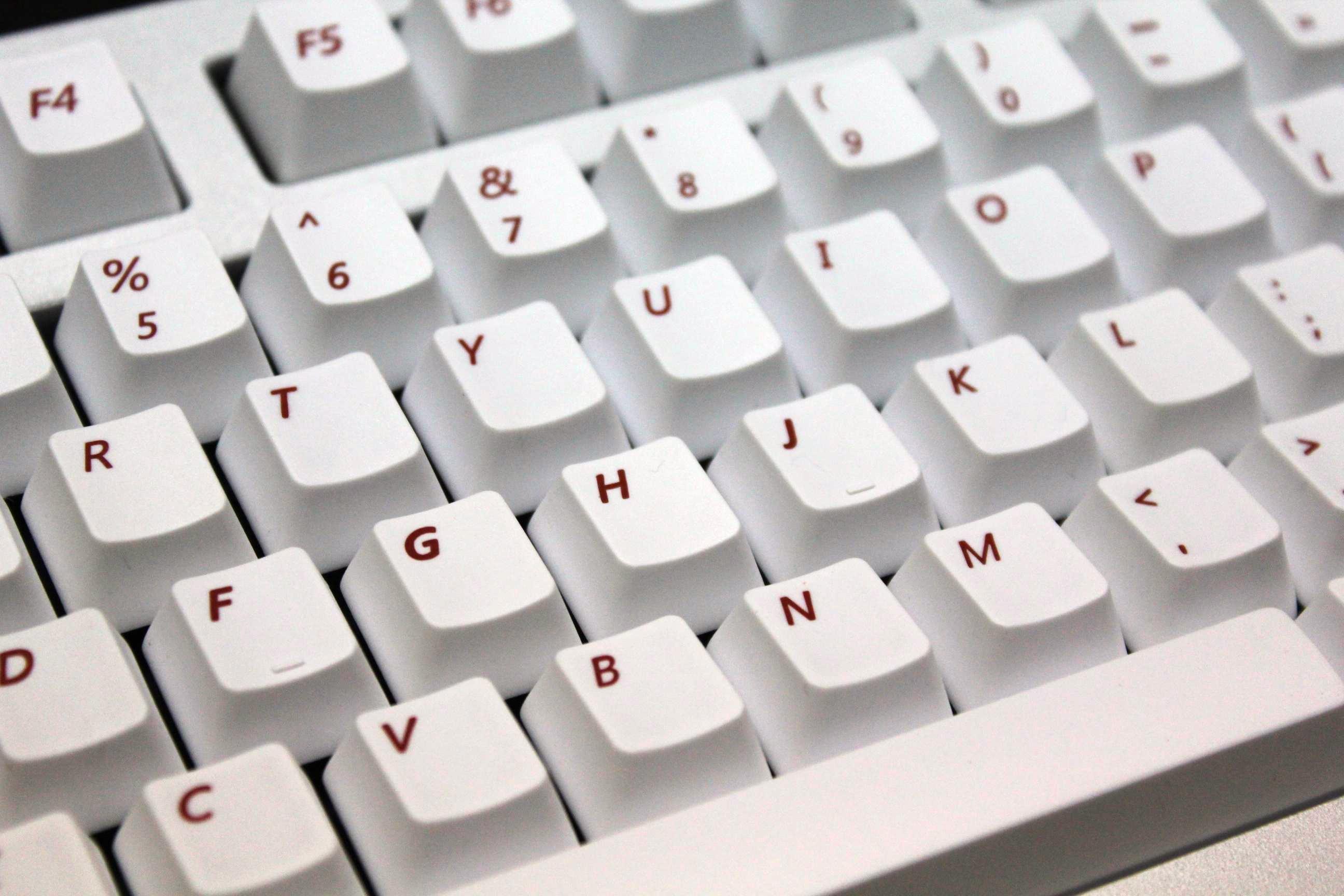

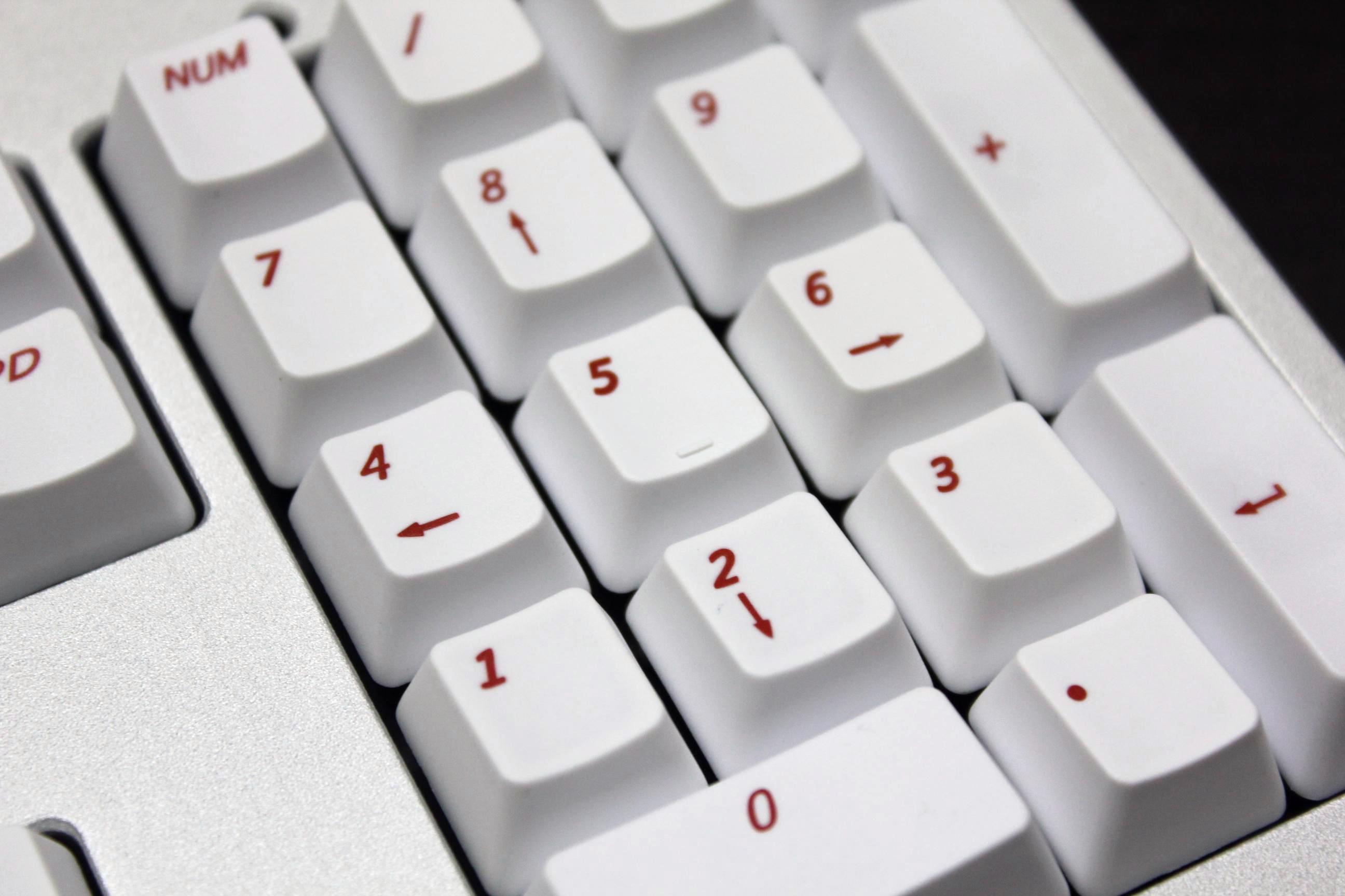

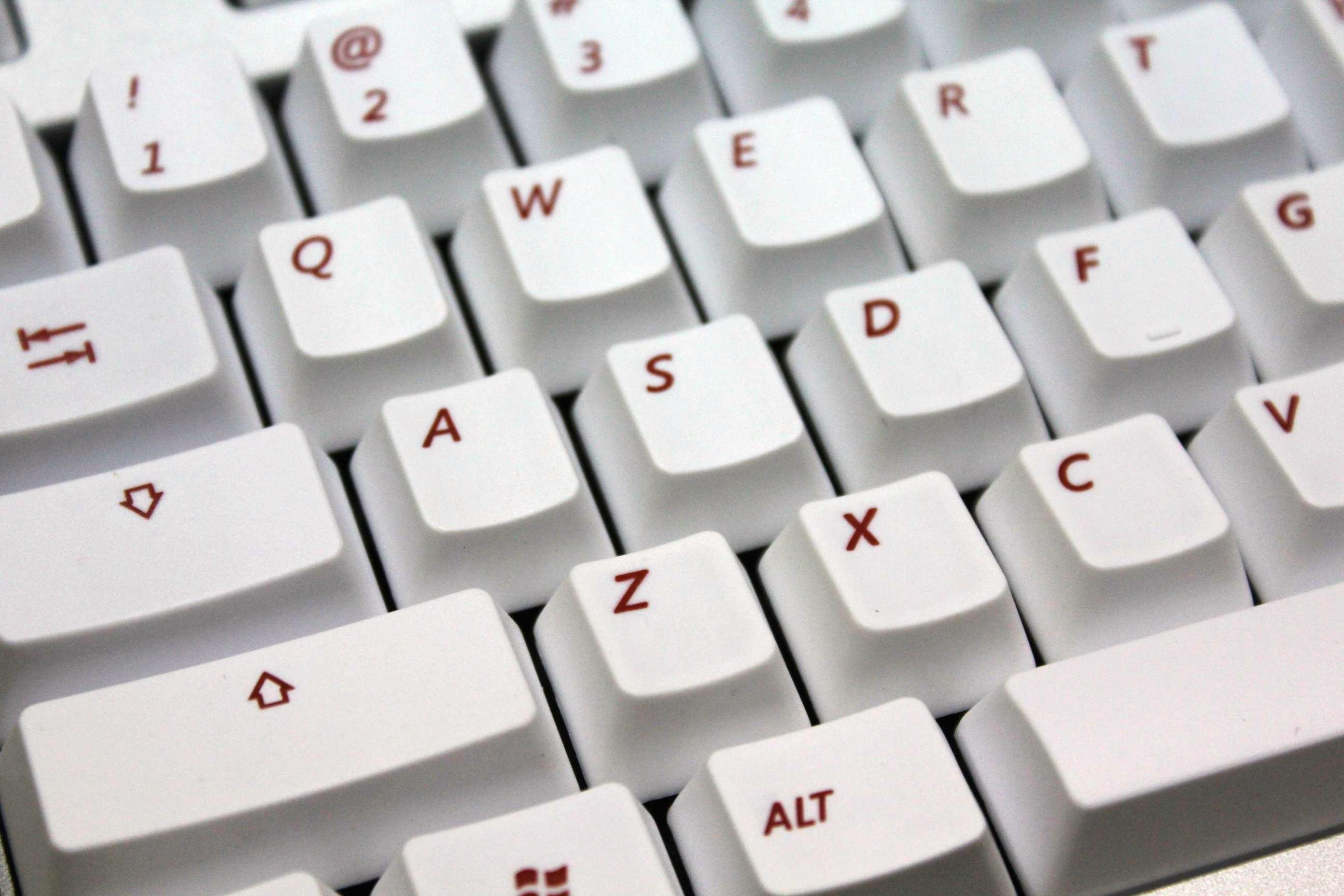

Why italic? Apart from that, why not consistent italic?
But keep up the work. I'm sure, once you have decent legends and quality, there will be plenty of customers.

How about centred legends — right in the middle of the key — in regular Helvetica (no italic)? Extra points for white text on black keys!

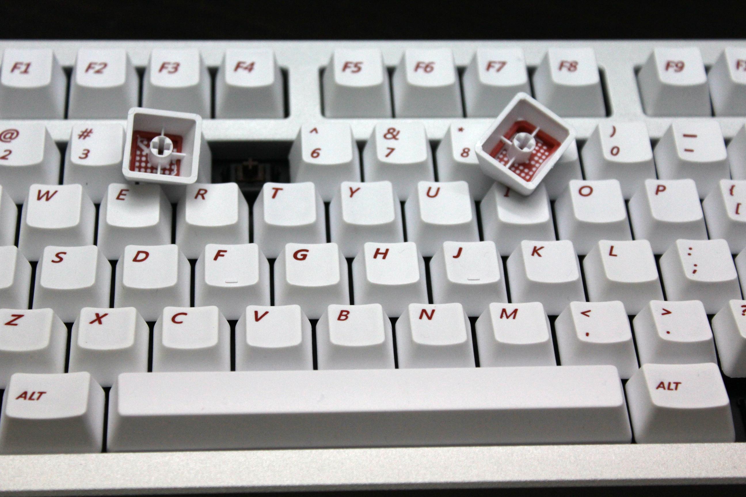

PBT is the plastic we want. Congratulations. Keep this coming!

But a giant step forward decent PBT DS, congratulations

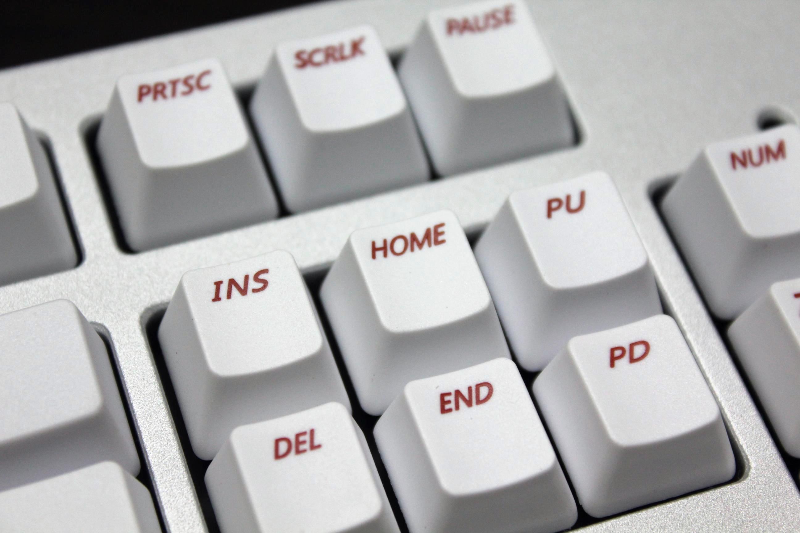

I think really the main problem is there are too many legend size. Size of alphabet legends are OK, but the ESC and F1-F12 is too big, should be same like the prtsc and etc, as well as the Ctrl Alt should be same size too as well as all should have same alignment. I think that is what really makes the set look off as it is not wholly uniform.
Dyesub is good and much more durable and better looking than most pad printing, but it too can wear off the surface with use. PBT doubleshot should be extremely durable which is good for consumer, but bad for manufacturer unless they can keep rolling out hot colorways to get buyer to come back often enough.

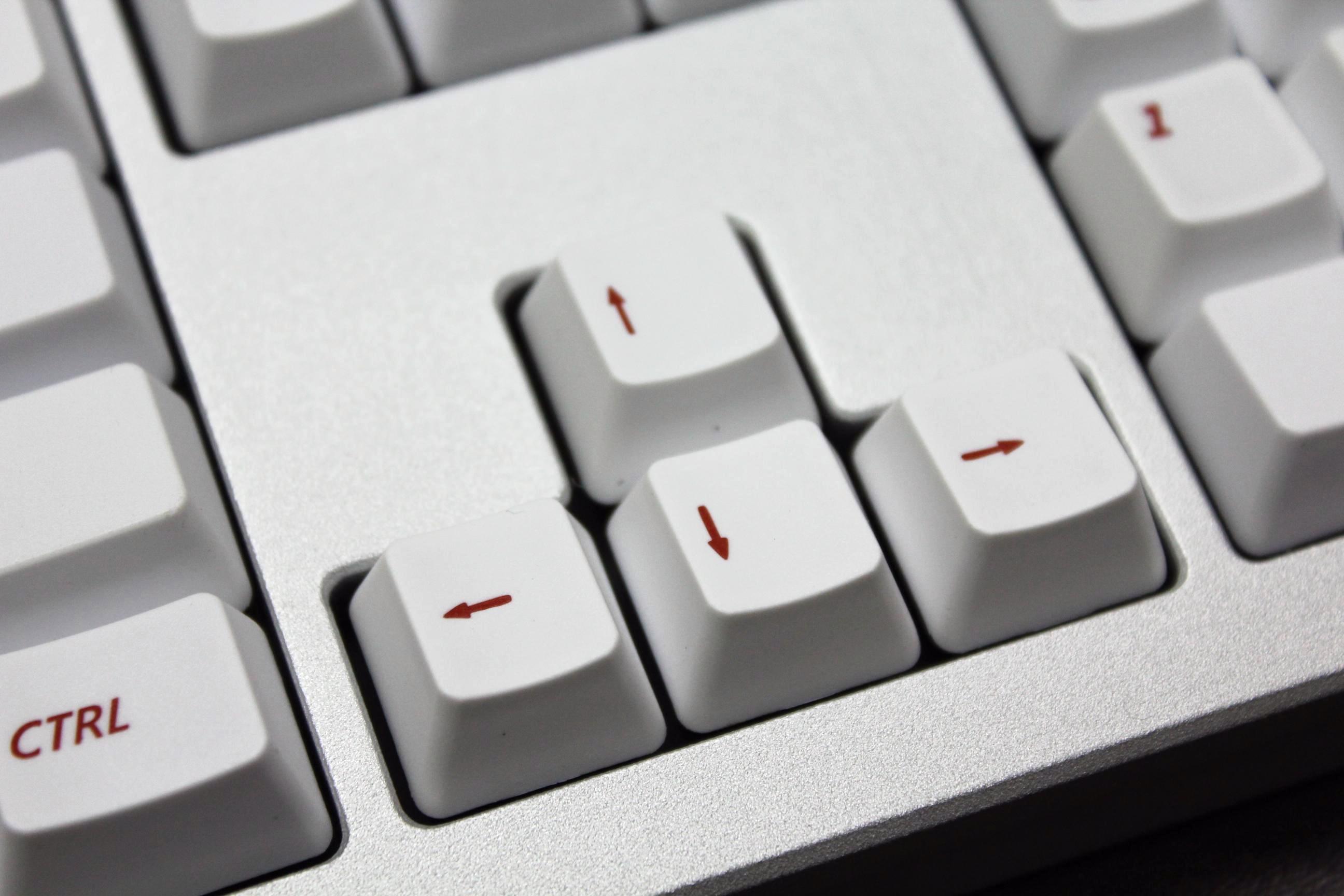

I agree that with the expected price of these sets, the legends can't have flaws like that. Italic font is OK to me, but, like Ivan said, font sizes and horizontal/vertical alignment must be consistent. The arrows on left shift and caps lock need to be horizontally aligned to each other btw, everything else looks sloppy.

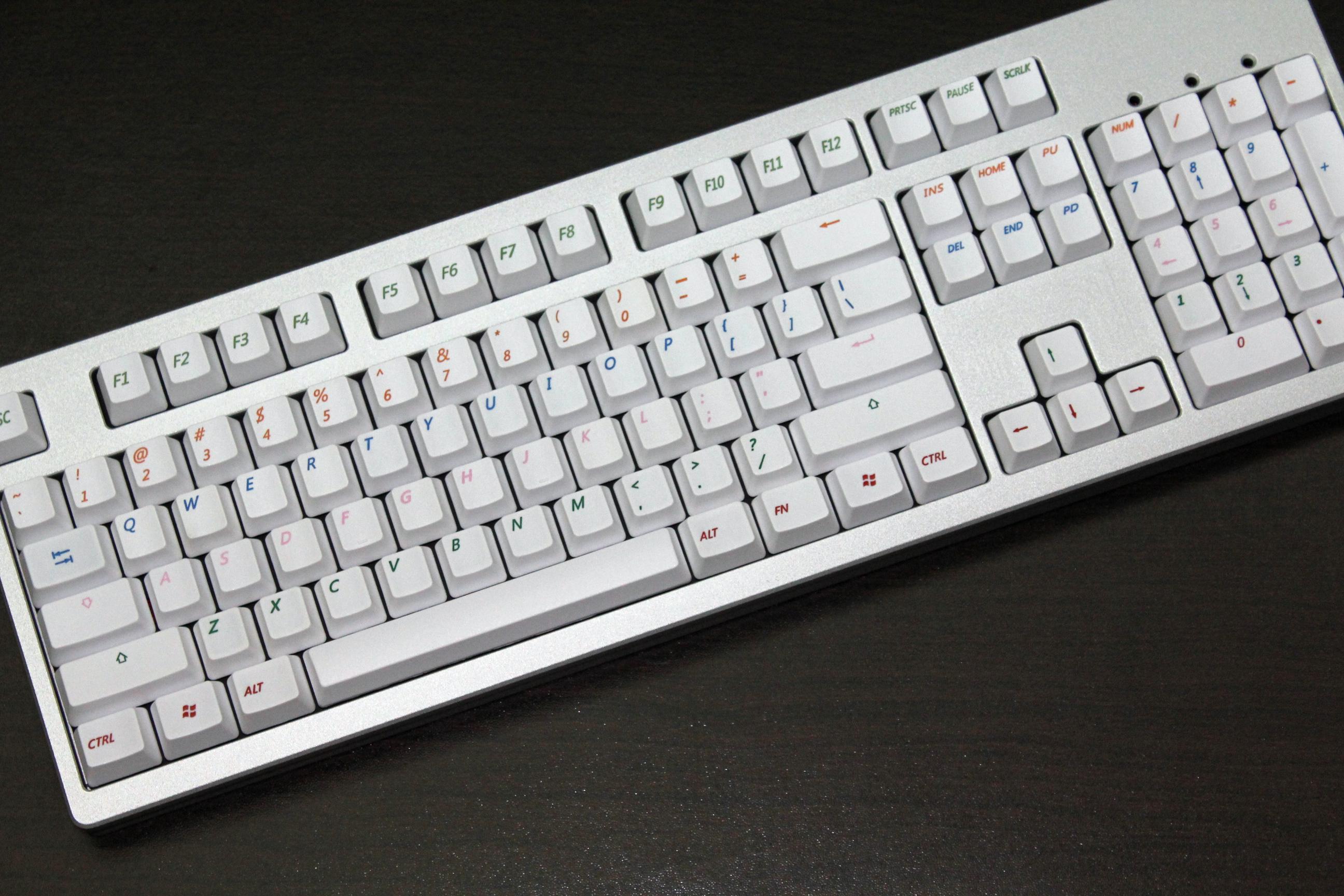

More colors.
- IMG_0596.JPG (265.38 KiB) Viewed 6943 times
- Colors.JPG (505.66 KiB) Viewed 6943 times

Doubleshot PBT is definitely nice tech. I don't mind the font. I like there being colours.
But the legend alignment is so inconsistent... Top/centre on some keys but left/middle on others. Look at the function row: compare ESC and PRTSC. Compare NUM and / next to each other.
