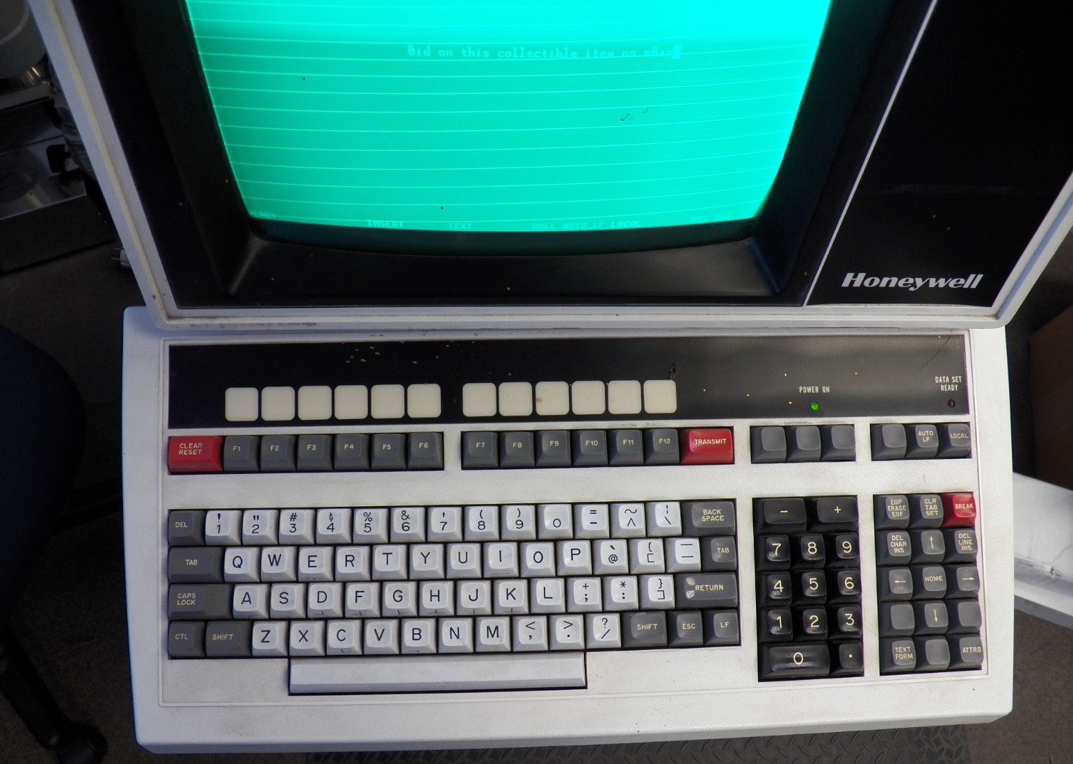

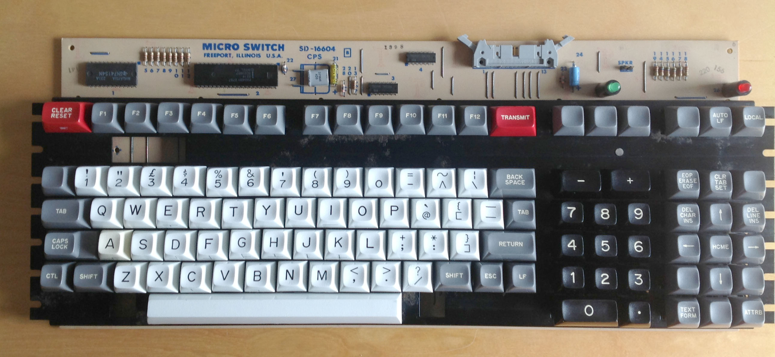

At first I couldn't ID this at all:
Asking around, 7bit found a similar looking Honeywell and Dorkvader found the exact match. I still don't know exactly what the keyboard is called, but here it is with two different Honeywell systems:
Honeywell BO1810
The one I'm looking after is complete and its chassis looks just like this, only dirtier!
Honeywell BTRM 121C-001
(The eBay seller kibutzblackbear gave me permission to use his pictures with credit.)
There is just a single measly label on the exterior of the keyboard (in my case) which gives no name. So its exact title is unknown for now.
