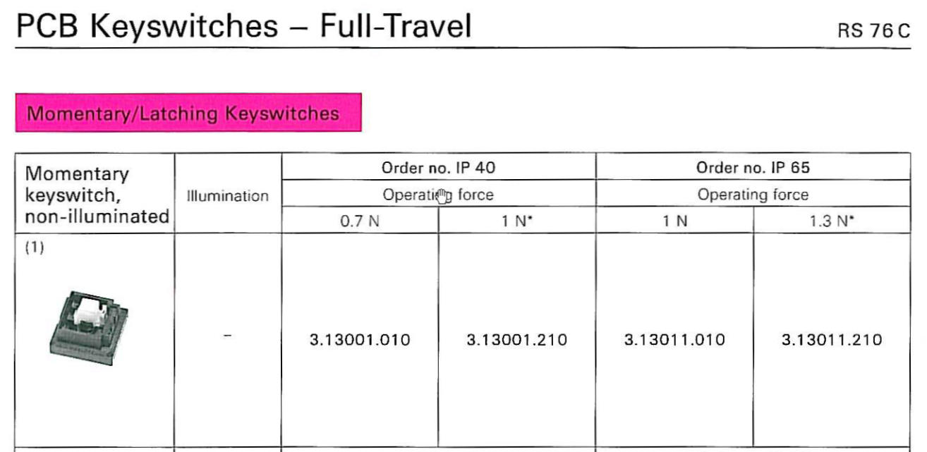

Muirium wrote:It's getting there…
http://deskthority.net/keyboards-f2/raf ... t6216.html
If this is indeed that.
Based on the catalogue I've got, I'd suggest that they are RAFI RS 76C Hall-effect switches:
RAFI RS 76C catalogue entry.jpg (62.98 KiB) Viewed 9656 times
The "magnetic pulse" switches are a mystery: the keycap mount is RAFI, but RAFI deny all knowledge of the switches or keycaps.
