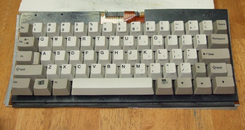

you can make a custom BS keyboard using two steel plates - the top one with holes where the barrels should go. use an XT as a barrel donor (and maybe the case too). you can use model M hammers and springs with custom membranes.
i have wanted to order from this vendor in the UK to check it out, but shipping alone to the US is £11 so have been working other ideas first. you guys in the UK might try it out:
http://inkjetflex.com/site/rapid-prototyping/
i just picked up a rework station and some diodes and will be fitting diodes onto a PCB that i am using for a bottom membrane. the controller is a Teensy.

clearance under the hammer in the "up" possition is very small - maybe 1 mm. the micro switch that you reference might work, and only add about 2mm to switch height. there would even be enough room for a diode. this might turn an XT barrel into a discrete switch like a Cherry. but at £1 (or .6 in bulk) for each microswitch, even custom membranes are a better deal.
