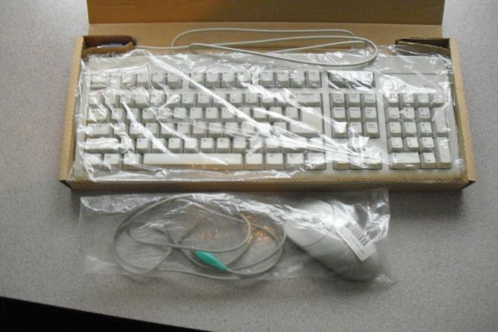

Does this keyboard look mechanical to you?

A guy is selling me this keyboard for about 5 dollars. I'm bidding 30 on it if it turns out to be mechanical (to offer a fair price). He certainly says that it is mechanical, and it is listed as such, but i'm not sure. Is there a definitive way of checking, just by looking at it?

- This is the keyboard

Got any clearer pictures? The bag is fairly effective noise layer over the details. Also: the back would likely say more than the front.

i asked him to provide the details on the back of the keyboard (if there are any) and will get back as soon as i get them. Thanks.

It is not, and the mere fact that you considered this could be an issue would heal it if it wasMembraneuser wrote:First post...don't know if it's rude to start asking for help immediately, but...

The keyboard is apparantly a BTC 5201.

rubber dome
http://fr.apacelli.com/keyboard-mouse-s ... grey-ps-2/
french of course, but there is ugly word "membrane"
In globish :
http://www.btc.com.tw/english/2-7-keyboard.htm
no 5201 though
or
http://reviews.cnet.com/keyboards/btc-5 ... 94104.html

Whenever the Esc key is 1.5 wide I first look if it is a BTC keyboard.

The 1.5u Esc and also the Power-Sleep-Wake buttons very strongly (let's say 98%) indicate a non-mechanical keyboard. Though there are exceptions (very few), if these two signs are manifested together you can be 99.9% sure it's non-mechanical. I hope this will be useful in your search for a mechanical keyboard.

Looks rubberdome to me...
