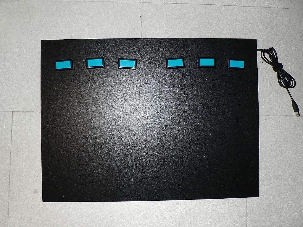

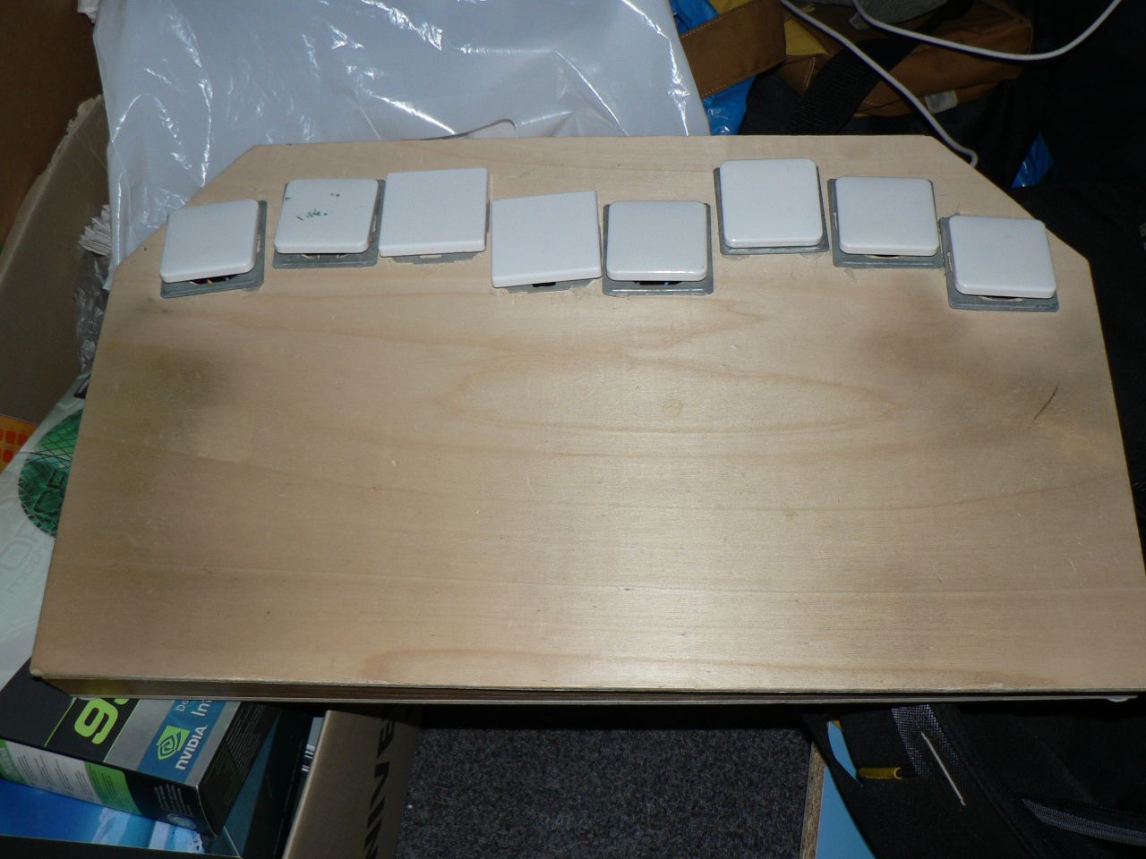

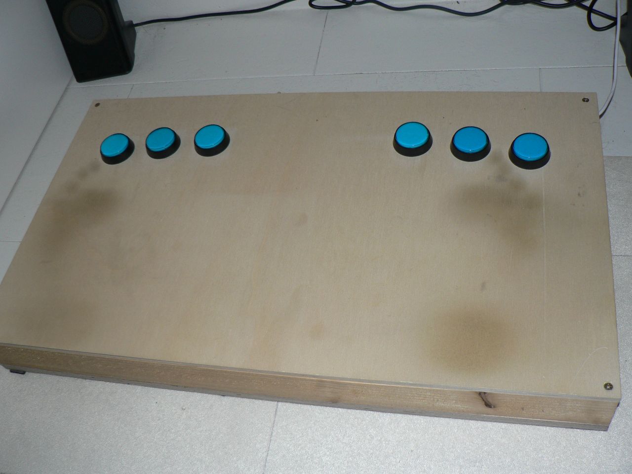

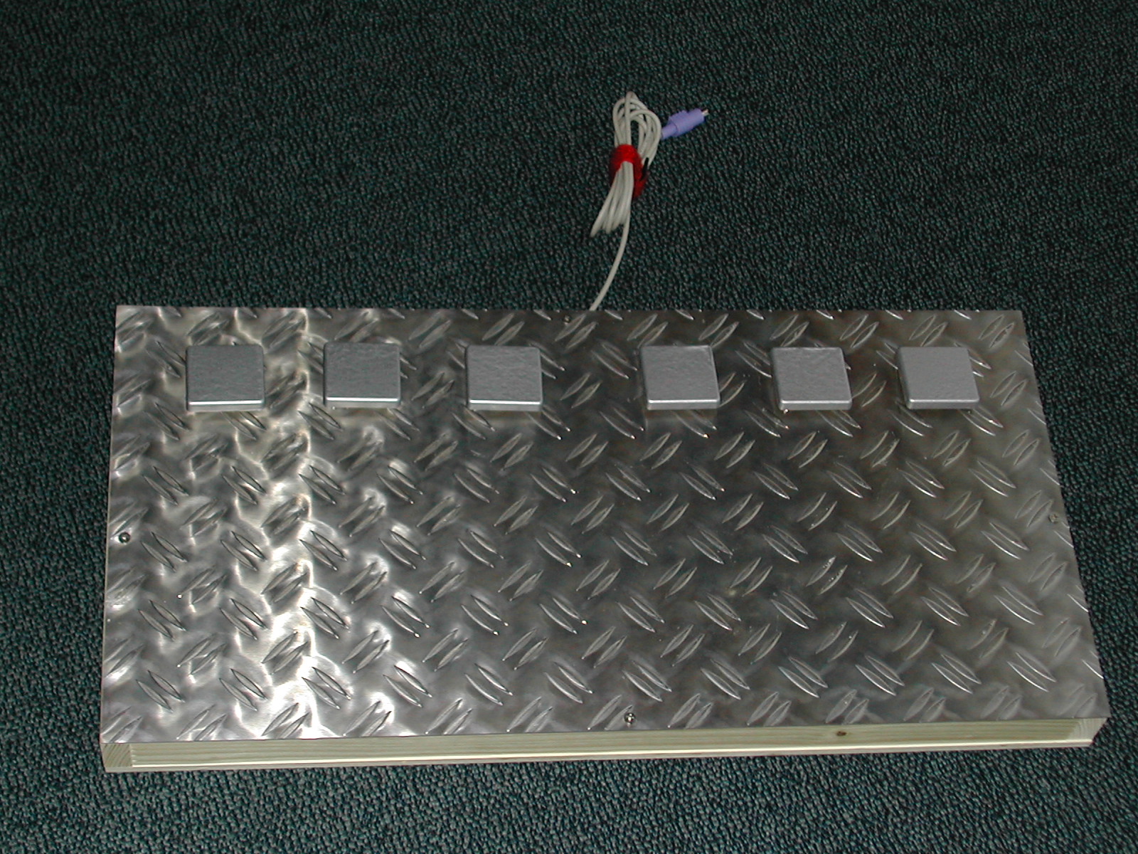

a simple and cheap variant (black one). Just use a plank and a wood strip. Let the sides open. So the footpedal lies inclined angle on the floor. Get 6 buttons. Make the holes for them and fix them.
Take a Keyboard PCB or a Joypad for the input. Trace (solder) the 6 Buttons one to one (2 cable for each button) to the Keyboard PCB with the keys you like. Fix the keyboard underneath the plank. That's it in the rough...

You could use button like in staircases for the light (pic 2,3).
(the button has to "swing" back in the non activation position, like keyboard or joystick buttons.
Or some kind of arcade button like pic 1,4.
Both are good for a digital footswitch.
The staircase light button needs much more force, but I am fine with it.
