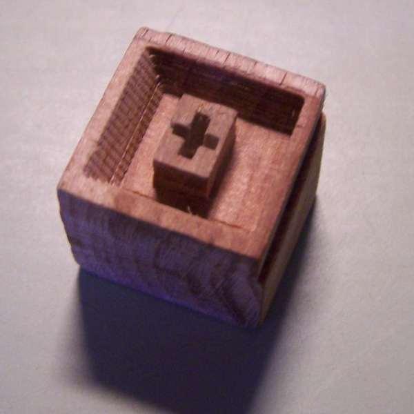

Can you post a picture from the bottom side of the caps?
I ran some tests on making my own wooden caps some time ago. They are working but I should cut them to size and I fear, the stem-mount will break off some day.
wooden keycap prototype
