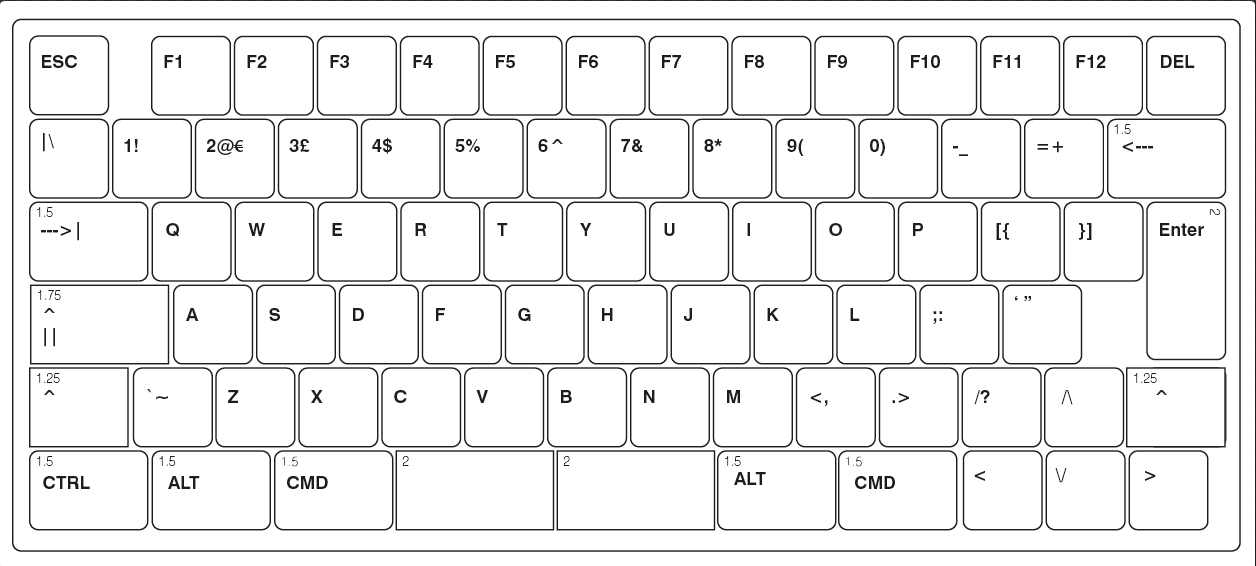

I'm trying to design a compact layout . Rules are:
- standard staggering (as much as possible)
- FN to the bottom left
- arrow keys
This is the closest we can go to a standard layout
Smaller right side
Reduced left size
A bit too far
Without the additional right hand row (note /? key)
EDIT: added this option
ideas? suggestions? opinions?

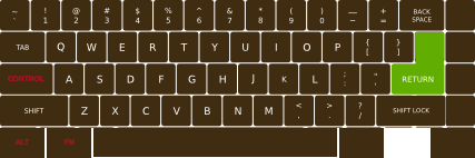

28 Feb 2013, 18:22
Your sequence of keyboards converges agaist a 5x14 matrix keyboard with a green CR key in row 3, 1 unit from the right end.

28 Feb 2013, 18:24
On the bottom row, I would reduce the space bar slightly, allowing you to move the arrow cluster left slightly, this means you can make the '?/' key normal size, and the shift bigger. Then you just have a small gap unused to the right of the right arrow.

28 Feb 2013, 18:30
7bit wrote:Your sequence of keyboards converges agaist a 5x14 matrix keyboard with a green CR key in row 3, 1 unit from the right end.
Don't know if I like a 1 unit CR... (if I understand what you mean) EDIT: no I didn't get it
gmjhowe wrote:On the bottom row, I would reduce the space bar slightly, allowing you to move the arrow cluster left slightly, this means you can make the '?/' key normal size, and the shift bigger. Then you just have a small gap unused to the right of the right arrow.
yes, I thought about that, but I can't live with that 0.25 gap to the right :P
anyway here it is... maybe I can live with it...
gmjhowe
28 Feb 2013, 19:02
It just seems silly to me that some keys like '|\' and '?/' are made larger than 1unit (my main complaint about the standard ANSI layout)

-[°_°]-
28 Feb 2013, 19:21
this is one of the few ISOs I can think of :)

-[°_°]-
01 Mar 2013, 09:12
it's not bad pasph, but the staggering is off in the last alpha line and I wanted to try to keep the default staggering as much as possible.
Also I'm not sold about the right side FN key (but that could be moved in place of the win key).
-[°_°]-
01 Mar 2013, 17:00
This is the smallest ISO I could think of with default staggering
Grond
01 Mar 2013, 17:07
Personally, I fear I'd hit UP instead of RIGHT SHIFT all the time!
-[°_°]-
01 Mar 2013, 17:14
Grond wrote:Personally, I fear I'd hit UP instead of RIGHT SHIFT all the time!
UP would be deep dished :)

Nice to see all these minimalistic approaches, but why does everybody insist on keeping the standard stagger? And the huge spacebar?
gmjhowe
01 Mar 2013, 17:33
That latest design is actually really nice matt3o.
I am with suka though, thats a pretty big space bar for a compact layout.
I would make it 5u then make my mods bigger.
Also, being a Mac user, I would want three mods on either side also.
01 Mar 2013, 17:40
Because of the same reasons people insist on qwerty and most innovation in keyboards and ergonomic keyboards fail in a bigger scope. Muscle memory, introducing a learning curve, and in fact because the keyboards you use elsewhere (work, laptop, etc.) use the standard. Note that I am a Colemak Datahand user who did invest and harvested, so I'm just stating the obvious reason without defending it.
-[°_°]-
01 Mar 2013, 17:42
gmjhowe wrote:That latest design is actually really nice matt3o.
stagger is important to me. so I'd like to keep it default.
size of spacebar and number/size of mods is pretty free I'd say. 6.25 and 7 are easier to find, that's all. I'll soon get 6u but 5u are DCS only I believe.

01 Mar 2013, 19:24
matt3o wrote:This is the smallest ISO I could think of with default staggering
I don't like right shift that far to the right I need to reach for it which makes it easy to miss and hitting "up" instead.
-[°_°]-
01 Mar 2013, 20:21
the only ISO possible with standard staggering is this I believe
tlt
01 Mar 2013, 20:40
I like that one the best. Maybe you could use a 6u spacebar and use a 1,25u AltGr key?
gmjhowe
01 Mar 2013, 20:49
Being able to assign some of the right hand keys as media keys would be nice too.
I do like how compact the previous one is, especially with the symmetric gaps.
dirge
01 Mar 2013, 21:23
matt3o wrote:the only ISO possible with standard staggering is this I believe
although on the right I'd have prt sc, pgup, pgdn I use those more.
I love that ISO enter in green. It's clearly the replacement for the red escape fashion.
Grond
01 Mar 2013, 21:39
I also think this latest layout is the best, and it's good to have the four extra keys on the right – supposing they're programmable, they'll suit anyone.

gmjhowe
01 Mar 2013, 23:55
Hey now! Who said you could drop the ISO enter?
I like this best, especially if the FN key could be put else where and the fn key mapped to CMD.
-[°_°]-
02 Mar 2013, 00:04
No drop :) I'm having both. I believe I'm going to pick this
and this
with some small changes (spacebar/mods)
gmjhowe
02 Mar 2013, 01:21
You should move ~` to be right of shift where you have that blank key, then make the top right corner into Escape.
I use escape a lot throughout the day, it should have its own key.
