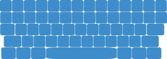

-[°_°]-
14 Feb 2013, 10:08
this would be something :) (mods up to 1.50)
