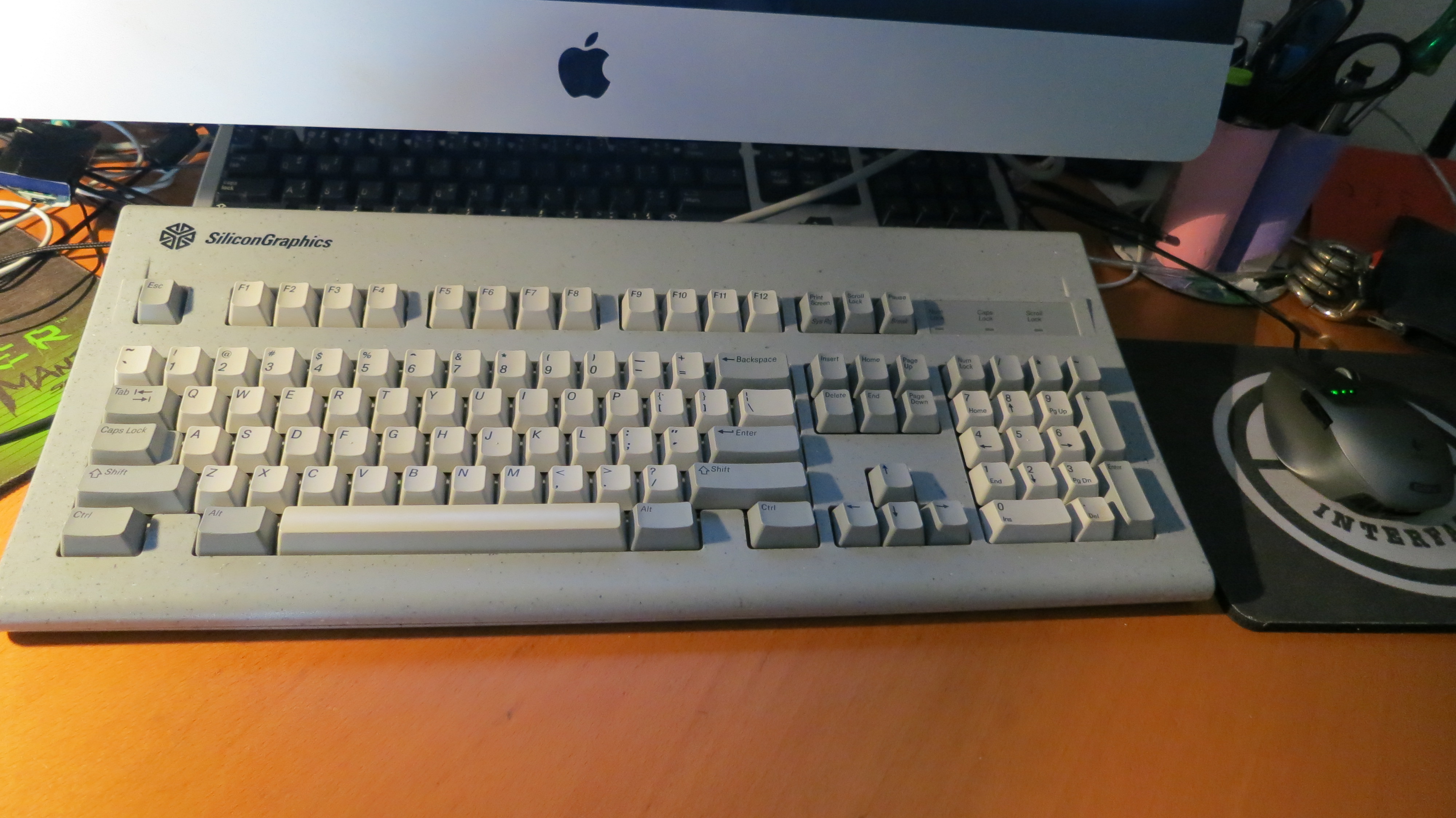

So today I started to do something about the bad feeling I had when I killed my perfectly fine Silicon Graphics AT101 .

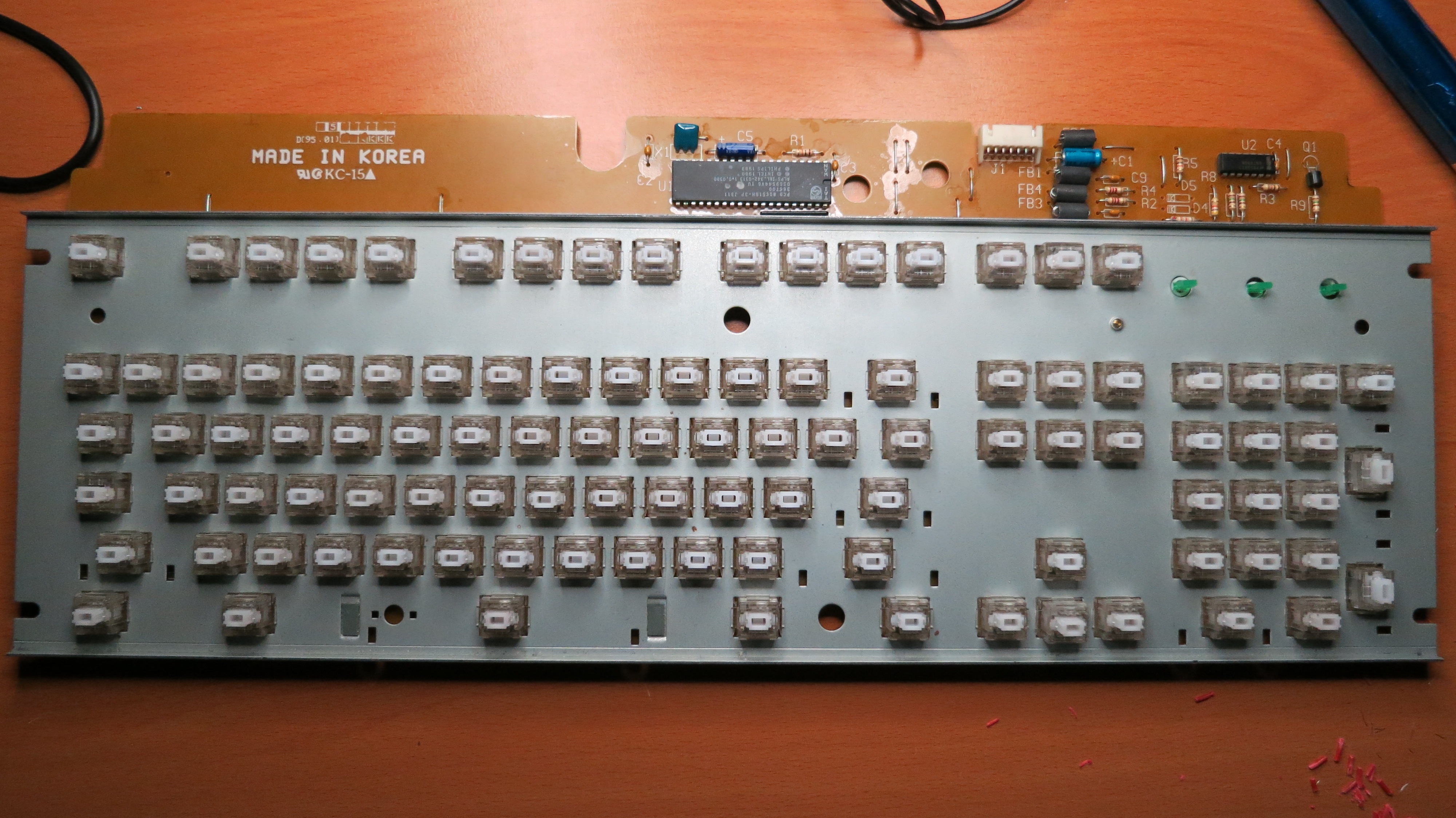

Matias was kind enough to send me some of his switches( both kinds : clicky and 'quiet' ) and I decided fix my little SGI ( I only removed the switches for the sample bags and sinklist items )
The clicky matias on a SGI, I put a quiet matias as spacebar.

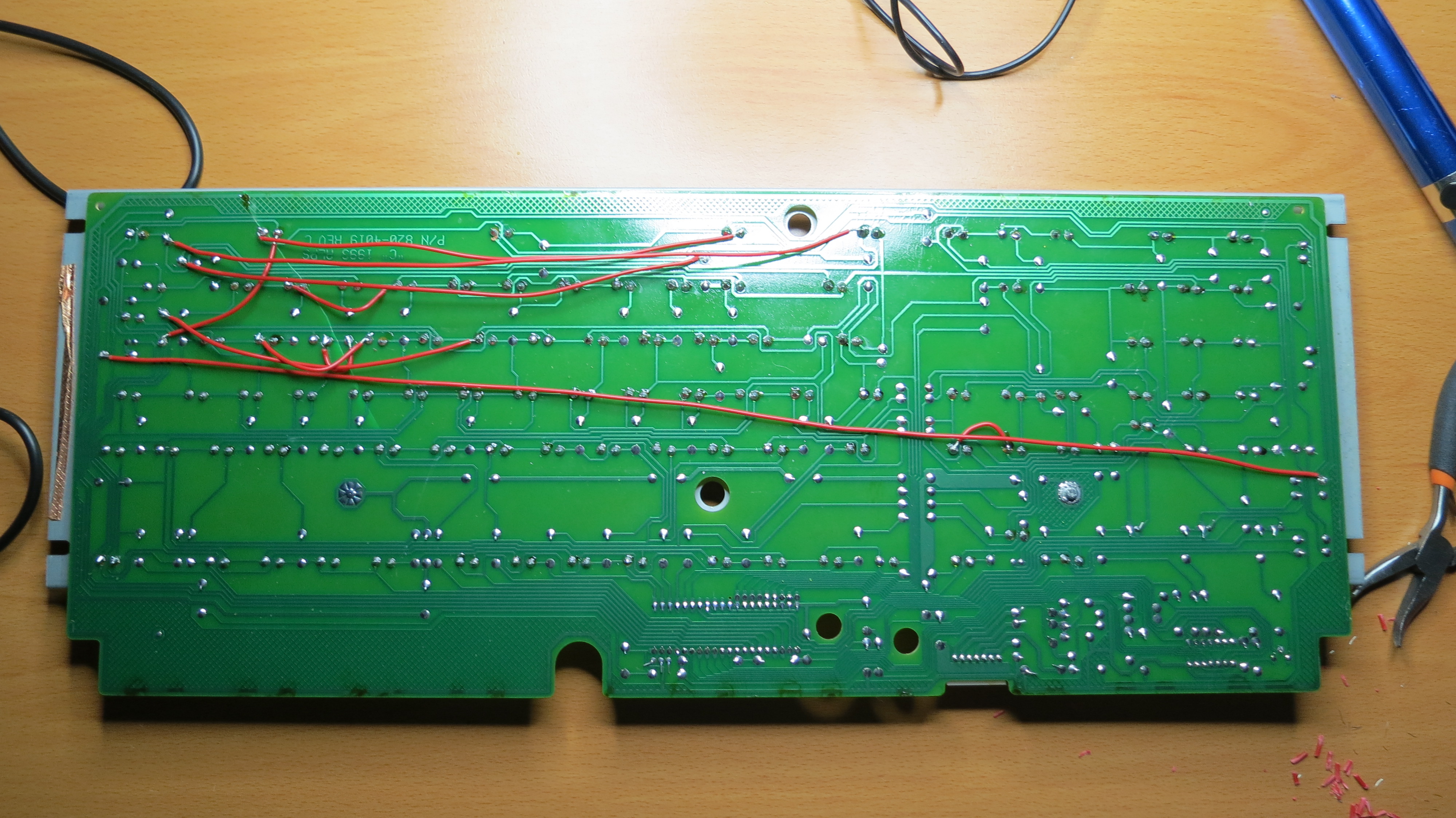

When removing the old switches, I sorta cracked the PCB.. So I had to fix that with a lot of wire.
The result. Happily clicking away on it, and that quiet spacebar is very nice!
It took me many many hours to get it working again, but I think it's worth it! I think I'm even the first to build a keyboard with the new matias switches :evilgeek:
I also decided to put clicky matias switches in, since that would contrast the board to a genuine SGI AT101 .

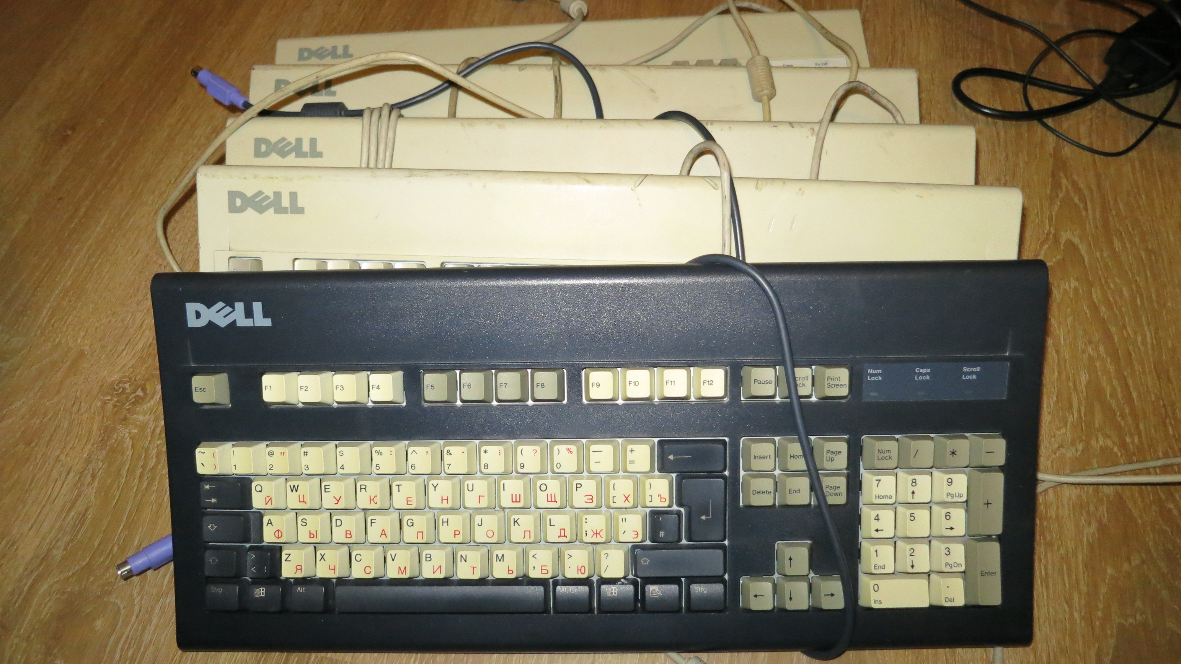

I'm going to do a DELL AT101W next with matias quiet switches.....

I'm going to do the alps black to matias quiet soon on one of my Dells. These alps black really need to be pressed dead centre or the keyswitch experience is mediocre at best.
So many dells.....
So many dells.....

How did you remove old alps switches ?
unsoldering only ?

Gilgam wrote: How did you remove old alps switches ?
unsoldering only ?
Yeps,
I tried to swap the internals, but they completely overhauled the switch and I could not see how to do it. So, from the outside they look the same, but the inside changed.
