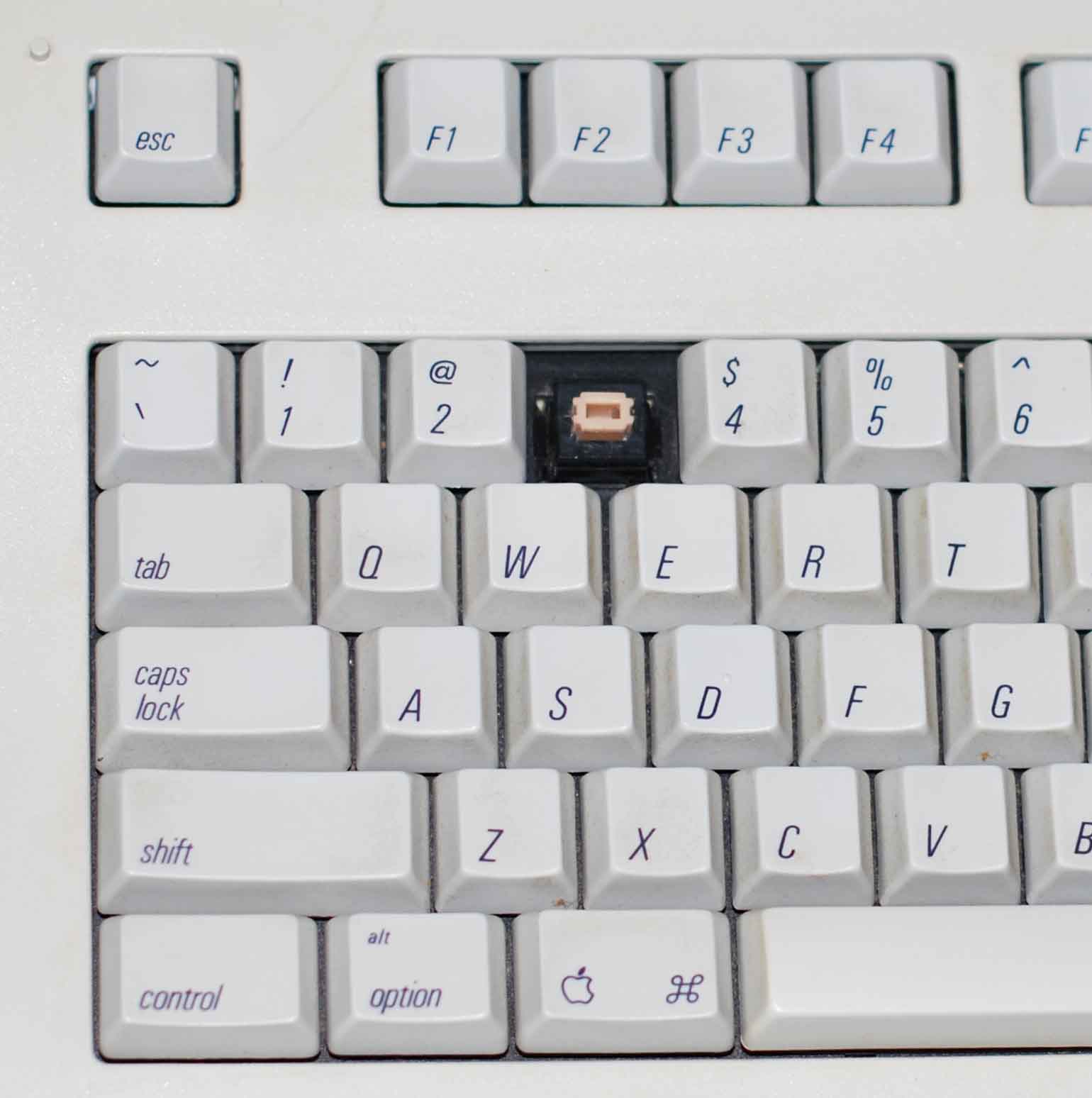

- If these are "salmon" Alps, they're nothing remotely like salmon colour. They're caucasian flesh colour of someone who's never seen sunlight in their life

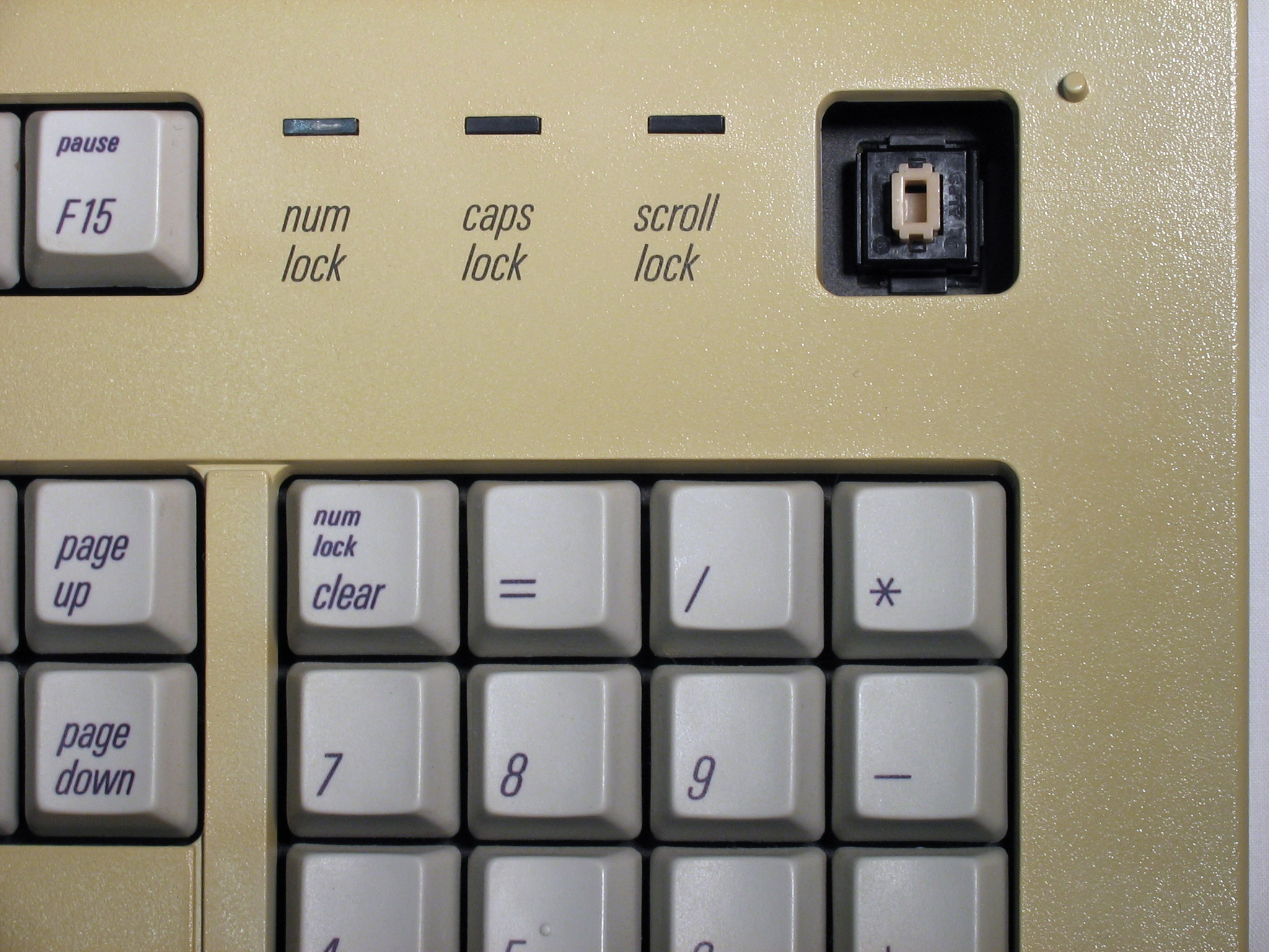

- The lock Alps switch is a new colour (dark grey), and the slider is a special shape. Will snap a pic when I have my camera to hand

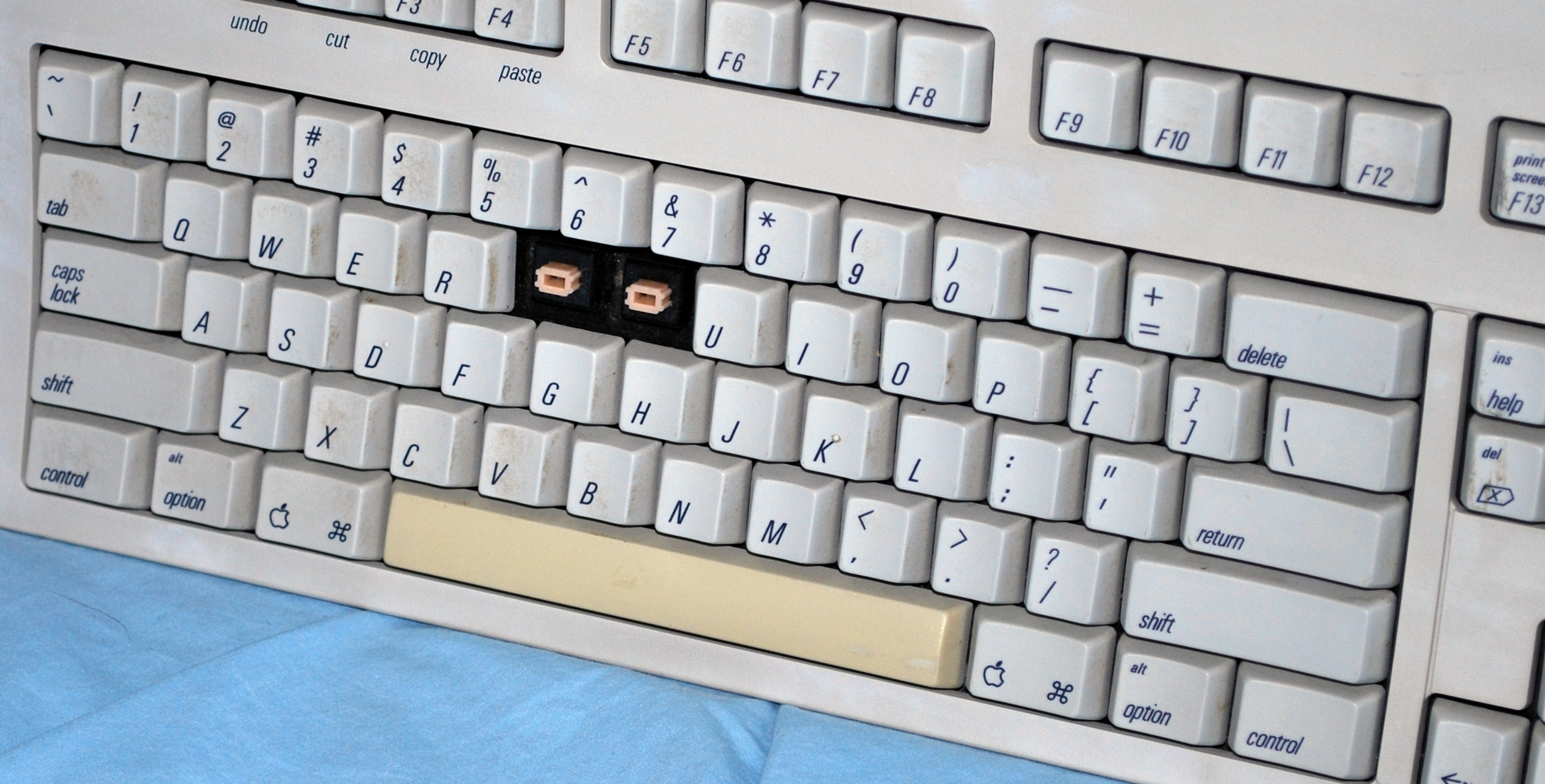

- It's short switchplate. Was NOT expecting that. It's significantly smoother than black Alps, yet not long switchplate. Either the switchplate idea is bogus after all (Edgar Matias noted that switch friction is affected by dye), or it's that NIB switches suck until they're well worn in and smoothed out
- For the record, definitely nowhere near as sharp tactility as blues
- The switches are however a lot quieter than black Alps, although the mounting of the plate itself seems weaker, as tugging on the caps lock (bottom-left key) cap heaves the whole plate up with it unless you hold down an adjacent key, so maybe this dampens the sound
- Both the lock AND key switches say "ALPS" on them, so they're a later model than blue

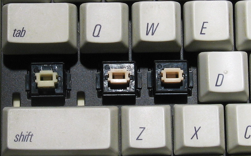

Would these be pink or salmon? If I dig further in my archives, i'm sure I have some snapshots of hybrid orange/pink switches all mingling together on the same board. Genetic engineering?

I call them "skin of a person who's never seen daylight in their life" switches. It's a similar hue to salmon meat, but paler. AFAIK, "pink" and "salmon" refer to the same switch.
I love Apple's persistent sideways mounting of switches. The M0116 seems to only have one sideways switch, the power button. I've just taken a load of pics, including closeups of the push-to-lock switch that show how it actually works (it wasn't clear from the photos posted recently).

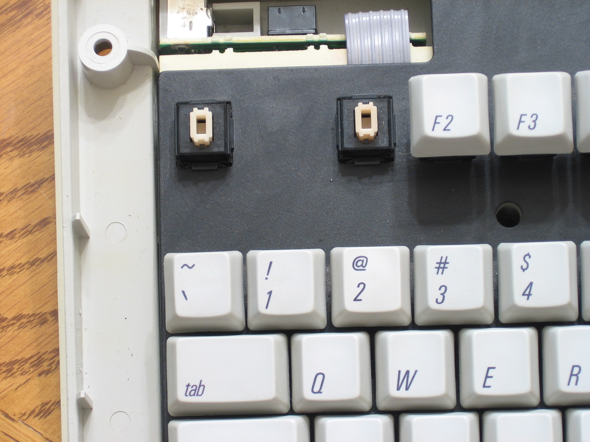

I was going to do one more of the dark grey and salmon side by side, but I'm out of juice :) I had to dismantle the whole keyboard after losing not one, but two springs inside when trying to put switches back together. Hopefully one day I'll figure out how to get the lid back on.
