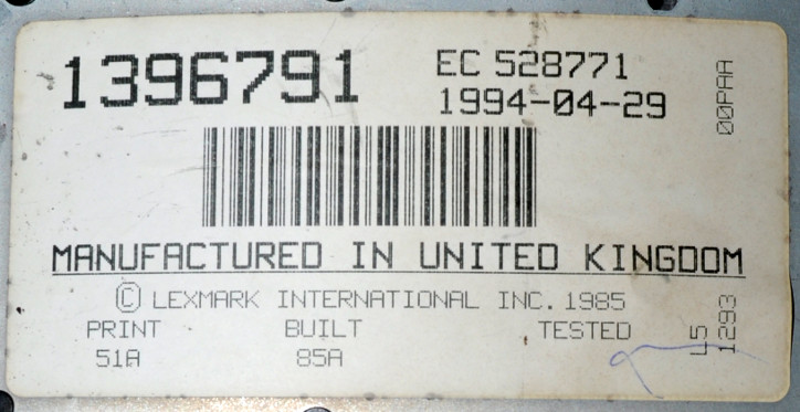

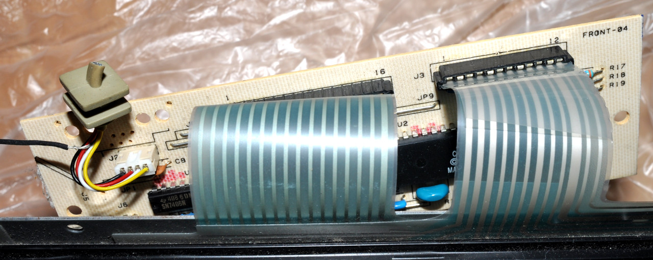

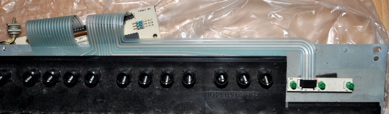

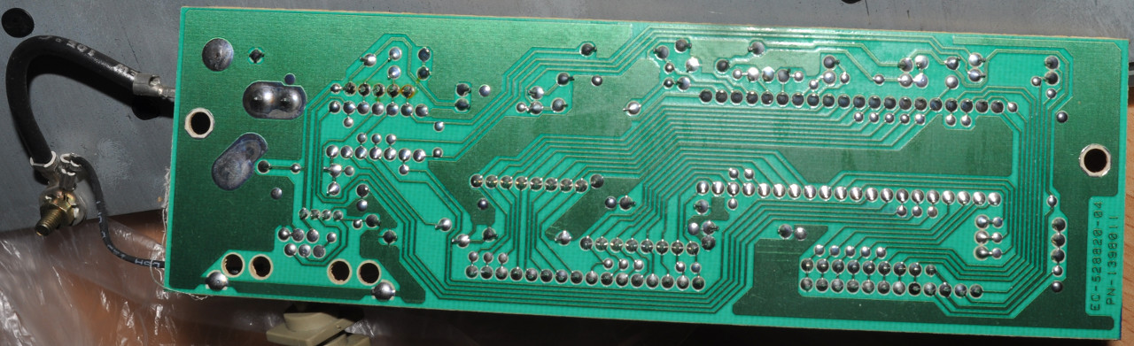

I can take pics of the insides for you if you like. I know for a fact that the traces of the model M assembly do not fit the m5-rd controller.

OK, tried last night. They all fit together but I don't have a lead to check if it works... I have a split lead coming with my industiral m13, this should work for testing right? Also your controller looks different to mine.
