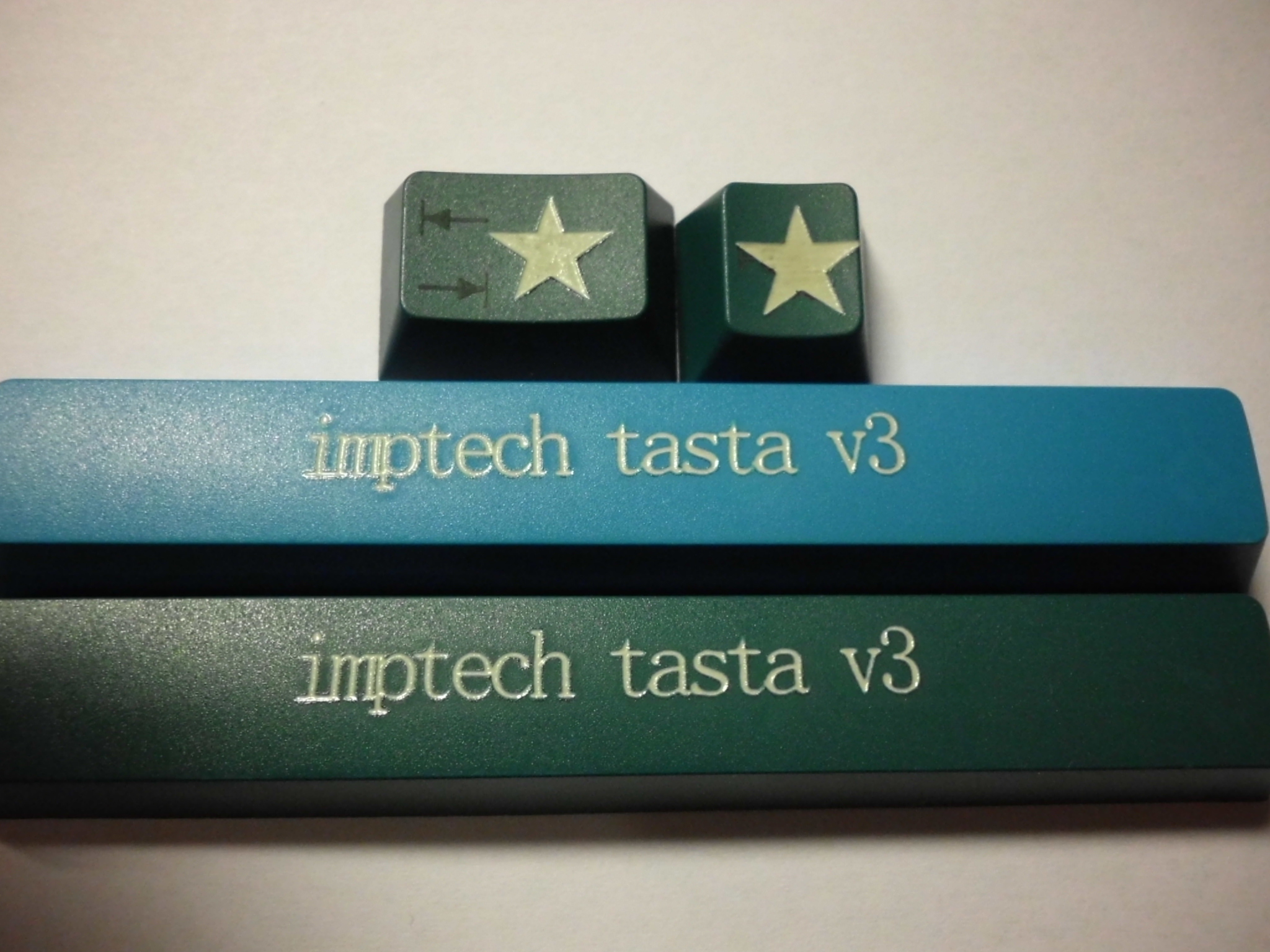

15 Dec 2012, 23:44
Short update - parts and pcbs ordered, half of the parts is already there.
Couldn't resist to play with the laser-cutter of my friends :D
self-dyed keycaps with test laser engraving \o/

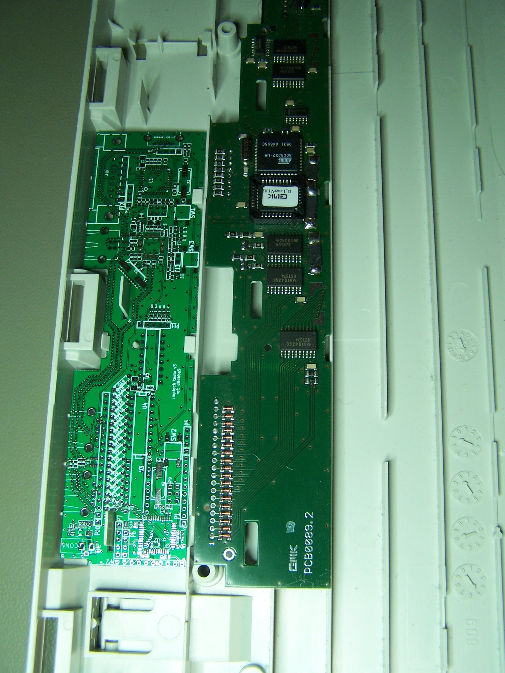

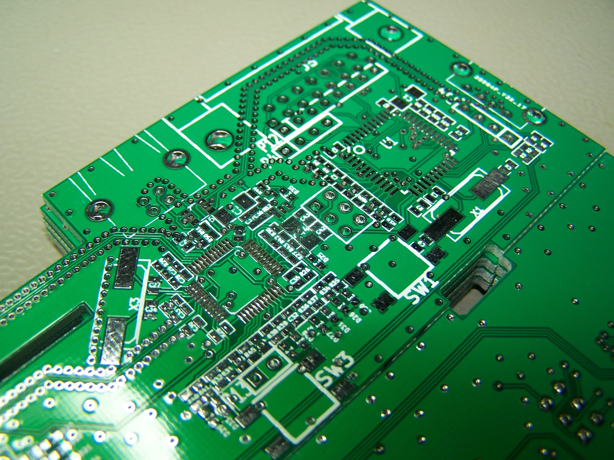

20 Dec 2012, 18:04

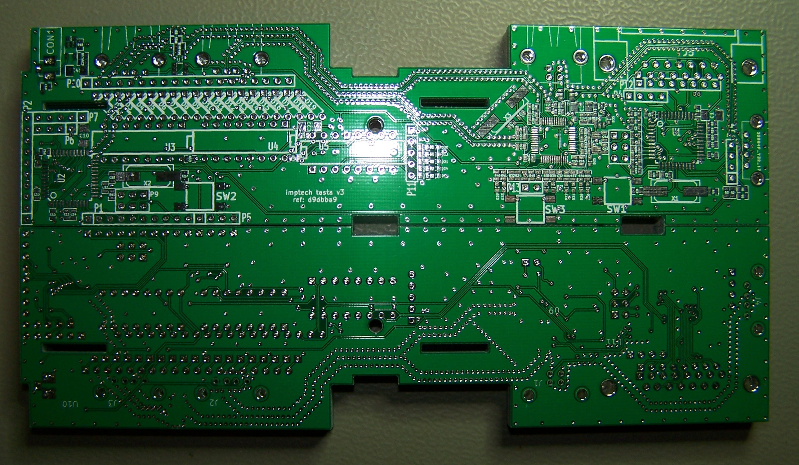

Finally - boards!!1!elf Had to wait all the day for my "express" shipment from DHL and they took twice the amount of taxes if've expected... But here we go:
stack of boards
stack of boards
hub and controller close-up (note the e-check marks :)
it fits in the case \o/
Time to get some food (was too busy lurking all day) and warm up the soldering iron \o/.

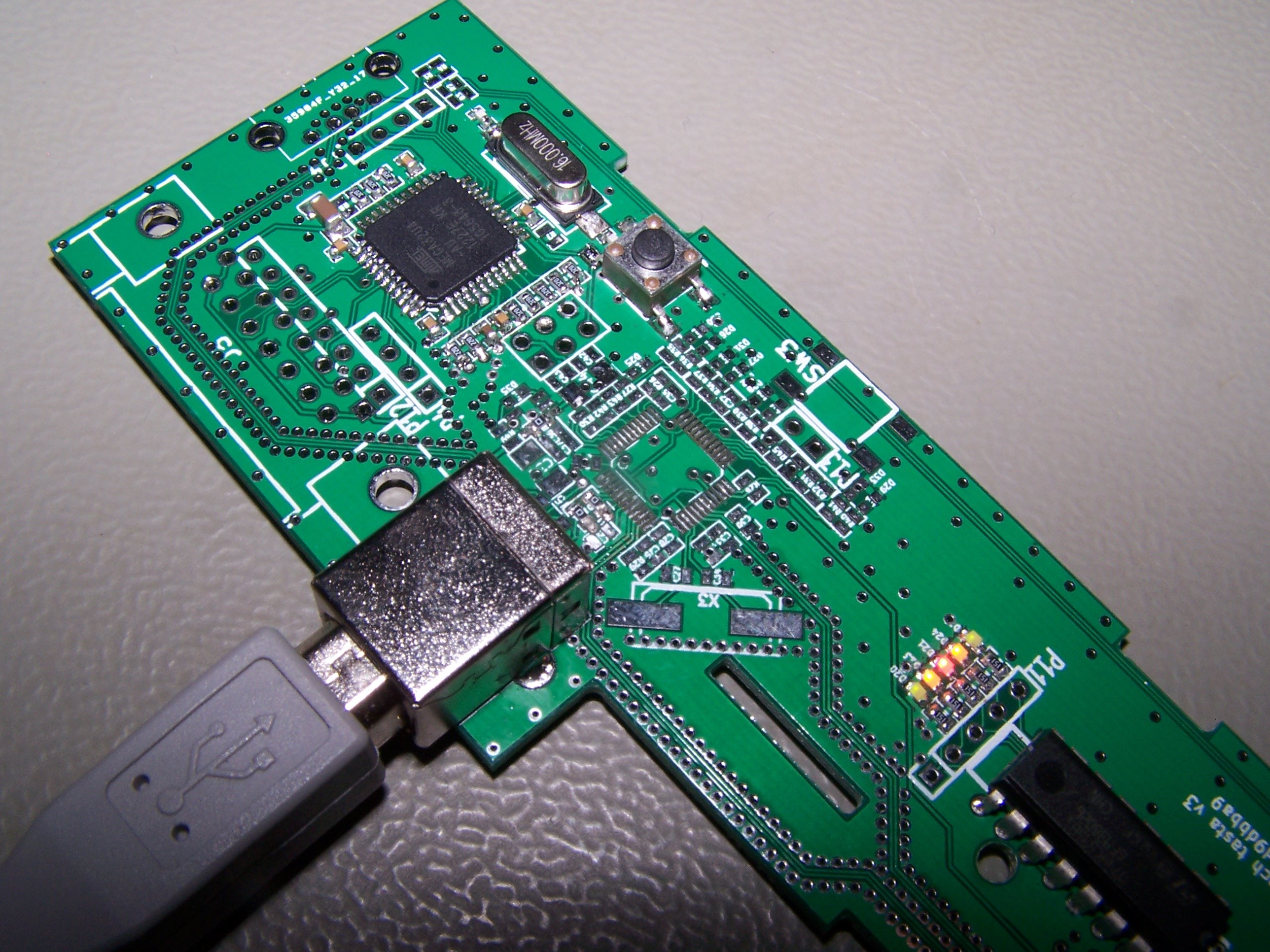

About 11$ each (PCB+shipping+tax). What gave you the impersion of a different manufacturer? Solderstopmask color? I've asked the guy who managed my order, if he's ready to handle the impact of you guys ;) (no answer yet, I don't want to destroy his christmas :)).
First board is working, populated the minimal version (no ESD protection, nor external power or USB-hub - but shiny LEDs :D ):
First working board, minimal version.
The 3 0 Ohm resistors: 1 to skip the power switch (which would normally between host-power and external power) and 2 to go directly from the USB-port onto 32u4s datalines, bypassing the missing hub.
Guess I'm going to use sockets for now (so I can detach the matrix) - don't want to end up with 3 additional keyboards on my desk only because I've soldered the matrix directly to the controller.
One minor bug from the footprint's I've used for the USB connectors: all the pads are covered on the bottom with solderstopmask, don't know why...

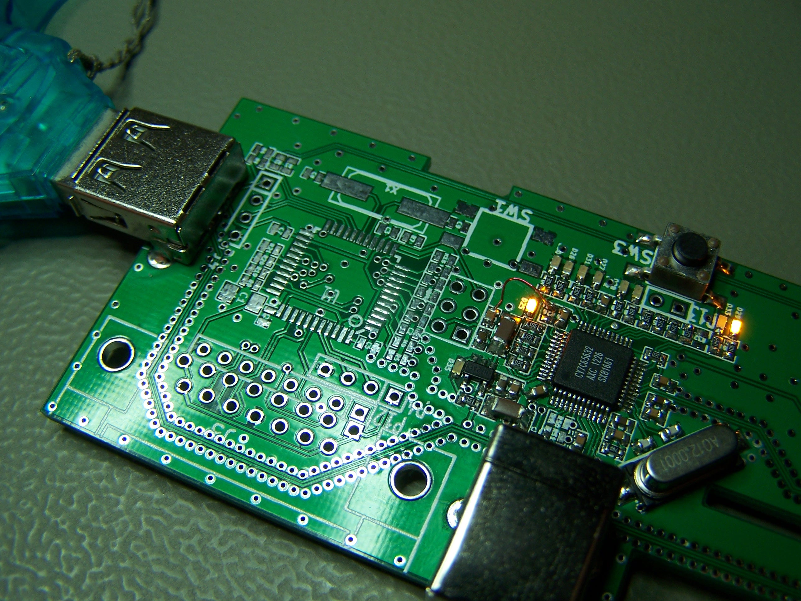

imp
21 Dec 2012, 13:55
Here we go, finished debugging the hub (looked like some bad solder joints or flux residue).
hub soldered and running
The small red wire is only for changing the "gang" mode of the hub to individual power and overcurrent protection (doesn't really matter, since it got the currentlimit on the incoming power line and not existant on the downstream ports).
Would have used the board with my SD cardreader, but "rejected 1 configuration due to insufficient available bus power".... still have to find a fitting plug for the external power input :) (so I can test the selfpowered configuration too).

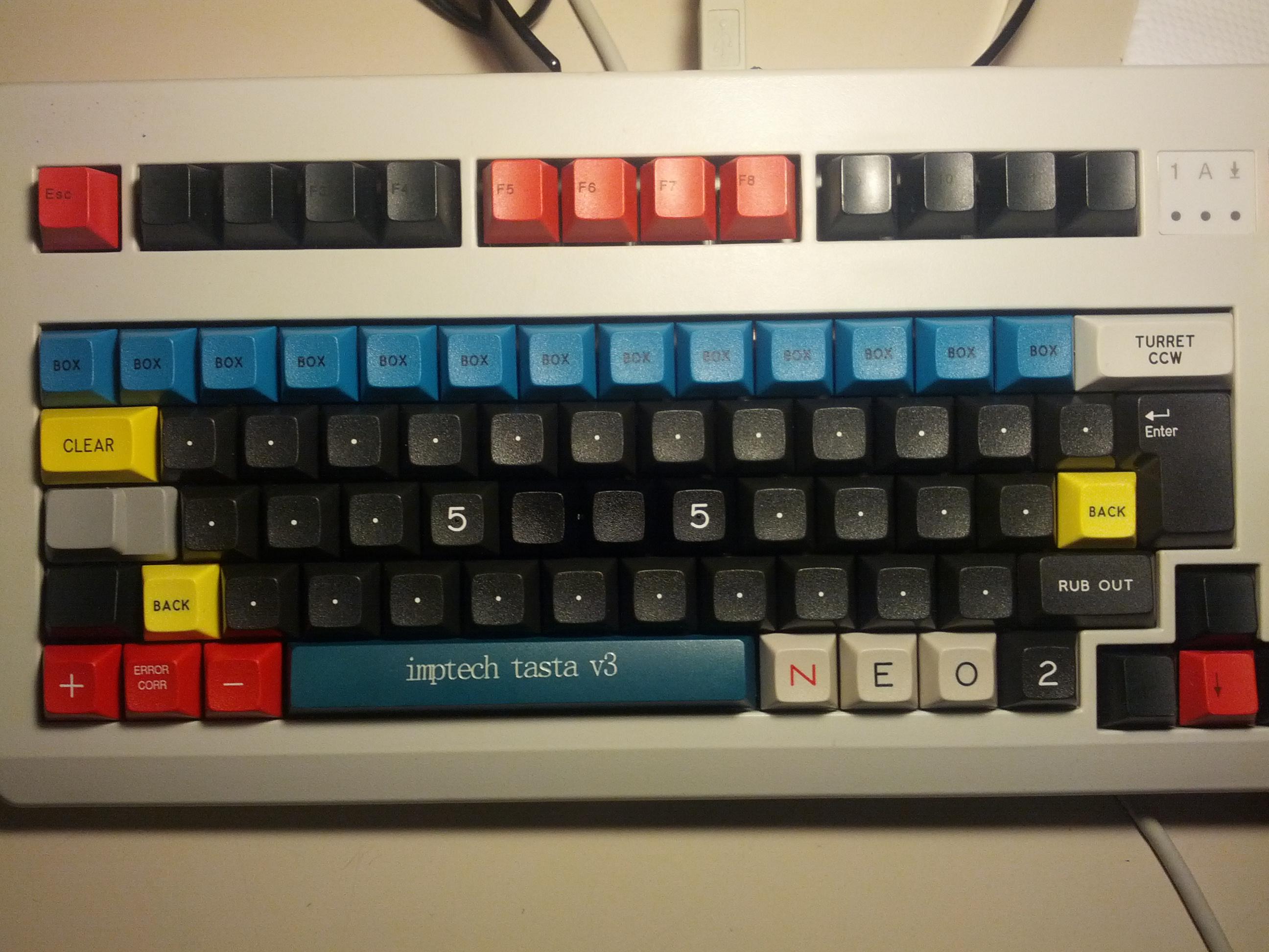

imp
12 Jan 2013, 00:53
Heyho,
the USB hubs caused some trouble... The example schematic from Cypress had all the status leds I've connected too. After reporting random numbers of ports each time I called lsusb... The datasheet mentioned "pin strapping pin foo and bar might enable proprietary firmware functions" - removing all the status leds fixed the problem :).
Speed testing the hub with an usbstick ended by 32Mbyte/s on my laptop (34 while connecting the stick directly). Still want to take a look at the eye diagram.
For the USB port placement, I'm not very happy with it for laptop use (i.e. putting the board on the laptop keyboard). The upstream port is right in the middle of my screen and the two external ports face the same problem. Any suggestions on this for a second iteration?
One fix would be skipping the USB-B jack and to solder the cable direct into it's place and fixating it with a zip-tie (and then using the original exit in the case). Also the same can be done with the two external ones, placing them on the side of the keyboard using the same way. But this causes the same problem that some Das Keyboard users got, cable / usbstick over the mousepad. Vertical ports are might be an option, but then again, you'll get cables / sticks infront of your screen (if this option is possible at all due the internal connection to the matrix - guess I have to make an cutout to get a closer look at it in the assembled state)...
Got my grabbags from ne0phyte today and replaced nearly all my caps, typing on a flat profile now :D.
new keycaps \o/
new keycaps \o/
Sadly I've got no 1.75x keys in that profile nor 1.25x :(.

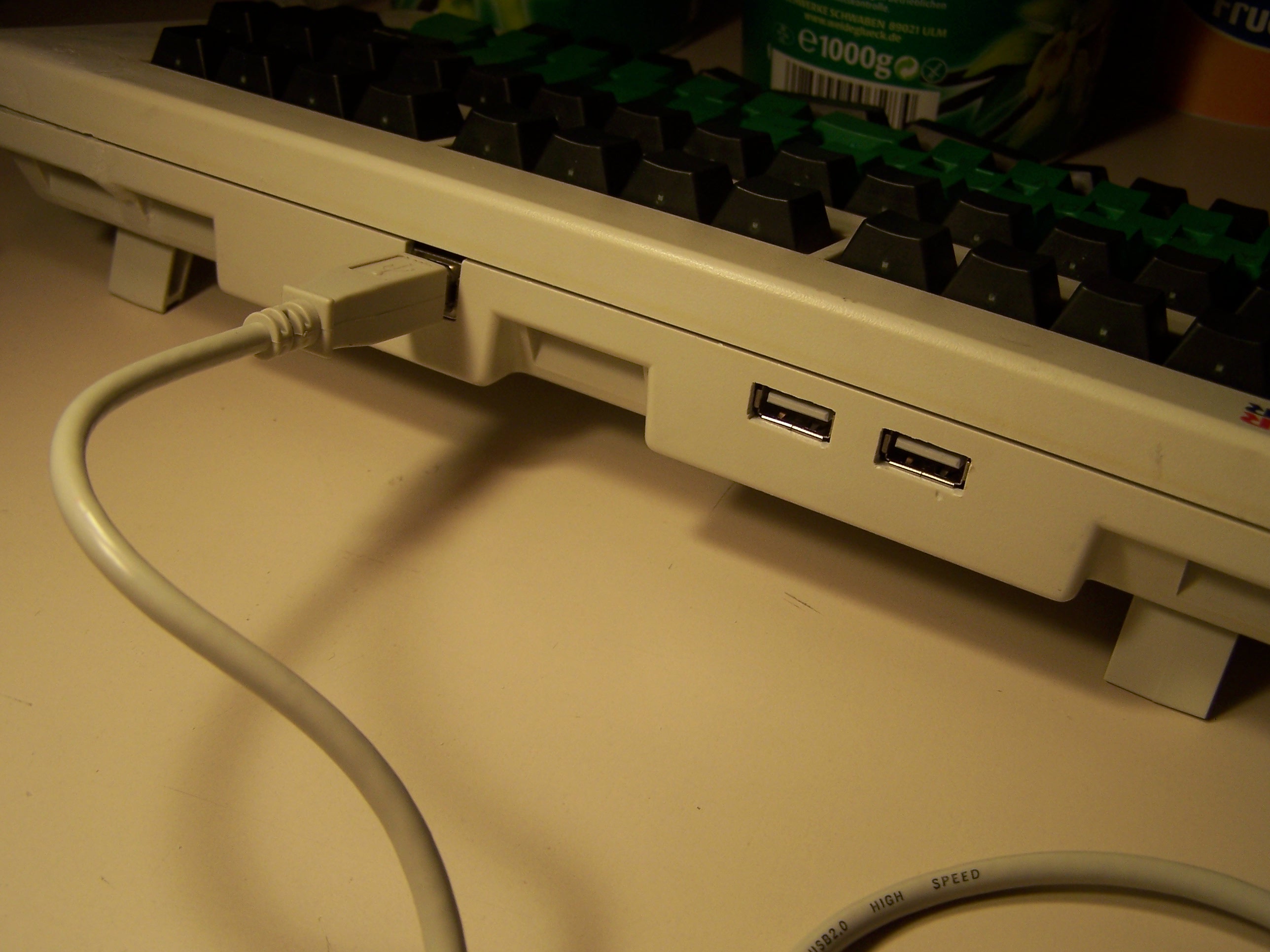

Jmneuv
18 Feb 2013, 21:37
Since i own a freshly cleaned 1800 i'm very excited about your controller project.
About the placement of the usb-ports:
Hmm the 1800 has some very nice flat surfaces at the rear face, perfect for openings. You just shouldn't place the keyboard onto your laptop :P
How about still at the rear, but vertical and pointed away in a 45° angle?
Would make it somewhat harder to hit the ports but could be a compromise.
imp
26 Feb 2013, 22:27
Jmneuv wrote:Since i own a freshly cleaned 1800 i'm very excited about your controller project.
That's where there all the openings are right now :P.
Here is the long promised image from the openings:
USB-ports\power socket
Jmneuv wrote:How about still at the rear, but vertical and pointed away in a 45° angle?
Still not better for my laptop usage :D. Guess I'll have to accept this for now (anyway, the option to move the ports around and solder wires onto the pcb still exists).
For some closeups on the modded case, visit the ABS Sludge thread: http://deskthority.net/workshop-f7/abs- ... ml#p101366 (even if the case material is SB and not ABS, works the same way :)).
