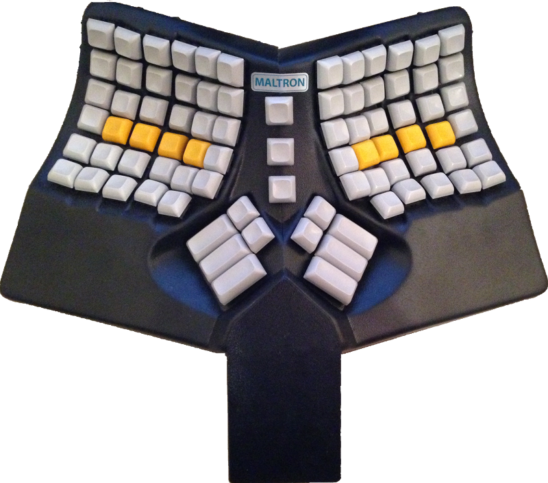

I just get comfortable with one of these Maltron KW and I would like to share my impressions and feelings about the device...
When it arrived it took me 4 days to get it running. This means getting the teensy from morse beep, the default application, to a customized keyboard firmware. Thanks to suka (see above) I only had to configure his version of teensy firmware, which already covered a design with 6 columns per side, a genius solution for reusing thumb keys as modifier keys and normal keys, 4 different layers, a software bootloader trigger, a command mode, a macro feature etc.
I must admit, that I prepared myself for this day by setting up a tool chain on my mac book beginning from the 'AVR-gcc' for cross-compiling the sources, 'teensy_loader_cli' for uploading the compiler output to the keyboard to finally 'hid_listen' in order to have insight to the debug messages.
When unpacking the keyboard I was surprised about its lightness, only 600 gramms! Putting first time my hands in the Maltron bowls felt very naturally. The cherry browns were a little loud when bottomed out and scratchy while pushed down (compared to my mac book keys). Therefore I added black o-rings to the keys, and now I get used to the scratchyness and the keys stopped to rattle when bottomed out. I do not feel constrained by the form (as suka assumed), because it matches perfectly my body.

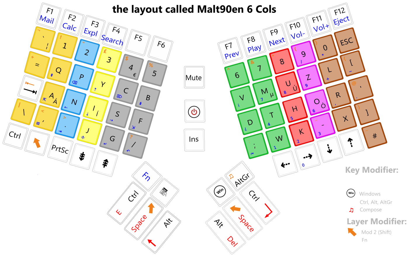

As a contribution to Lilian Malt I first put a version of her malt keyboard layout into the Maltron KW. This will not be the end, since I favour also the world of AdNW (http://www.adnw.de) keyboard layouts optimized for english AND german language.

May I ask if it is a disability that makes you want a keyboard like that? It just seems very tight with your elbows sticking out.
ksweber
10 Nov 2012, 08:49
I want to stay healthy, thats my motivation.When I first tried to move from 2 finger typing to 10 fingers, I realized that I was thereby forcing my hands in an uncomfortable angle and spin. The Maltron is a little bit tented to the middle, has a matrix key layout, a reversed V-shape and cares about different length of fingers, which all helps feeling much more comfortable as on a standard keyboard.
The layout is not too tight and my arms are hanging neutrally down when I position my hands on the keys. I think this is a combination of the V-angle and the distance between the two sides. No elbows sticking out.

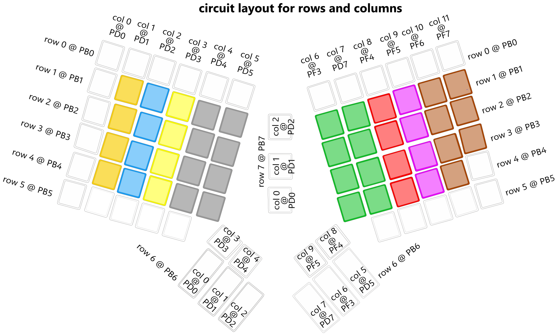

ksweber
10 Nov 2012, 13:15
First job in configuring the firmware was to adapt the circuit layout the Maltron KW had. For documentation reasons I attach the schema:
Circuits without diodes!

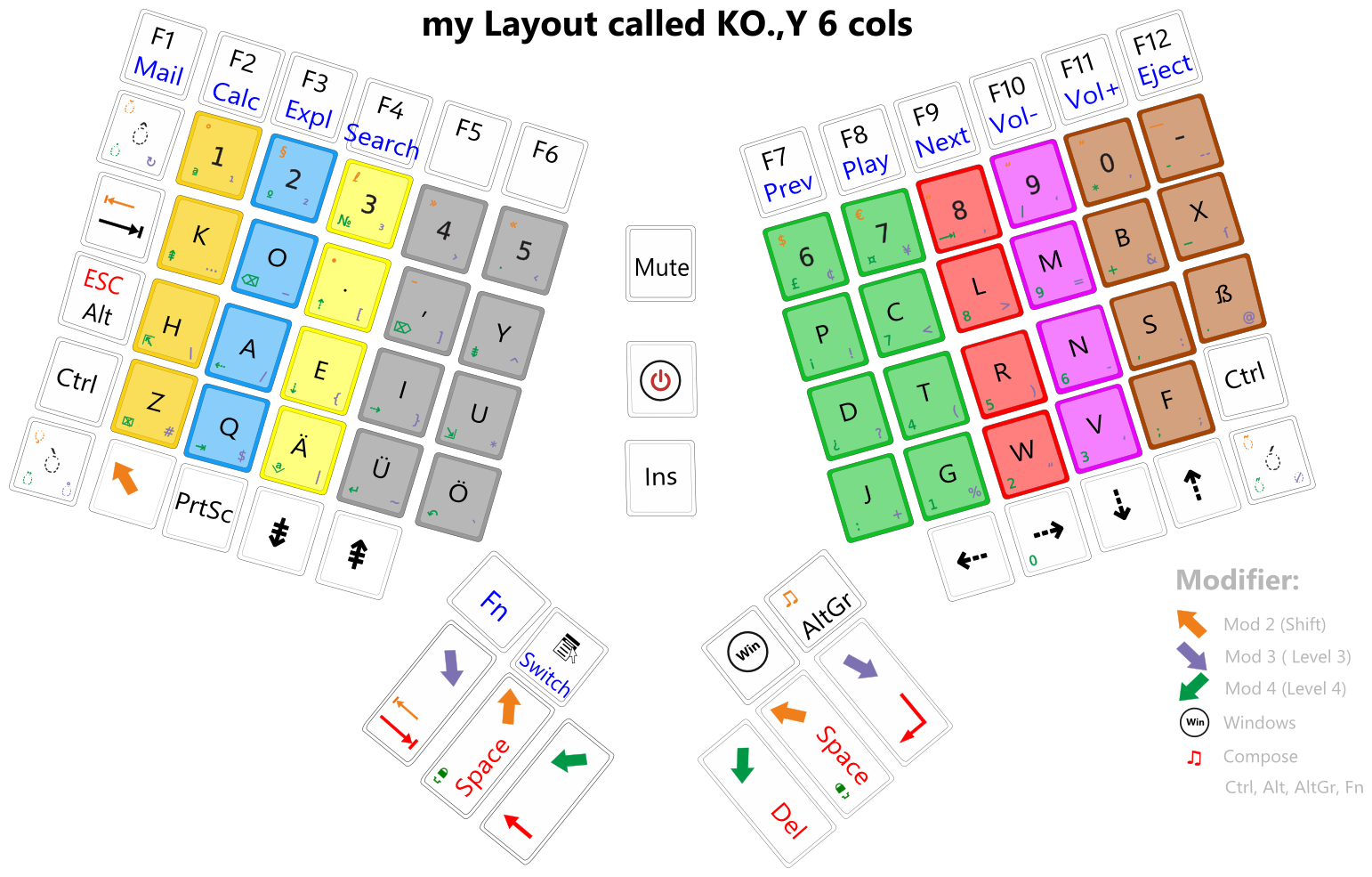

The next configuration duty was to add the prefered keyboard layouts. Beside Malt, I added british QWERTY, german QWERTZ and last but not least my favorite AdNW-Variant:
The KO.,Y layout: mixture of the layers 3&4 of Neo2 and a AdNW-Variant

ksweber
10 Nov 2012, 13:32
What I had to learn about configuration limits of keyboard firmware is, that some characters are not scan-code-able. For instance the liter literal ℓ (Shift+3) and also the 3 dead keys of Neo2 (see corners of the KO.,Y layout) were not configurable. These have to be remapped from one character to another by an operating system driver.

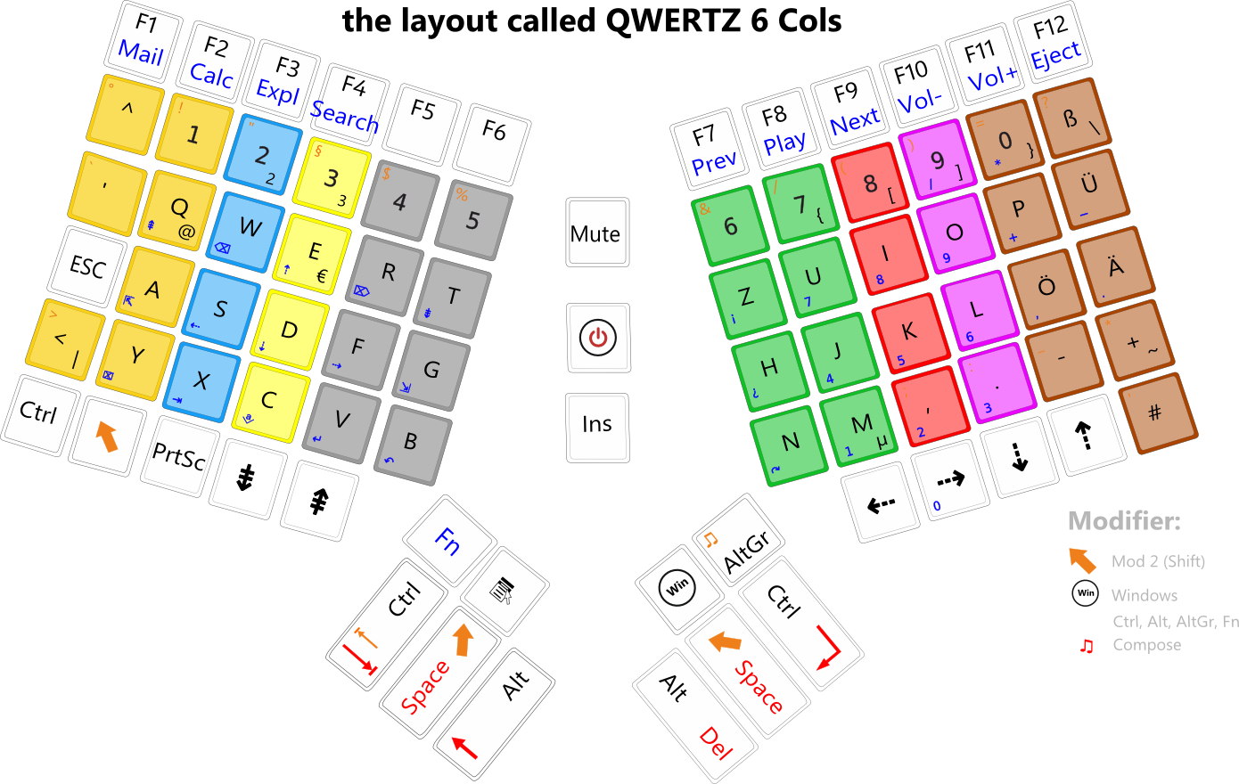

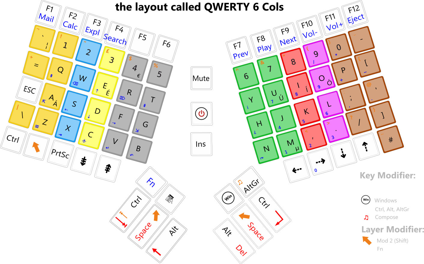

ksweber
24 Nov 2012, 13:33
Probably you are interested how the standard keyboard layouts for british QWERTY and german QWERTZ could match to the Maltron KW:

sordna
07 Feb 2013, 02:16
Interstingly, I can see that Maltron used switches with integrated diodes in this keyboard, however they are not utilized! I see the leads but they are not soldered anywhere...
ksweber
07 Feb 2013, 06:04
Yes, you are right. Between the 2 unused pins of the switches one can see a diode sign on the plastic. Apparently something went wrong here...
