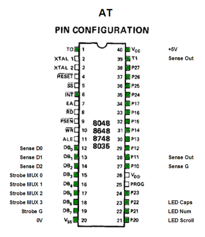

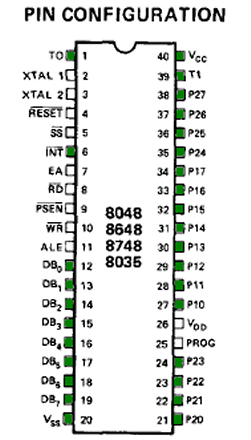

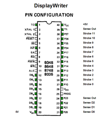

Some of the information here could of course be useful for replacing the 8048 in other, non-IBM, keyboards. The 8048 pins that might be used to scan a switch matrix are marked in green on this pinout:
They are never all used just for reading the matrix. Some will be driving the external interface, and some may be driving LEDs. So a Teensy should have enough pins for any case, just! OTOH, something like a Teensy++ would make it easier to make a logical mapping between the 8048's three 8-bit ports, since the Teensy++ has four full ports (and/or might make physically mounting it in place easier, but more of that later).

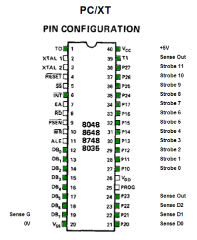

Of the IBM controllers, there's a distinct similarity in pin use between the PC/XT and DisplayWriter (although of course there are big differences in pin use for the external interface):
The AT uses a multiplexer for driving the strobe lines, so it doesn't use many pins at all. This same arrangement is also used in at least some of the 122-key terminal controllers:

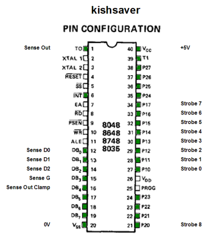

And finally the kishsaver simply doesn't have many keys, so has fewer strobe lines:
edit: updated kishsaver pinout, having discovered that there is a buffer between Sense Out Clamp and Sense Out (unlike the other boards).

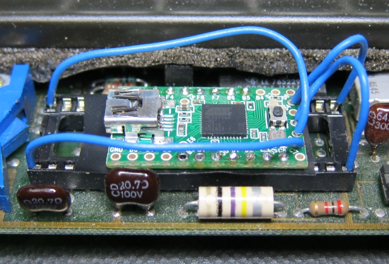

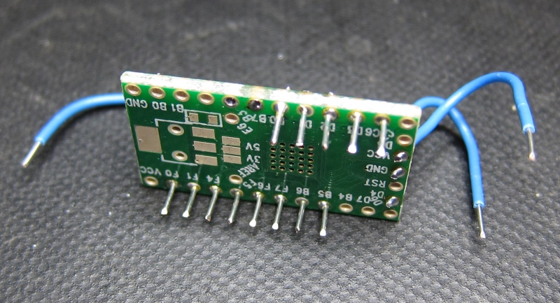

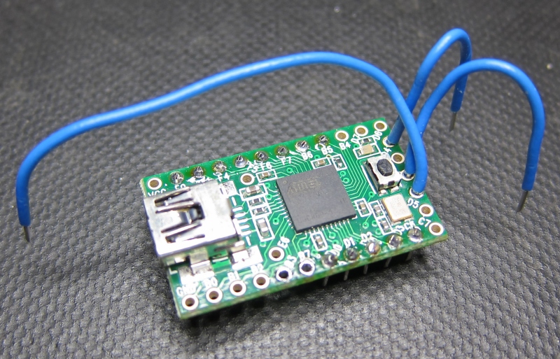

I've started with the kishsaver. Its CPU has been removed and an IC socket soldered in its place. I've fitted the Teensy with some pins made from solid core wire, and some solid core wires for power, ground and the final strobe...
edit: updated this pic now that I've added a fourth wire to connect to the real Sense Out...
Of course, I'll trim the wires a bit more when I'm happy with it!
I picked that position for the Teensy because it covers most of the used 8048 pins, and specifically it lines up PD0 to PD2 with Sense D0 to D2 - those three want to be changed together, so they at least need to be on the same Teensy port. The rest of connections will be read/written individually, so it doesn't matter if they're on different ports.

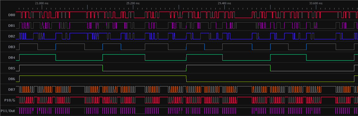

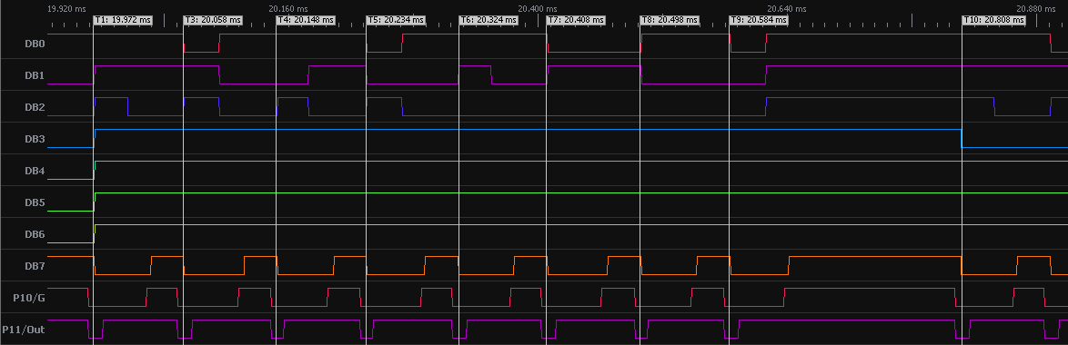

To sniff the logic of the capacitive sensing chip, the AT is good because of the multiplexer - less probes to attach!
A full scan of the entire matrix looks like this:

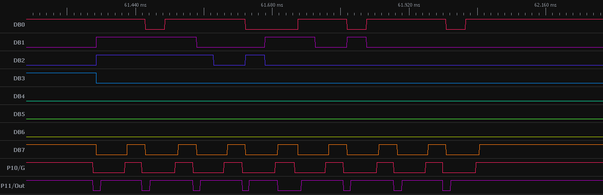

Scanning the keys on a single column (or row, if you prefer), like this:
Note that the Sense D0 to D2 lines (DB0 to DB2) serve a dual purpose - first, they select which key to read, and second, they set a sensitivity level (for which there is a table in the ROM).
When a key is pressed, the sense chip output (Out) goes low, when gated by the G line going high. The fifth key read in this scan is pressed:
This subroutine from the AT's firmware reads a column of 8 keys:

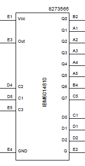

For local reference, here are symbols for the capacitive sensing chips that akurz has used in the kbdbabel schematics.
The 4-channel version (5251 schematic):
The 8-channel version (AT schematic):

I've updated a couple of the pics in the earlier posts because the kishsaver has a buffer connected to the pin it uses to clamp the Sense Out line low. None of the other controllers have a buffer there! Sense Out is the output from the capacitive sensing chip, and is normally connected to two pins on the CPU - one for reading it, and one for clamping it to ground. From the timing, this clamping could be an acknowledge back to the sensing chip - it appears to clear the previous output back to the unpressed state (high).
