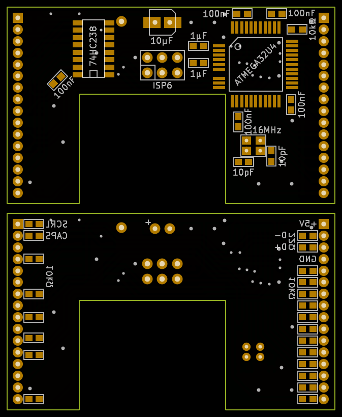

PCB files have been sent for final DRC (design rule checking) at pcbwing.com.
Deadline: 2012-09-09 23:59 CET
Anyone registering their interest before the deadline will be guaranteed their units when they are done and tested.
When the deadline has passed, I think I will set some system up to do the final ordering by email to keep track of everything.
What is this all about?
Ever wanted your Filco tenkeyless to have a programmable controller? Thought it sounded a bit insane to build a Phantom only for this reason? What if you could just simply replace the stock controller daughter board in your keyboard with a programmable one? Why not I say.
With this replacement daughter board you will basically have a Teensy that plugs conveniently into your Filco tenkeyless. There are a number of different keyboard project with code running on the Teensy that should be easily adopted to work with this controller.
The ATmega32u4 chip
This is the same chip as on the Teensy2.0. It is a 16MHz 8-bit AVR from Atmel.
It has 32kB of flash to hold the bootloader, firmware code and key matrix information. The flash memory is read only during normal operation, so it can only be altered when loading code onto it through the bootloader. Both the stock bootloader from Atmel and the open source bootloader from LUFA take 4kB of the flash memory. The very basic code for the Phantom with one single layer key matrix takes almost 9kB. This leaves more than 18kB for custom layers and macros or whatever.
There is 2.5kB of SRAM memory, this is used to run the program and store variables during runtime. It is like normal RAM memory erased when the power is cut.
There is also 1kB of EEPROM memory available, this can be used to store data when the power is off. So any recorded macro or on the fly remappings should be stored here.

I have based this design on my "gen2" Filco tenkeyless. I believe there are no differences compared to the "gen1" keyboard except the higher quality PCB. Electrically everything is the same. I cannot guarantee that it will work for everyone though since there may be differences I don't know about. If your keyboard turns out to be incompatible this would of course be handled somehow. Passing it on to someone else for example, or in the worst case returning it for a refund.
The Filco main PCB that I have reverse engineered is a "gen2" marked "CST-F87/88/89/91-MB V1.1" 2010-11-09, and the controller is marked "Tenkeyless PCBA Rev 2.1-ESD" 2010-08-24.

mintberryminuscrunch wrote:can't this be used with any keyboard (with some rewiring)
You would probably be better off just using a regular Teensy in that case, expanding it in a suiting way if that is needed for the matrix your keyboard is using. This is more or less just a Teensy copy that is modified to work in this particular case.
fossala wrote:Would soldering be needed? Or can you just plug it in?
I am planning to order all components, solder them, load the LUFA bootloader to the chip along with some basic firmware before shipping. The controller daughter board is just push fitted into the main board. You only need to pull the old one out and insert this one in its place.
csimi wrote:I assume this would be the same size as the original Filco one and fit in cases that are not Filco?
If it works with 1st gen TKL I'm definitely interested (or if there's no info on it I'll try myself).
Yes, this is the same size as the Filco tenkeyless daughter board. (The full size Filcos use another daughter board.) I am quite confident that this will work with the "gen 1" tenkeyless as well. Someone at geekhack said his "gen 1" had the same revision of the daughter board.
The original Filco controller can be seen above the arrow keys in one of the pictures in this thread http://geekhack.org/index.php?topic=6557.0

I was hooking everything up on a breadboard, and realised that the diodes on the board are actually mounted backwards to what I thought. No big problem with that except I will need to use pull-down resistors instead of pull-up resistors. Pull-up resistors are built into the ATmega, pull down resistors I will need to solder myself, all 18 of them... They are very cheap, but it is probably going to double the time to solder one board =P
Also $20 was probably on the low side to start with, so I think it is still a reasonable figure.
