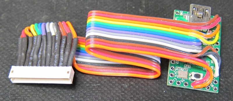

Here is the picture of the controller, the controller connected to the pcb and a picture of the original controller.
What is awesome is that he got a connector so I can just swap over the controllers when ever I want.
If anyone wants any more pictures in anymore detail of a certain area, just say so.
Soarer

Much better picture, thanks Soarer.

Colourful too - great job!
I guess I might also need to invest in heat-shrink tubing, that seems to keep the thing nice and clean compared to the tape I tend to use.

Yes, you should! Tape works ok for insulating, but it doesn't add strength like heat-shrink does :)
It is an investment though - I keep about 5 sizes, most in adhesive version as well. And a heat gun :evilgeek:

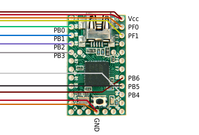

The only code changes needed to make it work on the non++ Teensy were in hhkb/matrix.c, to use PF0 and PF1 instead of PE6 and PE7. And of course changing the MCU definition in hhkb/Makefile.pjrc to atmega32u4. Any pins could be used, but those worked out nicely for the wiring...

It's called nothing more particular than a 'header' :lol: Luckily, there was only one 13-way header with 1.5mm pin spacing at Farnell, and it was the right one... http://uk.farnell.com/jsp/search/produc ... ku=1830906. I have a few spare, if you can't find one.
Teensy fits better than Teensy++, since it's short enough to fit without a 90-degree adapter. I hope fossala will post a picture once he's finished securing it, but we think it can be stuck to the base so that its connector sits in the original USB connector position.

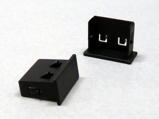

Also I have 2 holes where the USB ports used to be from the original controller, anyway to cover it up?

And you can find a cap for USB receptacle anywhere like this:
http://www.technoveins.co.jp/images/pro ... lck-b0.jpg

hasu wrote:Thick double sided tape works well for me. It doesn't need to give any damage your case.
Thanks, didn't know about them caps, now just to find a matching white.
