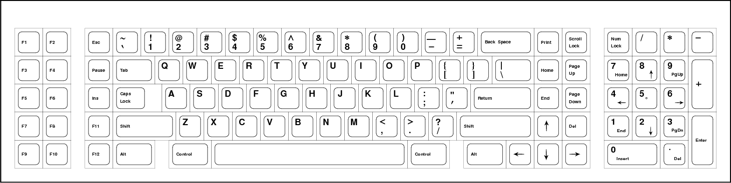

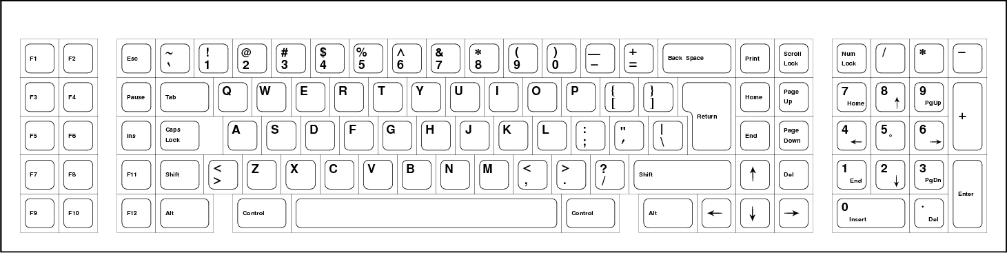

Just an idea what to do with existing key caps:
- CherryRecyclingISO.png (27.74 KiB) Viewed 2233 times
- CherryRecyclingANSI.png (27.37 KiB) Viewed 2233 times

Sorry I don't get it. To me the only "81" caps in need of recycling are offcenter and stabilized n>1*n>=1 caps.

Some of the keys are made for different rows than you placed them on.
Anyway ... I would place Del next to Backspace. (and I have)
I would also rearrange the function keys into two groups in three columns, like this:
| F1 | F2 | F3 |
| F4 | F5 | F6 |
| F7 | F8 | F9 |
| F10| F11| F12|

Findecanor wrote:Some of the keys are made for different rows than you placed them on.
I would also rearrange the function keys into two groups in three columns, like this:Code: Select all
WWW WGG GGW WWW
Not a good idea, unless the key caps are all in the same color.
Also, I know they are in wrong rows, but the 'normal' layout is boring.

Not much.Djuzuh wrote:Won't the profile differences mess everything up?
On the left, everything is in row 1, the rest is at most one row further down than usual, which should be OK.
Except for Del.
