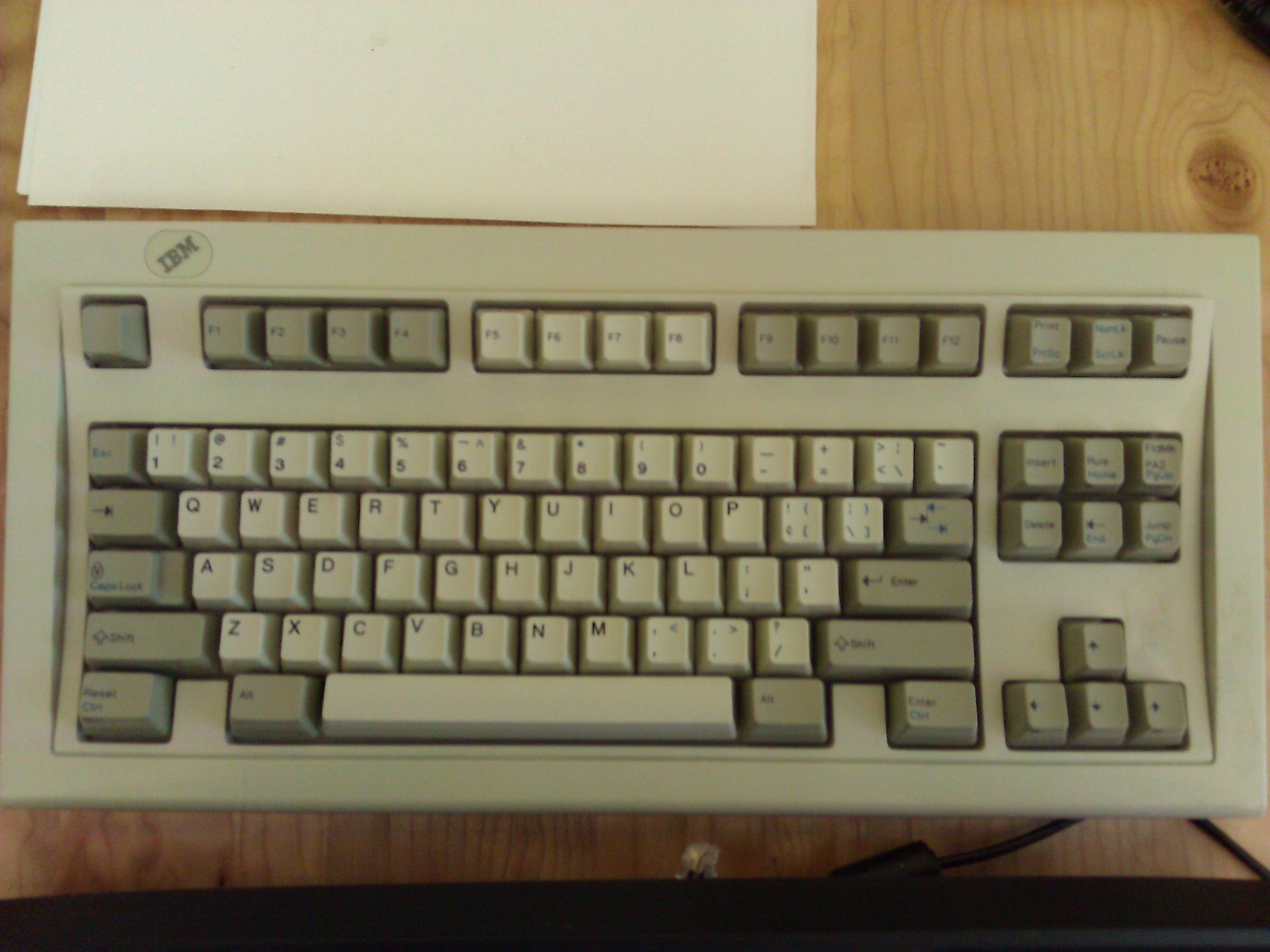

I want to use a teensy 2.0 with soarer's code to make an SSK that I will finaly get my hands on USB and hardware dvorak. That part is faily strait forward. But what I also want to do is to turn it into a Sun type 3 (HHKB) layout like this http://geekhack.org/attachment.php?atta ... 1320600118. Is there any way I could do this with soarer's code?
Any help would be good, Thanks guys.

Nicked it and uploaded here, hope "theferenc" doesn't mind. It is only from his for sale thread.

Hm...can't really figure out from the picture what you're trying to do but if it is just layering stuff then yes, Soarer's code has splendid support for that.

It's not. Look at the top line where backspace normaly is. There is membrane traces that send a different signal than the rest.

Maybe this picture makes it more clear. Image

Hm afaict that should only be simple remaps. How do you activate those blue functions anyway?

I don't want those blue functions. That just happends to be the only SSK I know of that has been "software" converted into a Unix (sun (HHKB)) layout.

Hm...well you can remap keys and you can also create macros if you want some shifted key. I don't have a sun type 3 or hhkb but if you tell me what specifically you're worried about I will simply try. :)

fossala wrote:It's not. Look at the top line where backspace normaly is. There is membrane traces that send a different signal than the rest.
No problem, assuming that key sends the same scancode as the corresponding key on a 101 (or in fact any other scancode that is mapped to a HID code), which it probably does. Or I can easily add a mapping. On a 101-key its code is 6A, which is mapped to INTERNATIONAL_3. Pretty sure it will be the same on an SSK.

fossala wrote:What would be best. Do the hardware mod the use XEV or something to check the scancodes? Then rig it up with a teensy with the right firmware?
Just hook it up with my firmware and use hid_listen to check on the scancodes :D
In fact I'm very sure it will be 6A - it's the Yen symbol for Japanese keyboards :ugeek:
