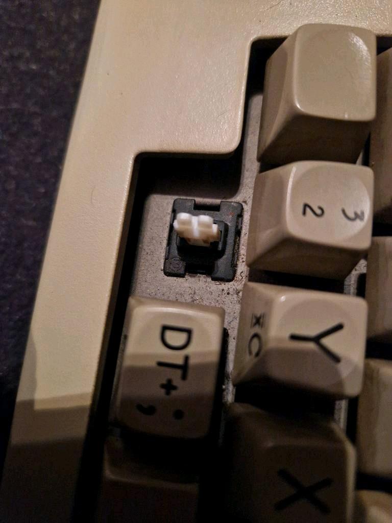

Anybody got an idea of what that switch could be ? wiki/Marquardt_Butterfly ? :?:

looks different to the buitterfly switch
wiki/Marquardt_Two_Fingers_Typewriter_switch i think its this one

inozenz wrote: 08 Nov 2022, 14:54 looks different to the buitterfly switch
YES thats it
