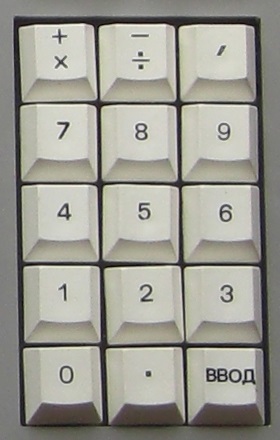

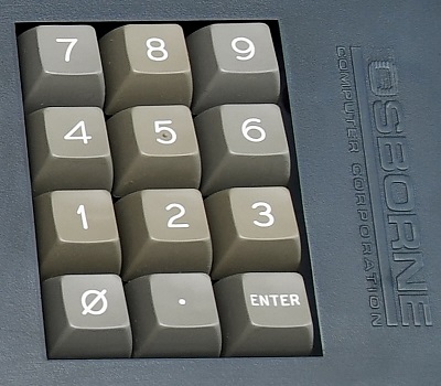

Back in the day, adding a simple 4×3 block to the right-hand side of the keyboard, to be able to comfortably type numbers, was quite the improvement.
4×3 numpad.
4×3 numpad.

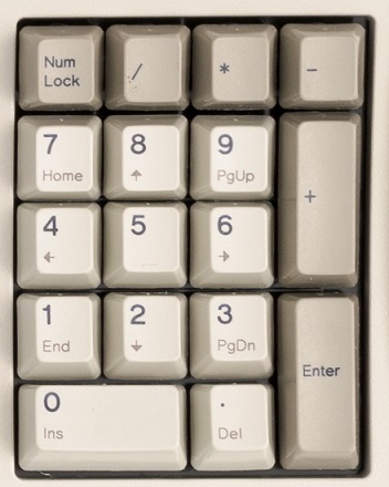

... and then up to 5×4, the size and shape that was fixed and codified in the Enhanced Layout; there have been no major changes in the last four decades.
5×4 numpad (enhanced layout).
The “common” 5×4 numpad has the digits 0 to 9, a period (or a comma, in some national layouts), an Enter key and the four most common symbols (the four basic math operators: +, -, * and /), as inspired by pocket calculators. And yet...

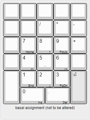

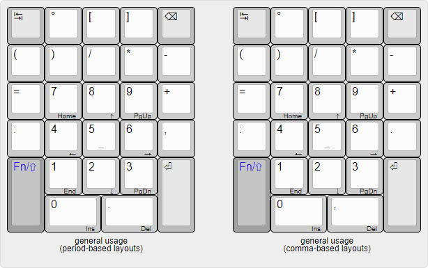

Adding one row wouldn’t be enough. Adding one column wouldn’t be enough, either. Two rows or two columns would be unwieldy to operate with a single hand. Adding one row to the left and one column above (for a maximum of 30 keys) seems best. Also, four decades (and more) of users’ muscle memories constitute an unavoidable mandate to keep the basal assignments unchanged (with three exceptions, as noted). This, then, would be the starting point:
Numpad's basal assignments.
Other than the extra keys, the main differences are:
  • Numpad+ is split onto two keys.
  • The assignment of Num Lock in the top-left corner is shamelessly erased. Sure, it needs to be available in the keyboard, for compatibility, but there is simply no valid reason to maintain it in the base layer, occupying prime real state, to boot. Heck, IBM itself moved Num Lock to Shift-Scroll Lock on the SSK back in 1987, and that’s fine and dandy, and should have become the standard long ago (i.e.: 1987).
  • Numpad0 is shrunk to 1.5U, while numpad-period grows to cover its space. Given the importance of the number zero, it was important to avoid shrinking its key to 1U, but keeping it 2U wide complicates things for left-side numpads. Making both keys the same width, as was done in some old terminal keyboards, is best. It’s for the same reason that the bottom-left key is 2U tall, to mirror the numpad-Enter key.
Note that splitting the 2U keys, or joining up the two 1U keys above them into single 2U keys is not unfeasible — on IBM Model F/M keyboards this is trivial, while on modern custom keyboards, PCB makers know well how to make “holes” for both possibilities.
With the hardware more or less decided upon, it’s time to start populating the key assignments, and this is where divergence starts.
Generally speaking, the four more often-requested or custom-implemented key assignments are, in rough order:
  • Backspace
  • Tab
  • Equals sign ('=')
  • Comma sign (',')
Other assignments vary wildly, as will be seen below.

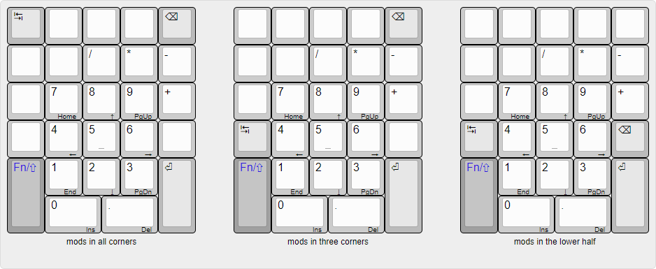

We should start with the modifiers. The bottom-left 2U key should be an Fn key (doubling as Shift on some keys, to be seen later on). Tab and Backspace naturally fall on to the top-left and top-right corners... although there is something to be said about the convenience of moving them to the lower half of the numpad, if their expected usage frequency should be high enough (after all, the hand should be mostly on rows 3 to 6, move up to row 2 with less frequency, and all the way up to row 1 occasionally).
Numpad's modifier keys placements.
Although each and every user will have his/her/its/their own preference, let’s go for now with a “mods on corners” scheme. With the basal assignments and modifiers already in place, we should place the needed and welcome additions. Let’s start with a numpad intended for general usage.

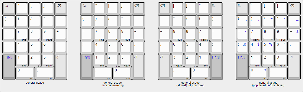

Besides the already mentioned comma and equal signs, the colon sign, parentheses and the degree sign (the only non-ASCII character... so far) all come naturally to mind as often-required.
Numpads for general usage.
The English (en-US and en-UK, among others) layouts use a numpad-period key, while many other layouts (German and many of its derivations, Portuguese (Brazil), etc.) opt for a numpad-comma key. Placing the comma above the Enter key on the former group and flipping both on the latter both preserves compatibility with the extant national layouts and allows both to be comfortably used, as both signs are, indeed, frequently used. Note the placement of the colon, also a frequently used symbol when mixed in with numbers; its usage on time markers is, by itself and even if all other usages were to be discarded, enough to merit its placement in one the keys closest to the digits.
The symmetrical nature of this numpad allows for easily mirrored versions.
Variations on the numpad for general usage.
Some people like their numpad fully mirrored, some partially, some not at all. In my personal experience using a left-side numpad, I’ve found that swapping only the numpad0 and numpad-period (or numpad-comma, as the national layout may dictate) keys works best for me.
The Fn/Shift key can be used to access a few extra symbols that are not as frequently used but are nevertheless convenient to have on the numpad.

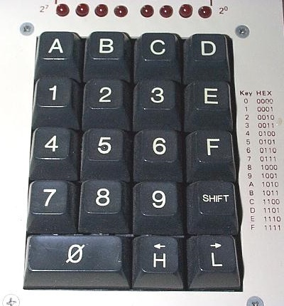

Hexadecimal numbers have been around for quite long in our industry, and yet they have barely been subject to proper input mechanisms. A couple “hexapads” in old keyboards are known, arranged in a 4×4 key block:
4×4 numpad for hex numbers.
... but this would clash with the muscle memory of modern users. In not few cases, the numbers A to F were shoehorned into a 5×4 cluster, resulting in a rather inelegant arrangement:

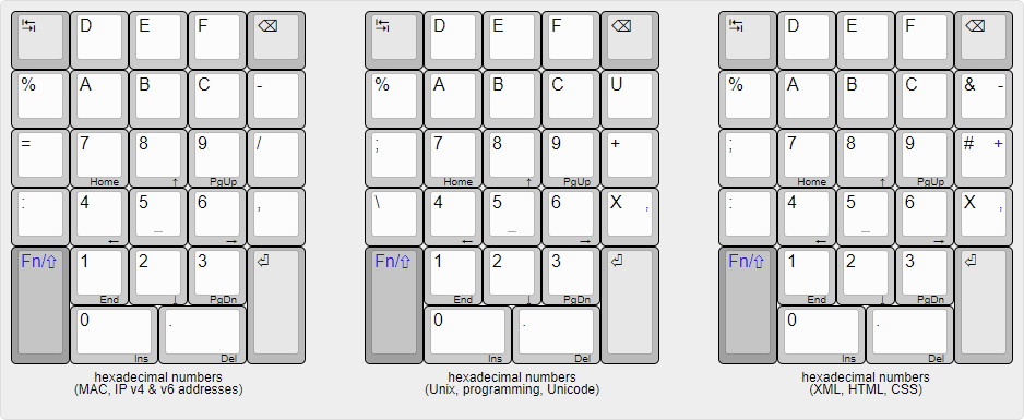

5×4 numpad for hex numbers.
It’s just best to take advantage of the sixth row and keep the logical progression. But then, the associated typographical symbols (and letters) vary wildly from computing context to computing context, to the point that we can easily design three different (modern) hexapads for distinct sets of needs:
Numpads for hexadecimal numbers.
Note how here referring to the bottom-left key as Fn/Shift pays off: thinking of it as Fn allows dissasociating numbers from symbols for the “additional characters” layer, but it’s best to think of it as Shift when dealing with letters, as most of the time they will be wanted as lowercase, but sometimes in uppercase (contrast, say, "\u00f3" with "U+00F3").

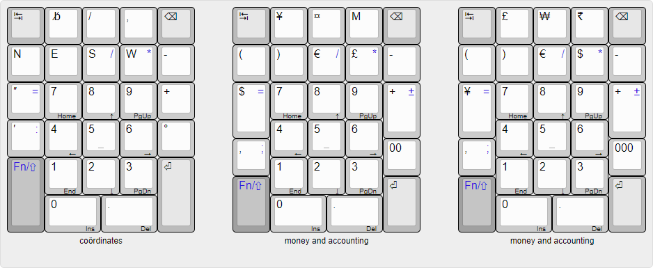

Numpads for coördinates and financial contexts.
It's easy to see people who type coördinates a lot clamoring for a numpad like the above (or, more probably, calling it a decent enough starting point and then piling on adjustment requests). People in financial institutions might get a kick out of the two financial-oriented designs above (note the hardware variation, where two alphas have been enlarged to 1.5U in height).

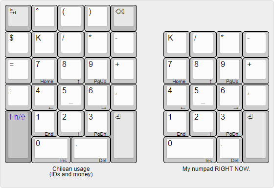

The idea of adjusted designs doesn’t have to be just for industries — it’s easy to see the benefit of general-use numpads “localized” for different countries. For example, in Chile, ID numbers are typed in a lot in all kinds of contexts; these have a modulus-11-based verifying digit, where K stands in as the 11th one (so: 12.345.678-5, 12.345.684-K, etc.) and it stands to reason that adding said letter would be a very welcome addition, even if everything else was left unchanged. The currency symbol ("$") is also used a lot. It makes sense, then, to pull in something like this:
Numpad(s) localized for Chilean usage.

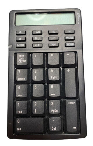

I'll attach a pic of the number pad I currently have. It's a Targus PAUK001 v.3.0. Works on both Mac and PC (and in my Linux VM). USB. They're $5 to $20 on ebay. You can send results of the calculator to the computer. The little arrow key is a backspace.
s-l500 - Copy.jpg (27.7 KiB) Viewed 5290 times
As far as data entry and accounting are concerned, you really need a number pad. I suffered just doing my own budget. Also, I wouldn't like having to press a FN key combination to get to = / or *. I'd also want both a 00 and a 000 key. I think I could live with the arrow keys and PgUp/PgDn, etc. keys just in one block and not on the number pad, tho.

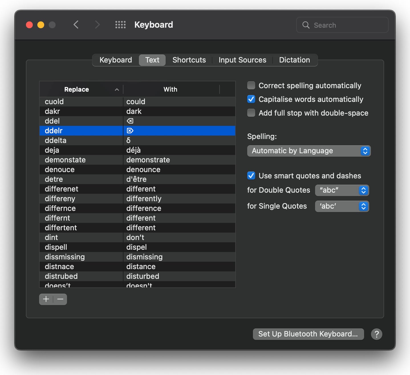

Don't tell anyone, but I use ⌫ and ⌦ so much in certain contexts, that I snuck them in onto my preferred national layout. ;)
29 Aug 2022, 13:05
Good ones! I'll sneak them onto my extended list…
Screenshot 2022-08-29 at 12.02.05 pm.jpg (115.15 KiB) Viewed 5095 times
Mnemonics also have a place. I've already quite enough things triggered from modifiers + my Backspace key. :D

These are some interesting points you bring up, and I've actually been playing around with various numpad related edits myself lately.
I want ( and ) on my numpad, since I use those frequently and don't like them stuck on a shift layer. How are you guys actually sending all these characters? Right now I just have a soarers macros for shift+9 and shift+0, but that seems... inelegant to me. Is there a way (with Soarer's or otherwise) to send characters directly?
30 Aug 2022, 18:22
Johnbo wrote: 30 Aug 2022, 17:56 These are some interesting points you bring up, and I've actually been playing around with various numpad related edits myself lately.
Keyboardery, in this regard, functions in two separate levels: the keyboard sends a scan code (not a character), and the operating system translates said scan code to a character by looking it up on a predefined table (this is the "national layout"). That is why, for example, pressing the C10 key, which always sends the 0xC0, produces ; (if you've beforehand told the computer this is an "English (USA)" keyboard), Ñ (if Spanish has been selected instead), Ö (German), Ç (Portuguese), etcetera.
In the case of the numpad, it's the same thing, only the amount of scan codes defined for it is rather lacking, and so is support in operating systems (for example, scancodes for numpad= and numpad-comma do exist, but Windows happily ignores both), which forces the usage of macros... that, due to the two levels described above, are national-layout dependent: Shift-9 and Shift-0, in your case, for the parenthesis signs, but Shift-8 and Shift-9 in mine.
It is, indeed, inelegant.

Interesting topic. The Focus FK-5001 has a large numpad for an integrated calculator which is close to the number of keys you’re suggesting. I’m not sure if they send scan codes in KB mode though. If they did it could be possible to remap the scan codes and use relegendable keys.
