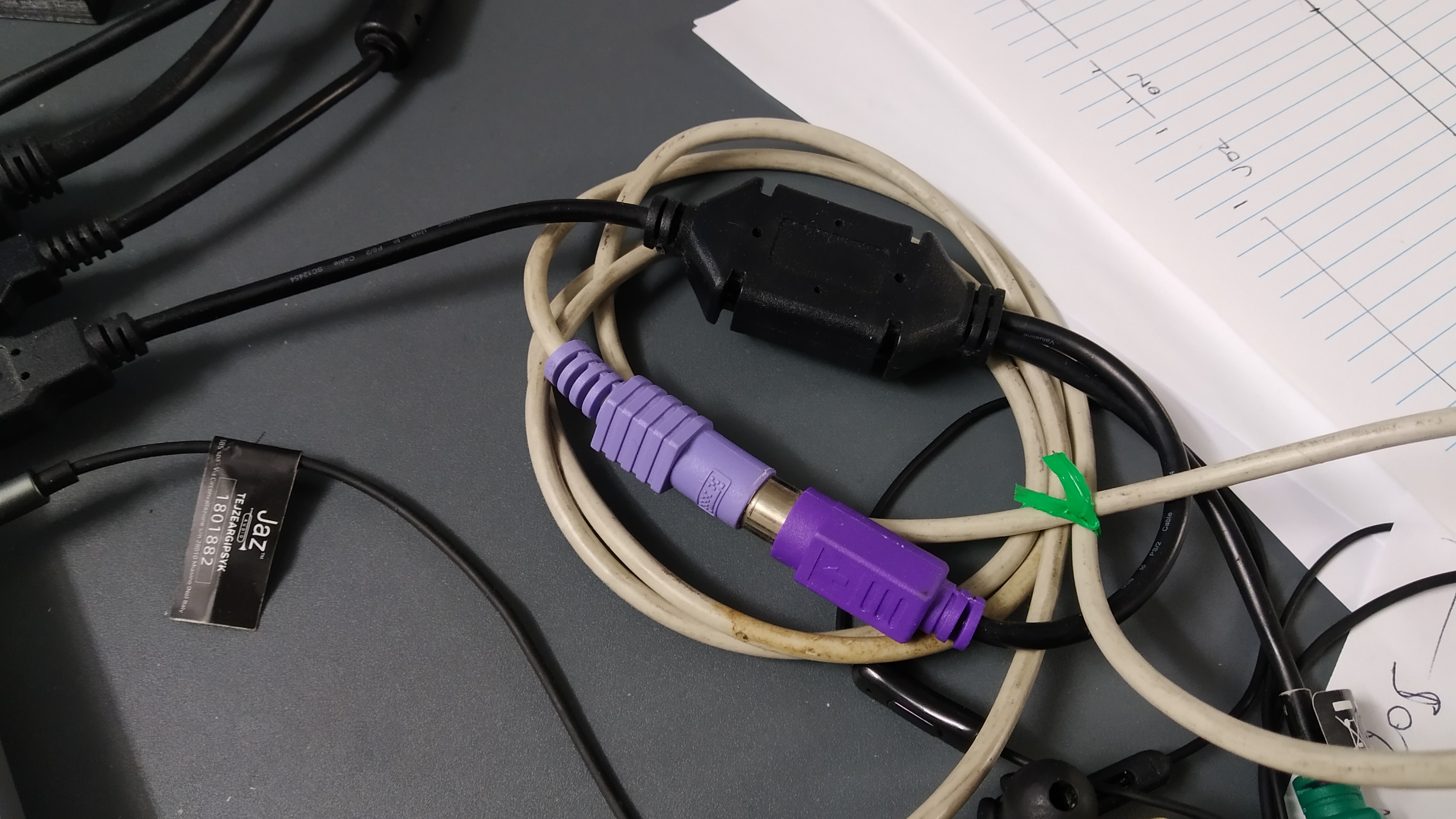

I have had a similar problem but, in my experience, it was a combination of keyboard and converter. The same cheap gadget that works flawlessly on a couple of keyboards I use constantly (a RD BTC and a Model M, for example) was instead creating the exact same issue on 2 other keyboards I was testing (a modern-ish rubber dome IBM and another cheap board I found lying around).

Same as mine, it works as I described in my previous post (it's a bit "picky", so to speak, about boards it likes to cooperate with).

Another word: flaky.
Take Bjerk’s advice and gut it for its precious bodily ports!
I’ve been running Soarer converters since 2013. They are gold, and I built them myself.
