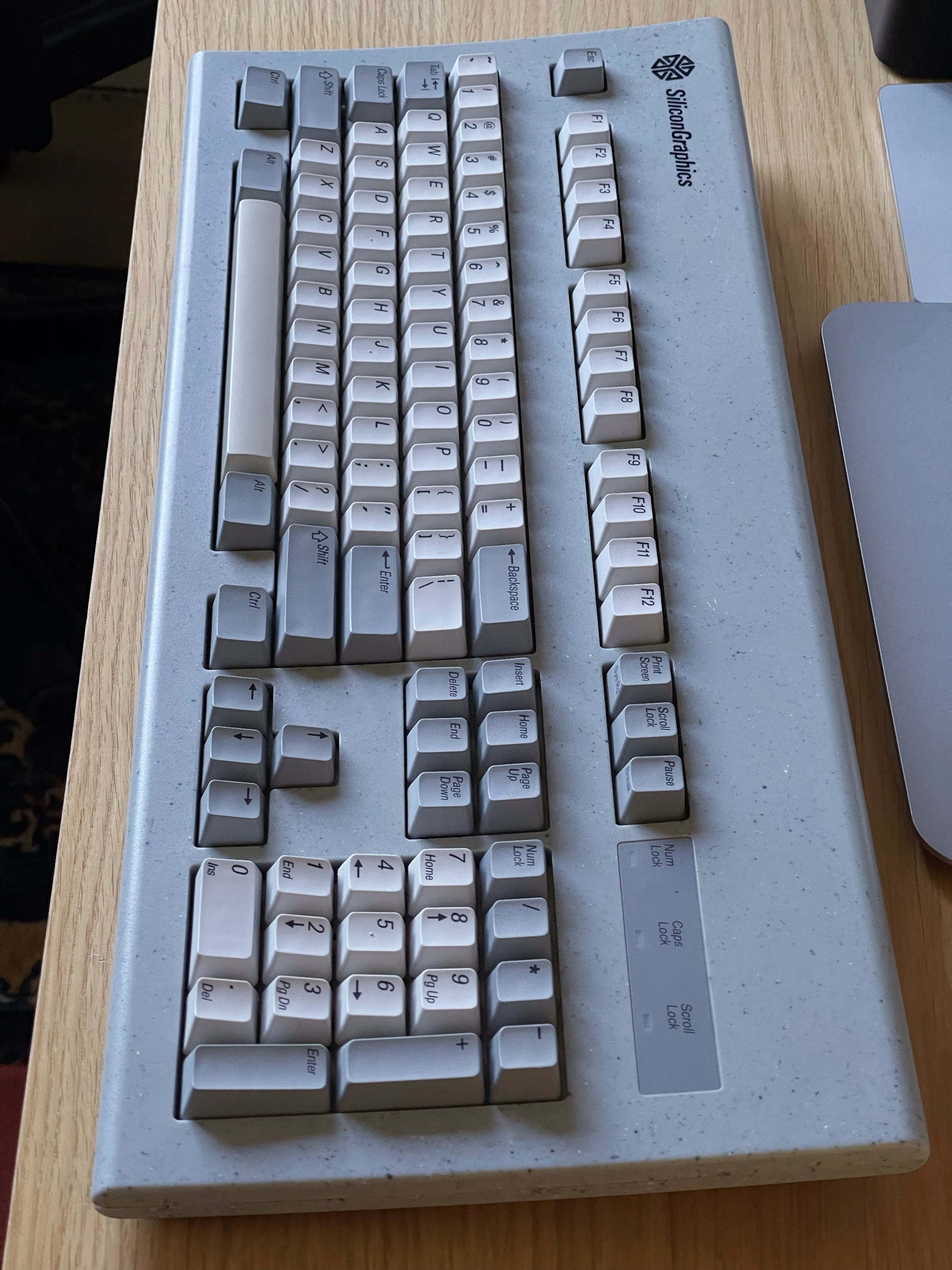

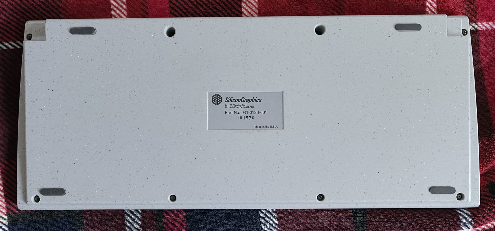

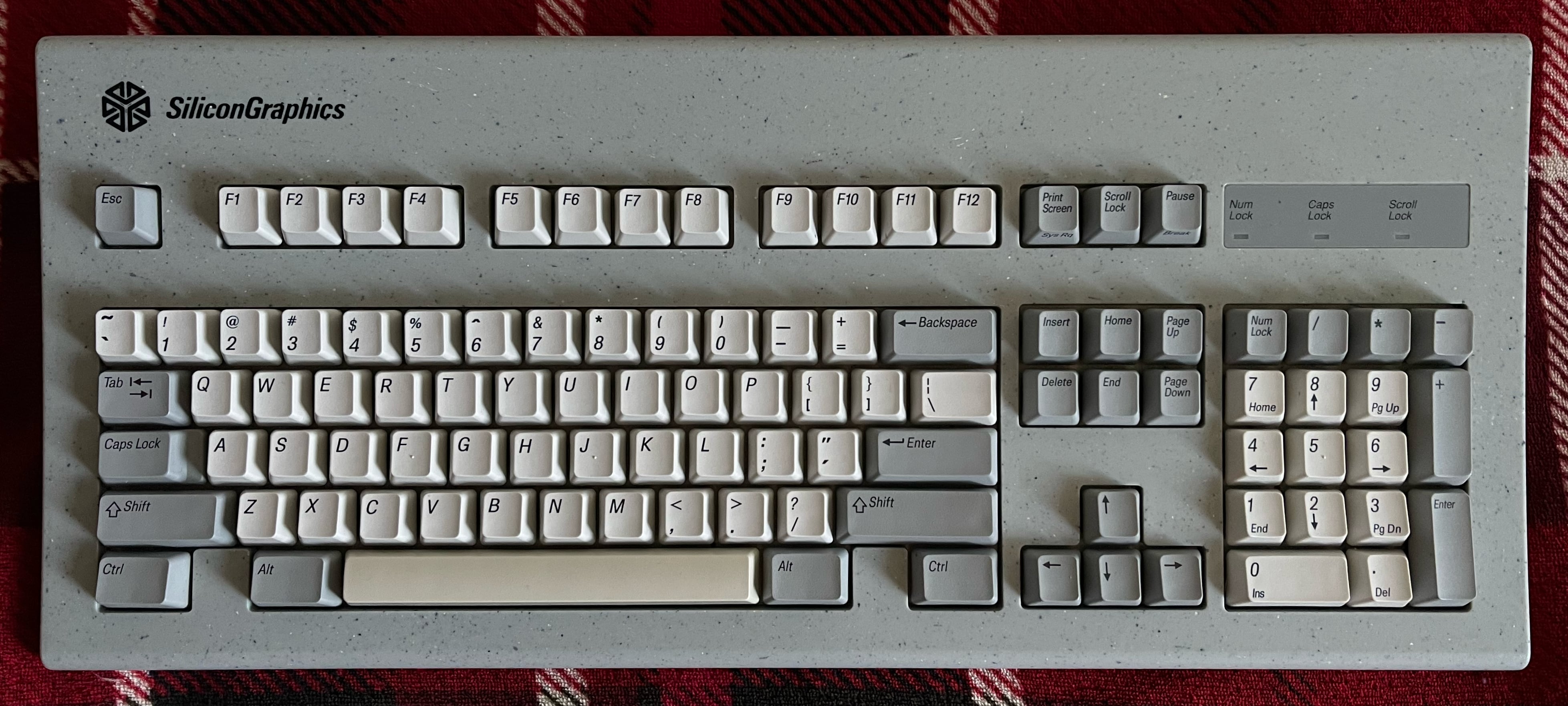

So, I have this rather handsome but non-PS/2 Silicon Graphics keyboard. Good old part number 041-0136-001:
This model speaks SGI's own protocol. Quite like Apple ADB keyboards, it has no attached cable but instead a pair of identical ports on the case:

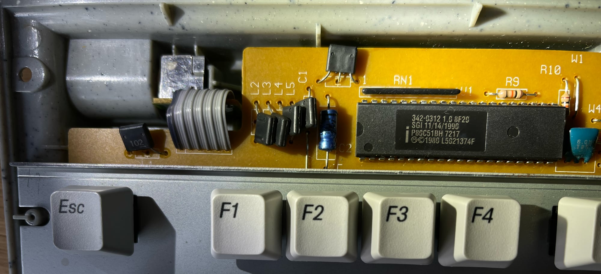

12 volts? Not the most helpful thing! Here's the chip responsible: marked SGI as you can see.
Now, that's long put me off doing anything with it. Indeed, this keyboard's been waiting for some attention for years. Annoying, given it's aye a looker, and feels very nice indeed. Even matches my monitor and trackpad! What a tease.

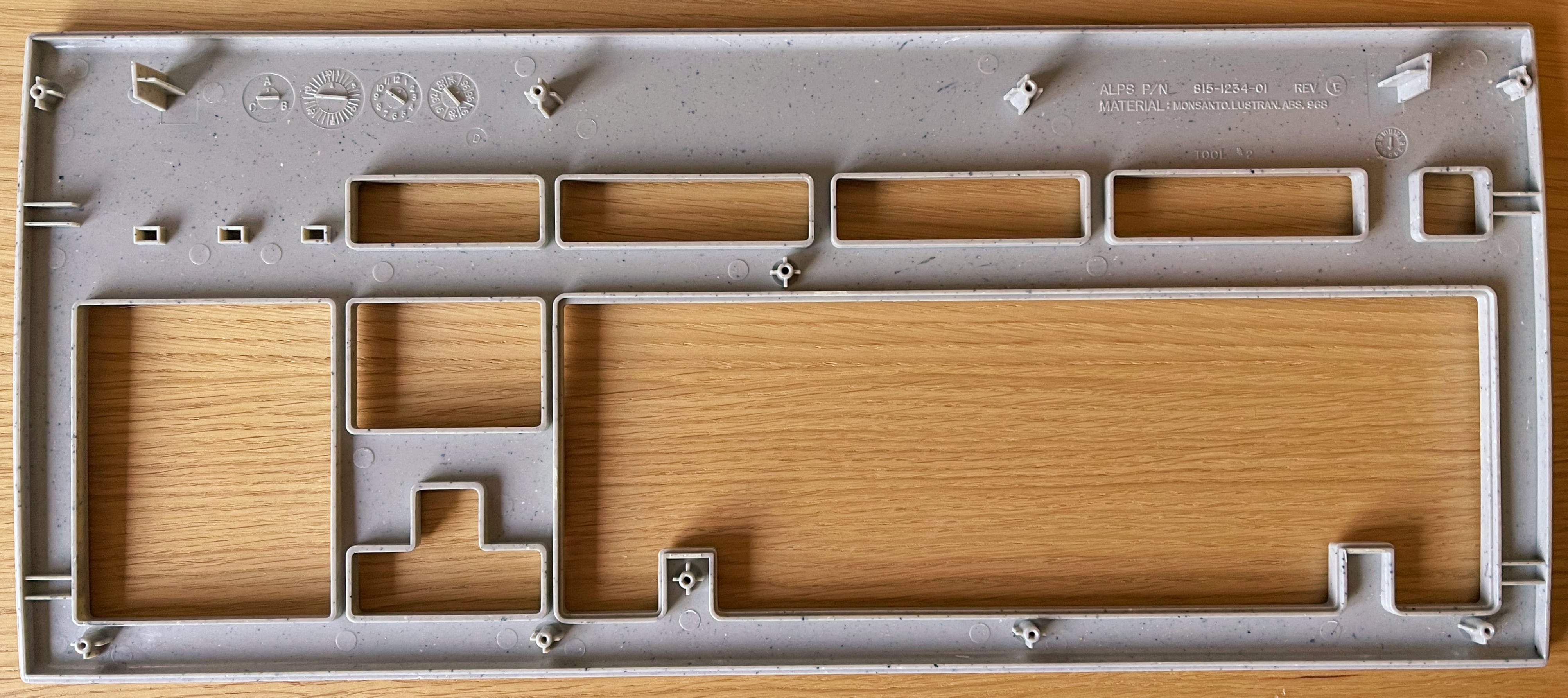

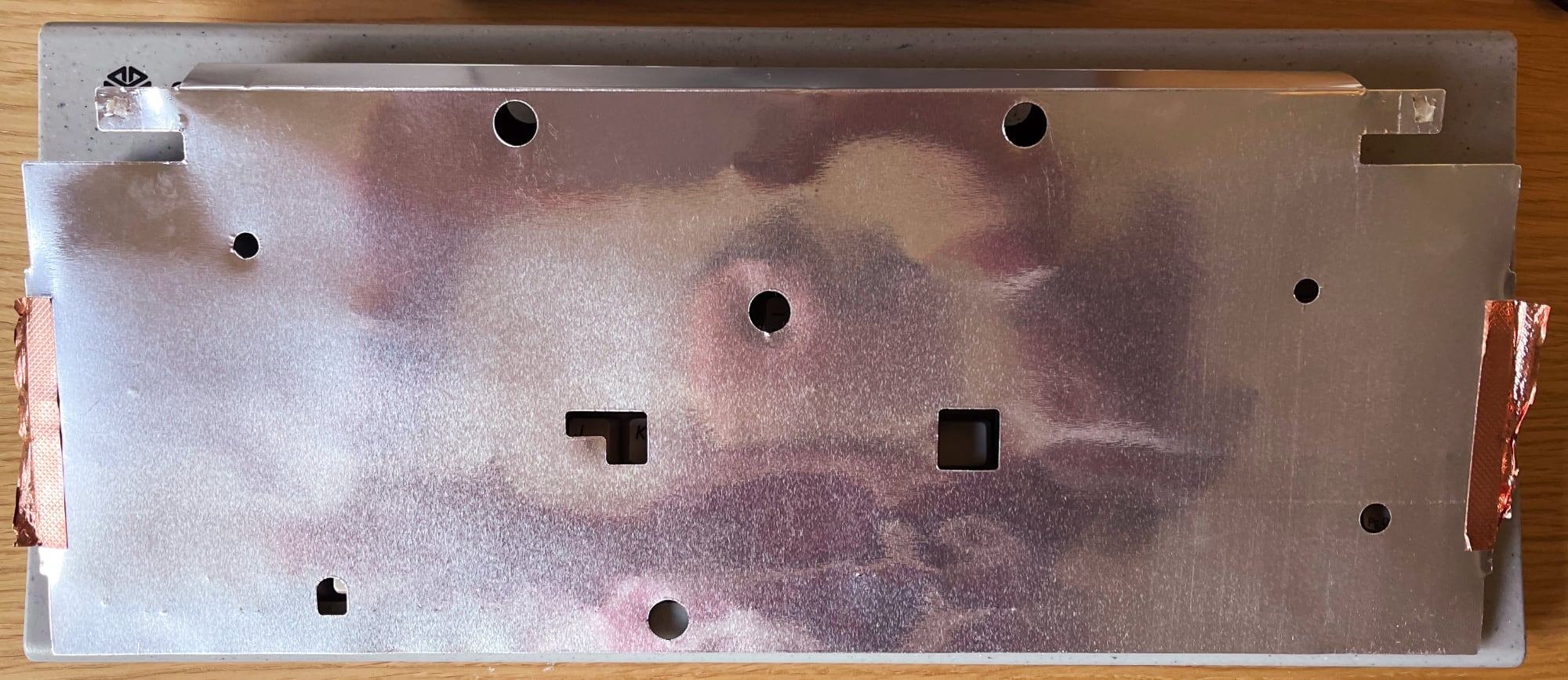

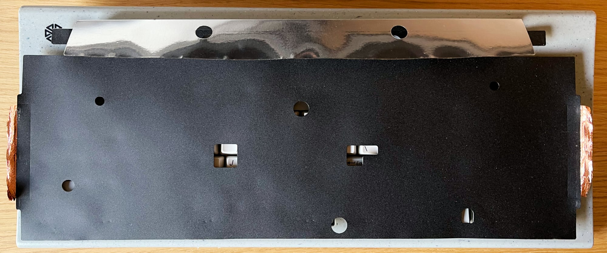

So what to do about it? Well, first of all: the shield has to go. I peeled back its copper tabs the other night.
They didn't cheap out with this thing:
Shield back.jpg (284.95 KiB) Viewed 23907 times

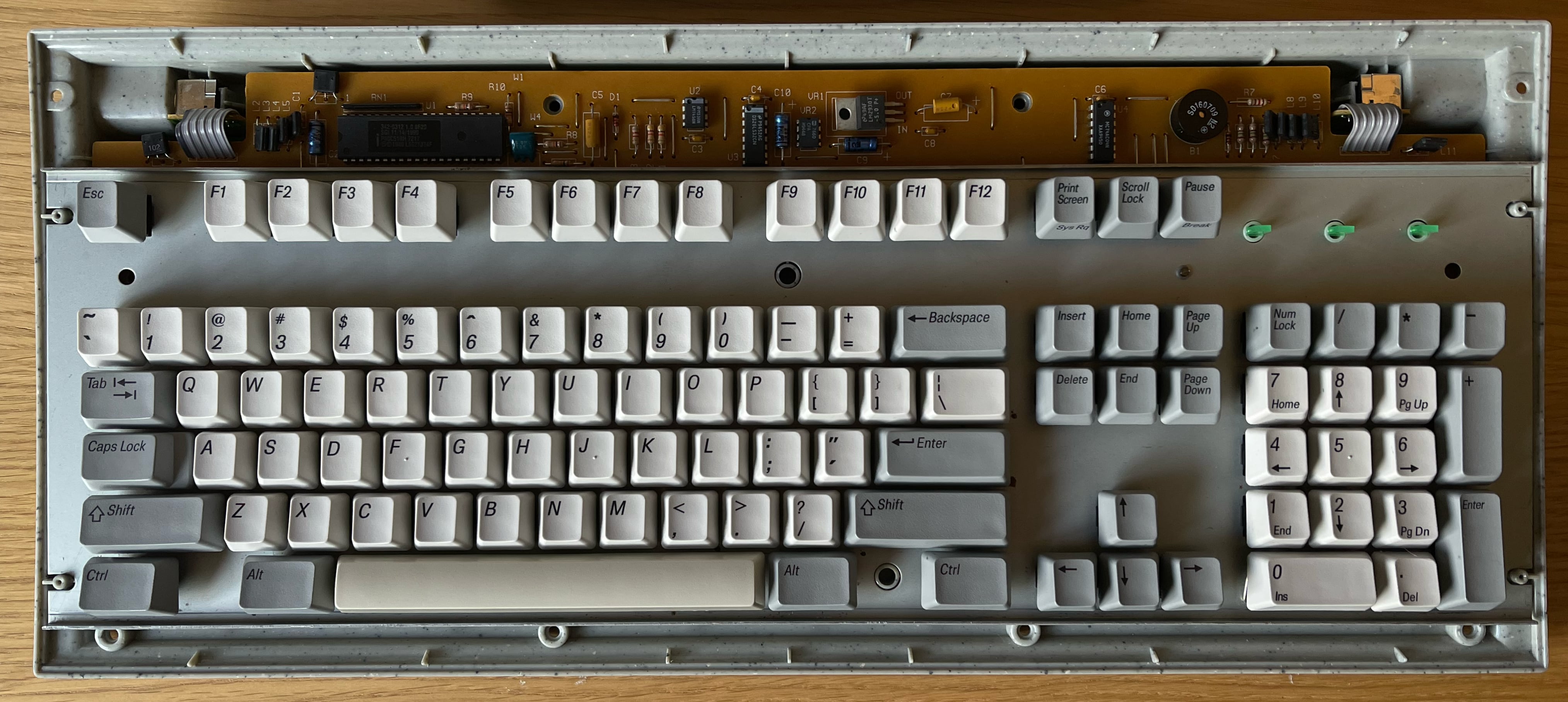

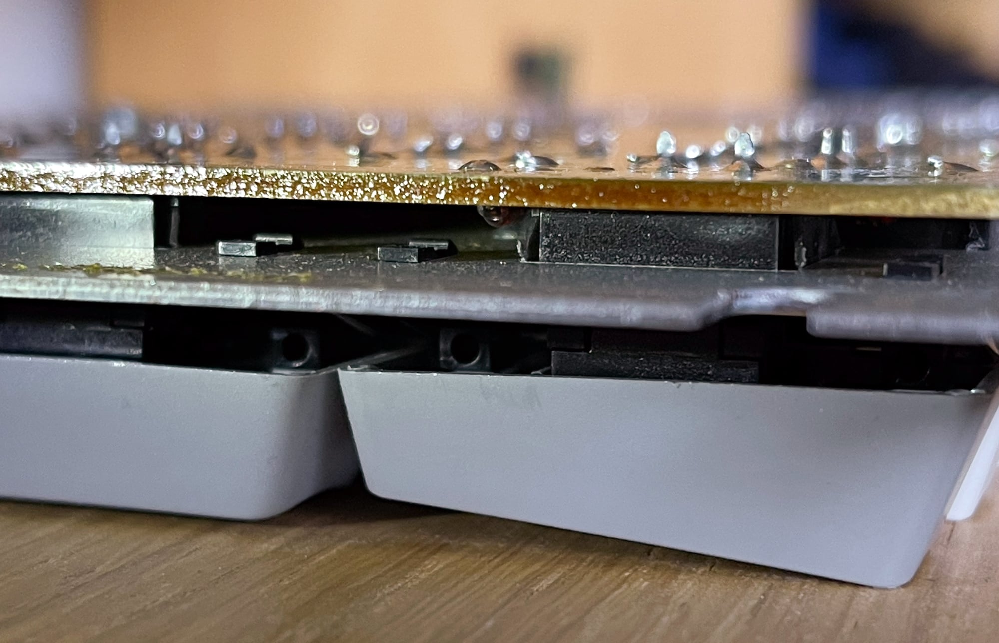

What lies beneath? Why, our good old friends: Alps.
Including an Alps original PCB:

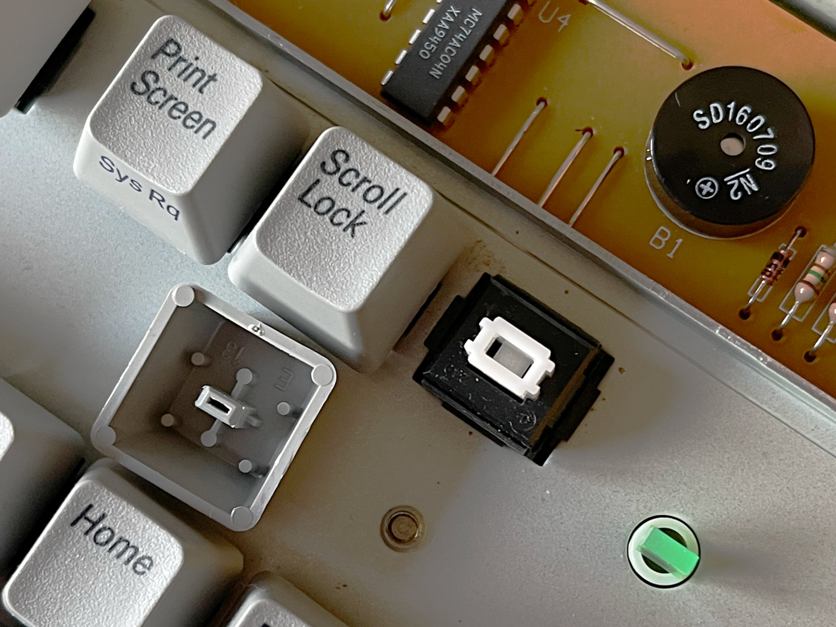

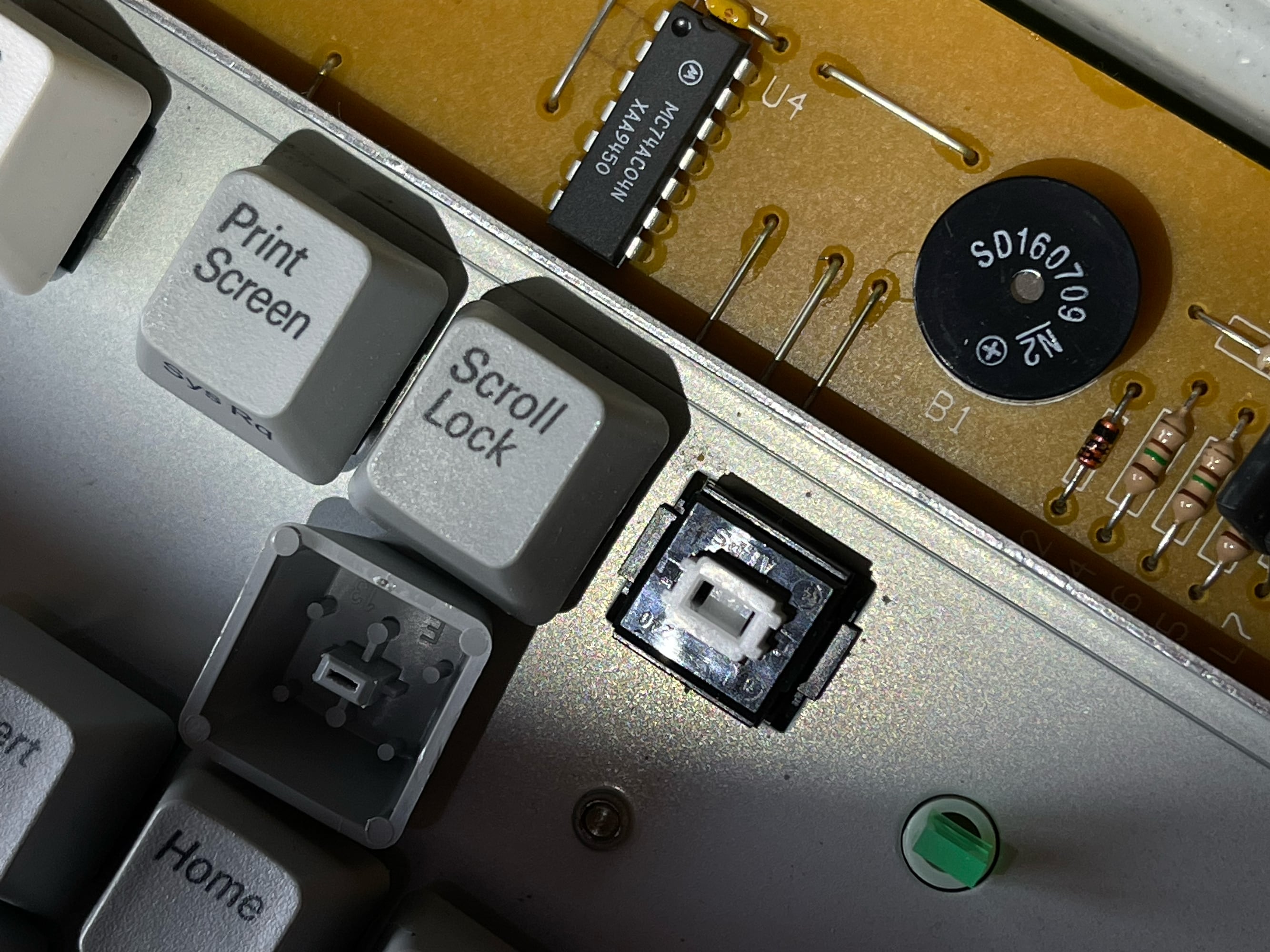

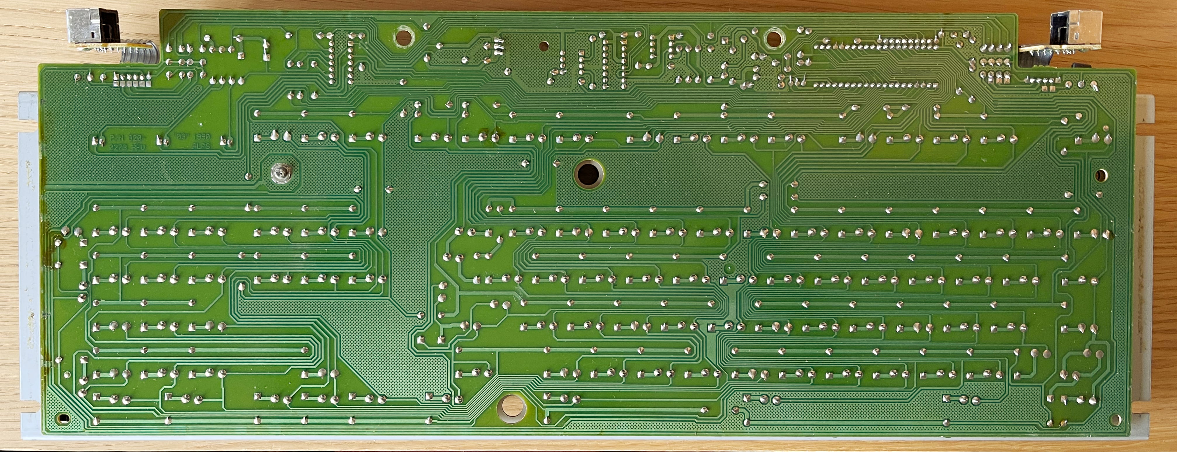

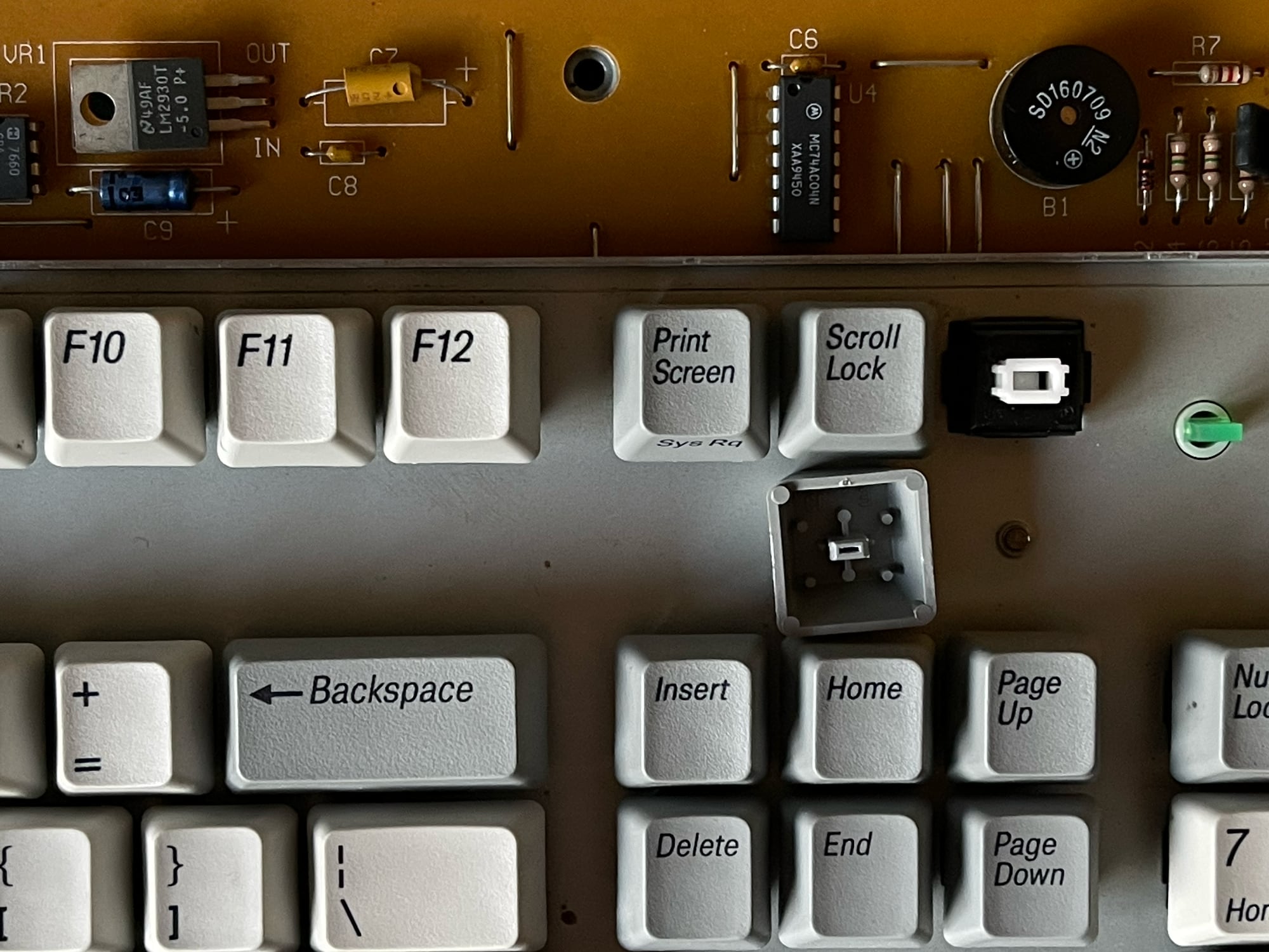

This PCB looks single-sided to me. Here's a peek of the top, and what looks to be a beeper? (Indeed: it is.)
Where are all the diodes, though? Well, I pulled out my flashlight and sure enough: there's dozens of the wee red buggers, tucked away under the plate. Couldn't quite catch them on my phone though, so you'll have to take my word for it!
What I'm thinking, then, is the matrix looks to be all exposed for me on the single exposed side of the PCB. I'll trace it out and figure out the rows and columns. Then I need to pull the SGI controller chip, at least?

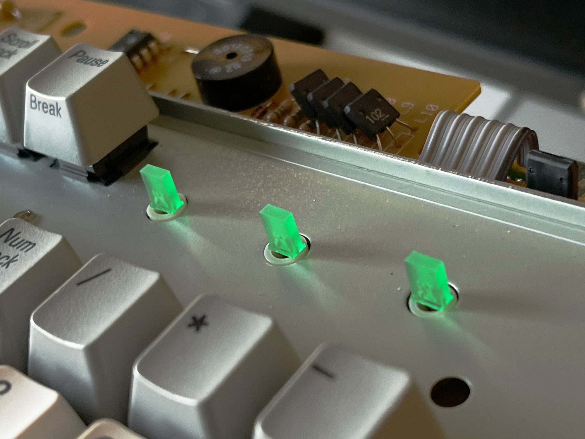

There's also the LEDs to think about:
Remember that 12 volts issue. I'll need to watch out how I drive these. I don't mind them a bit dark, fortunately. But getting them lit up from a 5 volt, let alone 3.3 volt battery / wireless controller might be tricky.

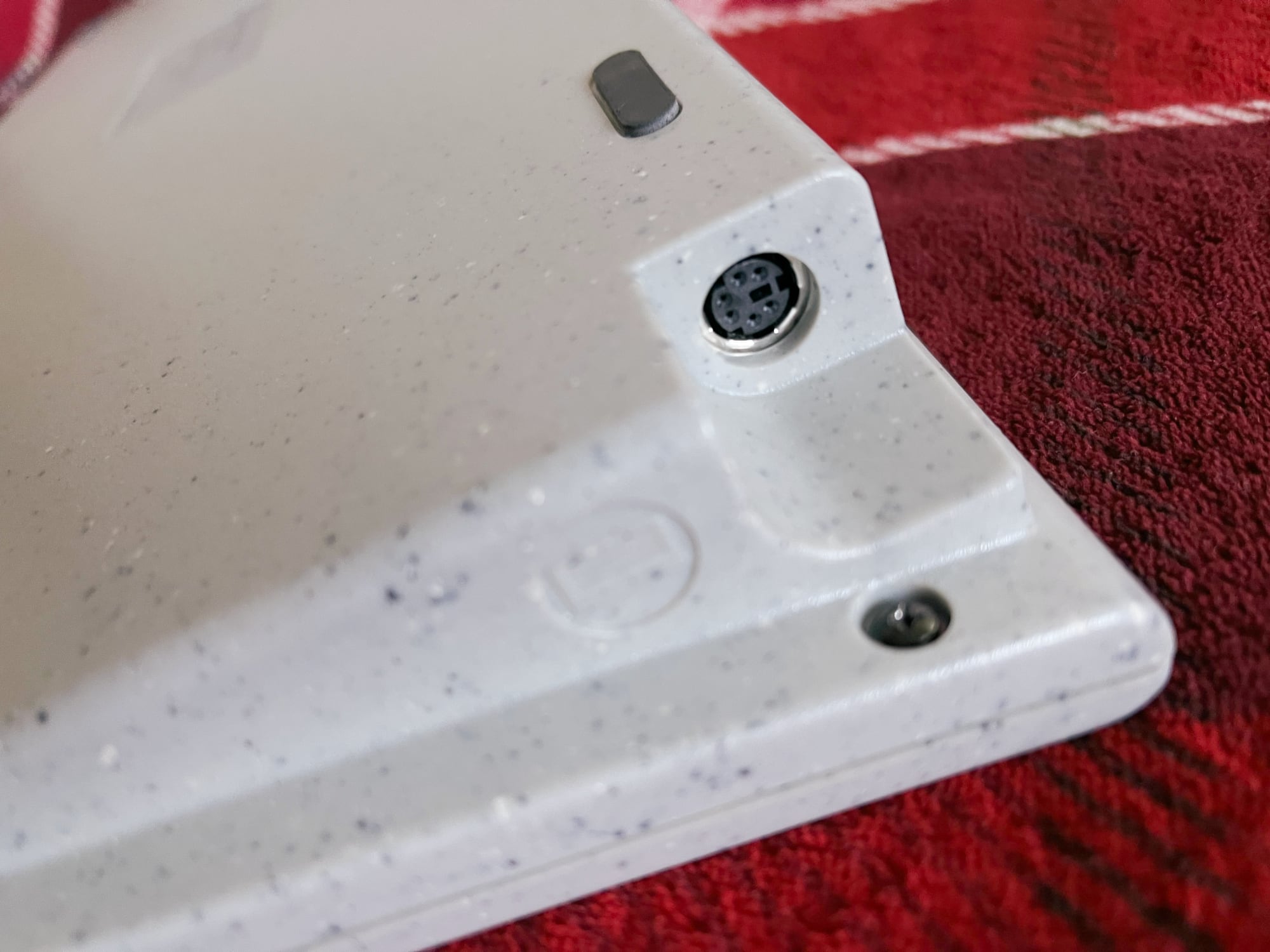

I'd also like to use these original ports for connection:

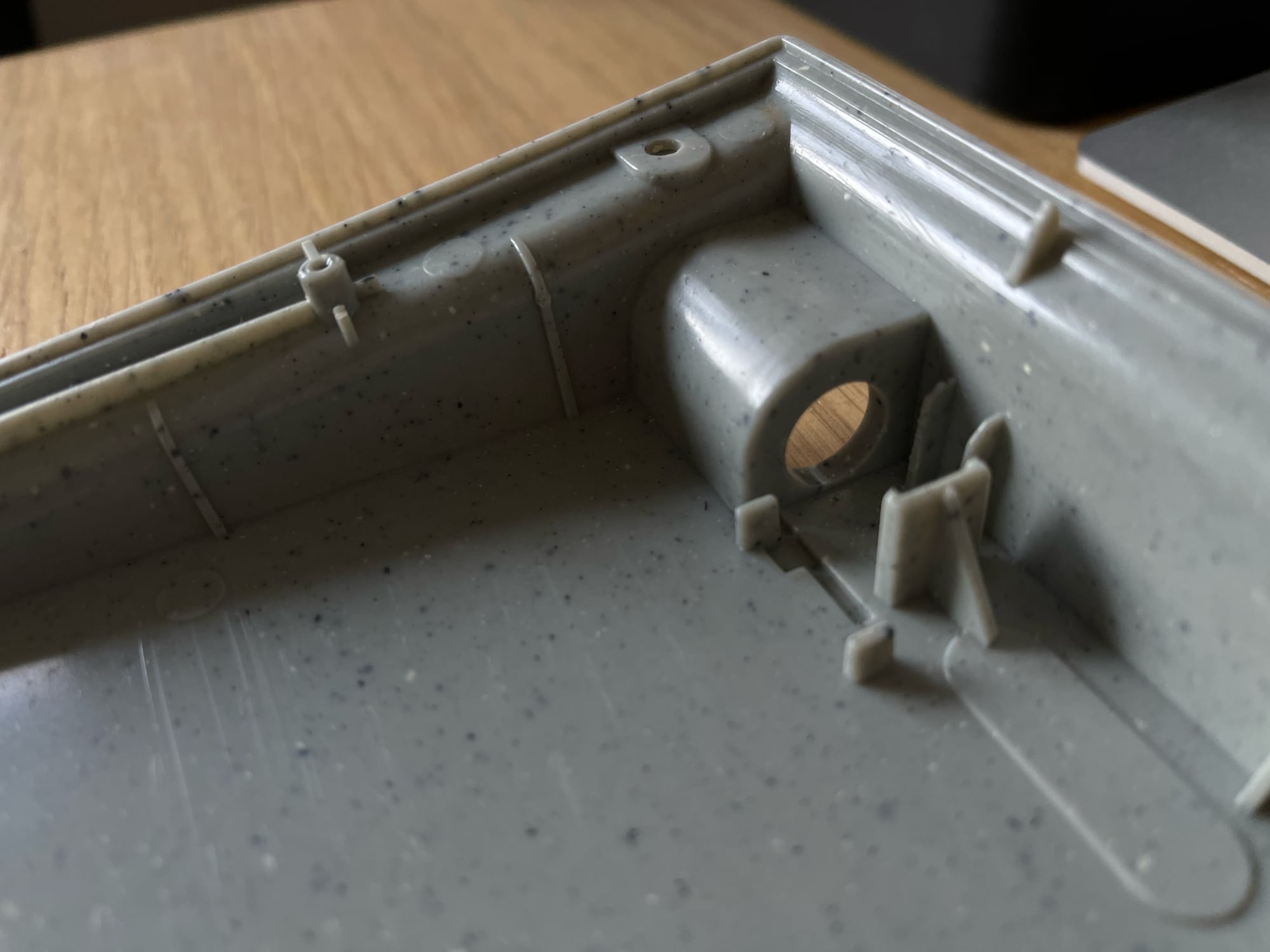

Much like ADB ports, they tuck into the bottom shell here:

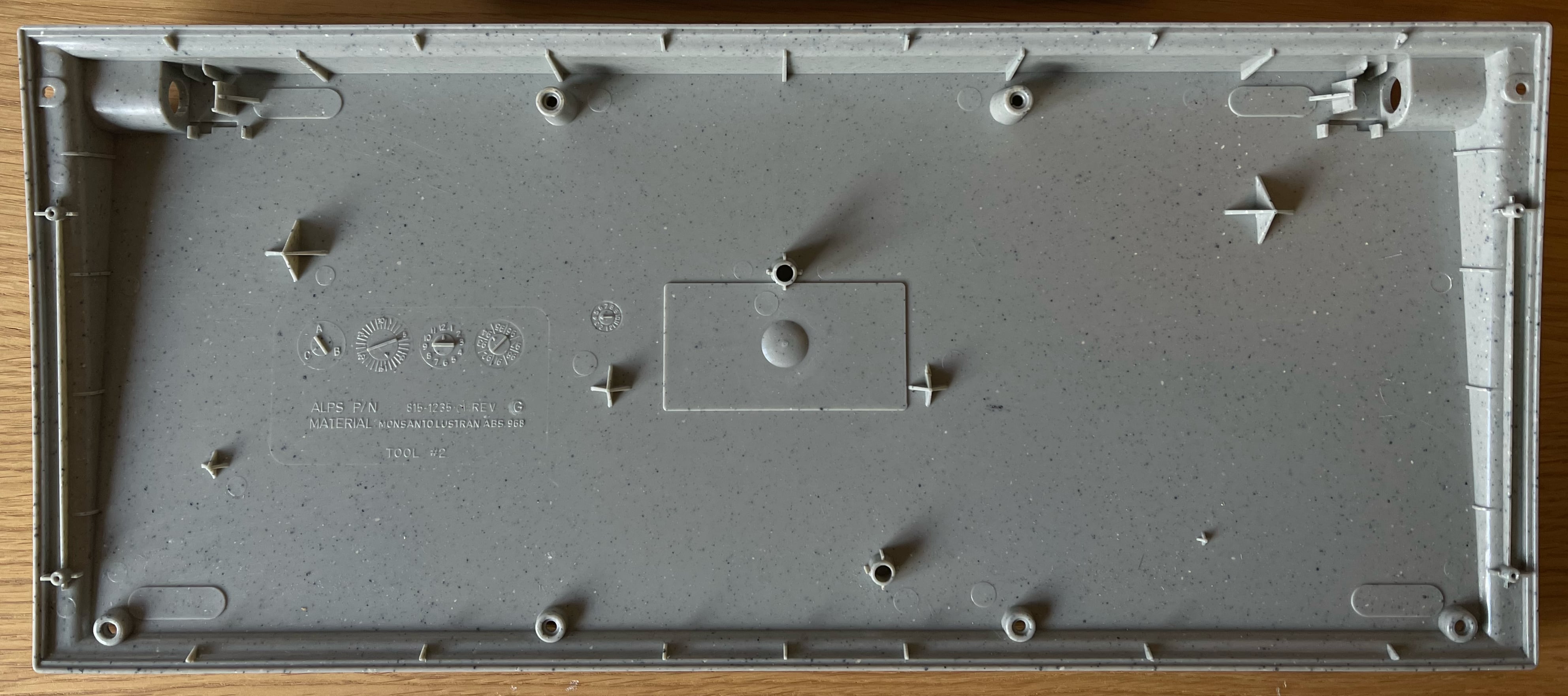

Speaking of which, here's the manufacturer marks:
1993 top and 1994 base. Don't think my SGI had much use, given its nice condition. These damped tactile Alps are as good as it gets, in my Alpine experience:
And those pale Granite dyesubs are peak classy, too.
I'm still in two minds about doing anything destructive to this one. But if I ever want to use it, I'm gonna have to, right? For now, I'll map out the matrix and see if there's gotchas awaiting me there.

Connector pinout here. Positive and negative 8V !!
There are VR1 and VR2 printed next to what like voltage regulator circuits. The one with heat-sink has "5.0" printed on it. Most logic from that era (and USB) runs 5V.
I suspect that mouse data was just pass-through to the host, with both ports being connected in parallel. Sun did the same.
I would speculate that the +8V and -8V could be for some RS232-like interface for the mouse, with the keyboard only needing +5V.

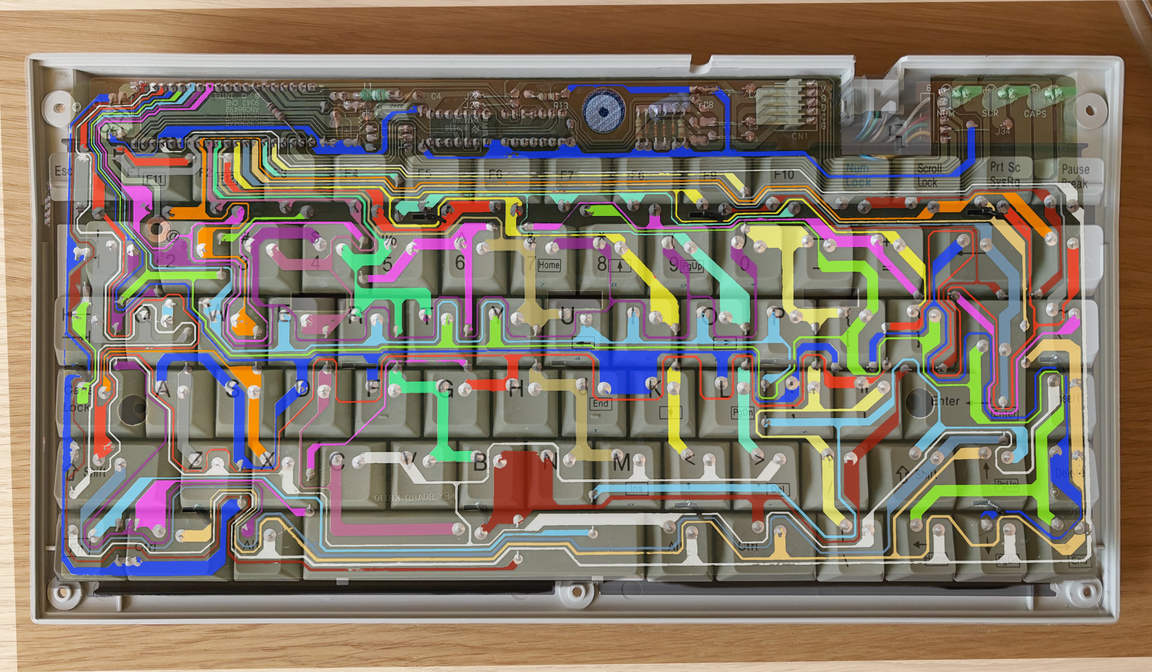

Getting there:
Matrix in progress.jpg (1.2 MiB) Viewed 23828 times
Work in progress. Haven't even gotten out the multimeter yet: this is entirely visual, from the photo above. I figured out Pixelmator is actually very well suited to this! Quite fun actually, just selective colour-filling the traces.
I'm sure several bits will join together unexpected, likes. I'll rejigger the colours when that's cleared up. But so far, it all seems fairly sensible.

Muirium wrote: 12 Jan 2022, 18:58 Getting there:
Very nice! I am doing the same thing with Snag It for an Omni Key 102 and will have to try Pixelmator to see if that works better. Good luck with your project!
12 Jan 2022, 22:45
Thanks!
I used the color fill tool. Press N to engage it. Click on a trace, and drag a little to expand it along the colour zone. When it spills like crazy, pull back a bit. Lots of trial and undo but you soon get the hang of it!
https://www.pixelmator.com/support/guid ... r-pro/1039
I should have made my traces in separate layers, as you can use lower layers for the full input. Didn’t know that at the time so did it all in one instead. The switch labels are in a layer though, so they don’t mess up my fills.

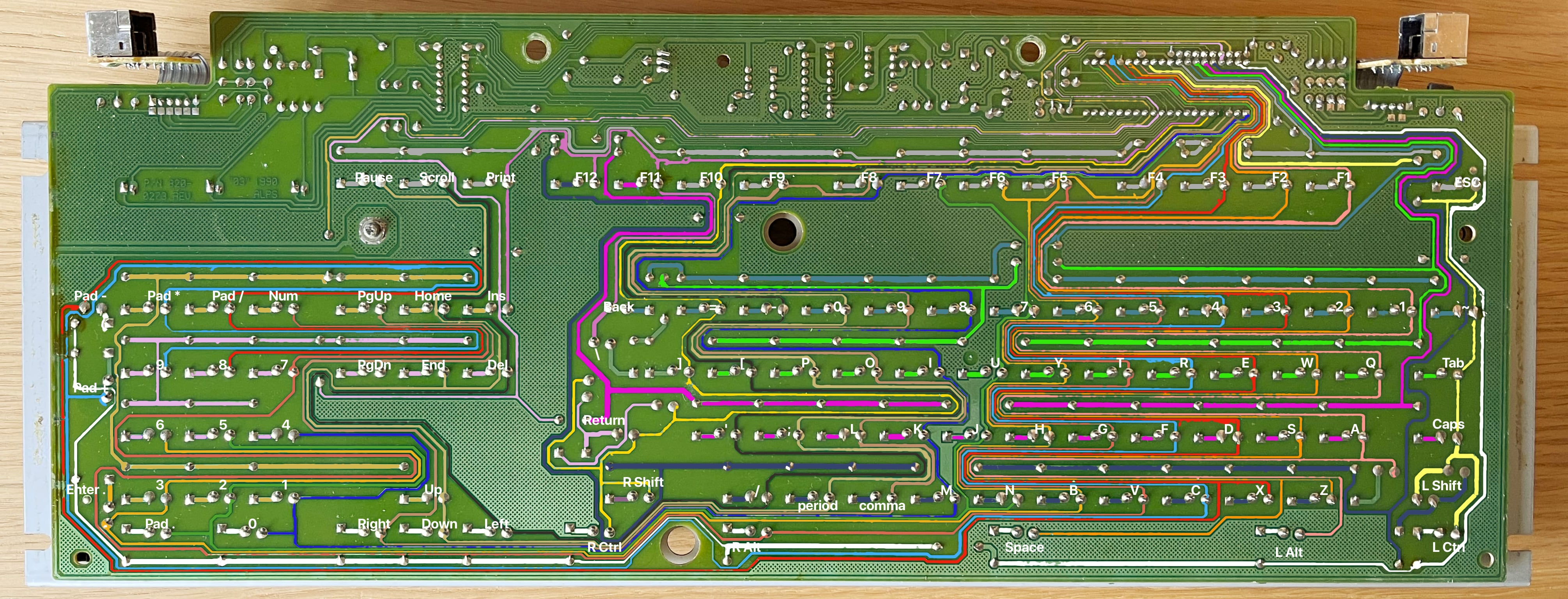

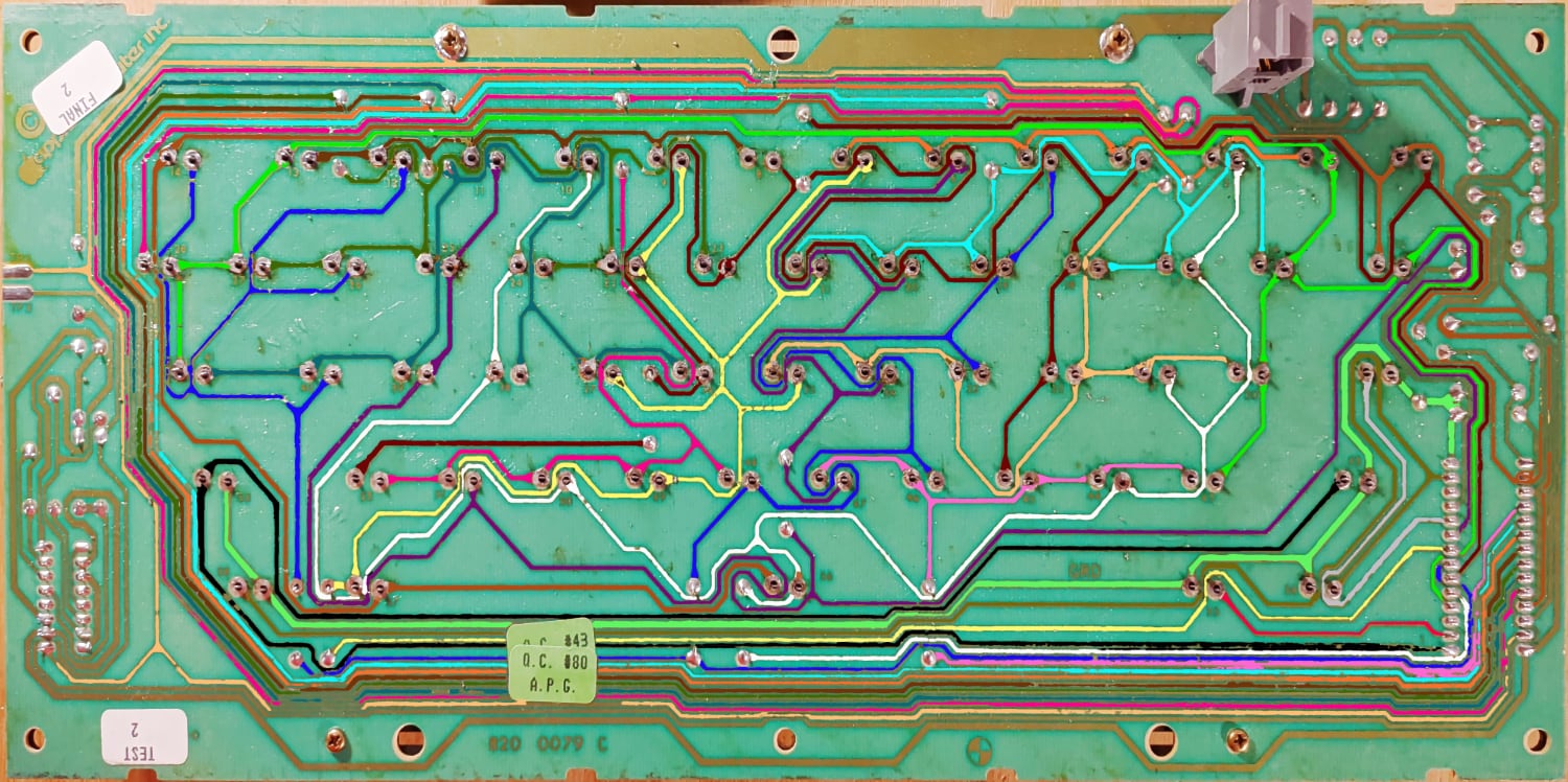

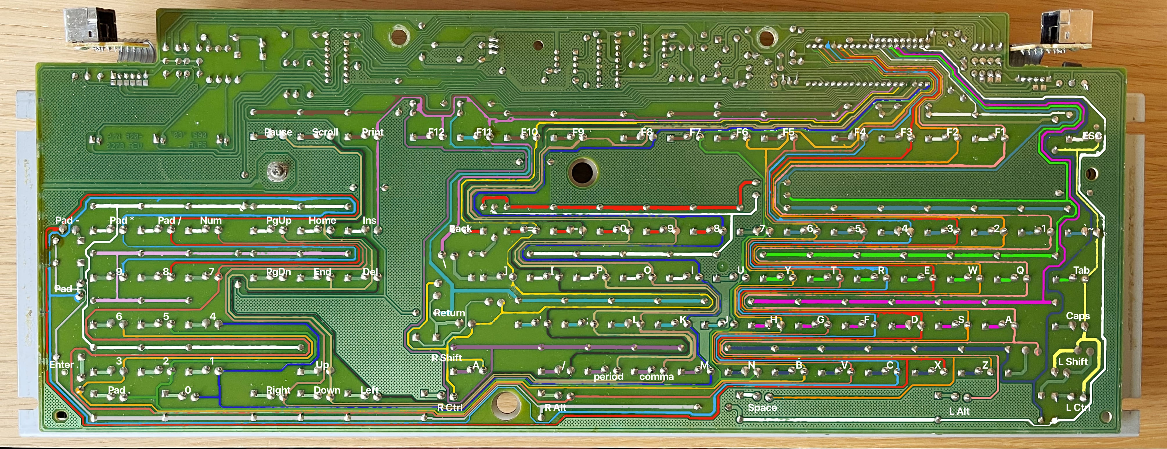

Okay, I think I've got it. The multimeter confirmed my suspicion a lot of those rails do in fact continue along the keyboard, bridged by hidden connections on the other side. So here's everything re-coloured and mostly tested:
PCB with Matrix Traced.jpg (1.2 MiB) Viewed 23716 times

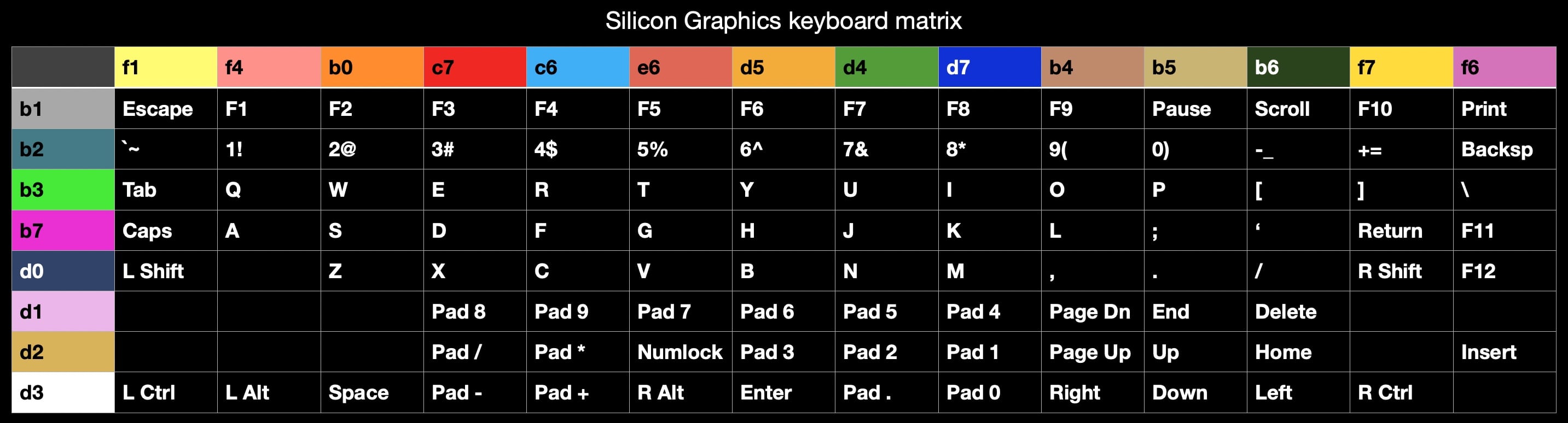

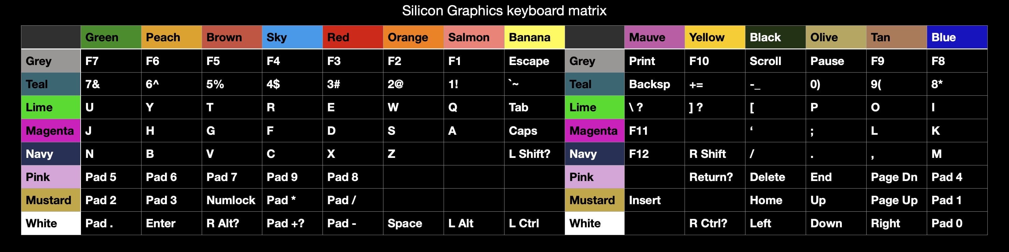

Which yields this 8 * 14 matrix:
Matrix Diagram.jpg (181.27 KiB) Viewed 23708 times
The order of the rows and columns is by their pin placement on the controller. Substituting that guy for a Teensy 2++ (which I do indeed already have) is likely the big hands-on stage in this conversion. I've never tried a straight chip swap before. So I'm reluctant. But now I know the matrix, I'm more tempted than ever…

14 Jan 2022, 20:45
Confirmed: had the matrix almost perfect. Return and numpad Enter were off, but soon found in the handful of blank spots still available. Desoldered the SGI controller, Teensied up my own, and here I am typing on the granite right now! Always the proof of the pudding. First action this keyboard's seen this century, at least.
Just a humble Teensy 2 in here, running Soarer's Keyboard Controller and using 22 pins to drive this matrix. I had a Teensy 2++ but you need both corner pins, so there would be some jump-wires in any case. Besides, I like pushing the little guy to his limits!
Screenshot 2022-01-14 at 8.11.13 pm.jpg (154.3 KiB) Viewed 23619 times
Here's my Soarer config, matched up to all those pins, with my usual preferred Mac mods. It's rotated thanks to the diodes needing rows instead of columns to be strobed. Might be possible to rewrite it the other way, but I was keen to get on with my testing.

Nice project! The LEDs look like they're set up as common positive 5V by the way. Soarer's controller can handle them fine if you prefix the pin assignment with "-" so it pulls low to light them up.
14 Jan 2022, 22:43
Nice tip. 8-)
I see the three resistors they’re tied to. The only pins I’ve hooked up are the 22 required by the matrix. Doubt I’ve still three spare! Should be able to rummage one up for Caps Lock, though. The only one which ever lights up anyway on the Mac.

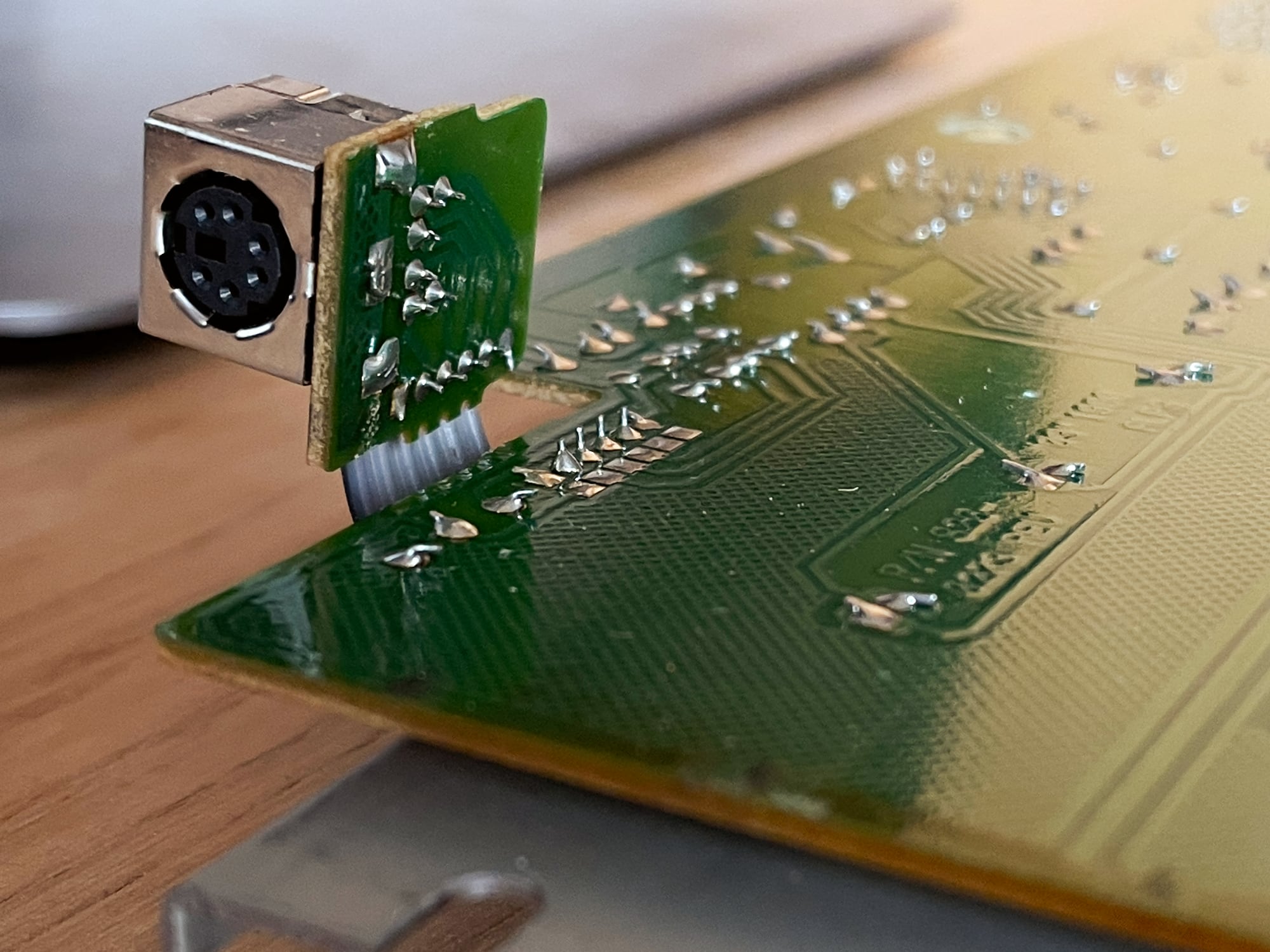

Part of me even wants to give that beeper a use. Not like I listen to the one in my Kishy, but. I should know better than to treat it as a loudspeaker I could drive with a USB DAC. Well, one worth listening to at any rate. :lol:
No luck finding mini din 6 to USB cables yet. I see other pins are available, though. Anything I could trim with a simple snip? I’m no Orihalcon. True cable hacking is beyond me. But as I can assign the pins however I choose inside the keyboard, I could use something quite “nonstandard”.

74 series is powered from +5V. So you seem to be correct about keyboard running at 5V and mouse probably using bipolar 8V for sort of a com port.

Is there anything to stop me from snipping the two extraneous pins? Why mini din 8? Because I see a fair few ready made USB cables out there like this:
Providing snipped 8 to 6 does fit, the only gotcha there is where do the 4 USB pins route to: there are only 6 good answers from a possible 8. :lol:

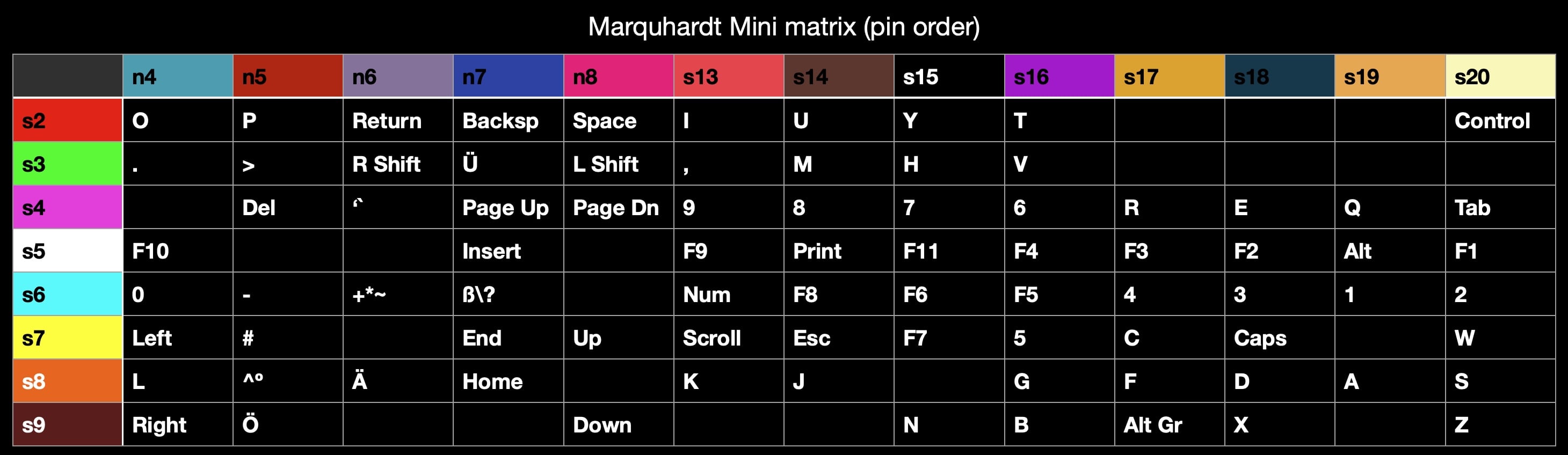

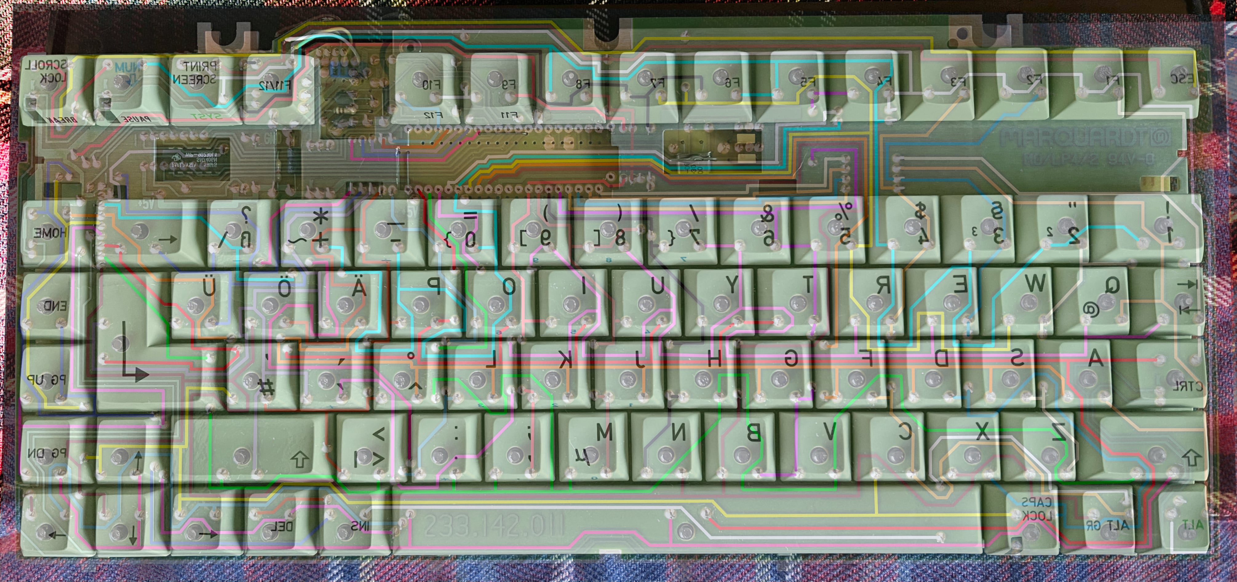

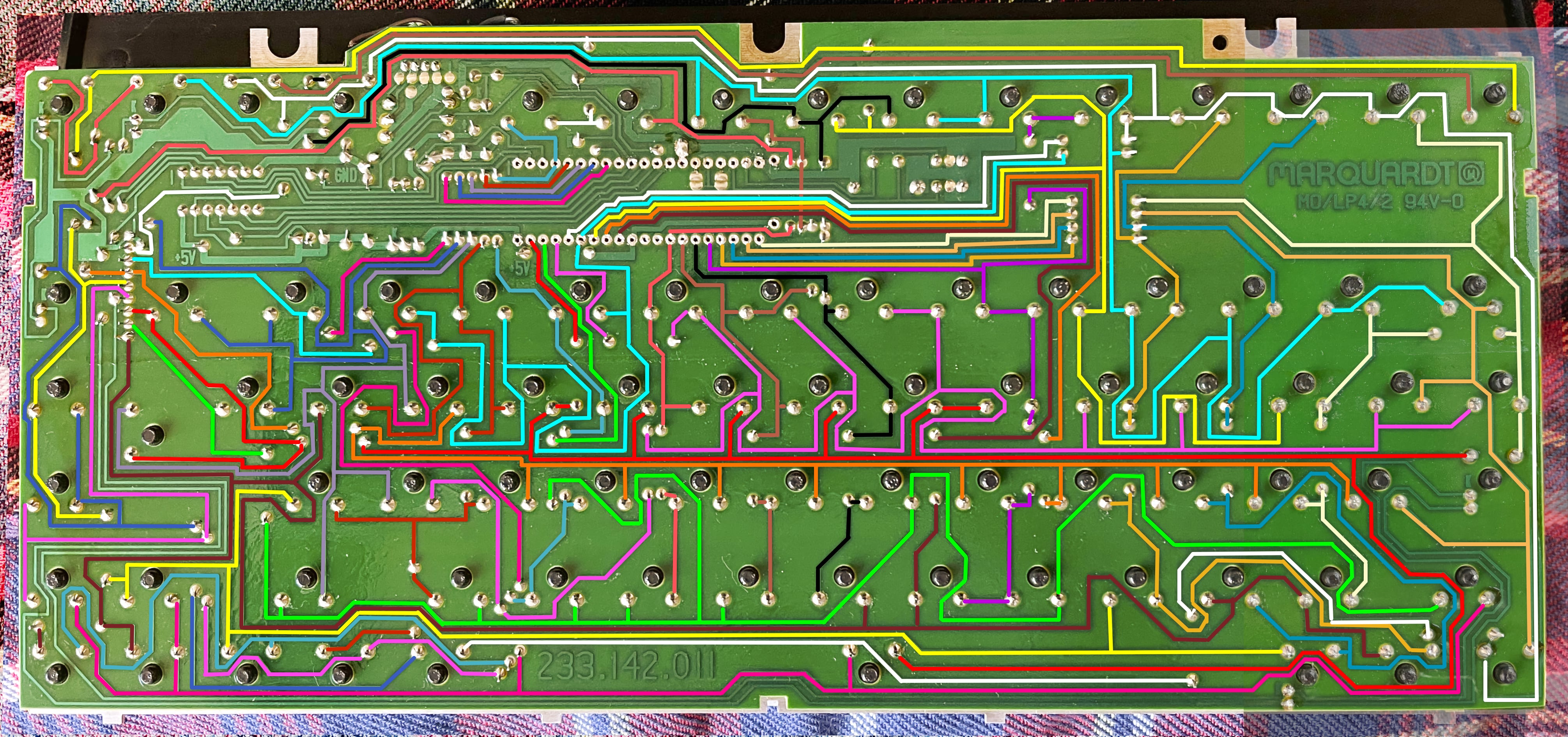

Since I was still in the mood for matrix tracing, I decided to give my little Marquardt Mini its turn. Good grief! I'm glad I did the SGI first. This wee fella's pure mental!
Marquardt Mini Matrix clear.jpg (1.37 MiB) Viewed 23256 times
Tracing that one was MUCH more work. The SGI's posh Alps PCB has higher contrast, making its traces easier to follow. I barely needed to tweak pixels at all, just working around it with colour fills was enough to paint the matrix I showed earlier.
Tried the same approach on the Marquardt, and it failed completely. Even throwing multiple pics of the PCB together as layers to enhance the contrast never cut it, though it did teach me a new skill in geometry warping to get them pixel perfect; they're all on show above. I wound up going oldschool and painting on top of the images, by hand. Well, at least the traces are all straight lines, but goodness me does the Mini take a lot of spaghetti to join its dots! Here's another view, this time with a photo of the keys in place, geometry matched for the PCB underside. I needed this to ID them at the end:
Marquardt Mini Matrix opaque.jpg (1.02 MiB) Viewed 23256 times
All that complexity for a 8×13 matrix. Huh? That many pins? It's only 83 keys so they could have done it in less, if they'd tried harder. Bet it wouldn't have been any more of a convoluted mess. :roll:
Anyway, here's the final result:
Pin order.jpg (136.37 KiB) Viewed 23256 times
The pin labelling is my own simplistic north vs. south side of the controller, counting 1 at left to 20 on the right. There's also those three LEDs, integrated neatly into their respective keys, which I'll hook up when I do this board. It's a murderously tight wee case it's in, though, so I'll need to strategise.

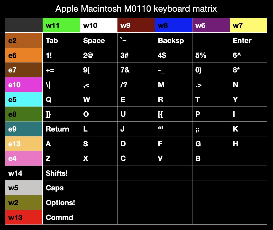

So, I also traced my Apple M0110 original 1984 Macintosh keyboard matrix. Actually just used jsheradin's PCB pics, as overlaid layers for contrast…
Macintosh M0110 matrix plot.jpg (262.35 KiB) Viewed 23170 times
It has swirly, loopy character, but no diodes!? And, yeah, the Shifts are fused together, as are both Option keys. The result is this fairly compact, mostly 6×9 matrix:
Macintosh M0110 matrix spreadsheet.jpg (177.97 KiB) Viewed 23170 times
Sure, you're really supposed to tear this out of your M0110, but I was in the mood to trace so, you know. This is my Sudoku… :roll:

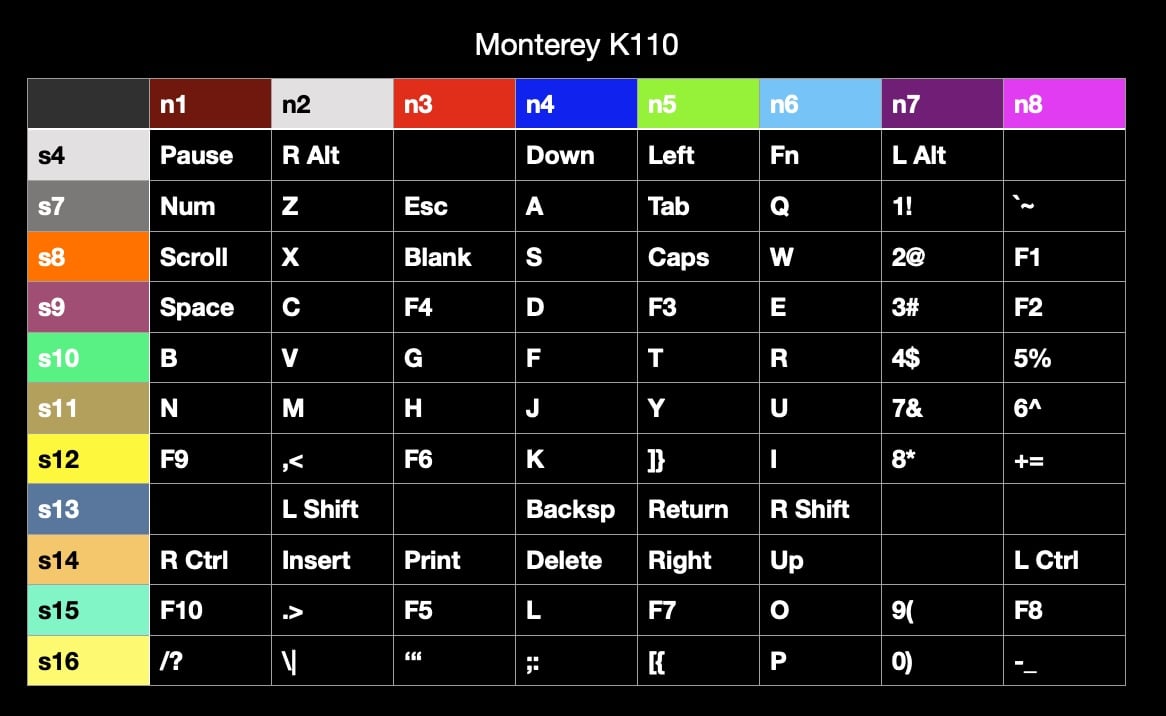

Here's another matrix, this time my Monterey K110. Sweet little keyboard this one, but a lousy controller (with a hard coded function layer I couldn't tweak) and a heavy cable which tugs it all around the desk! Seeing as it has a nice big open port on the back (for a numpad?) I've easy access for installing a USB port of my own.
Monterey K110.jpg (1.18 MiB) Viewed 23002 times
(This time I flipped the PCB images to match the keyboard’s true, user-facing orientation. There’s layers with just the bottom case etc. which give this one an X-ray vision character. I’ll make an animation sometime, as it’s fun just playing with layer visibility in the file!)
Much better designed matrix this, I will say: 8×11 for 81 keys.
Screenshot 2022-01-29 at 12.07.30 pm.jpg (71.2 KiB) Viewed 23002 times
Should be an easier project to wrap up than the SGI. But I'll get around to all of them, in time. :lol:
