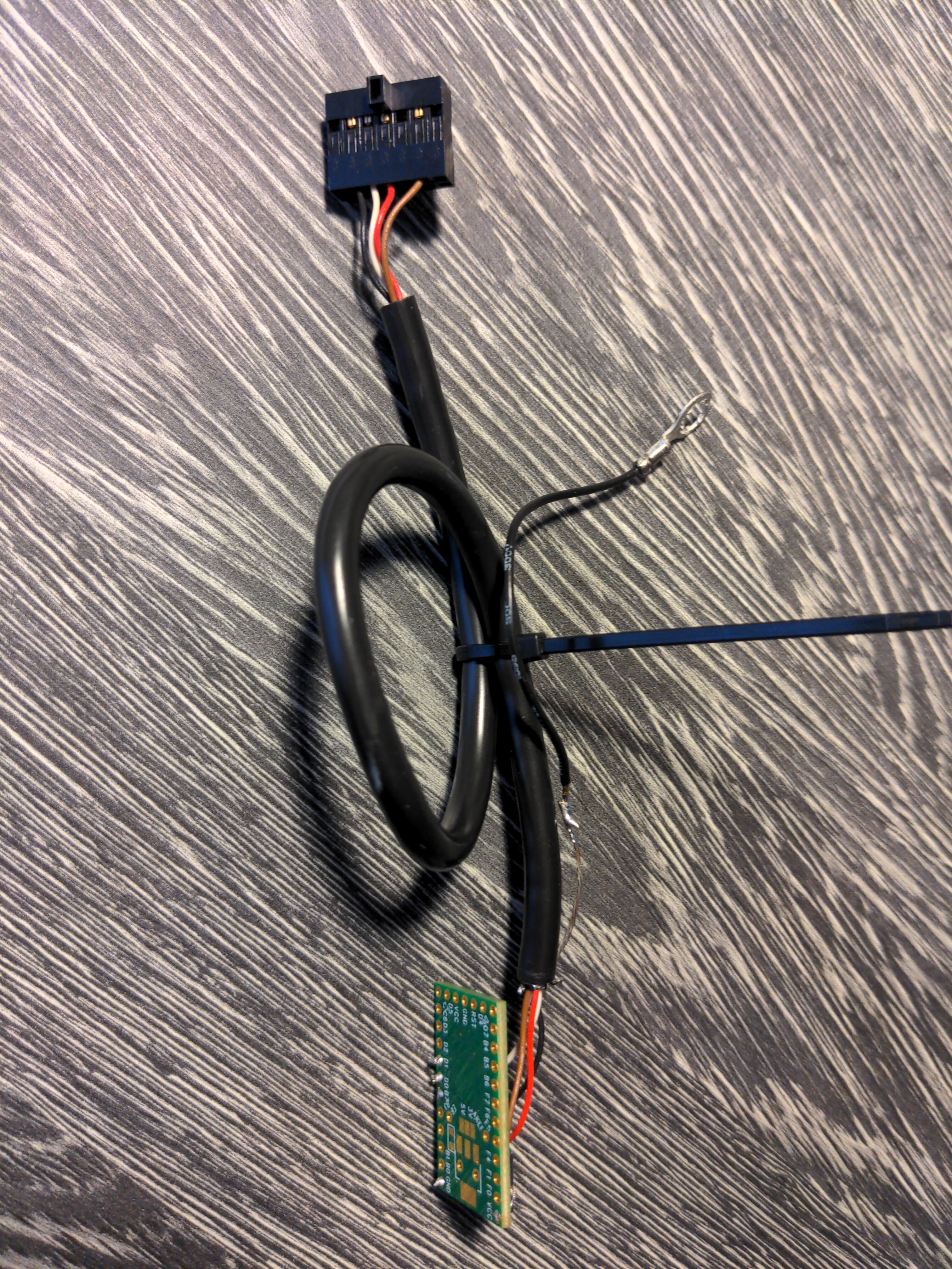

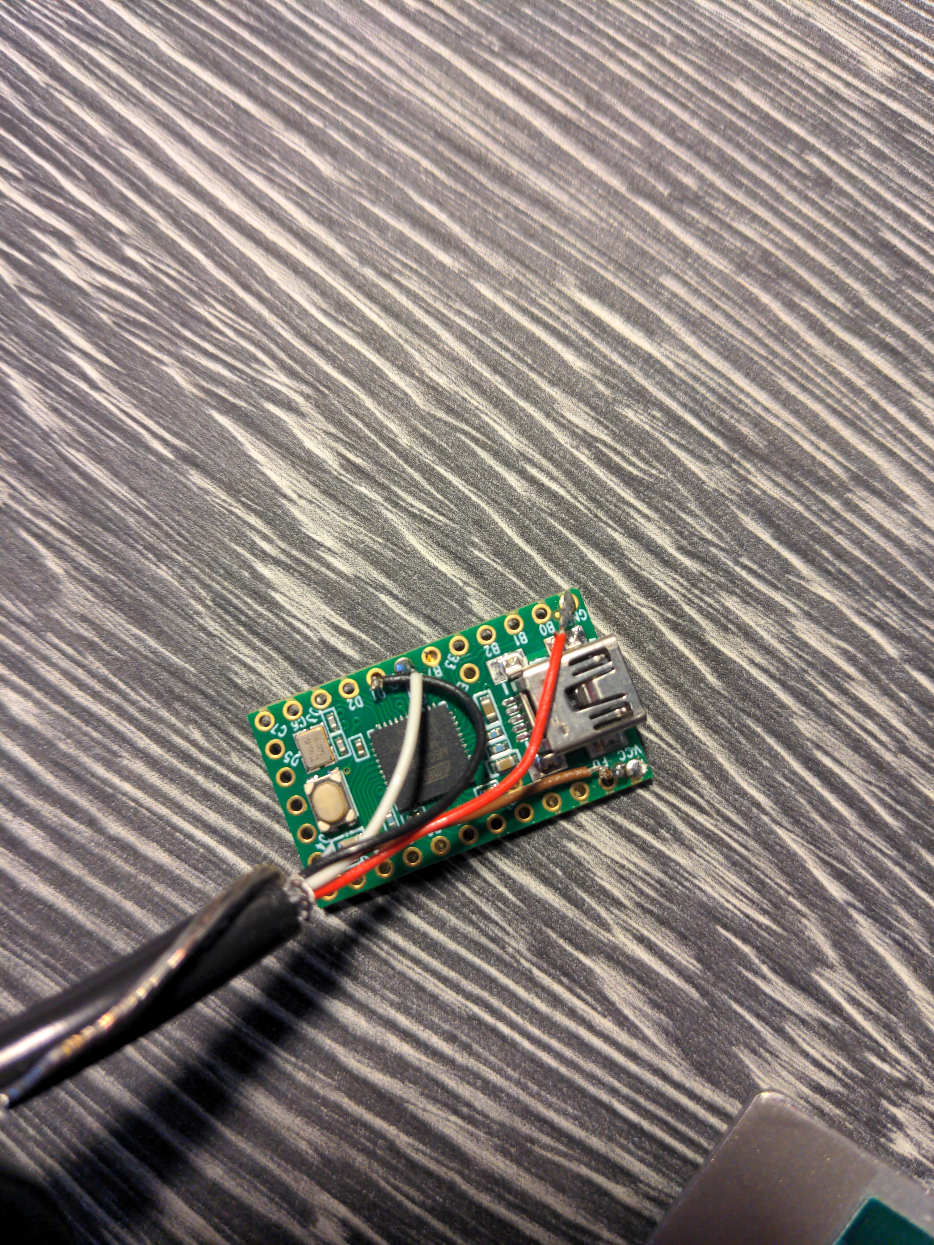

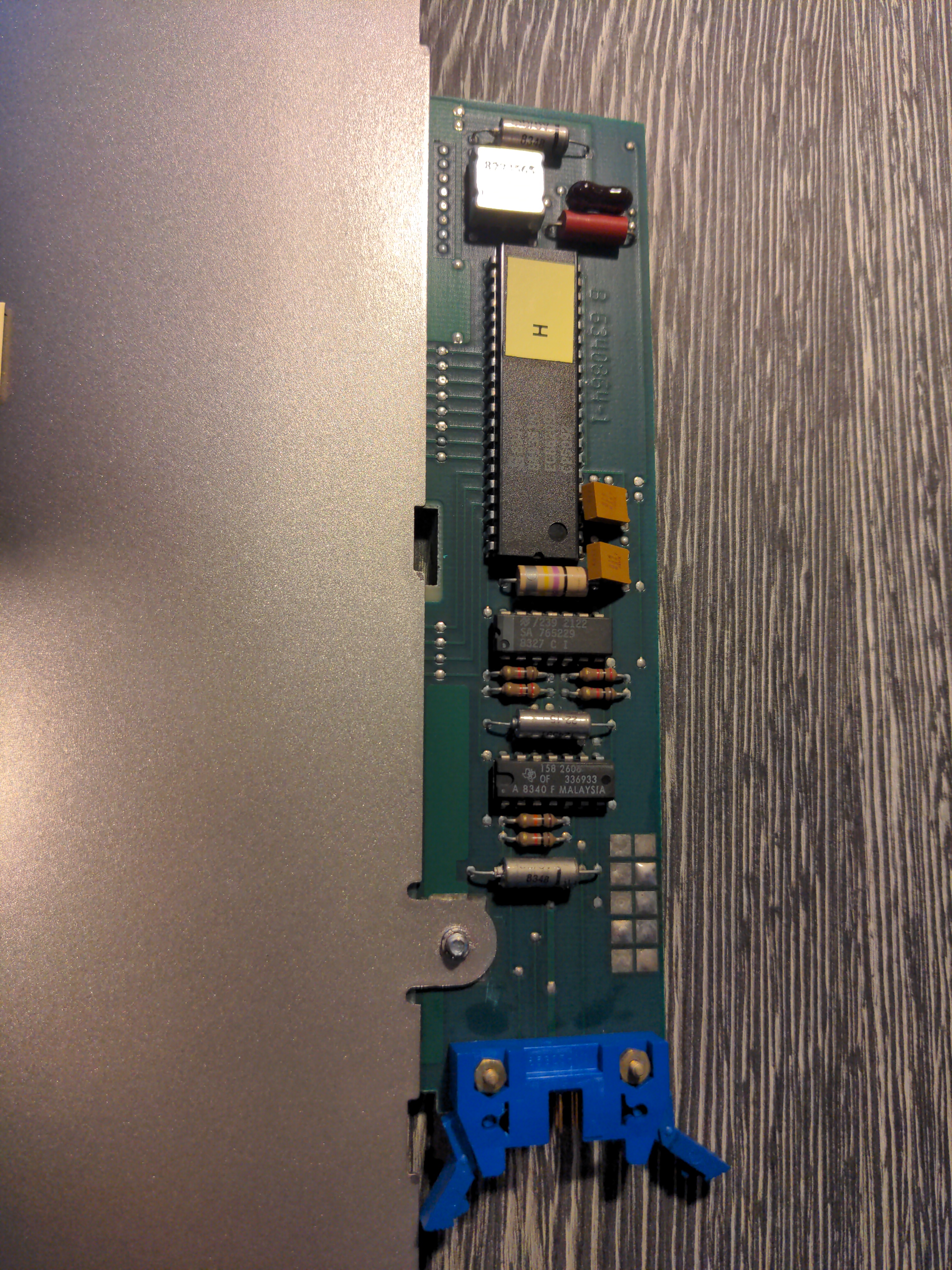

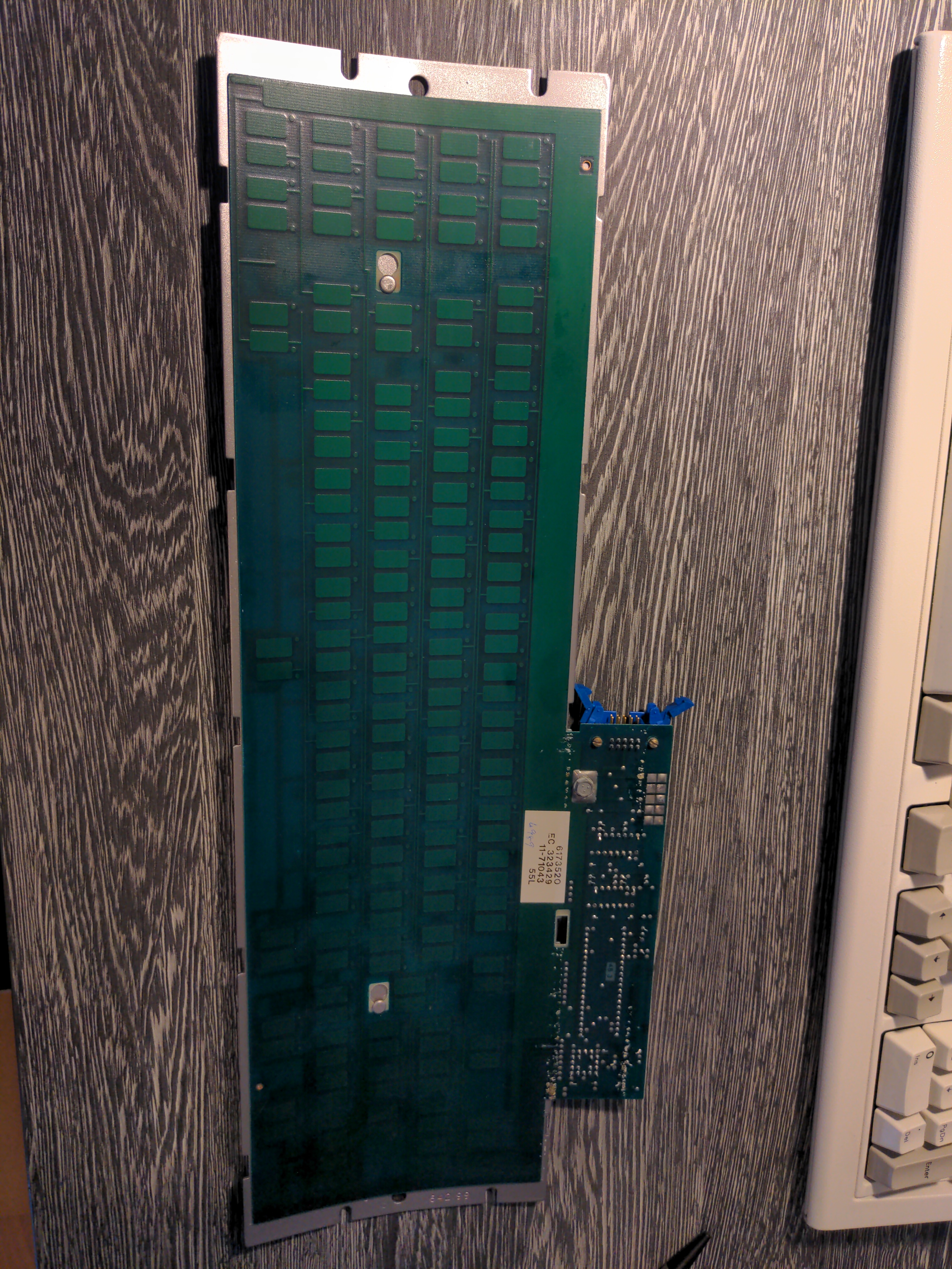

lately, I've been working on my restoration project of my Model F. Well, restoring the parts turned out to be great, however, I face a problem. As soon as I connect my Soarer's Converter it results in "USB Device taking up too much power, must disconnect immediately". I'm wondering if either the PCB has a short or if I misconfigured my Teensy. I double-checked the wiring at the Teensy, and I'm pretty sure that it is correct. Connecting my Teensy without being attached to the board, my computer detects the Soarer's Converter successfully.
Does anyone have an idea how to check the issue?
PCB board back:
PCB board front:
Teensy:
Teensy:

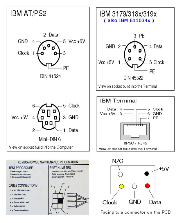

I have never done direct wiring to an F XT, but the diagram for the 122-key has the colors generally reversed from yours.
Remember that the diagrams show the socket and not the plug.

Thanks for your answer. I was referring to this thread https://geekhack.org/index.php?topic=17 ... #msg617942.
In addition, I'm going to check the PCB with a multimeter.
26 Nov 2021, 12:09
Model Fs can draw a lot of power. It's the vintage electronics inside their controllers that do it. For example: my Model F AT just wouldn't work with a Pro Micro running Soarer's Controller. The computer didn't complain, the Pro Micro just couldn't handle it! I swapped that thing out for a Teensy and it worked fine, but as you're seeing some hosts will complain it takes too much power and will deny you a connection. (iPads are especially mean about power draw, I found, back when I was doing that. Likely other tablets and even laptops too.)
So try using another computer, just to see if the XT's controller is working, and your Soarer Teensy too. A *powered* USB hub could do the trick. This could be a host-side limitation rather than anything wrong with the ~40 year old keyboard!
Ultimately, I swapped out my AT's controller for a modern Xwhatsit controller. Solved all the power draw problems, it's as efficient as any USB keyboard now. But the XT's controller is non-detachable so you don't have that option.

At least I know that the board is completely fine.

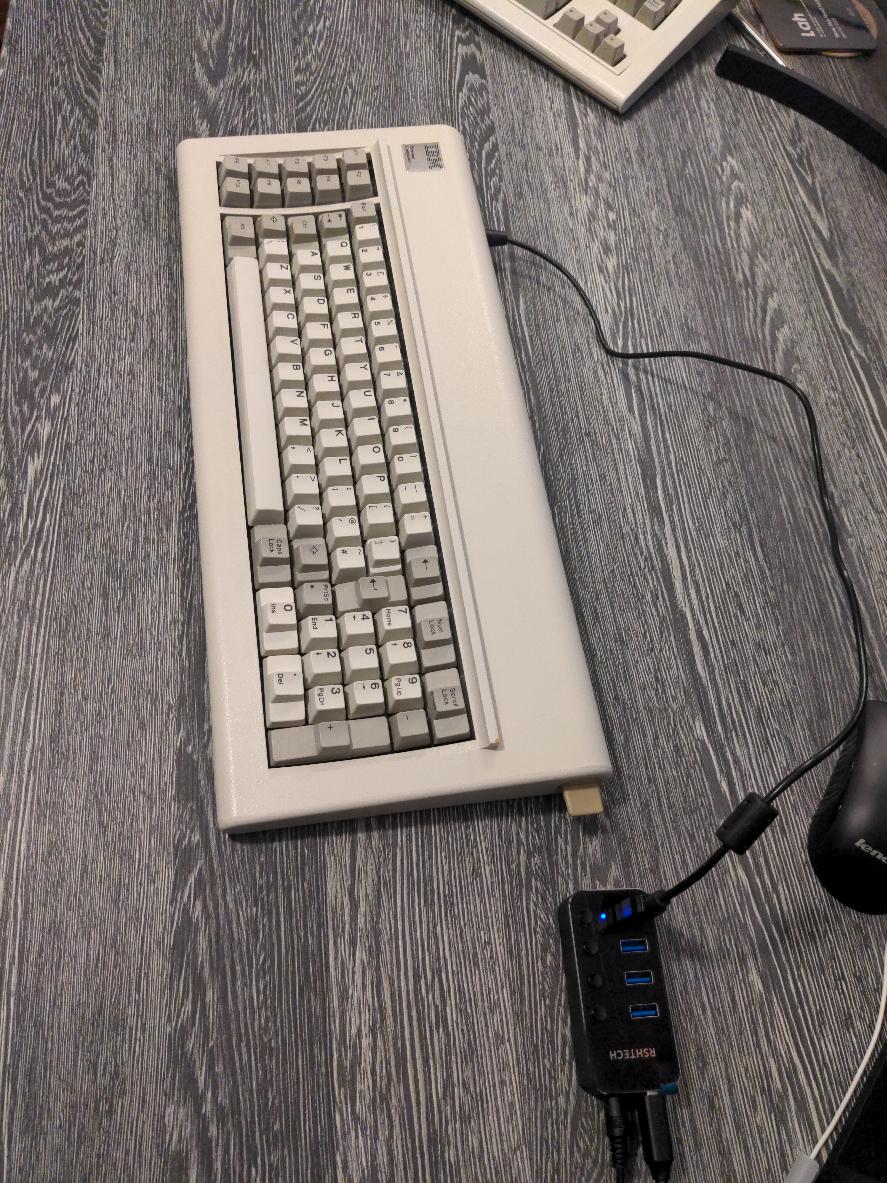

29 Nov 2021, 18:00
Yes indeed thanks @hellothere, I've tested it on this USB hub (https://www.amazon.de/-/en/RSHTECH-Acti ... B091F7C5K4) that I recently ordered on sale, and et voilà it works like a charm. :D
So for everyone who stumbles upon the same issue, this might fix it.
