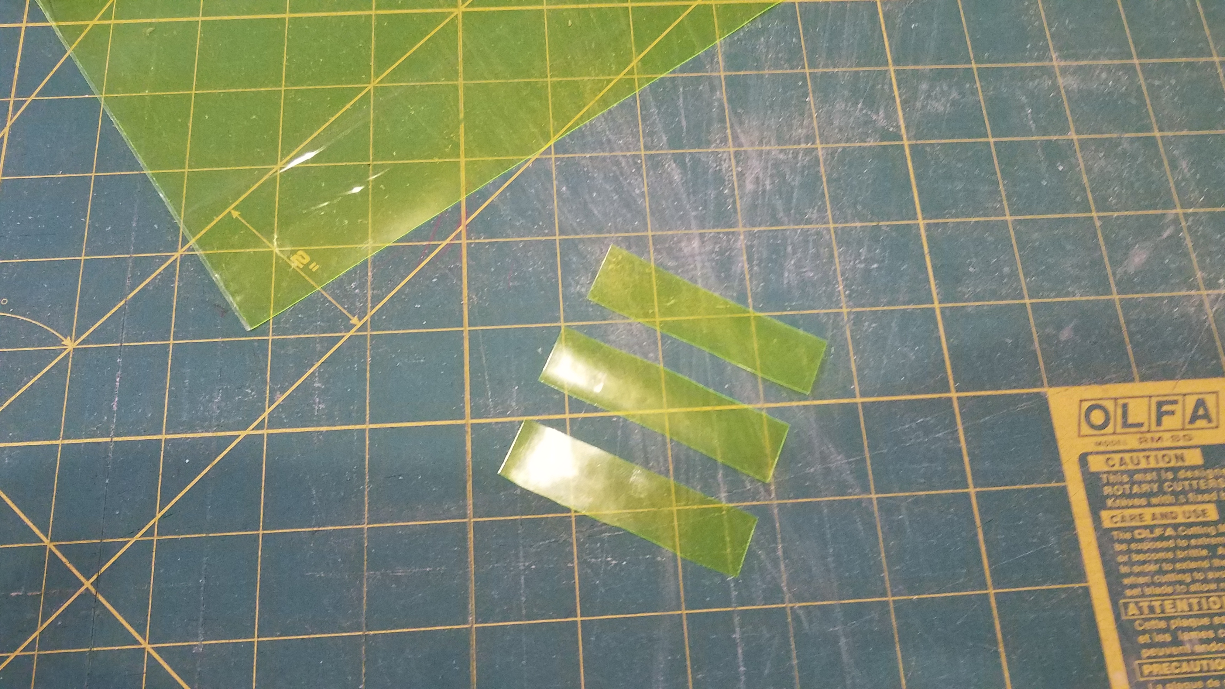

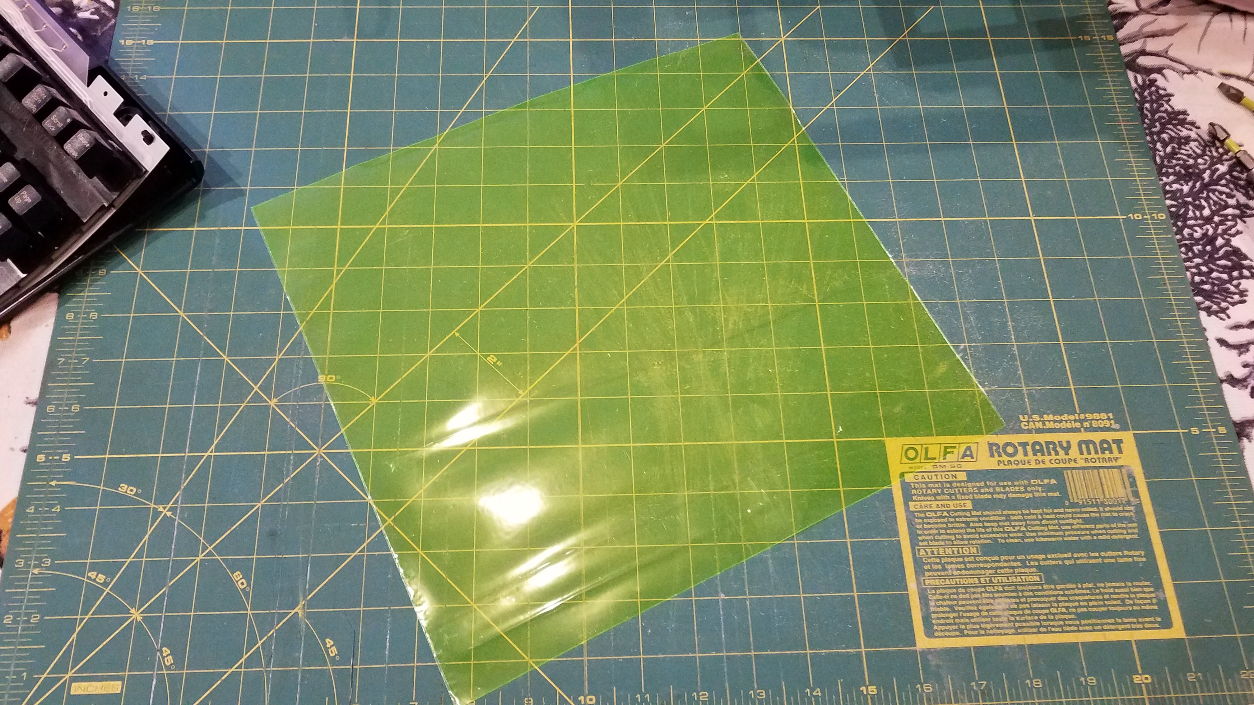

I looked for some plastic filters but didn't want to do these as I would have to glue something to the membrane. After a bit I found vinyl headlight films which will self adhere but can be removed if needed. These films are available on Amazon and other places for less than $10. After a bit of thought I chose a "lime" color film to pass greens and remove more blues than a green film. I think a pure yellow film may work also if it is just tinting film, but a straight green film will just go to blue/green.

I cut the films into 3 strips about 3in x 1/2in. After some trial and error I found that I needed to stack the three strips to get a full green, less than 3 it was still too blue, more didn't matter. Maybe with pure yellow film you might need less. The film has 2 coverings, one side is non adhesive with a scratch covering and the other covers the adhesive side.

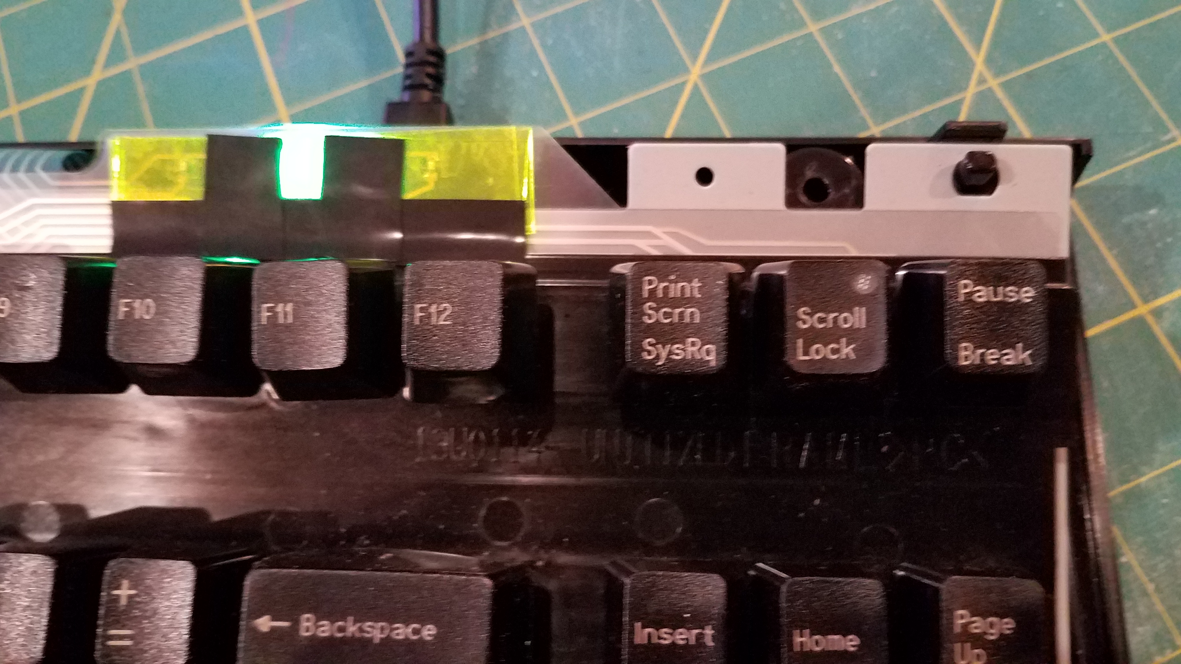

I removed the scratch protection side from all of them, then stacked them on each other removing the adhesive side and placing them on the membrane over the leds. Later I actually cut them into smaller 1/2in squares to eliminate some light bleed across the strip, but that seems to be an issue with the case design an not the film, squares might help a little bit so light does not travel in the film but not sure. Put some electrical tape between for good measure. The case has alot of space between the membrane and the lock lenses and is not well baffled so I think you will get light bleed no matter what.

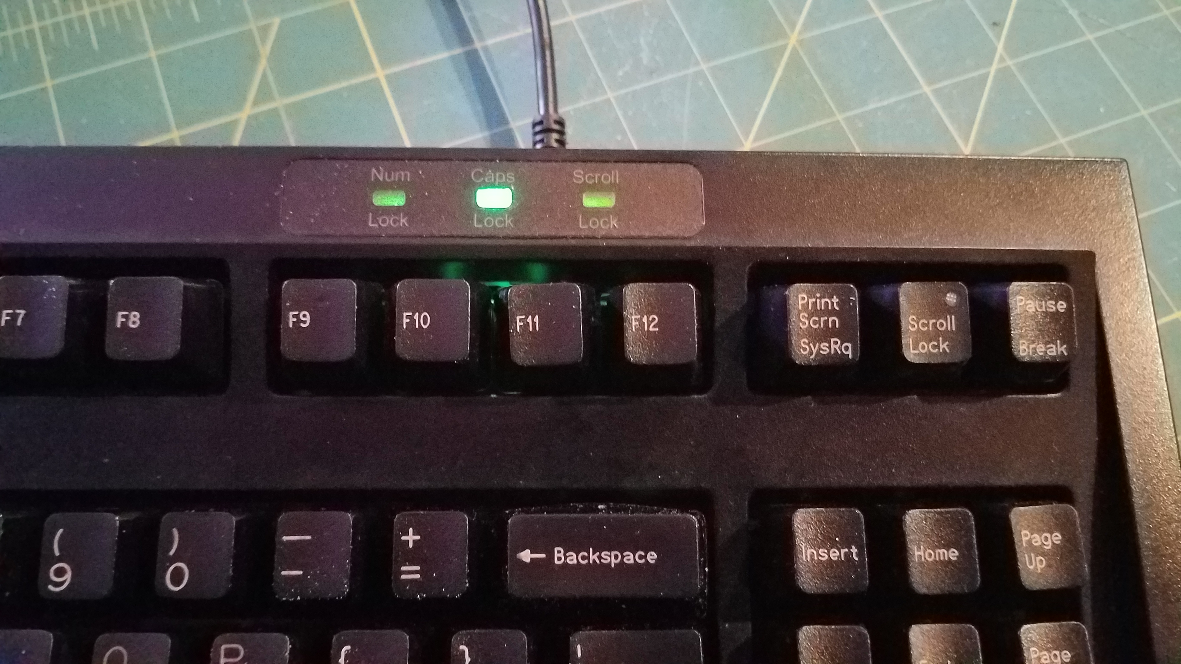

Below is how it turned out. I like the green and it is a touch dimmer than the piercing blue. The slight color bleed is there but I am ok with it, it was there with the blue also. Overall I am satisfied with the mod and it is fairly simple and non destructive so easy to try and change if you don't like. Let me know what you think.

What's up with your scroll lock key? It looks like it has an led window

If you make 3 seperate stacks of film vs one, with more black tape between, you'd get less light bleed.

zrrion wrote: 18 Oct 2021, 03:37 What's up with your scroll lock key? It looks like it has an led window
You noticed that, good eye. ;) I will be posting a surprise in keyboards shortly.

0100010 wrote: 18 Oct 2021, 04:43 If you make 3 seperate stacks of film vs one, with more black tape between, you'd get less light bleed.
Yes I mentioned that but probably did not make it clear that making 3 squares of 1/2in x 1/2in helped a little to eliminate light travel in the strip. But I think some of the bleed is just that the lock lenses on the case dont baffle the glare from the other leds very well.
