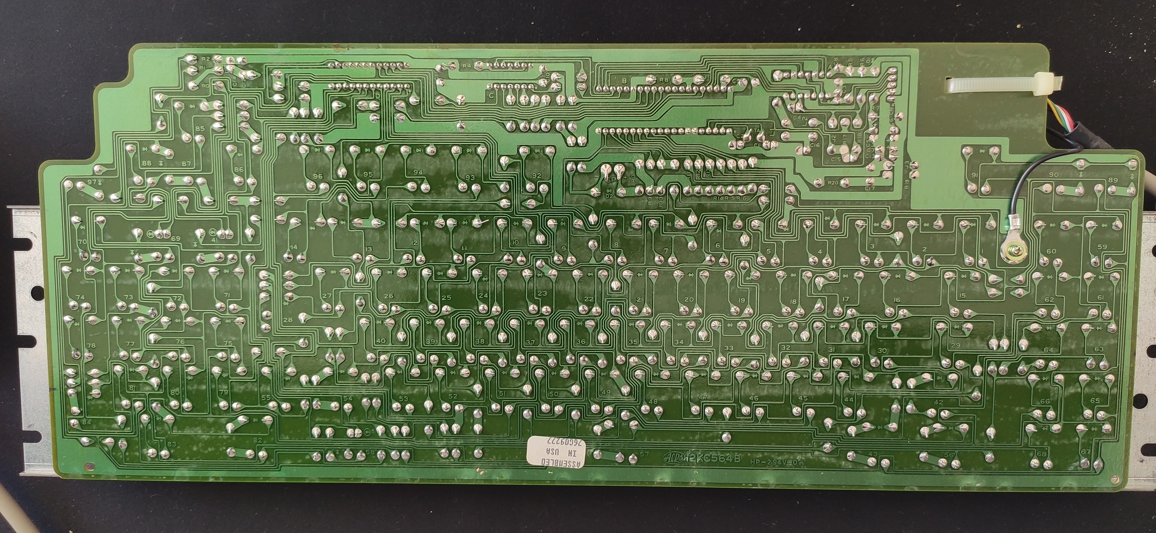

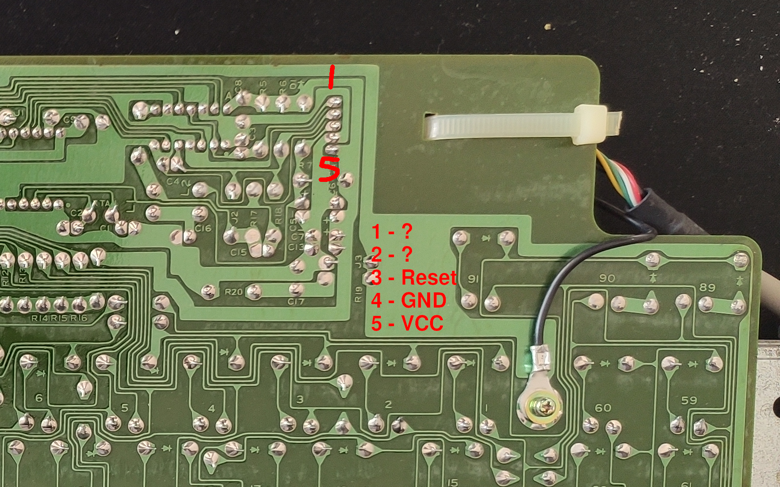

- doomsday_device
posting here too in case someone wants to add a thought
thanks kelvinhall with the help, my multimeter is crap.
you still have to guess clock/data
also please check pcb revision before taking any action.
- IMG_20210904_1721152.jpg (1.43 MiB) Viewed 36895 times
- IMG_20210904_172115.jpg (2.14 MiB) Viewed 36895 times

So as I don't take over someone else's thread, I'll post in here. I just threw up a bunch of data in viewtopic.php?f=7&t=26414&p=494747.
1. Thanks to doomsday_device and kelvinhall for the above pics. Very, very helpful. I still haven't built a converter yet, but it's on my list!
2. I do have the same model PCB. The "Assembled in USA [number]" has a different number, but I'd assume that what's stamped on the KB is more authoritative than a sticker. Hopefully.
I did play around with a multimeter today. Keyboard cable pins 3 through 5, as pictured on the above PCB, have continuity to pins on both the 40 pin NEC microcontroller and the 14 pin Texas Instruments chip. Pins 1 and 2 only have continuity to the TI chip. I don't know if that means anything.
It does look like I may have to wire in a couple resistors, per viewtopic.php?t=12972.

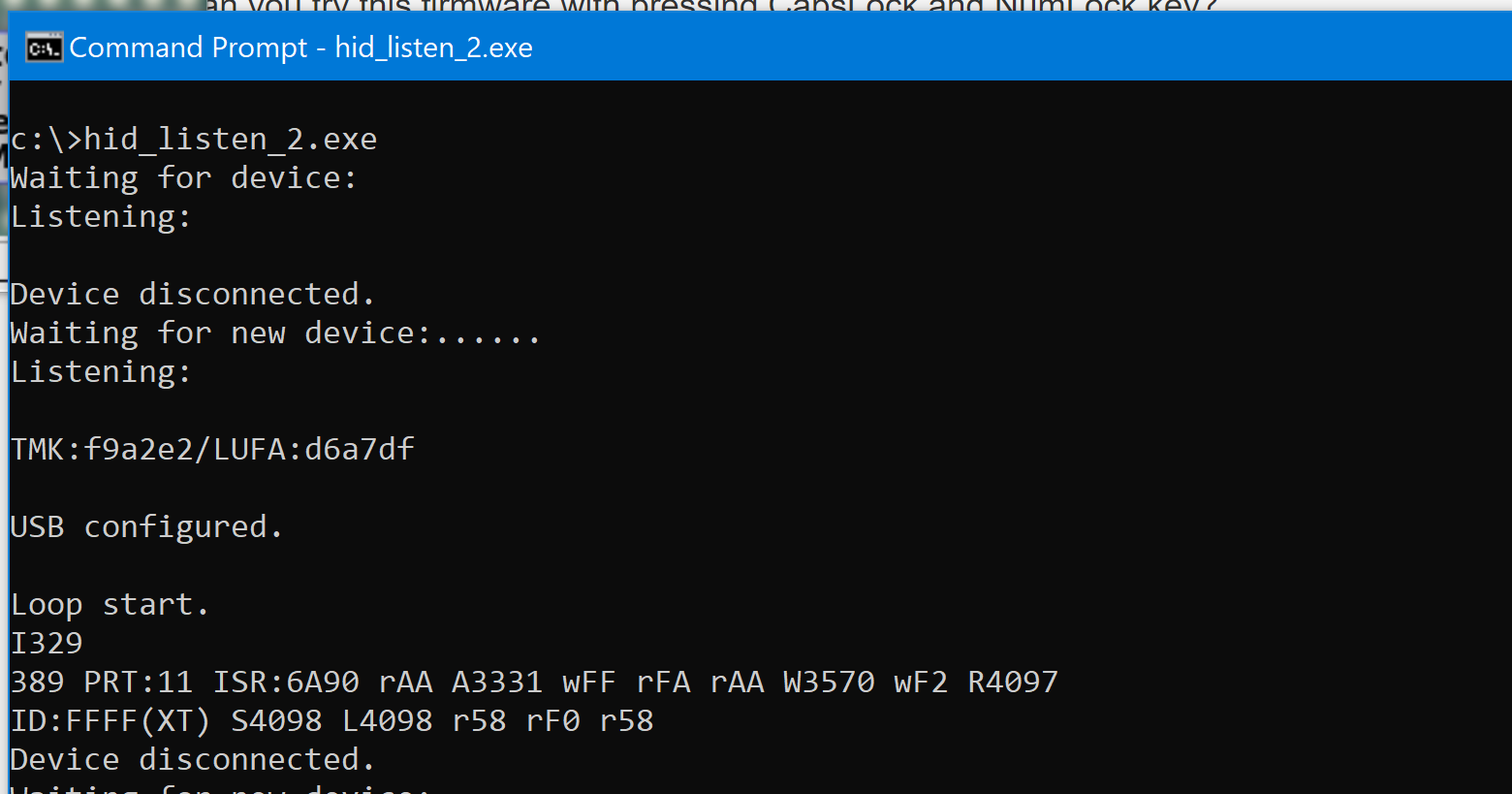

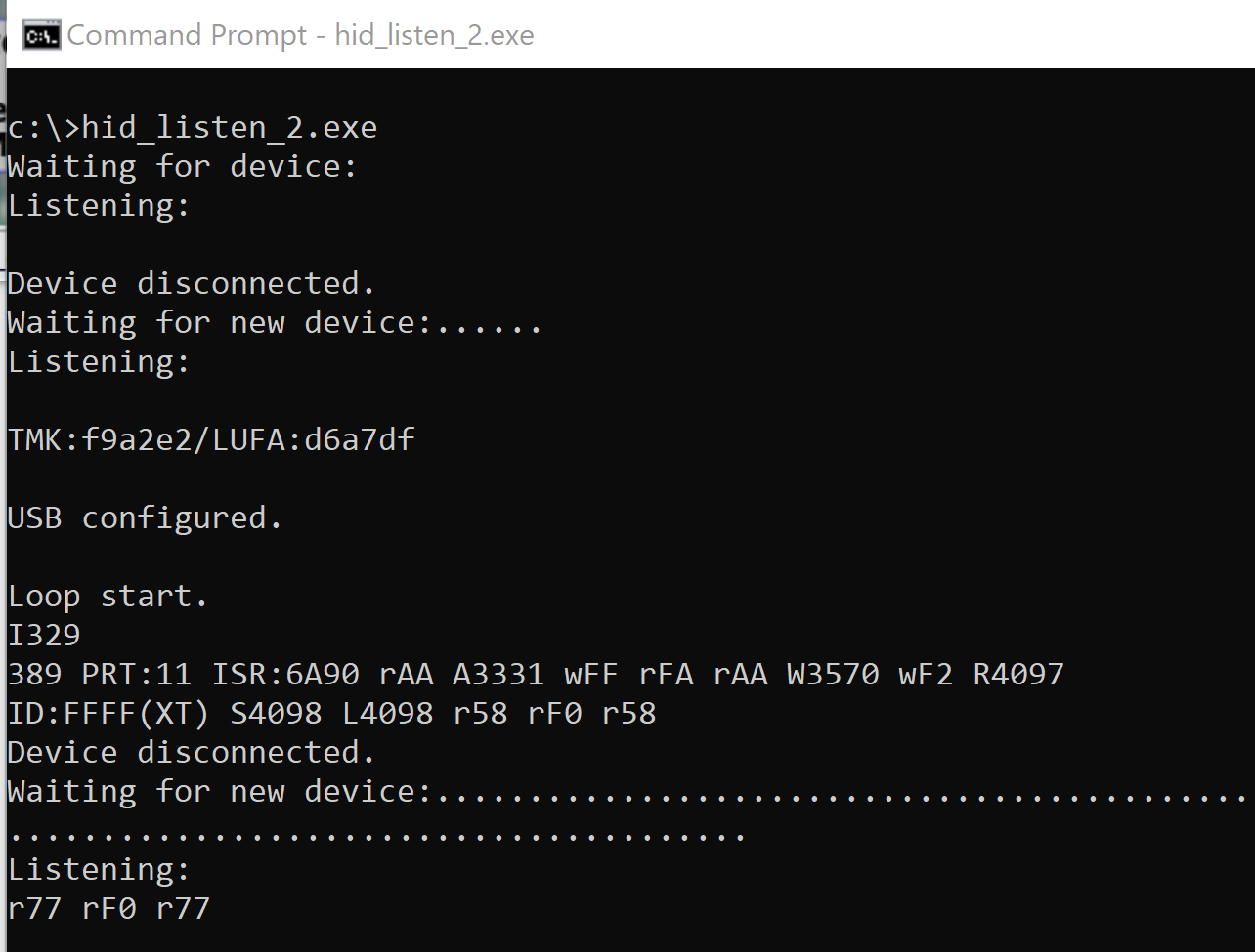

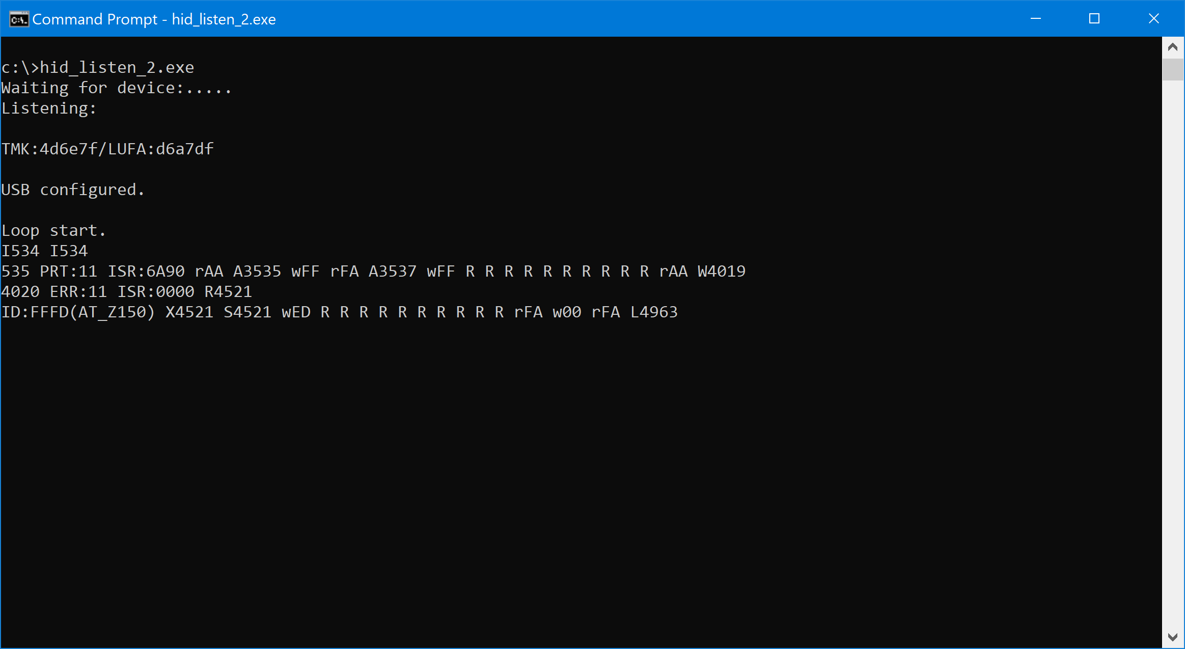

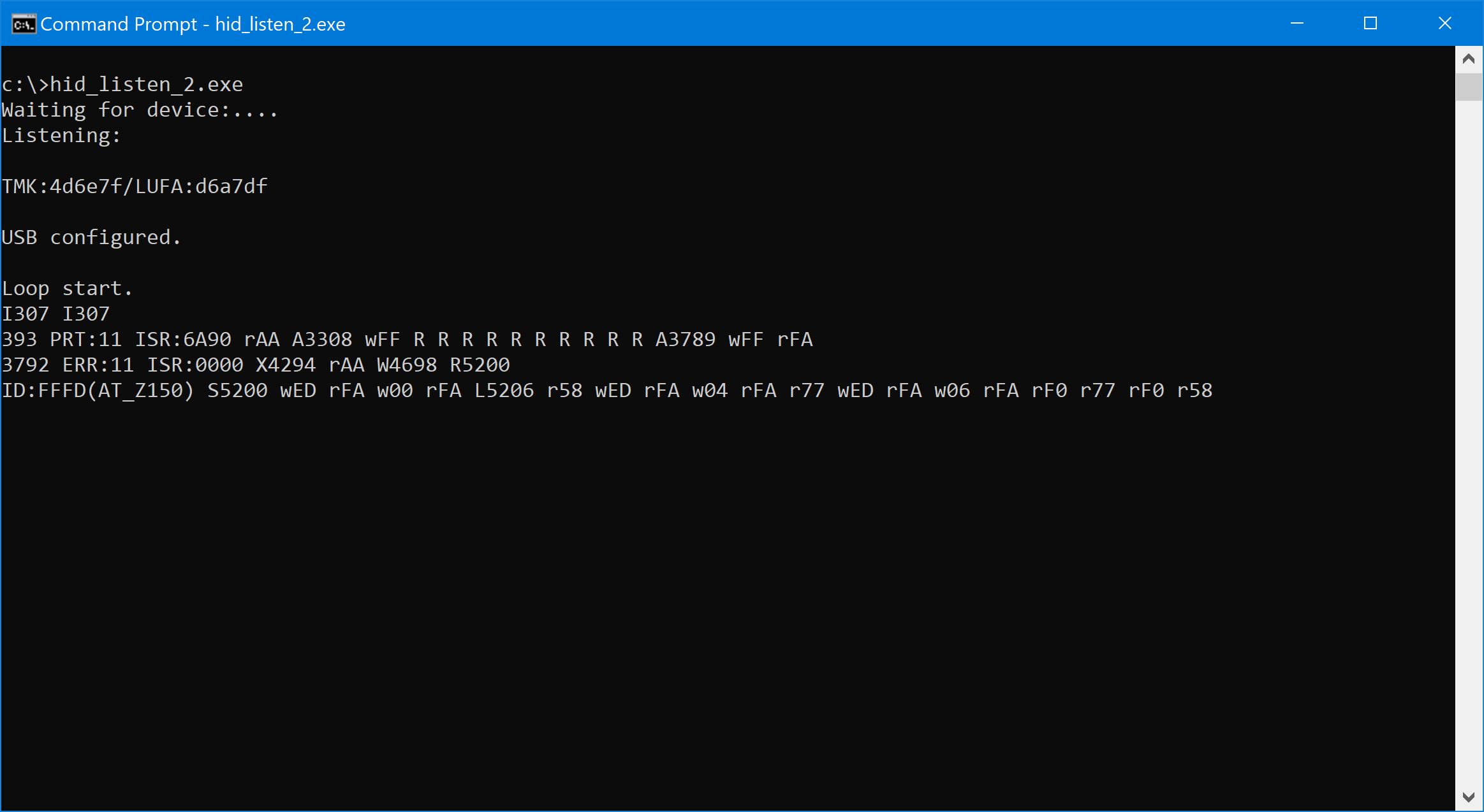

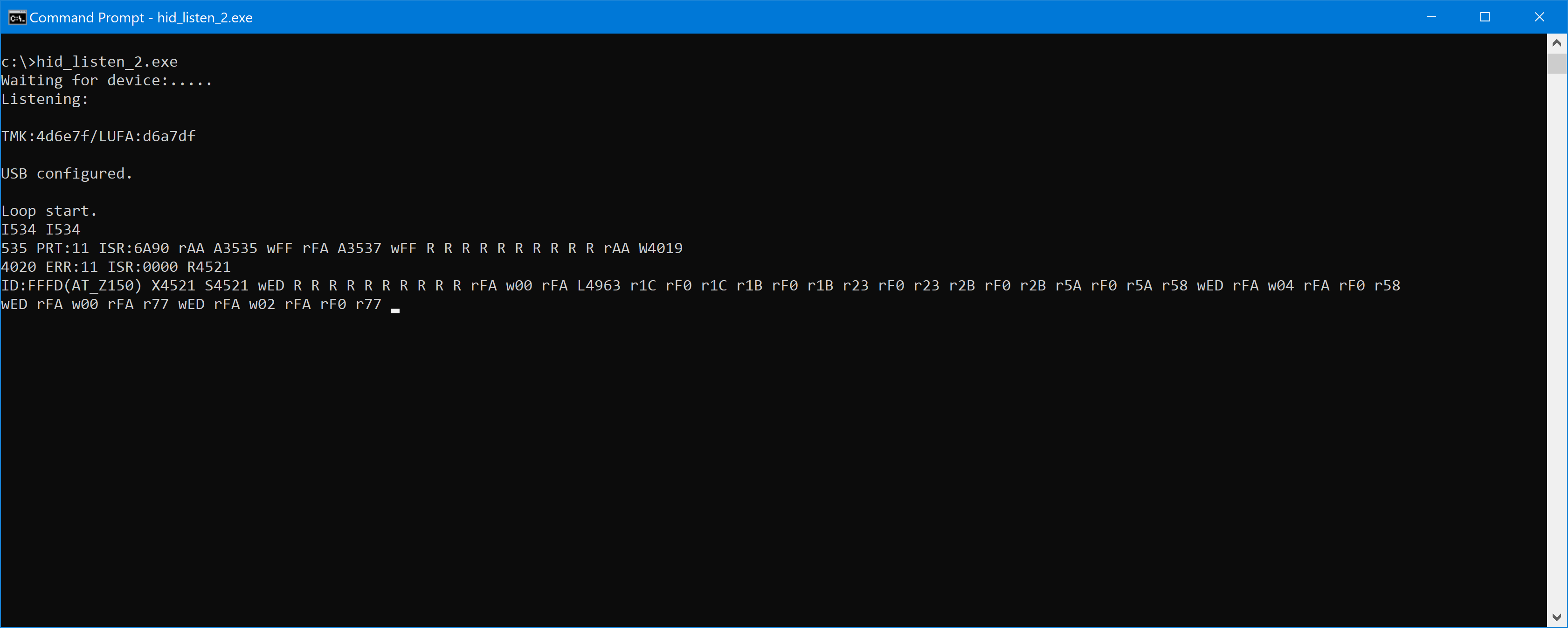

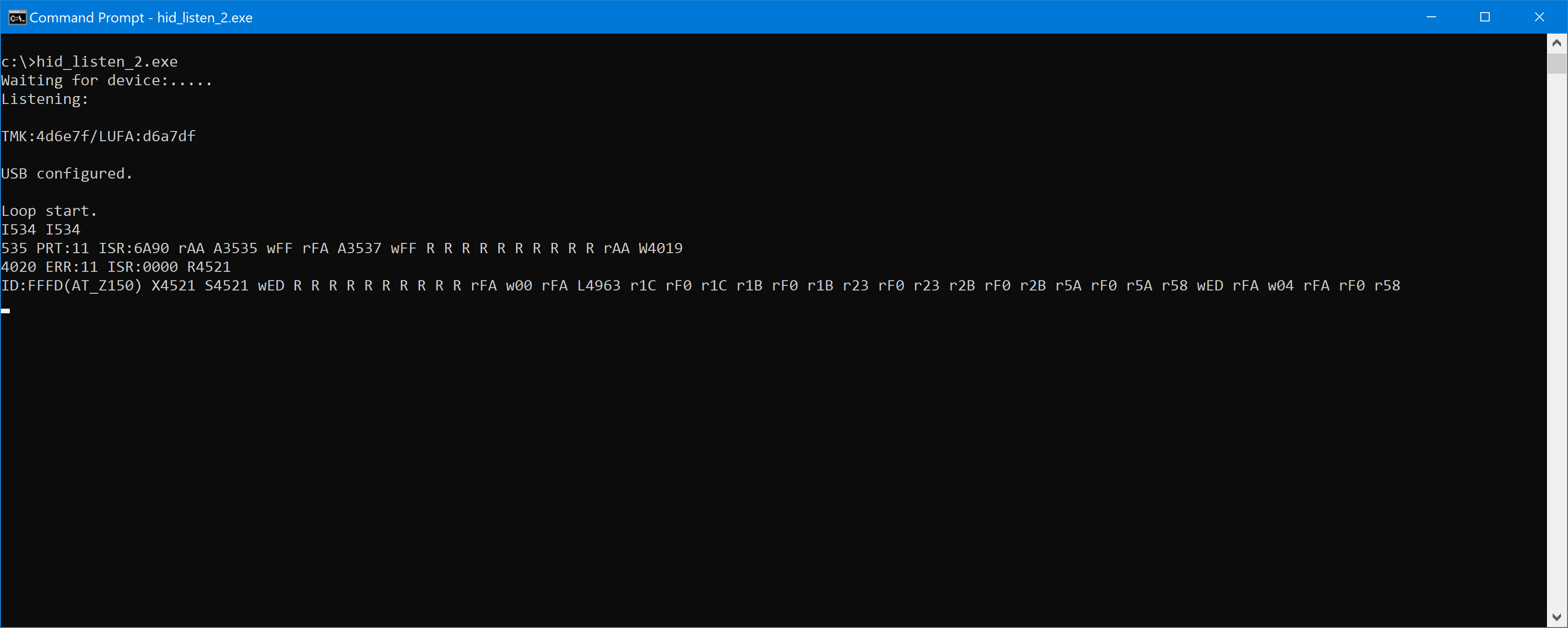

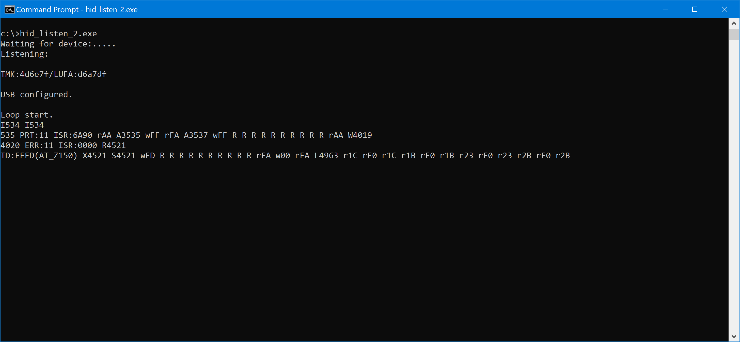

- hasu
- Location: Japan
- Main keyboard: HHKB
- Main mouse: HHKB
- Favorite switch: Topre
Glad to hear my firmware works for your keyboard.
Z-150 AT is still required improvemnt in TMK firmware and your help would be appreciated.
Can you try hid_listen to share its debug prints here?

It seems that the keyboard doesn't accept ID command(0xF2).
Can you try this firmware then with pressing CapsLock key 10-20 times quickly?
https://gist.githubusercontent.com/tmk/ ... _debug.hex
Pasting debug log in text form like below is enough, intead of screenshot.
Thanks,
Thanks,
TMK:96e722/LUFA:d6a7df
USB configured.
Loop start.
I476 A3477 wFF rFA
3480 PRT:10 ISR:FE90 rAA W3828 wF2 rFA rAB r83 R4334
ID:AB83(AT) S4335 wED rFA w02 rFA L4341 r58 wED rFA w06 rFA rF0 r58 r58 rF0 r58 wED rFA w02 rFA r58 wED rFA w06 rFA rF0 r58 r58 rF0 r58 wED rFA w02 rFA r58 wED rFA w06 rFA rF0 r58 r58 rF0 r58 wED rFA w02 rFA r58 wED rFA w06 rFA rF0 r58 r58 rF0 r58 wED rFA w02 rFA r58 wED rFA w06 rFA rF0 r58 r58 rF0 r58 wED rFA w02 rFA r58 wED rFA w06 rFA rF0 r58 r58 rF0 r58 wED rFA w02 rFA r58 wED rFA w06 rFA rF0 r58 r58 rF0 r58 wED rFA w02 rFA r58 wED rFA w06 rFA rF0 r58 r58 rF0 r58 wED rFA w02 rFA r58 wED rFA w06 rFA rF0 r58 r58 rF0 r58 wED rFA w02 rFA r58 wED rFA w06 rFA rF0 r58 r58 rF0 r58 wED rFA w02 rFA r58 wED rFA w06 rFA rF0 r58 r58 rF0 r58 wED rFA w02 rFA

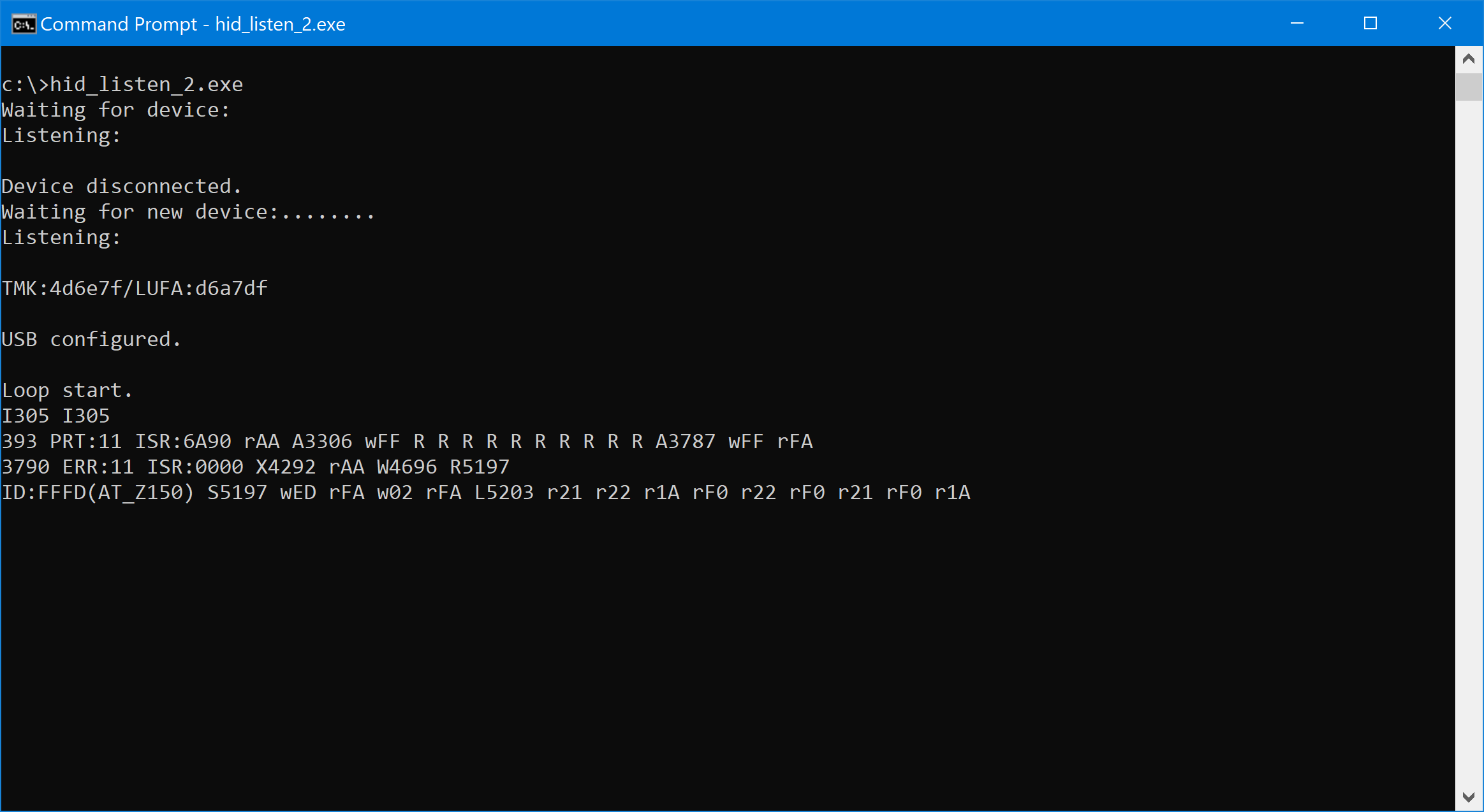

Very nice.
Lock lights are working. No "held down" keys. I'll check it in https://www.keyboardtester.com/tester.html.
C:\>hid_listen_2.exe
Waiting for device:.........
Listening:
USB configured.
Loop start.
I304
395 PRT:11 ISR:6A90 rAA A3305 wFF rFA rAA W3544 R4045
ID:FFFD(AT_Z150) S4045 wED rFA w02 rFA L4051 r58 wED rFA w06 rFA rF0 r58 r58 wED rFA w02 rFA rF0 r58 r58 wED rFA w06 rFA rF0 r58 r58 wED rFA w02 rFA rF0 r58 r58 wED rFA w06 rFA rF0 r58 r58 wED rFA w02 rFA rF0 r58 r58 wED rFA w06 rFA rF0 r58 r58 wED rFA w02 rFA rF0 r58 r58 wED rFA w06 rFA rF0 r58 r58 wED rFA w02 rFA rF0 r58 r58 wED rFA w06 rFA rF0 r58 r58 wED rFA w02 rFA rF0 r58 r58 wED rFA w06 rFA rF0 r58 r58 wED rFA w02 rFA rF0 r58 r58 wED rFA w06 rFA rF0 r58 r58 wED rFA w02 rFA rF0 r58 r58 wED rFA w06 rFA rF0 r58 r58 wED rFA w02 rFA rF0 r58 r58 wED rFA w06 rFA rF0 r58 r58 wED rFA w02 rFA rF0 r58 r58 wED rFA w06 rFA rF0 r58 r58 wED rFA w02 rFA rF0 r58 r58 wED rFA w06 rFA rF0 r58 r58 wED rFA w02 rFA rF0 r58 r58 wED rFA w06 rFA rF0 r58
