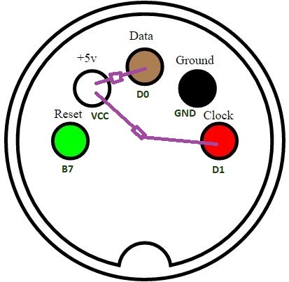

I actually just got an XT Z-150 myself and made a converter for it for my first time like two weeks ago. Here is what I did. Hope this helps!
What I did was purchase a Teensy 2.0 and some female MIDI din sockets, then I flashed the teensy with this hex file here: viewtopic.php?p=355792#p355792
You could also use Hasu's firmware.

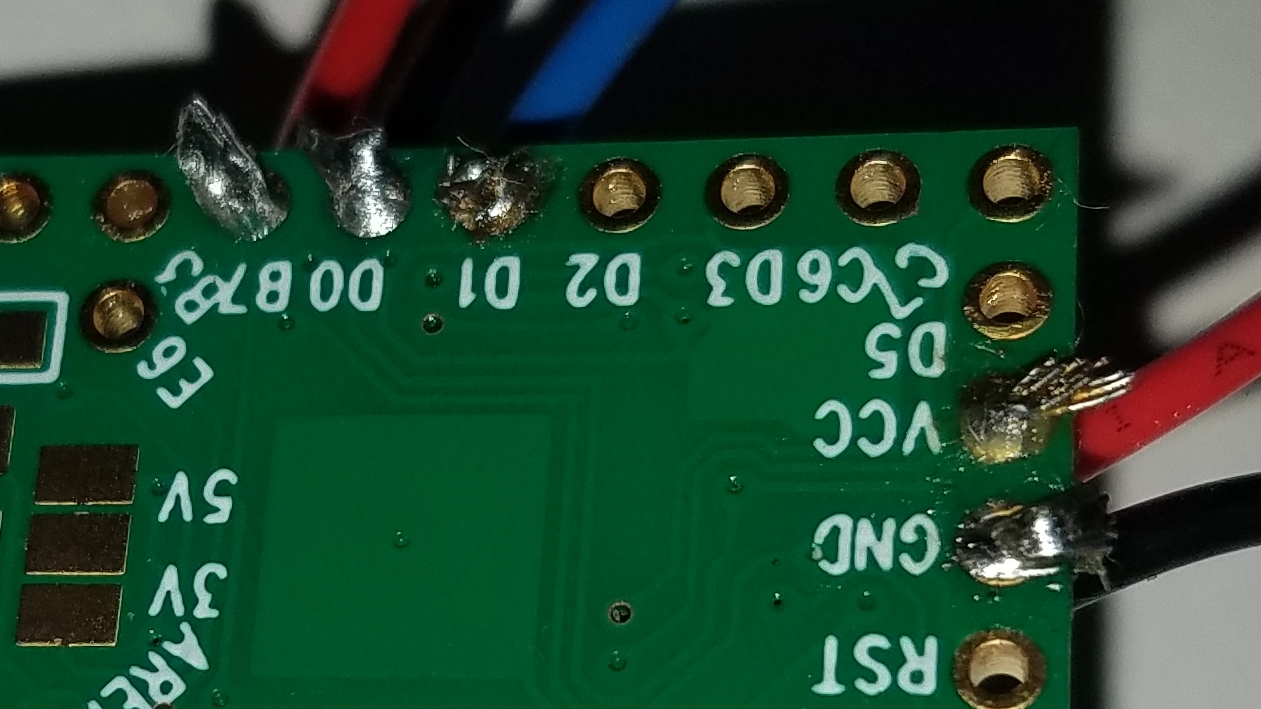

After that I soldered the leads on the back of one of the 5-pin din sockets I purchased to the respective holes on the teensy, the reason this won't work with one of Orihalcon's converters is because it needs to have the reset pin wired in.
Here is a diagram from the male end of the XT connector, on the top of the pins is the XT pinout and on the bottom is the corresponding teensy connectors. Also make sure to put a pull-up resistor between clock and 5v and another between data and 5v, as is shown here in purple.

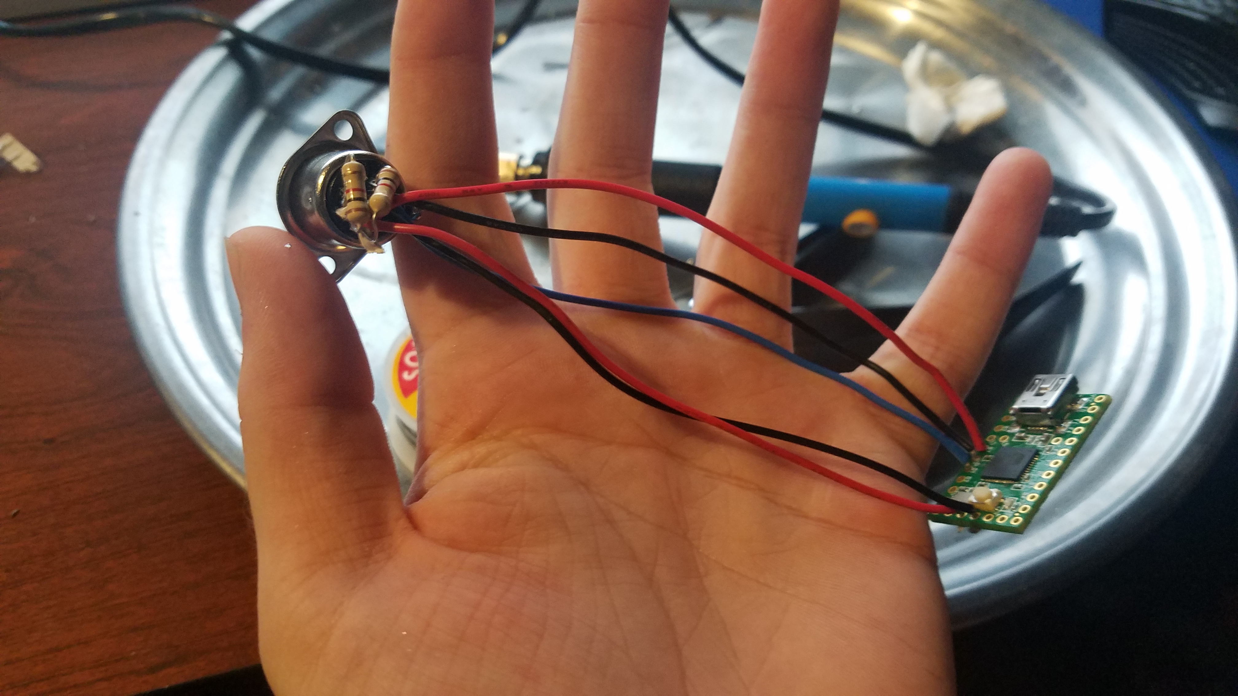

Here is what my converter looked like. Pardon my awful soldering :D
