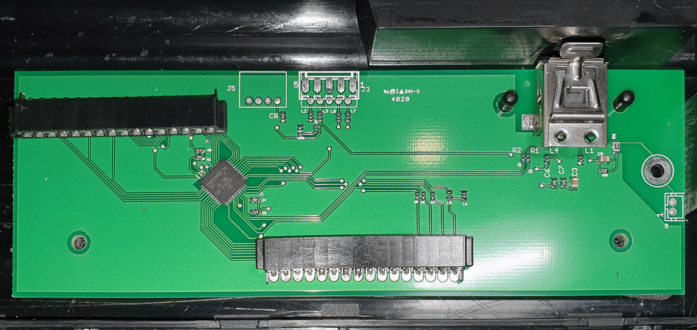

By "two controllers", do you mean physically or an 'enumeration to the operating system' technique? This is what the only PCB in the Mini M looks like:
The comments about the USB I can agree with. The standards part makes sense of course, but I like the pressure-locking solution it has versus what seems to be manual-screwing solutions for Type-C at present.

sharktastica wrote: 24 Apr 2021, 00:28 By "two controllers", do you mean physically or an 'enumeration to the operating system' technique?
Your pic answers it nicely: clearly the latter! So hopefully it's something they can fix in firmware. Extra points if the firmware update can be performed by end users.

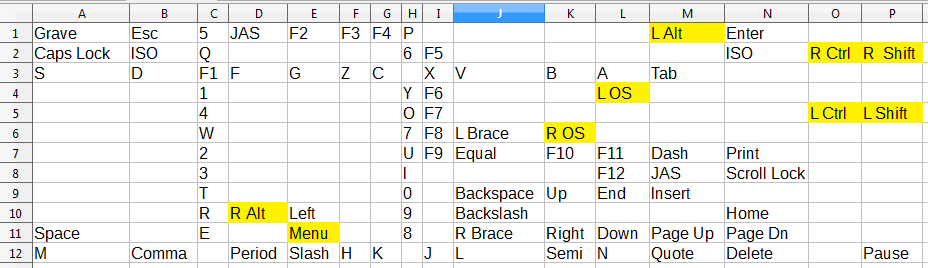

I posted this in another thread. Sharing here too. Biggest risk of blocking/ghosting on columns C and H. Hold down any two numbers and it will block two keys on the QWERT row.
M Mini matrix.png (24 KiB) Viewed 7538 times
